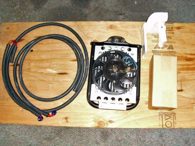

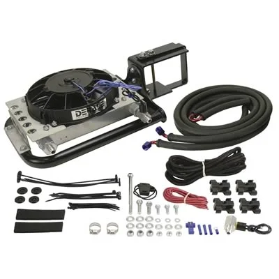

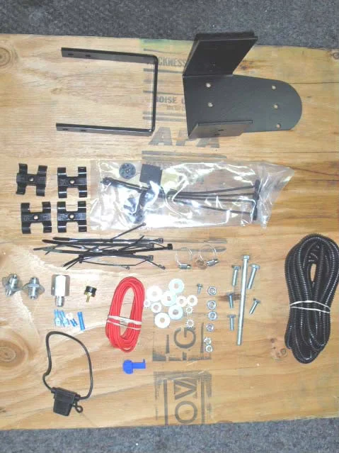

This is the box that arrived… you can see it is nicely packaged specifically for the Wrangler.
It comes well packaged and it contains every thing needed to install it, down to zip ties for the electrical wiring. The only tools you need are minimal and very basic. If you have SAE size wrenches, a pair of pliers, wire cutters, and a solderless connection crimp tool, you’re good to go. A nice additional tool would be a heat gun and heat shrink tubing for the fan’s electrical connections.
It was engineered to be easily installed by anyone with basic hand tools and that’s what it turned out to be… a very easy non-technical job. The mount and fan frame are unique to the Wrangler kit so no mods are needed to get it to fit perfectly.
Even the two supplied coolant hoses are already cut precisely to length and are complete with fancy red and blue anodized AN fittings. AN fittings are the standard for high-quality builds, you won’t have leaks from these.
One of the first things I noticed about Derale’s kit was its set of instructions. It’s clear Derale put some serious time and effort into them. They are complete, extremely well illustrated, and leave nothing for you to have to figure out. Check them out below.

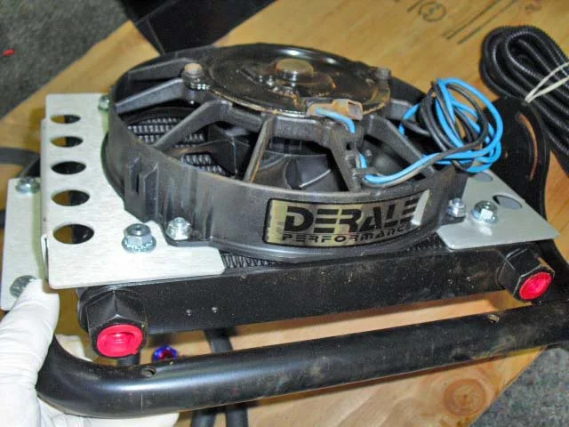

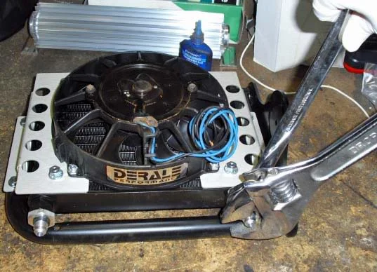

First things first, position the cooler on your workbench so you can attach its two fittings, install its thermostat switch, and do the very basic wiring so the thermostat switch can turn the fan on and off.

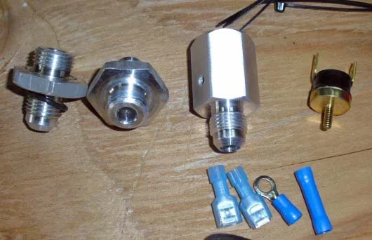

Thread the aluminum fittings, the two on the left above, onto the fan assembly’s inlet and outlet connectors. Note that the o-ring shown above on the left-most fitting actually goes on the OTHER side of that fitting. The o-ring needs to be on the side of the fitting that threads into the cooler, not on the hose side as shown in the picture.
Please don't beat me up too much for using the Crescent wrench on that 1 1/16" fitting, my SAE open-end/box-end set set only goes up to 1".

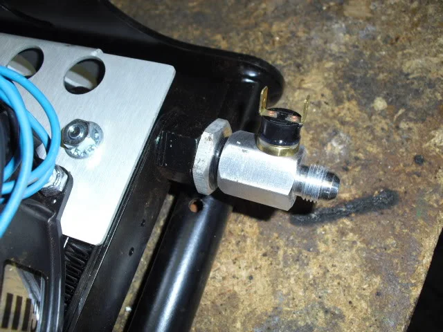

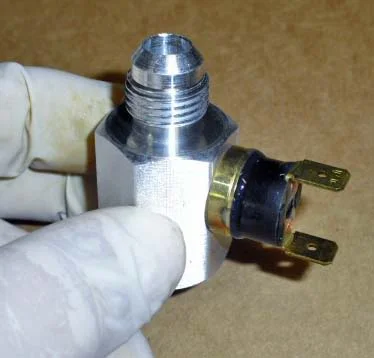

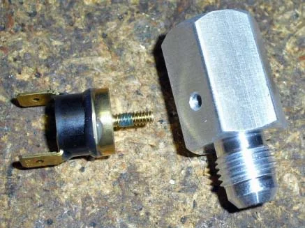

Attach the thermostat switch and its aluminum fitting as shown below using a 7/8” and 1 1/16” wrench. The thermostat switch’s sensor protrudes into its fitting far enough so it can actually touch the ATF as it is pumped through. Use a bit of Locktite on the middle of the thermostat switch’s threads to insure it doesn’t unscrew from the engine’s vibrations. Do not use a wrench to tighten the thermostat switch, it should only be firmly hand-tightened.
The thermostat switch and fitting assembly is then screwed into the cooler’s input port.
Wiring the thermostat switch in is easy, it is a simple on-off switch that turns the fan on and off based on the temperature of the transmission’s ATF fluid. The switch turns the fan on when the ATF reaches 180 degrees, well below the temperature where damage could occur to the ATF or transmission. The switch shuts the fan off after the ATF has been cooled back down to 170 degrees.

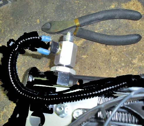

I used a bit of plastic wire loom to protect the wiring and then zip-tied it to an adhesive zip-tie holder to keep the wires where they belong.

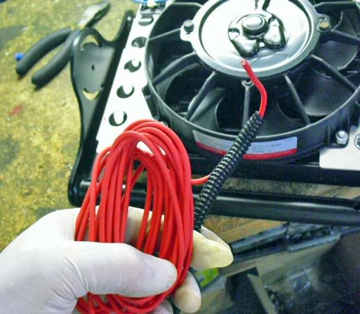

Next, connect the supplied red wire to the other side of the thermostat fan switch. This wire connects the fan to a +12v source. Derale recommends the +12v be switched, which means the power should only be on when the ignition switch is on. Derale provides an inline fuse holder and blade style fuse to protect everything. Slip the red wire into the provided protective plastic wire loom before mounting the fan.

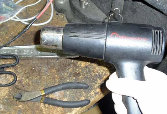

I cover every splice and every crimped connection with protective insulated heat-shrink tubing. Heat shrink tubing is inexpensive, better, and quicker than wrapping connections and splices with electrical tape. This pic shows a heat gun being used to shrink the heat shrink tubing that can be found in any hardware store, Home Depot, Radio Shack, etc.

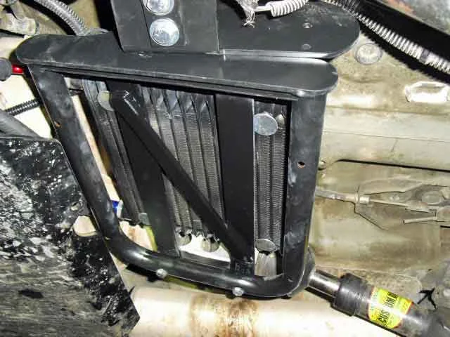

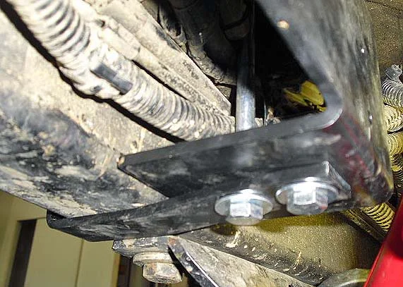

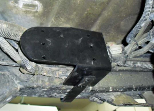

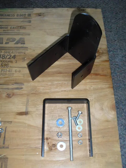

With the fan pre-wired and its hose connectors installed, it is time to install its mount to the Jeep’s frame. The top part goes inside, the smaller part slips over the frame from the outside.
The mount leaves plenty of room for the fuel lines and wiring that run along the frame.

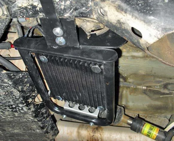

The cooler is attached to the clamp with three bolts. Its angle can be positioned from flat to angled. Once it is at the angle you like, tighten the bolts. For me, it worked best by sliding the mount a bit further rearward and using the forward-most mounting bolt holes. It gives you a choice between two positions, the most forward position worked best for me.
The mount itself is well designed and purposely made from two gauges of steel. The heavier side securely holds the cooler to the frame and away from the fuel and electrical lines underneath. The other half of the mount is still a heavy-gauge steel but it is designed to provide a clamping effect when it bends slightly to conform to the frame and inside mount as the mounting nuts and bolts are given those final turns. The mount holds the fan very securely.
For some, that position may seem to be exposed. However, it’s not as exposed as it may seem to be since it has the frame, skidplate, and control arm bracket on three sides of it. I will likely fabricate an additional guard to provide a little added insurance against a rock being in the wrong place at the wrong time. If this makes you feel better, I had my previous TJ’s on-board air tank in the same position and after nearly ten years on the rocks, the rocks never touched the air tank.

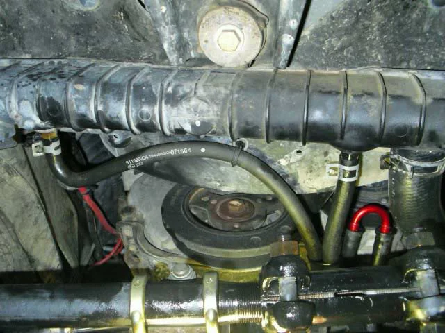

Coolant hose routing and connections
The two coolant hoses are routed along the driver’s side of the frame towards the radiator. The two hoses are connected to the radiator's transmission cooler output side, so the Derale system cools the ATF flowing back towards the transmission. Which side of the radiator's transmission cooler the Derale gets connected into, passenger-side or driver's side, depends on your TJ's model year and thus its transmission type.

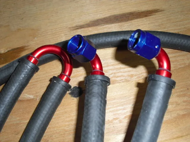

For 2002 and older models which use the 3-speed 32RH or 30RH transmission, the Derale cooler lines connect to the passenger-side transmission output port of the radiator and the hard line the OE passenger-side hose used to connect to. Entirely remove the OE short hose that connected the passenger-side transmission cooler port to the hard line, connect the new Derale hoses to those fittings.
The current Derale instructions do not address the change in which way the ATF flows through the radiator transmission cooler for 2003 and newer TJs so the following modification to where its hoses connect should be followed:
For 2003 and newer models which use the 4-speed 42RLE transmission, the Derale cooler lines connect to the driver's-side transmission output port and the hard line the OE driver's-side hose used to connect to. Entirely remove the OE short hose that connected the driver's-side transmission cooler port to the hard line, connect the new Derale hoses to those fittings.
The Derale kit does not otherwise need any additional parts or modifications other than the supply hose leading to the Derale (the plain hose) now has perhaps 6" of extra available length. I left the additional length in place and located the small amount of extra length above the t-case skidplate. Those extra inches of available hose for 2003 and newer TJs may come in handy years down the road.

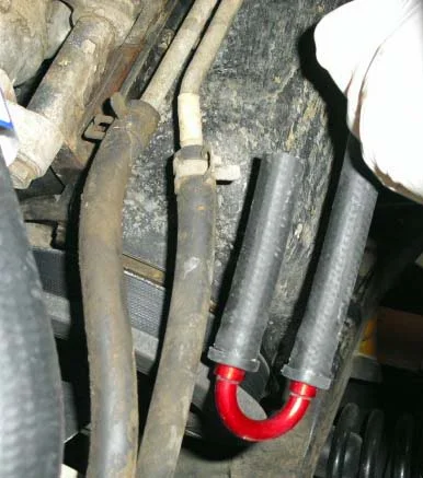

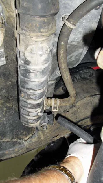

The below photo shows the 2003 and newer hose layout connected into the driver's side. For 2002 and older, connect the Derale into passenger side instead.
The first hose from the Derale cooler connects to the radiator’s return line. Derale includes two stainless steel hose clamps to be used here and on the other line but I reused the factory constant-tension spring clamps.
The other new hose, which is the return line, connects here after the old hose is removed.

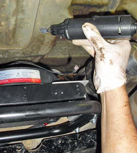

Derale provides a cool way of attaching the coolant lines to the frame rail which serves to keep them parallel and out of the way of damage. Also provided are zip-ties to secure the hoses and wiring the rest of the way to their destination. Take pain now to insure everything is well secured and out of the way of potential harm.

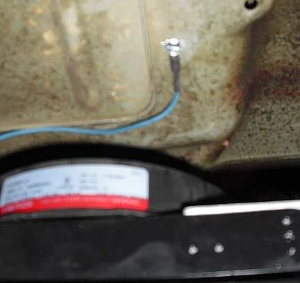

The negative ground wire, remember, is the blue wire coming from the fan. NOT the black wire which for us electrical types keeps you on your feet. Connect the fan’s blue ground wire to a suitable ground connection. I simply drilled a 9/64” hole in the floor pan above the cooler for the supplied hex-head self-tapping ground screw.
To assure a good solid ground connection, be sure to grind any paint away from what you choose to ground the fan to as shown below. A Dremel tool makes quick work of this.

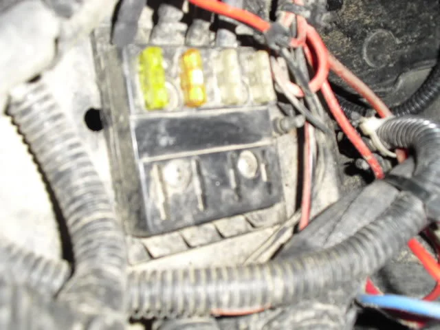

I connected the cooler’s +12v lead to an auxiliary fuse panel I installed last year.

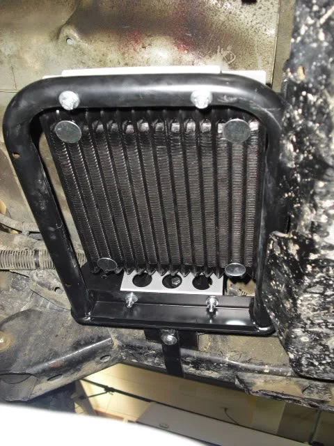

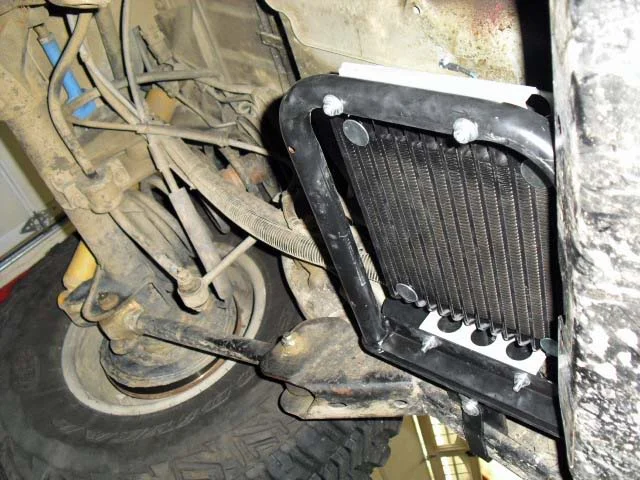

This is the final product. Even though I know from past experience that particular location is quite safe, I’m a bit anal about over-protecting everything underneath so I added a protective barrier since this Jeep wheels on a lot of big rocks.

This is the final product. Even though I know from past experience that particular location is quite safe, I’m a bit anal about over-protecting everything underneath so I’ll add a protective barrier before too long since this Jeep sees some big rocks once in a while.

Have you had any issues with it being damaged in that location? I know you do rocks frequently and i would think it would get hit being in that spot.
If you read some of the reviews from the Amazon link you'll see that people were initially concerned about the location, but then after wheeling with it, found that it didn't get damaged even one bit.
I can attest to this as well. I have the same transmission cooler in the same location, and I've never had any issues with rocks or damage when I go wheeling.
Interesting. I bet if you do alot of mudding then it'll get quite messy.
I have a t-cooler on my xj but it's mounted in front of the radiator.

Question- your photo of the thermostat housing installed in the inlet port shows an O ring between the thermostat housing and the port. Is that correct? My kit has 2 O rings, which I assume is to go between the cooler and the screw - in ports. Do you use any thread sealant on the threads from the inlet ports (like the threads in the thermostat housing) or are those tapered threaded fittings self sealing? I didn't know if I should use some permatex aviation sealant or not.
Thanks for the great write up
No sealant is needed when there are o-rings or on the outer threads where the blue AN hose connector connects.
That AN hose connection should be securely tightened (tight!) onto the coupler the thermostat switch is threaded into. As well as the other blue anodized AN hose connector.
