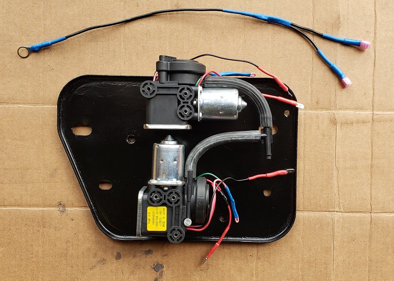

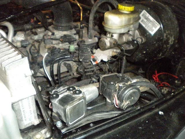

This is where I mounted my Rubicon compressors...

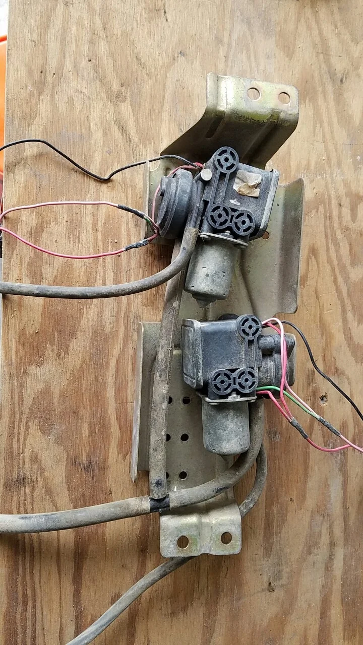

Took off the loom so I can see what I have. I don't see a red with stripe but I have pink and green together and two reds together. Am I still only using the black and reds or go behind the splices and only use black and the one red wire from pump? Sorry just trying to get it right.
I don't recall what I did with the extra non-black wires, I might have just twisted them together. The compressor itself only needs two wires to work. I'd ground the black wire and apply +12v to the other non-black wiring... they likely go to a common connection inside the pump. Whatever it takes to be able to turn the pump on & off.

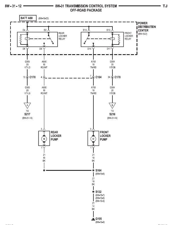

Here's the schematic for it out of the FSM, you can see each compressor only requires two wires to work, ground and +12 volt power...

Hi guys, I have a dilemma.
I’m trying to wire up these pumps red to 12v and black to ground. All I’m getting is a solenoid “click”
what’s the problem??

The compressor shuts itself off automatically when the pressure reaches 5 psi and turns itself back on if the pressure drops. There is absolutely no need to connect anything but 12v and ground to it.

I just looked at mine and I spliced the pink and green wire together off the pump and red goes to battery and black is ground
Tape off the pink/green wire. It doesn't get used. All you need is the red for power and black for ground. No relays are needed either.

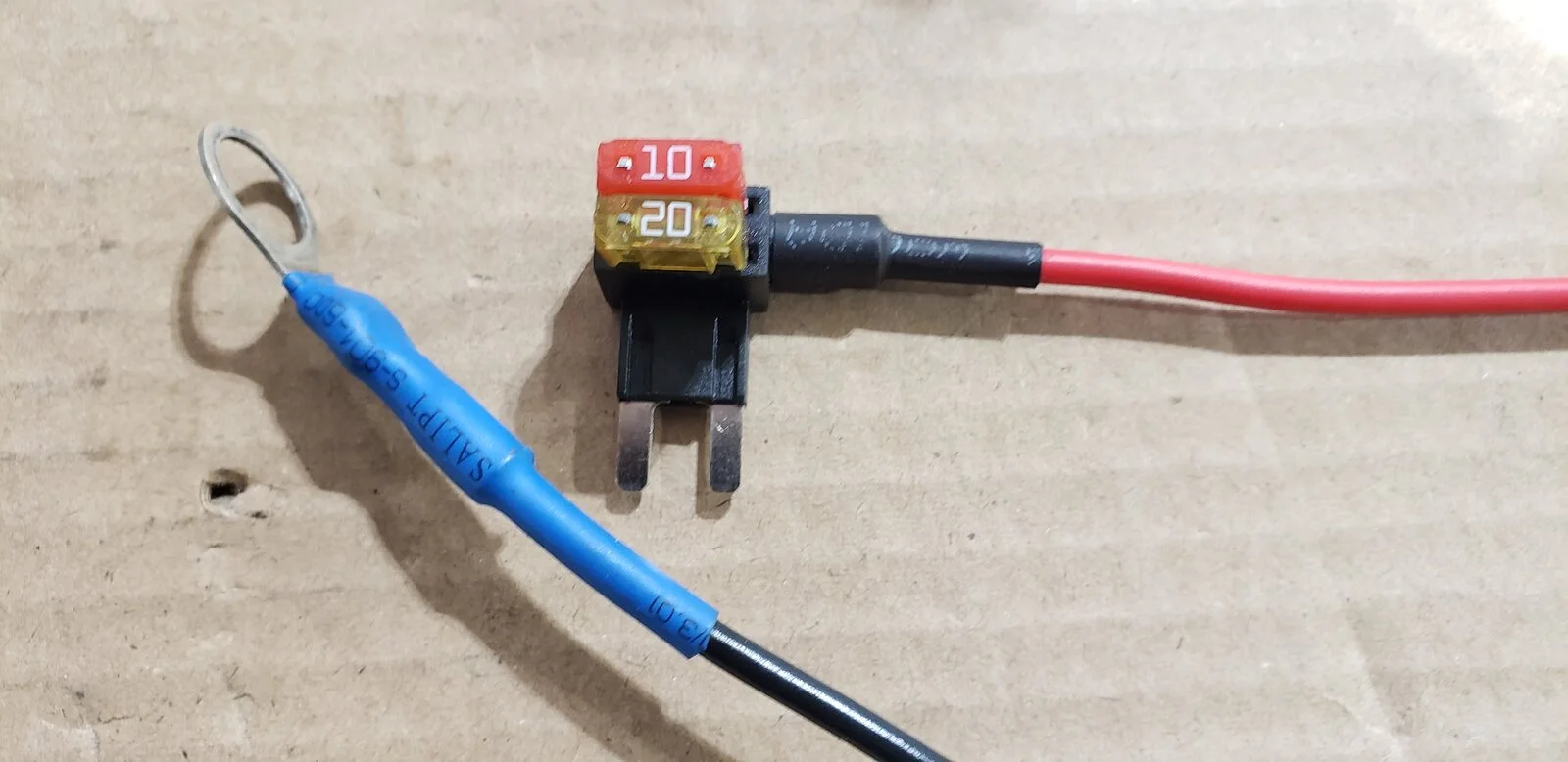

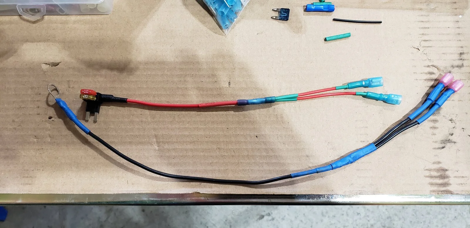

I make pigtails for all my installations, then tie into the fuse panel behind the glovebox.

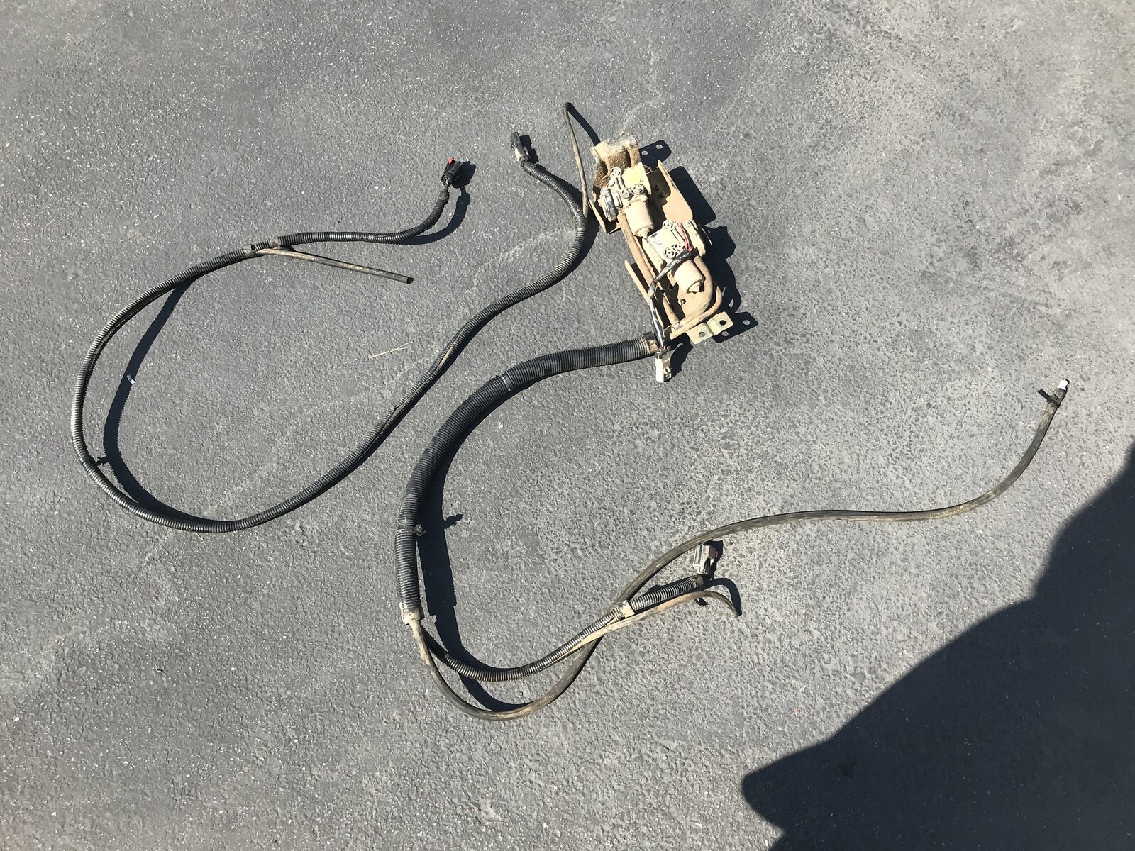

I just bought myself some rubicon axles also to swap in my 05 LJ. I was so lost when I didn’t see the connect for the pumps but this clears things up. Looks like I can make my own switch connections to power the pumps.
I only got the connections for the axle lock switch with the vacuum hoses.

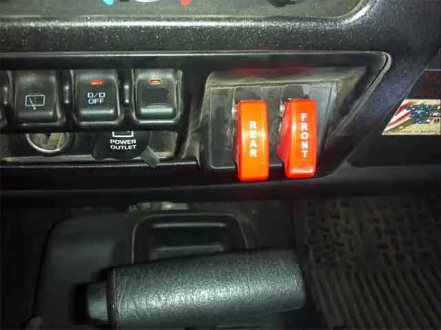

No need for any of the Rubicon wiring. Wire each compressor like you would a small 12 volt bulb, use nothing larger than a 5 amp fuse for each.

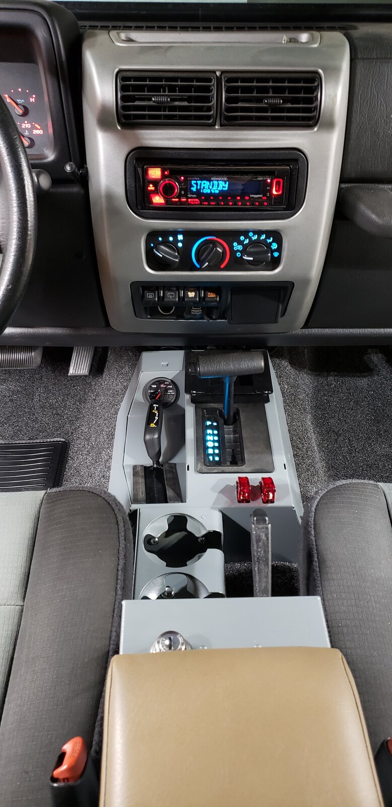

Two simple on-off switches are all you need, this is where I placed mine.
