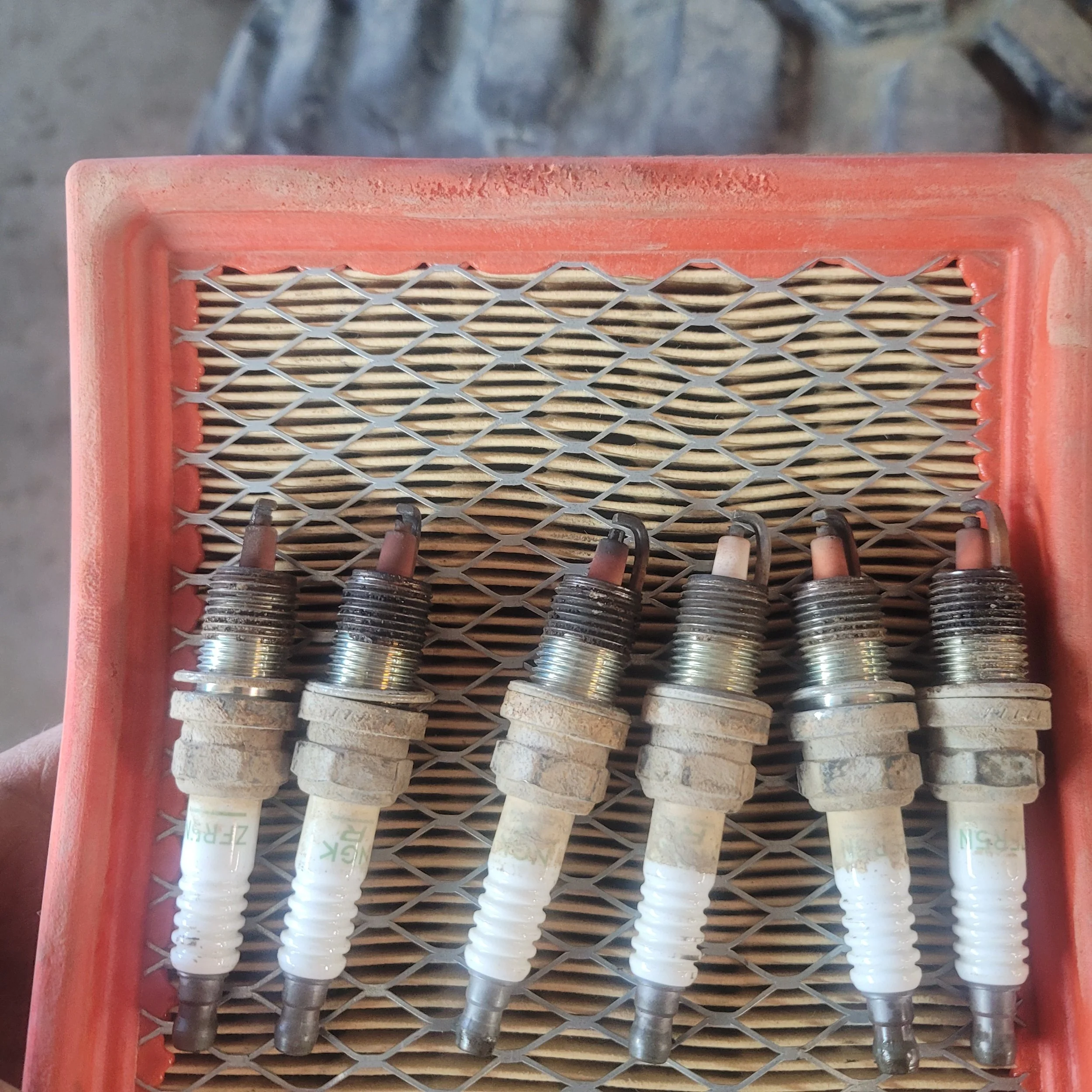

Ok so installed new bosch fuel pump, air filter, and spark plugs. Haven't drove yet working on new battery mount. got a plan for tomorrow to get it out under load in 2wd/4wd hi and see if anything has changed. Compression ck was within spec 140-160 all cylinders. Only concern is 1 spark plug 3rd from the right. Should the color of this point me in some other direction? Injector?
That would be about the only reason for it to look so different.
Actually all of the ones in my 06 look like it, not the others when I change them.
