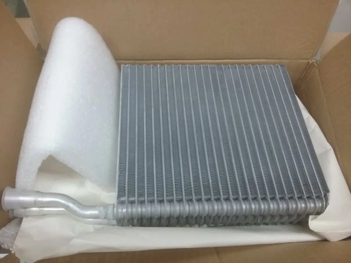

I went with what @Mr. Bills is running. My AC evaporator leaks, so I figured I might as well replace the heater core while I'm in there.
Shipping only took a few days, and they seemed to be packaged well.

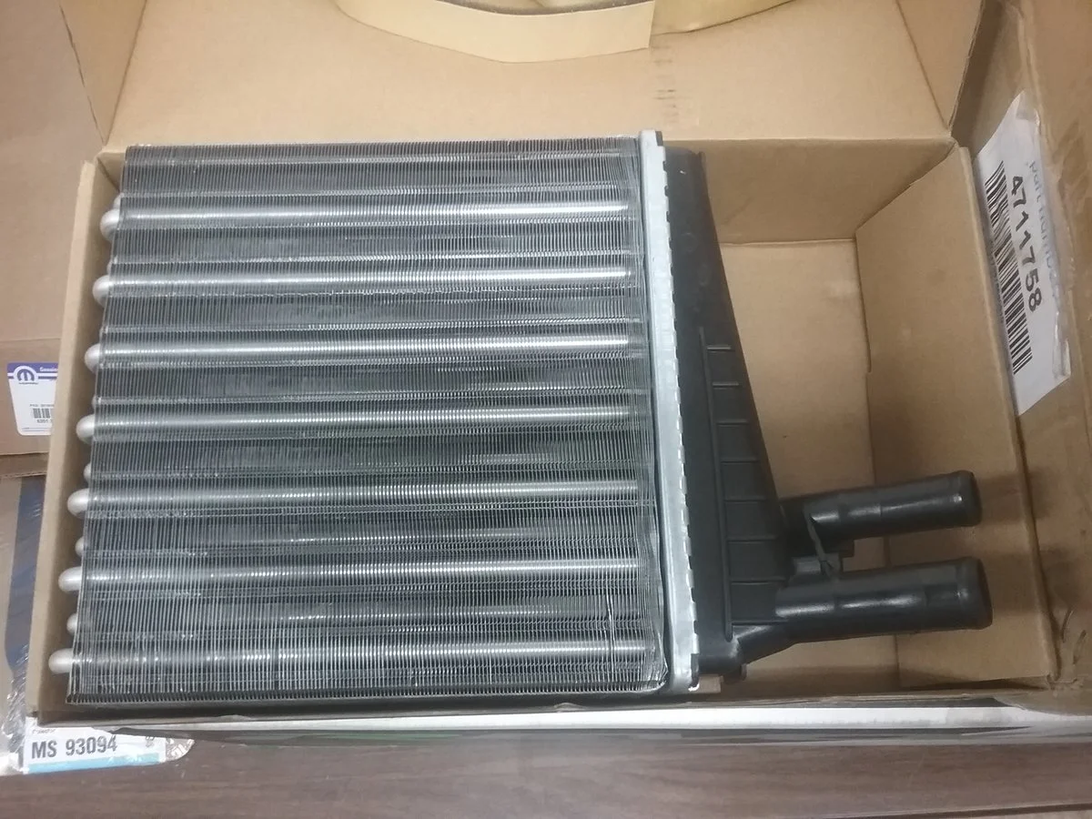

Dealers should still stock part number 05073180AB which is good for 2002-2006.
Part Number: 05073180AB
Supersession(s): 05073180AA; 05161657AA; 5073180AB
