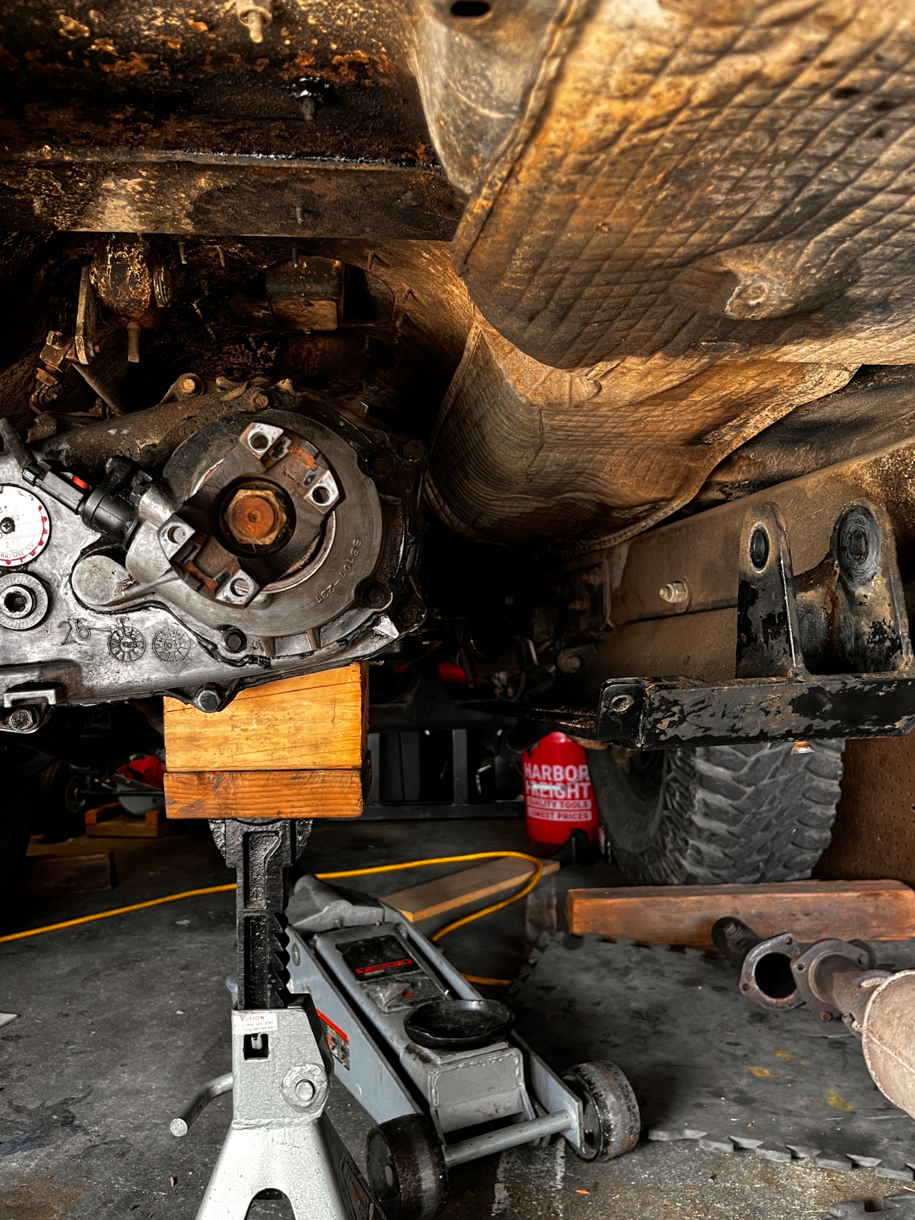

Made a little progress today, just as i suspected, exhaust drop is a challenge. The t-case needs to be removed, to remove exhaust out in one piece.
Mentioned to shop about fixing seal with t-case in place, no waisting your time he said. He wants it to fix right.
I better get a jack under tranny before I go to bed. I guess there was an earthquake today when I was wrestling with the exhaust. I did not feel it, wife did.

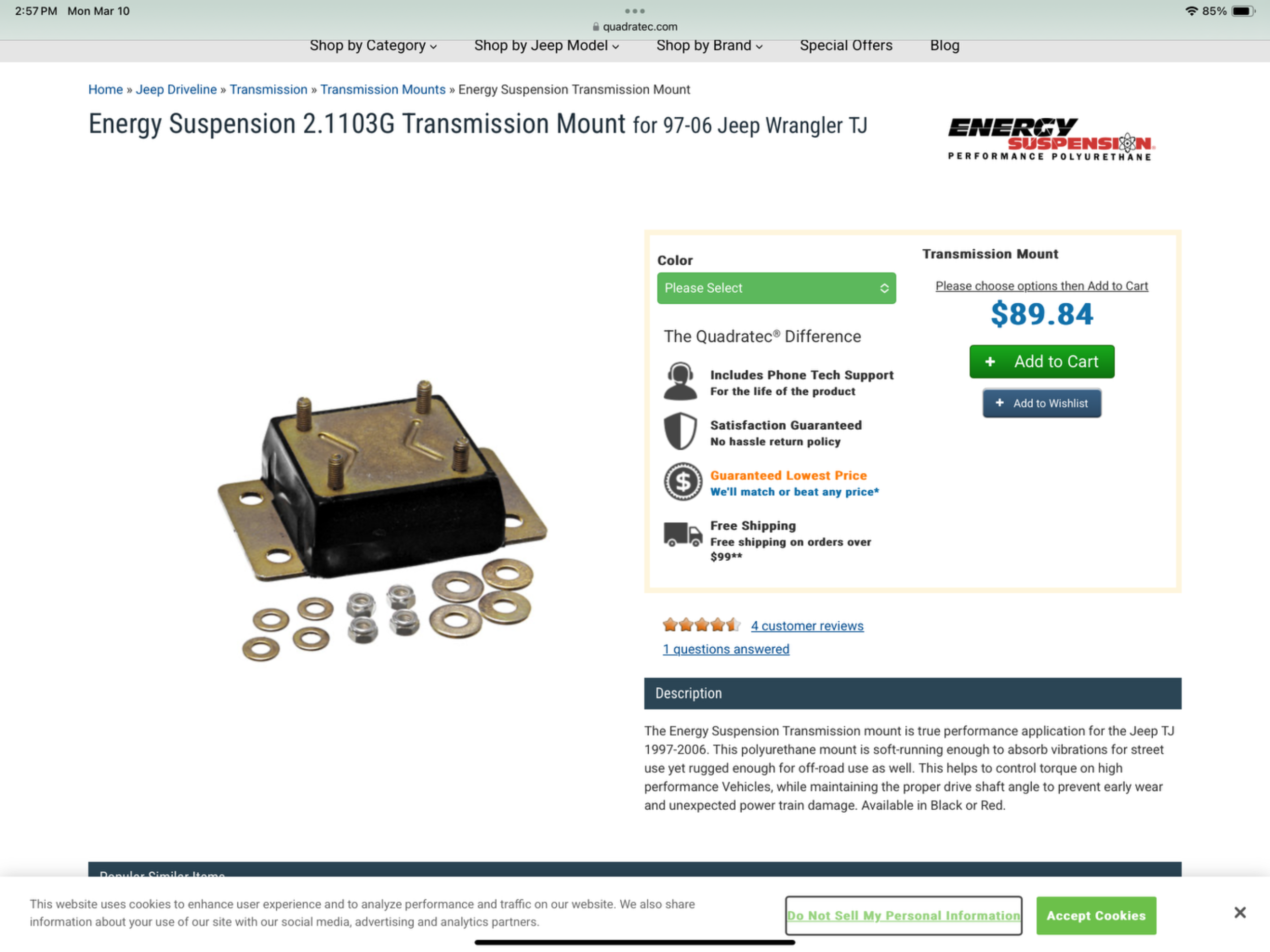

Most folks that used the polyurethane style transmission mounts or motor mounts end up replacing them due to excessive vibrations. You're better off to get a stock rubber style mount instead.

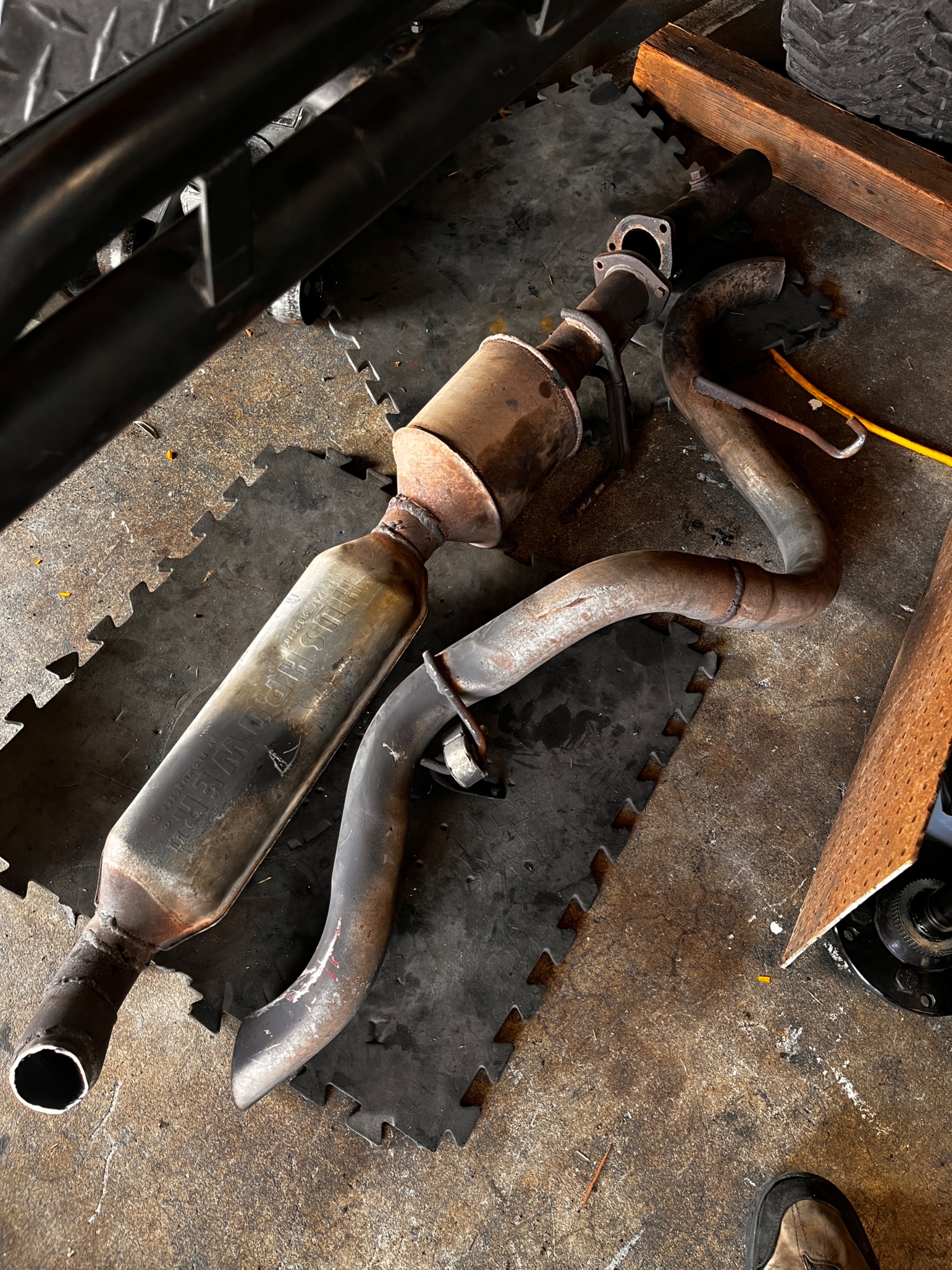

I got back at it today, finally got a-arm out and long arm. I decided to cut tail pipe off , pulled exhaust to get clearance to remove a-arm bolt. Uniball soaking in kroil, hopefully get it out tomorrow. Rear axle is back, feels as if there is no pinion bearing preload, turns to easy, I have mentioned anything to him yet.

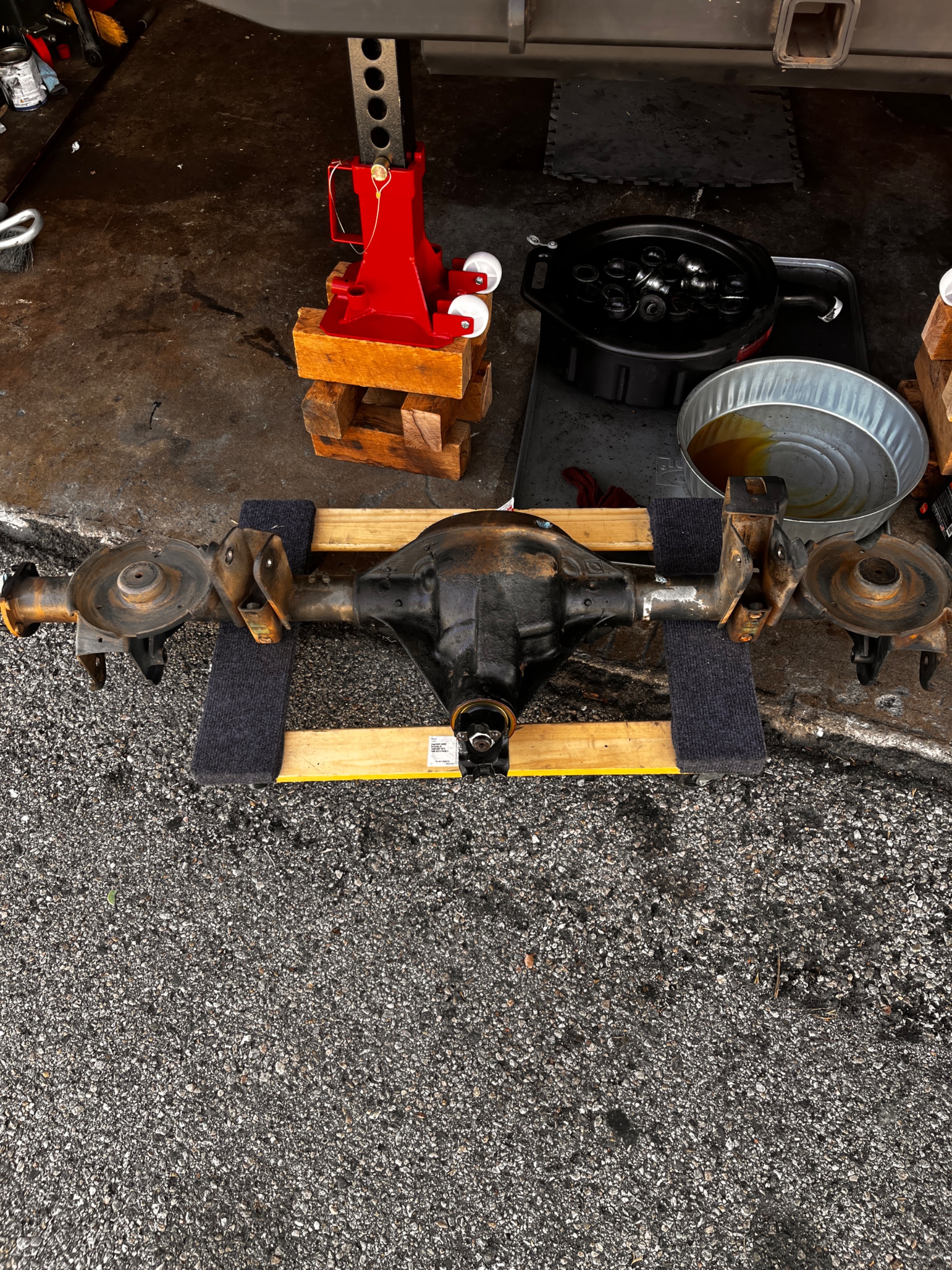

IMG_7819.jpegIMG_7829.jpegIMG_7836.jpegIMG_4107.pngIMG_4108.pngIMG_7832.jpegIMG_4110.pngIMG_7830.jpegIMG_7581.jpeg

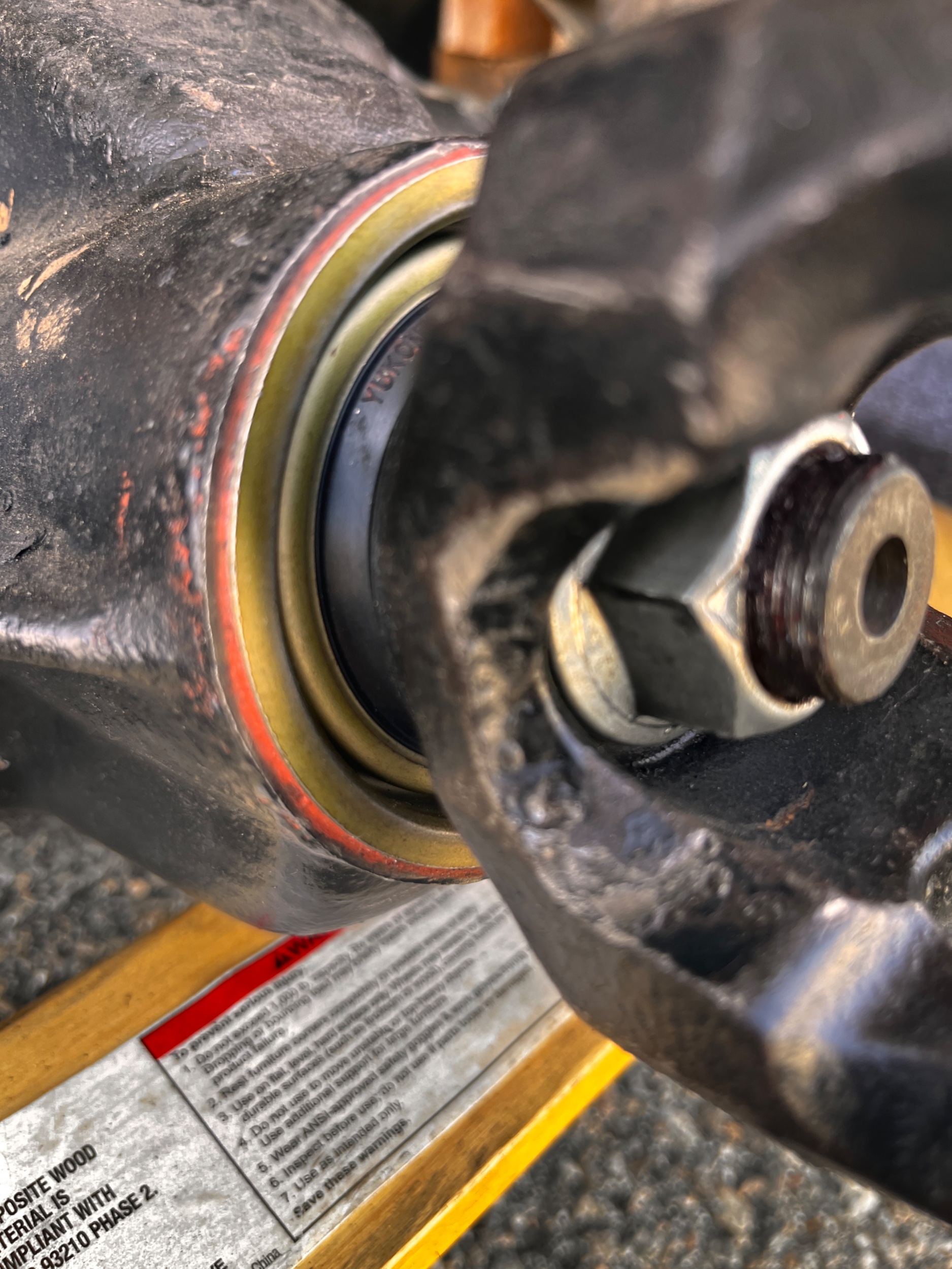

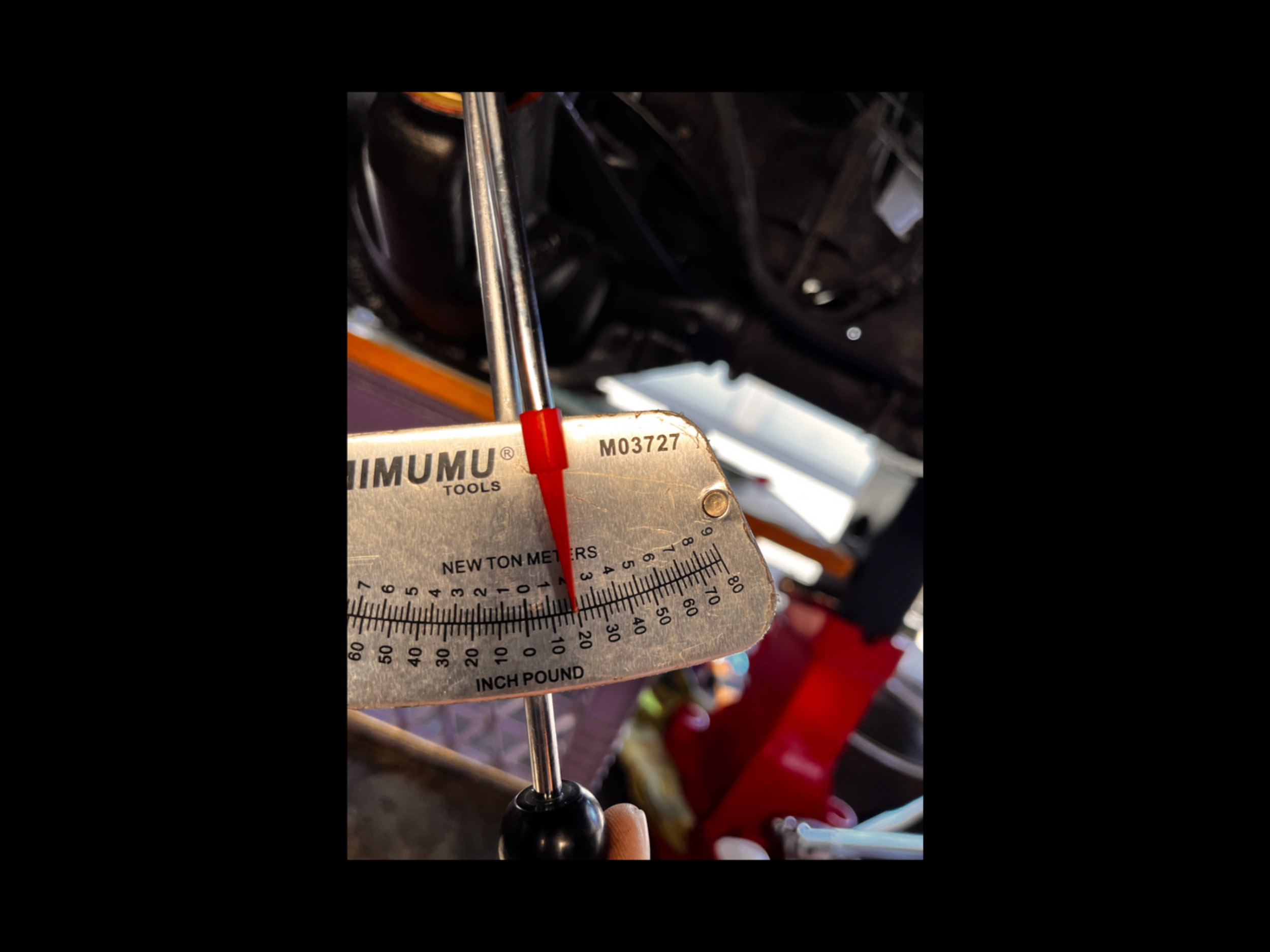

Catch-up photos. I managed to remove snap ring for uni-ball. More kroil soaking tonight, not sure if my little press will get it out. Clean up passenger longarm and shock removed paint over spray on shaft and blue parts. May try a little navel jelly on shock body, might clean up, think its mild stainless steel. Now to diff, first photo of pinion nut with white marks and wrench on yoke is my work, rotation torque in spec for fresh bearings, near 20 inch pounds. Second photo his work, with lock tight and rotation torque 2 inch pounds ? Backlash good, which I know was bad, why he messed with pinion, I don't know. Pinion thread looks trashed, thus why locktite?, not sure if I should try to torque more? I do not feel comfortable installing this as is, he wants $300.00 for this?………..NOT!
Not sure how to approach this guy. I am glad that I didn’t remove axle seals, get it dipped and put on a jig my butt. So…to fix correct? New ring and pinion set?
Have not run a pattern yet.

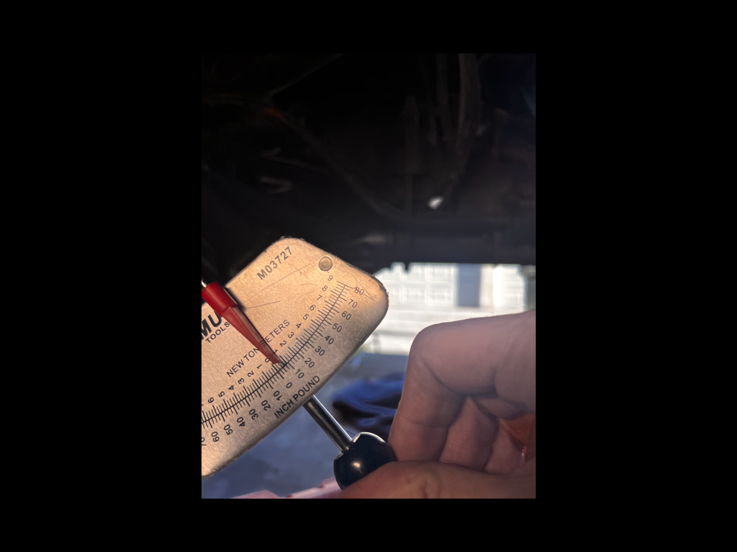

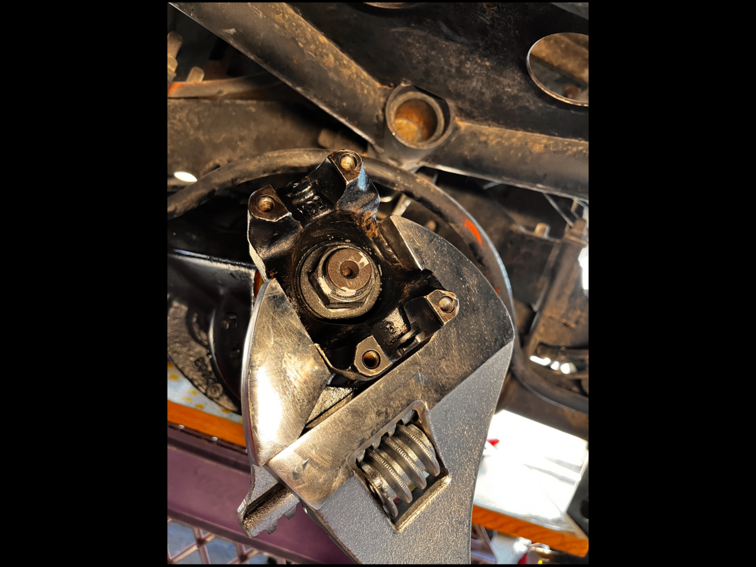

Had a chat with mechanic, good as it gets with pinion thread condition, it has been reworked to many times, this the last. Marching on with what i have.

Do you think it will be ok with current preload. For a while? I was looking at 8.8 complete at east coast, they recommend a 489. 8.8 being phased out.

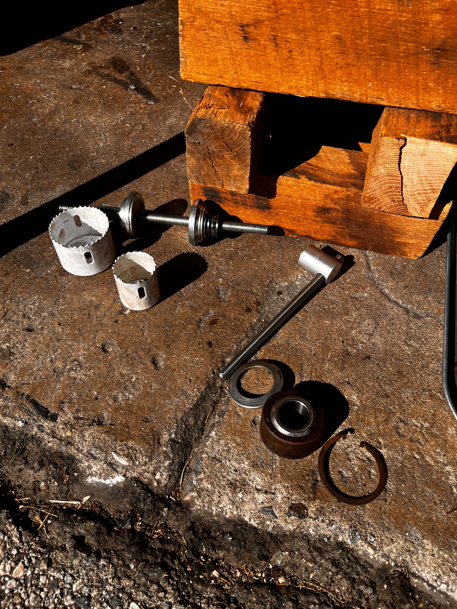

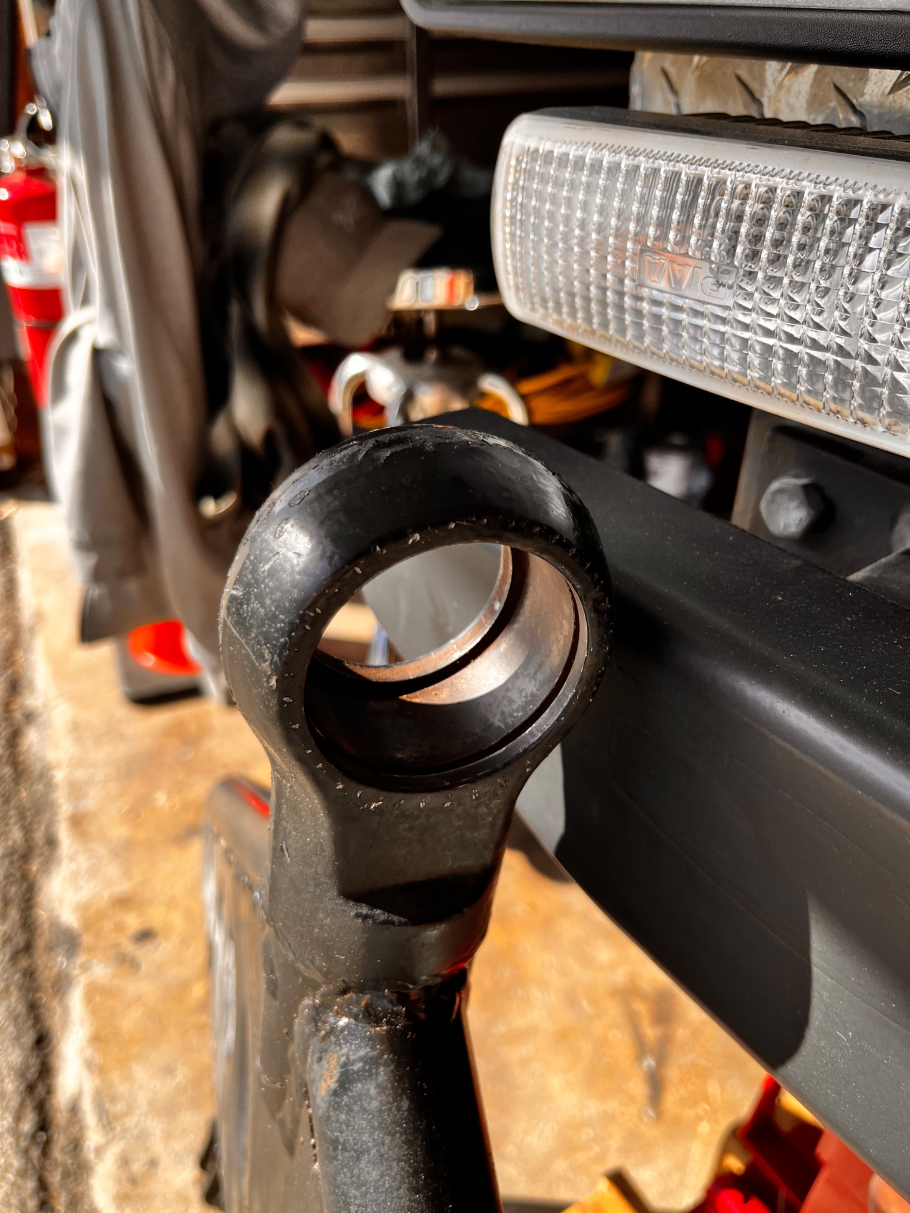

Anyhow I got the uni-ball out of a-arm today so far.
I didn’t think my little bicycle headset tool would work, it did, trashing two hole saws, used heat a gun, hammering and squirting PB blaster.Not sure what to do as far as finish, bead blast, powder coat? I haven’t gotten a quote for powder coat in while.

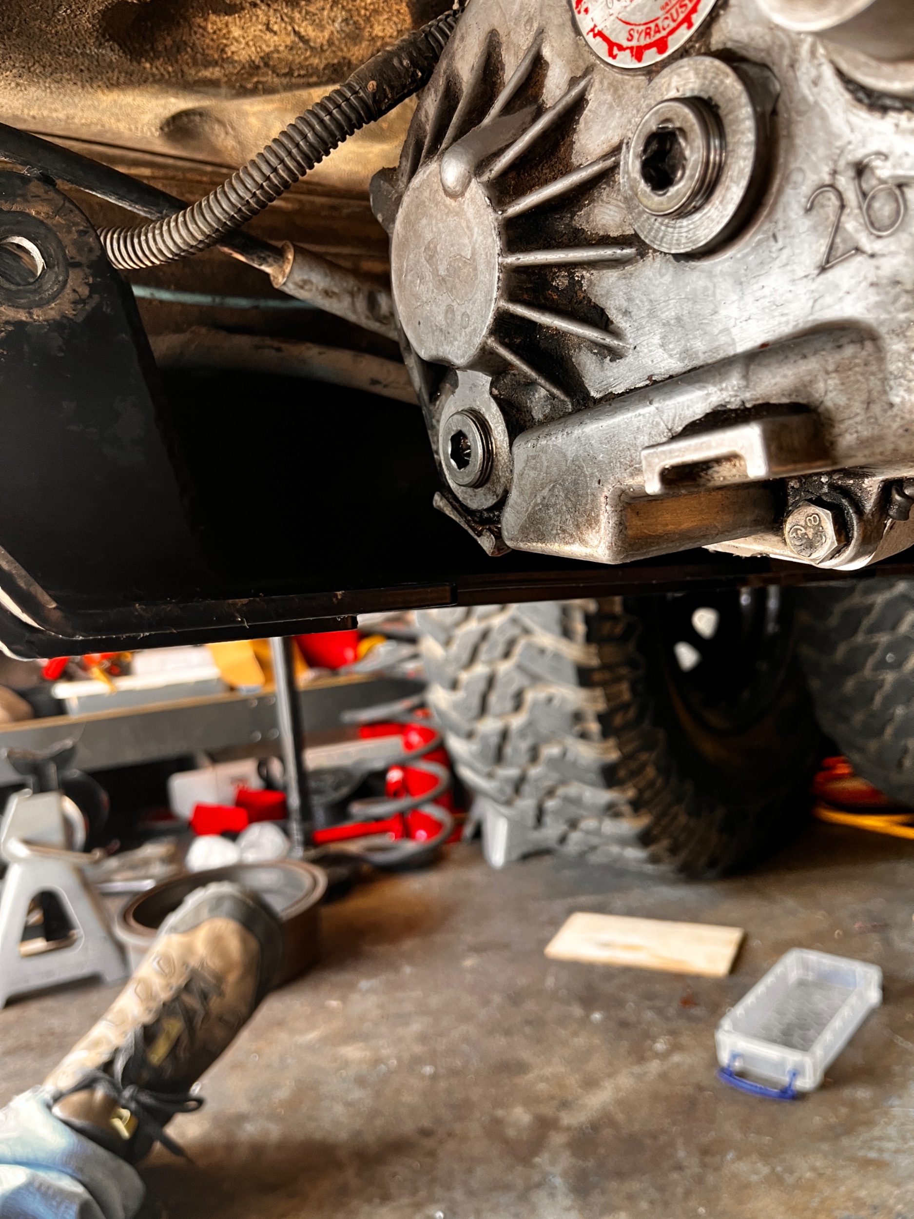

Next major hurdle, removing T-case, got more room now for that op.
I'm a little worried about that preload but can't tell you if it'll survive or not. I guess push comes to shove here are your options as I see them:
Not sure about powder coating it since, think you'd have clearance issues with the parts once coated.
View attachment 601702View attachment 601703
A half moon wrench really helps to get at some of the nuts for the t-case. Have you looked at a cable shifter for your t-case while you've got everything apart?

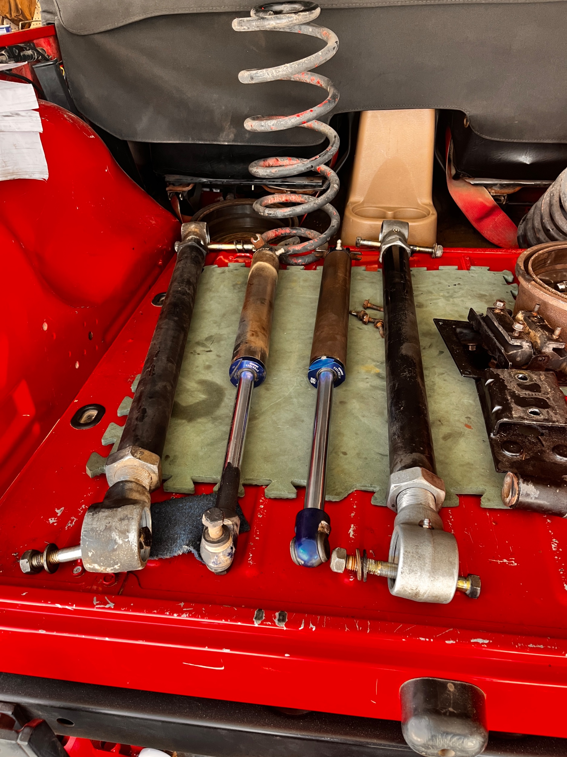

I will just paint with a-arm, truss, long arms with rustoleum, get springs blasted and powder paint. Shock bodies, not sure yet, just paint I guess. I wish I measured shock length at ride height. I am not sure, but it doesn’t take too much force to close. I wondering if I should go buy new set now as well. Another ouch.
I did not get a good photo of t-case linkage, have to go back out, but its mechanical linkage not cable.
Read up on how to properly size a shock. There is more than one thread of the subject.

Just going paint shock bodies they are fine for now.
I looked up half moon wrench, I do not recall ever seeing one, I see how it would help. Think those are 9/16” nuts on t-case.
