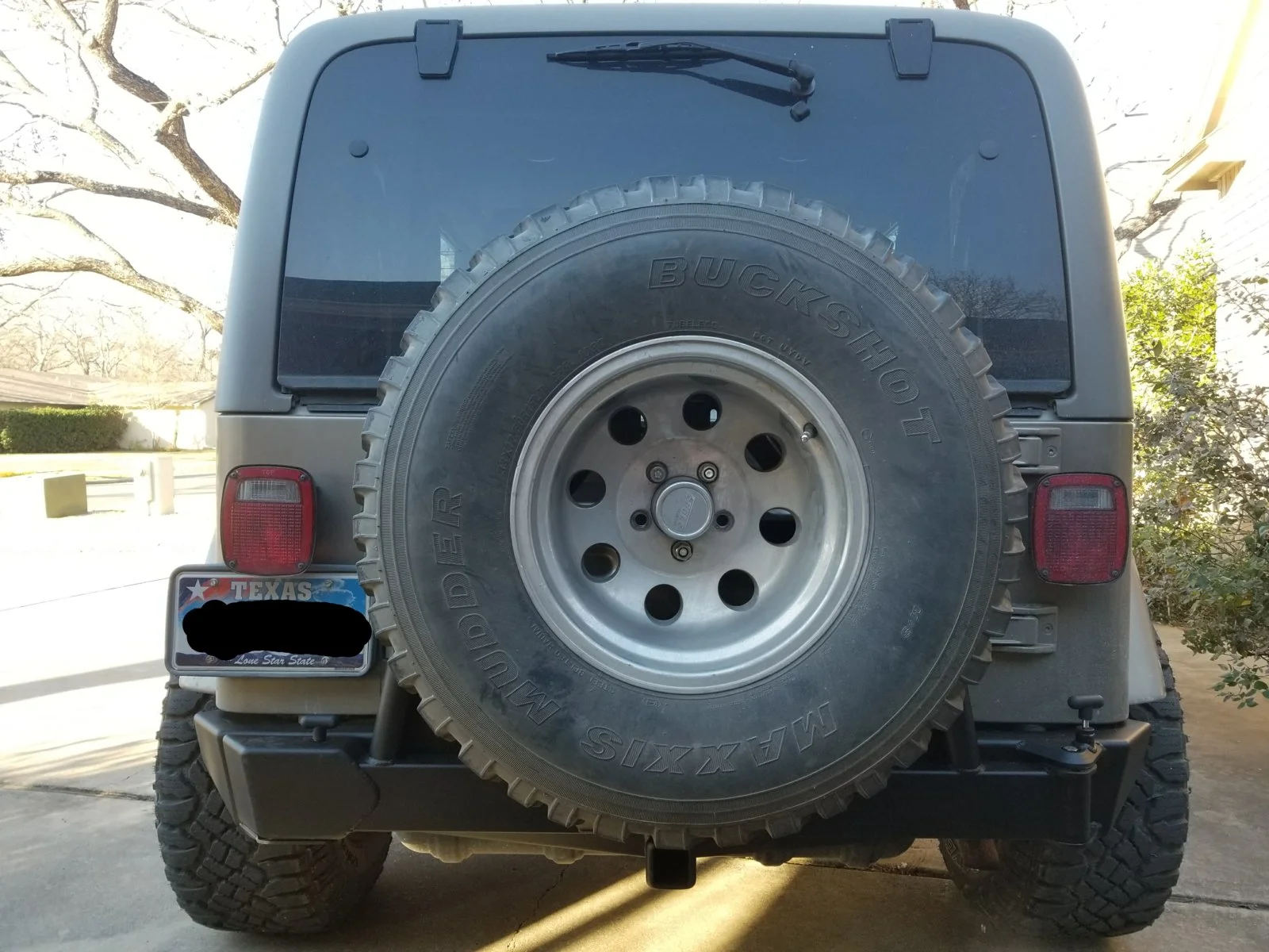

Why did you covered just one of your license plates?
Thanks
I did that to see how observant people are! Good eye my man you passed my little test.
Those are just the pics that I had honestly. I was going to cover all plates but already had that pic posted on here so it really didn't matter.

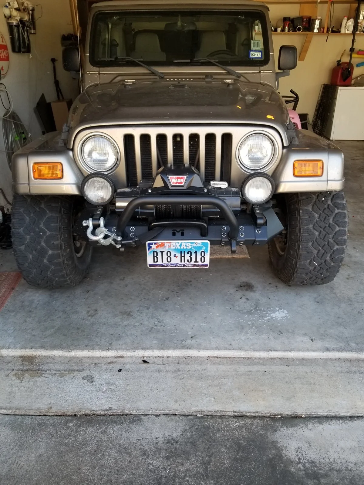

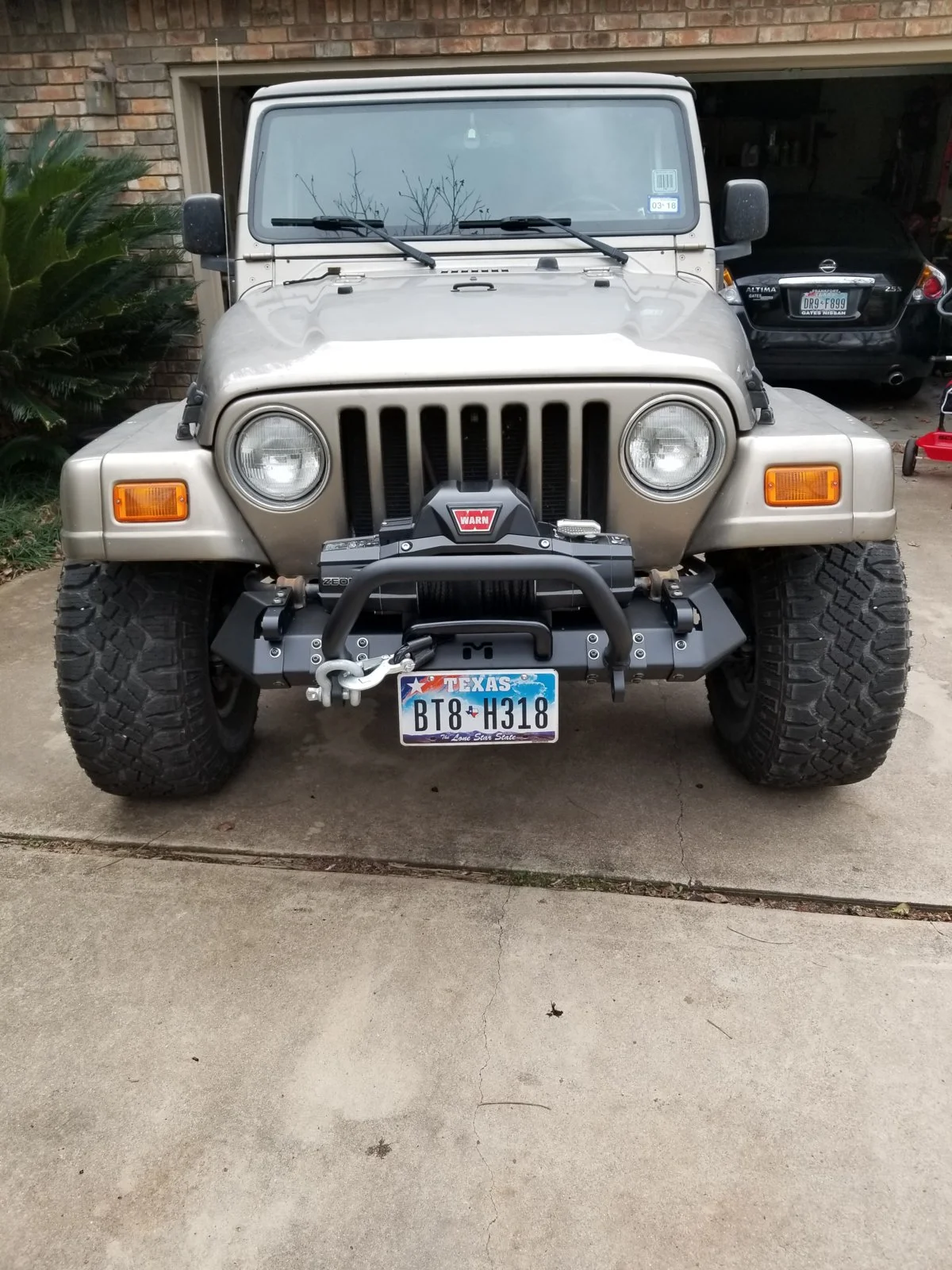

I would also like to get my factory fogs back on. Need to do some drilling before the install. Need some opinions though.
Would this look work or do they get in the way of the headlights too much?
Or is it just way too much?
I may end up seeing if MC can give me different endcaps.
Possibly these?
https://www.metalcloak.com/52-Hi-Crawler-Caps-CJ-YJ-TJ-LJ-p/2121.htm
These endcaps should allow me to mount the lights slightly lower and a few inches away from the winch.

"Close Encounters..." LOL Remember the scene of the space ship coming up behind Richard Dreyfuss in the truck, and he waves them by? That's what your light set-up reminds me of! :) You can star in a sequel..."Close Encounters of the Jeep Kind"... :D All kidding aside, I think it looks fine. It's whatever you want...and your wife, of course, if you've got that contract going! ;)

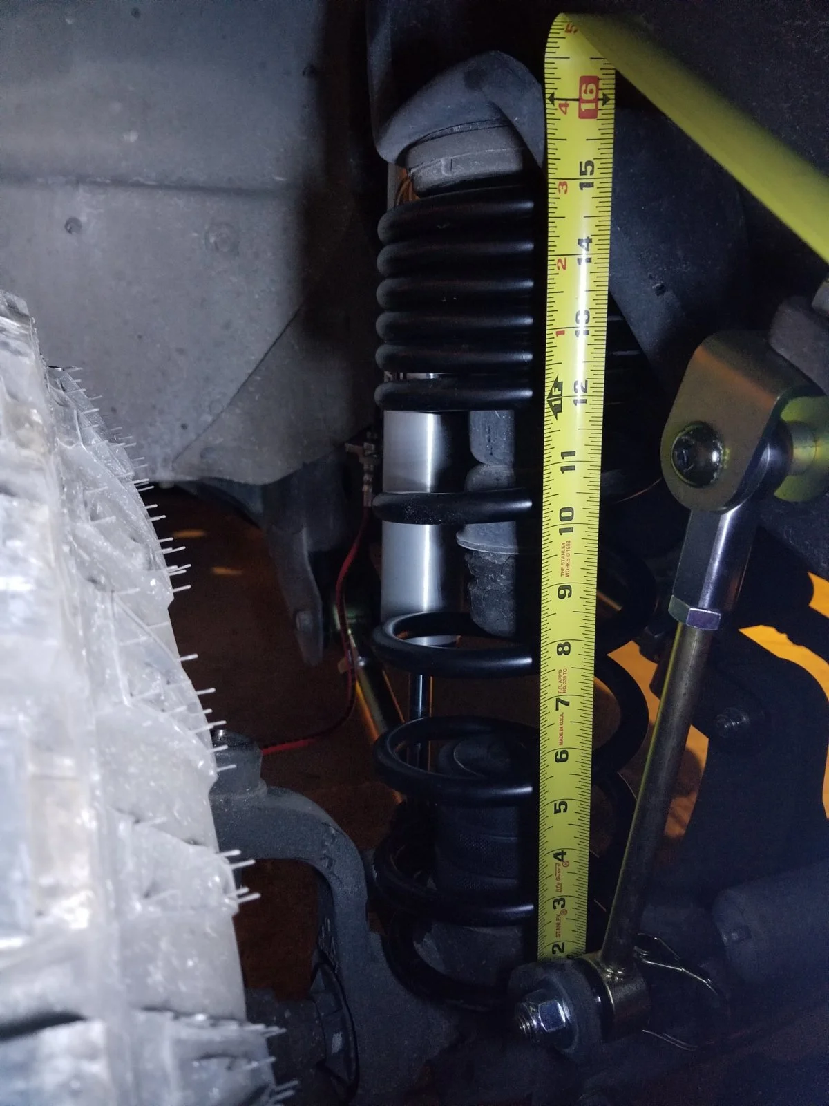

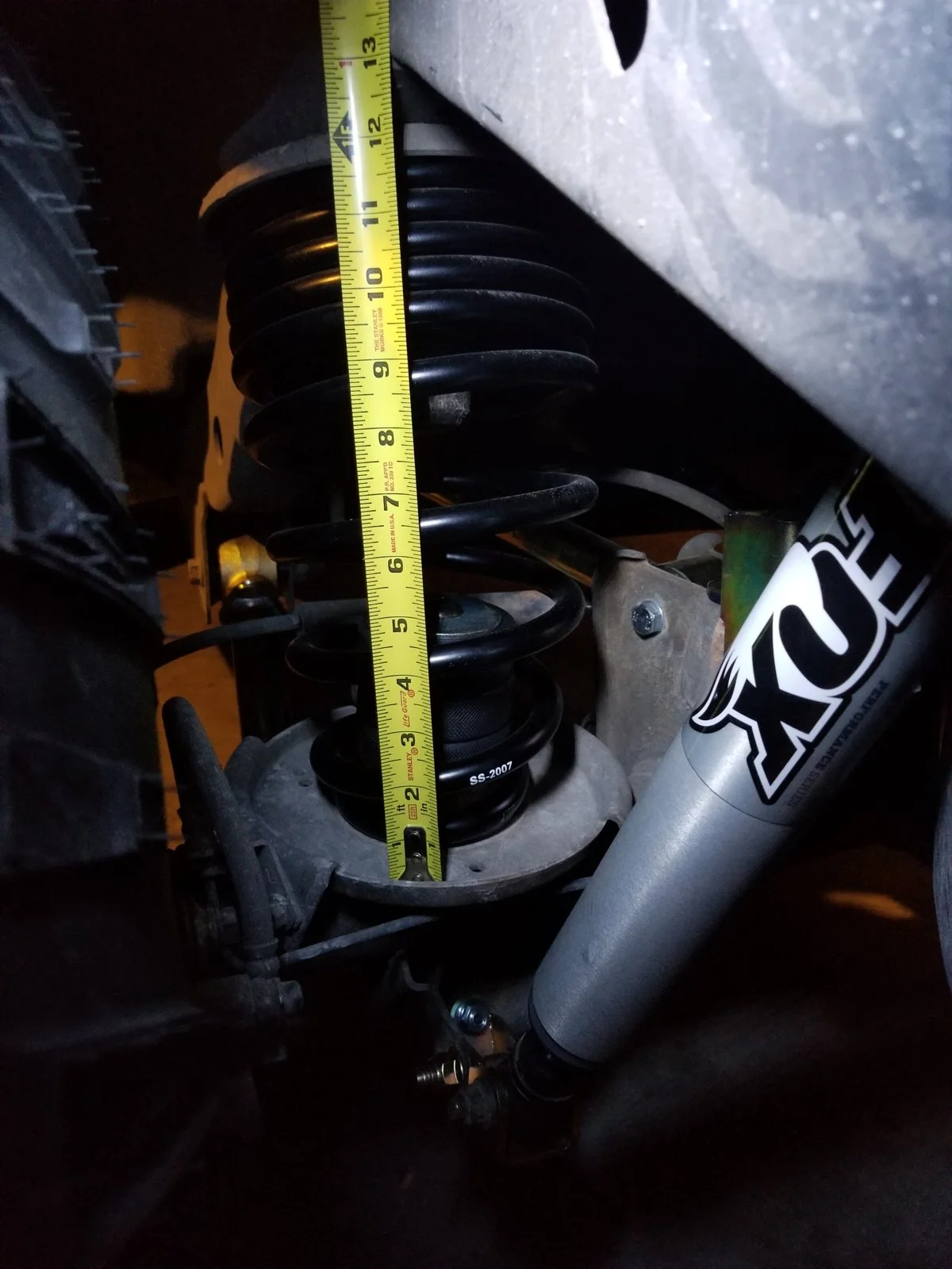

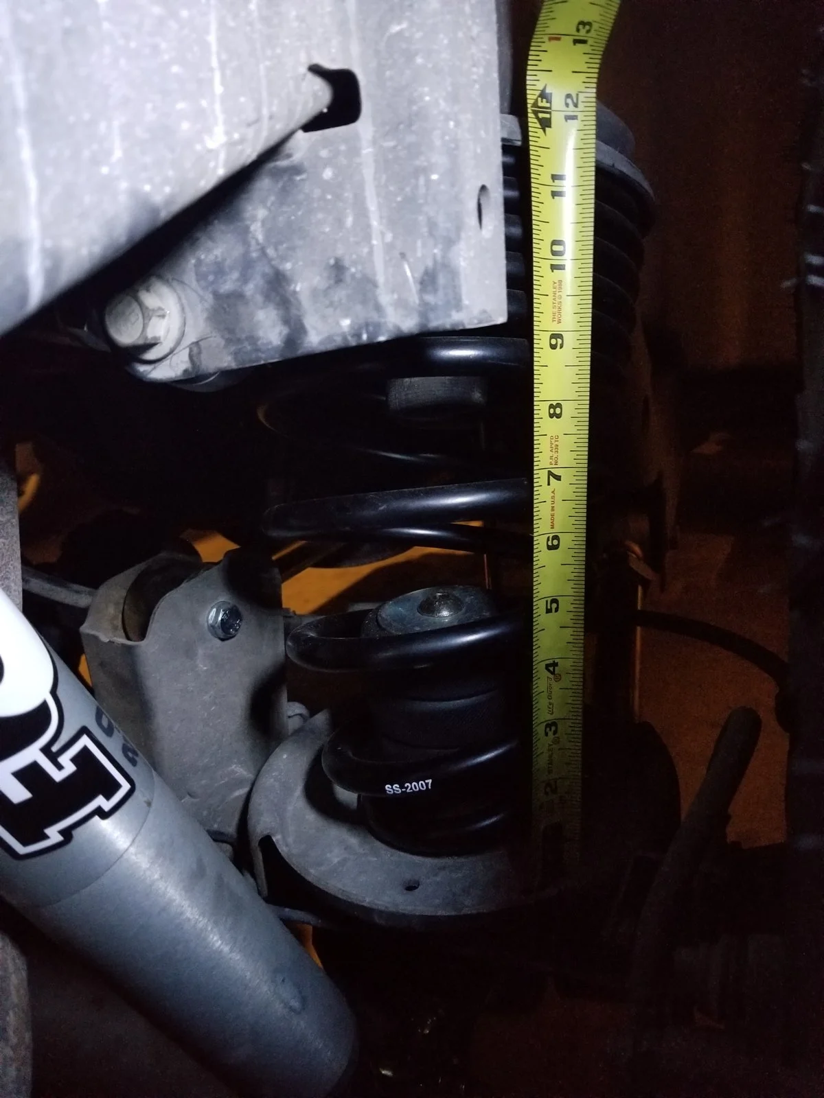

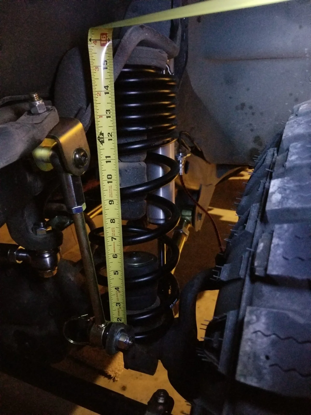

Everything is installed as of this past Saturday. The rear shocks were boxed wrong so they are getting replaced. Rear shocks are for a 4" or 6" lift. Everything else seems to be great.
Did some more measurements last night and both front springs measure right at 3 1/4" above stock. The rear measures 3 3/4" above stock. I think it sits pretty good now.
These pics are from later that night of the install.
Front passenger
Front driver
Rear driver
Rear passenger

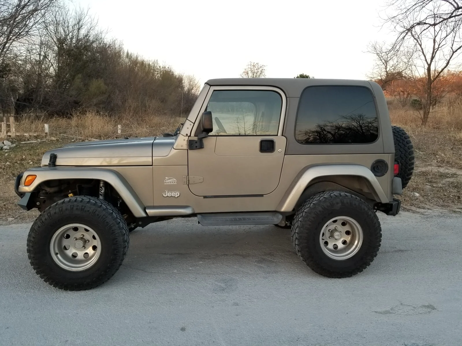

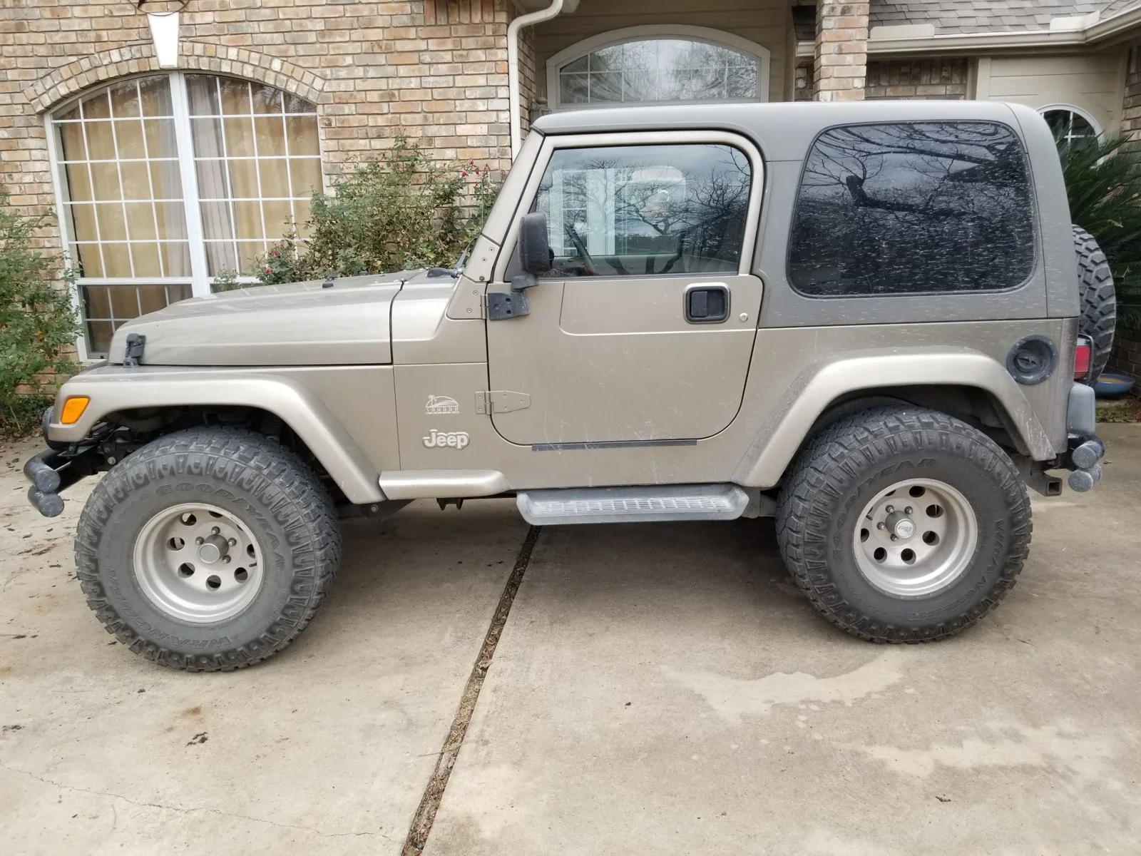

Before side view
I believe this was a 1.5" lift with 33s
New 3.5" lift with 33s
How do you like the ride?
I think it rides pretty well considering. The only issue is the rear shocks being too long. The rear end bottoms out very quick with right at 1" (up travel?) left in the shock. So once the correct shocks are installed It should be a lot better. Just having to baby the rear end over speed bumps and large dips in the road.

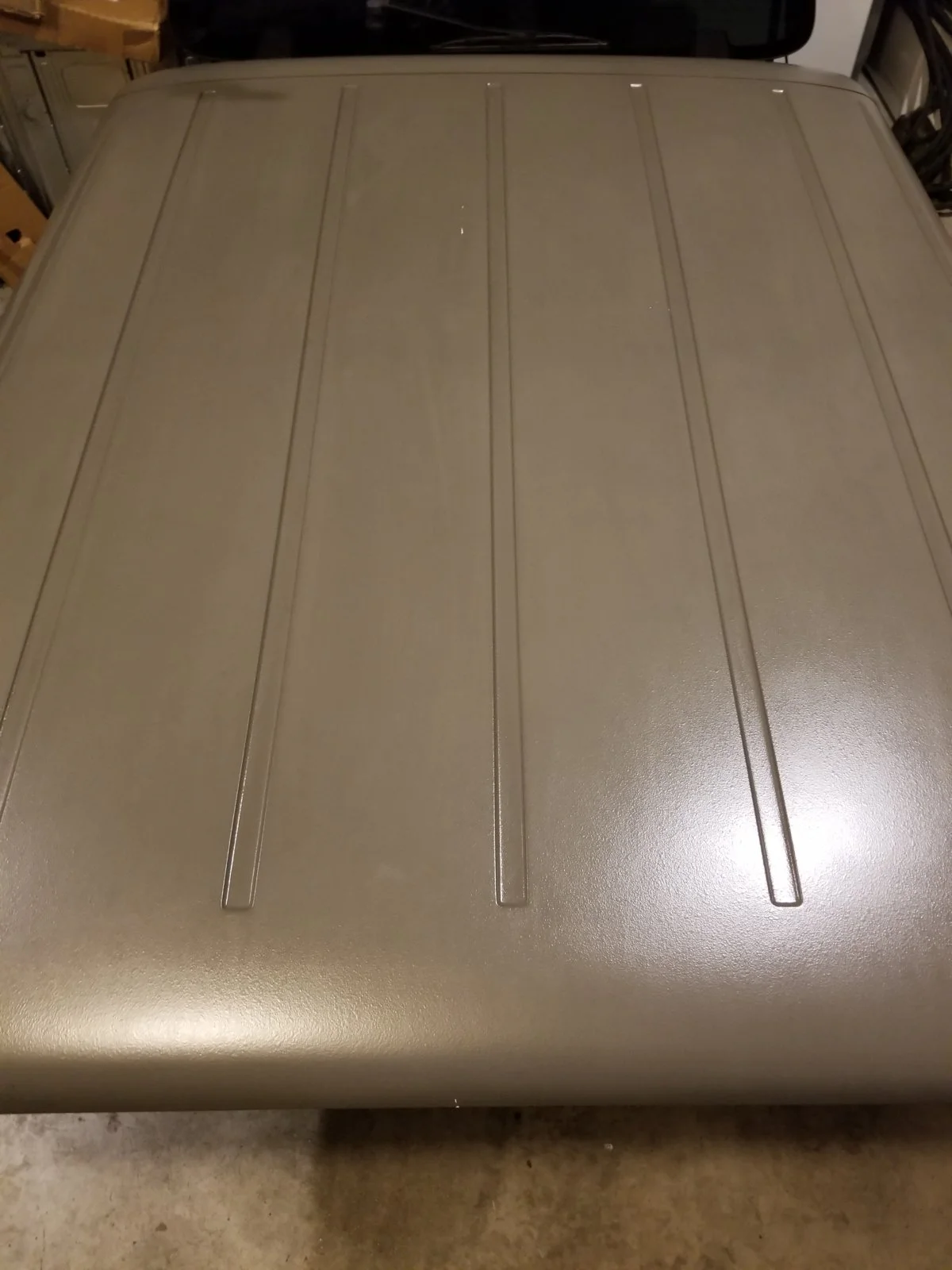

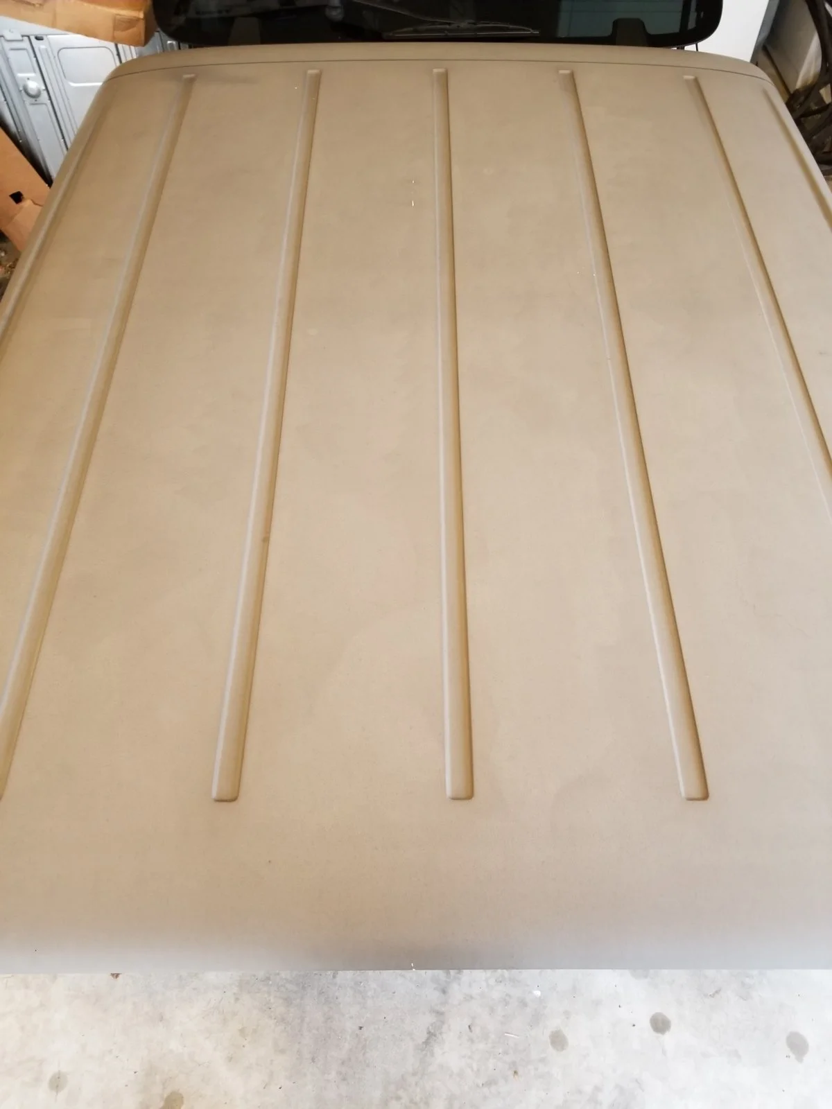

Used penetrol on the hard top today.
Posted this in the "what did you do to your TJ today" thread as well.
Should have posted here 1st and linked it in the other thread. Sorry guys!
Easier for me to check back here to see how long this penetrol holds up.
Before
After

I love penetrol :D, nice work!

I think they look fine. I’ll know better when I see them up close and personal
