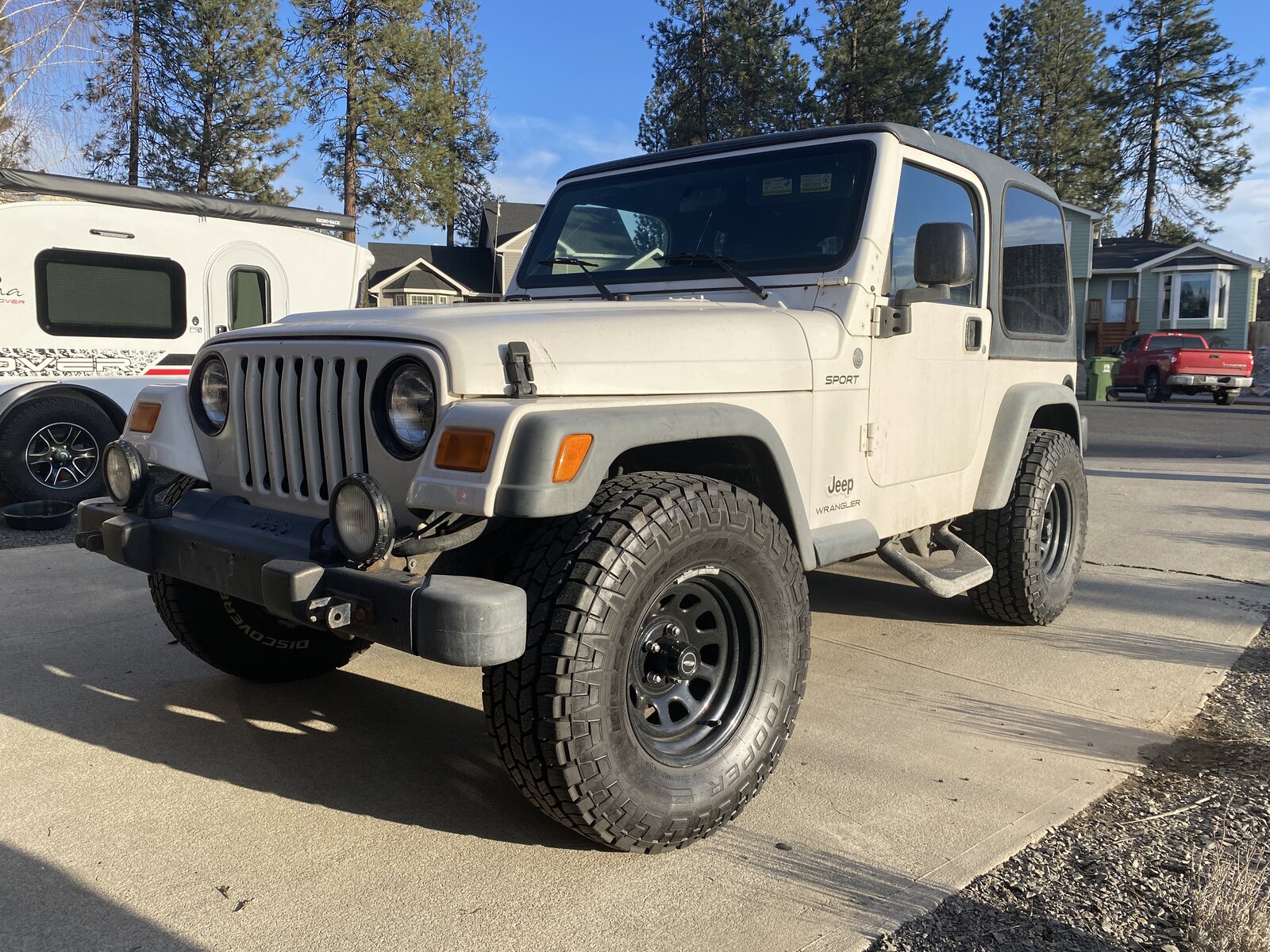

@JMT’s twins are turning 16 in September and I’ve been looking for a TJ in the PNW. They go like hot cakes as anyone who has liked lately knows. Finding something unmolested is even tougher, and the good ones go in hours. I was in line for several and never even got a look. Finally got first in line on a 2004 Stone White, 4.0, 162,000 miles, 42rle, stock except 32’s, hardtop, and a little rough. It had huge potential so I bought it for them as a surprise.
They were blown away. Day 1 sitting at the new home. Little does she know what we have planned.

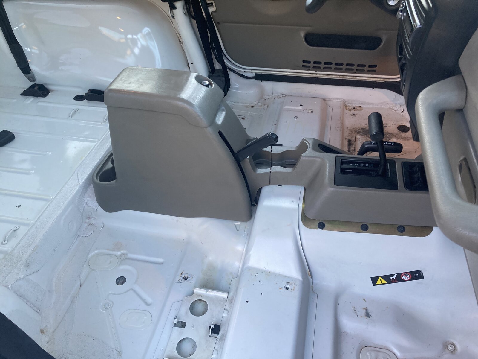

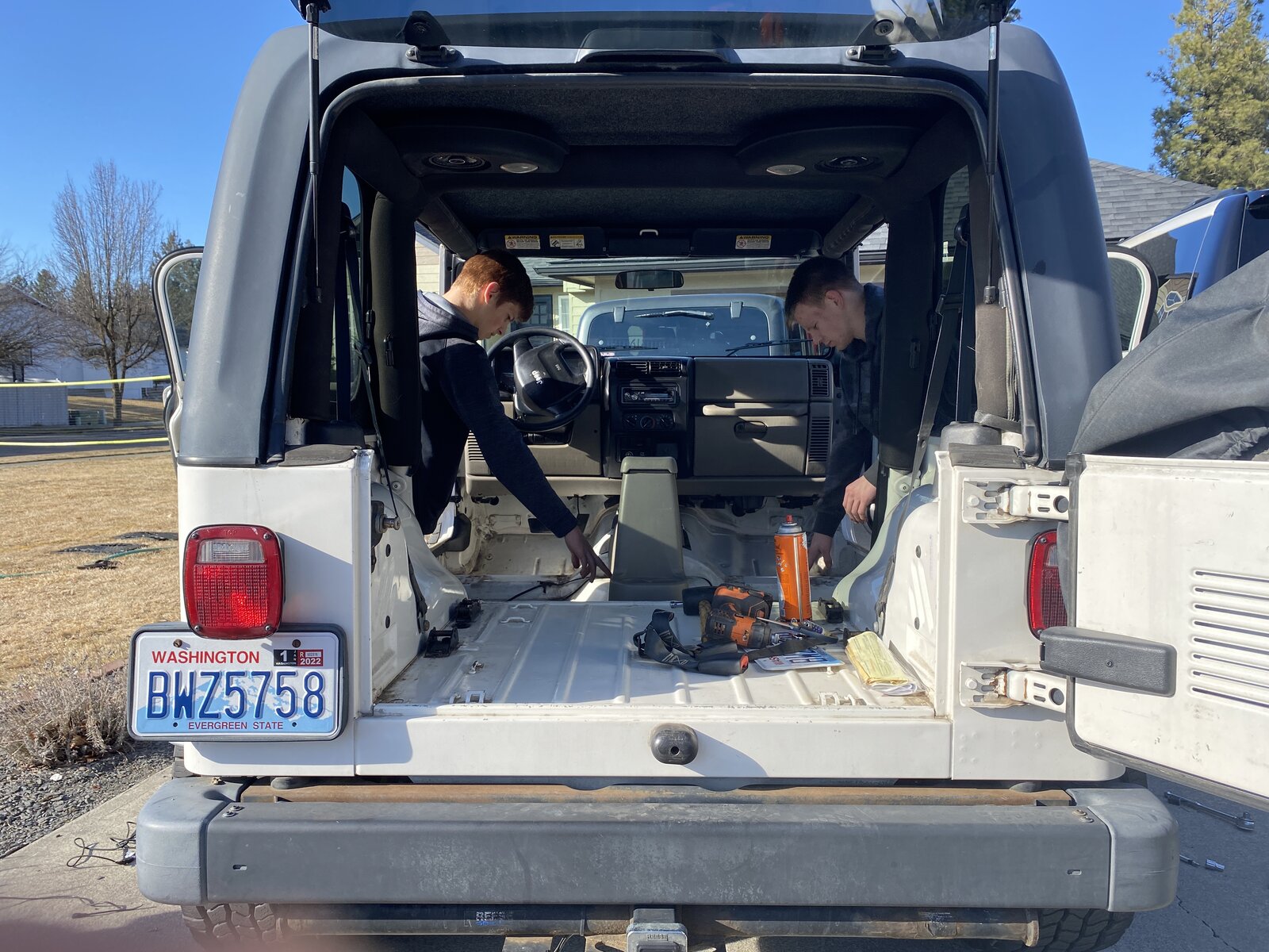

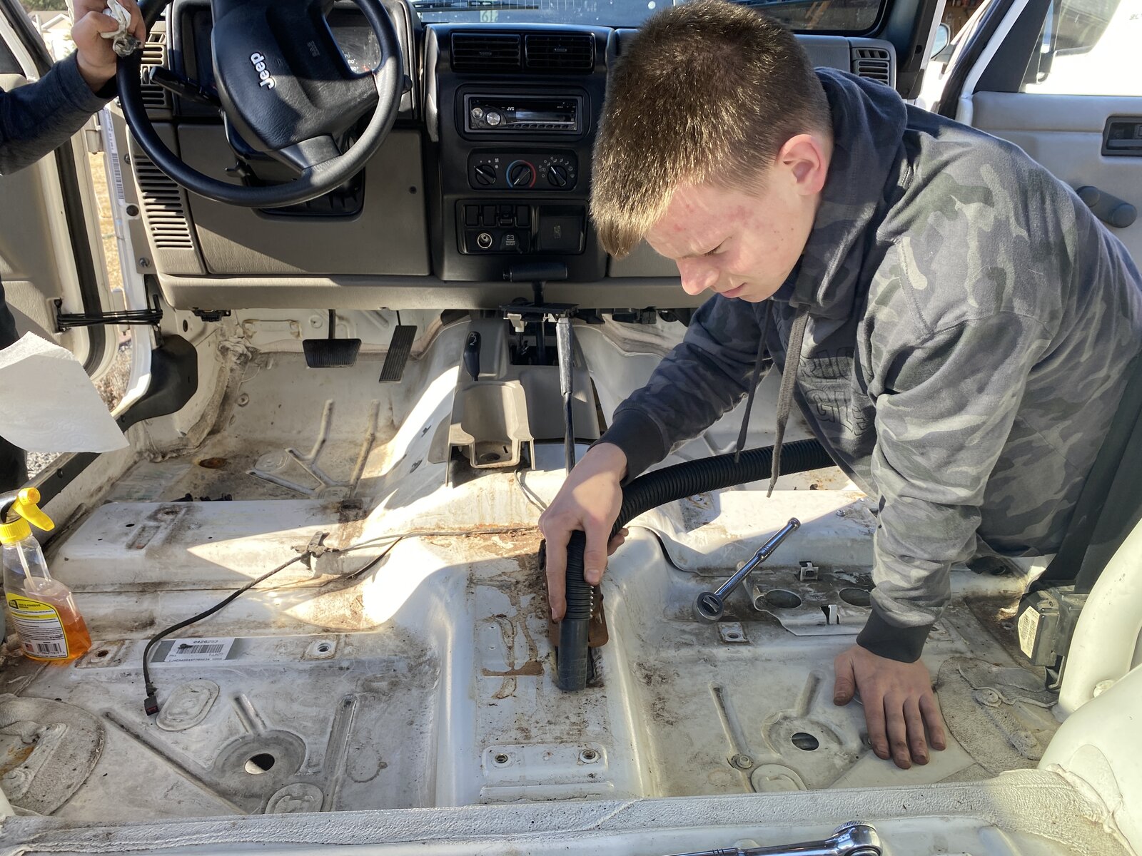

They got to work quick. Removed the stupid step that would get creamed on a trail, removed seats, carpet, console, the whole 9 yards and started cleaning. Carpets took Bissel cleaning detergent, power wash, and vacuum. People are so dirty. Neglect had set in. Looks amazing now, considering. The plan now is to figure out a plan. What do we want to do with this Jeep?

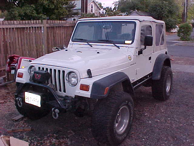

@Alex01, as you can see, is way above the curve and ahead of the game. You should check out his build if you want to learn something. He’s been at this a long time. As implied, we scrapped all those wonderful build plans and decided to basically move my lift over incrementally, while I did the unthinkable and went to 4” Currie. Those who know me, know this is a step I’ve been pushing back for awhile, but this thread is not about me. This is about two 15 1/2 year olds who got a Jeep.

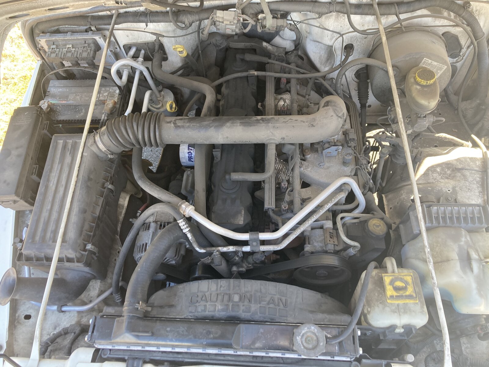

We have a lot to do. Well, they do. I made them research cleaning the engine, and they followed to a T the instructions from another forum post. People are so neglectful of these TJ’s. It turned out nicer than mine. 🤣
Before:
After:

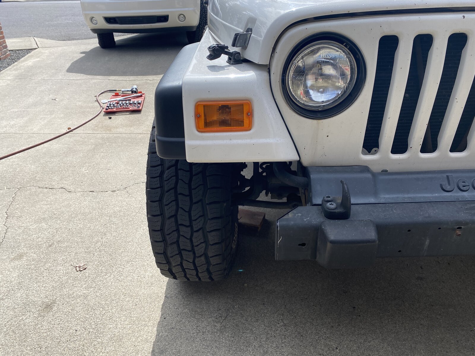

So much to do. The flares were toast on this thing. We could have painted them, but materials were $75, and it’s not worth it when you can get new for $120-130. The Crown get some negative fitment reviews, but the Rugged Ridge get much better reviews, and all new stainless hardware. Remarkably, not one nutsert stripped. I told them to tighten each slightly, and then loosen. After they took the old ones off, I cleaned the area and went to town with a wool disc and compound. It’s best to do it now before the new flares bc it flings everywhere. Jeep is totally changed aesthetically.

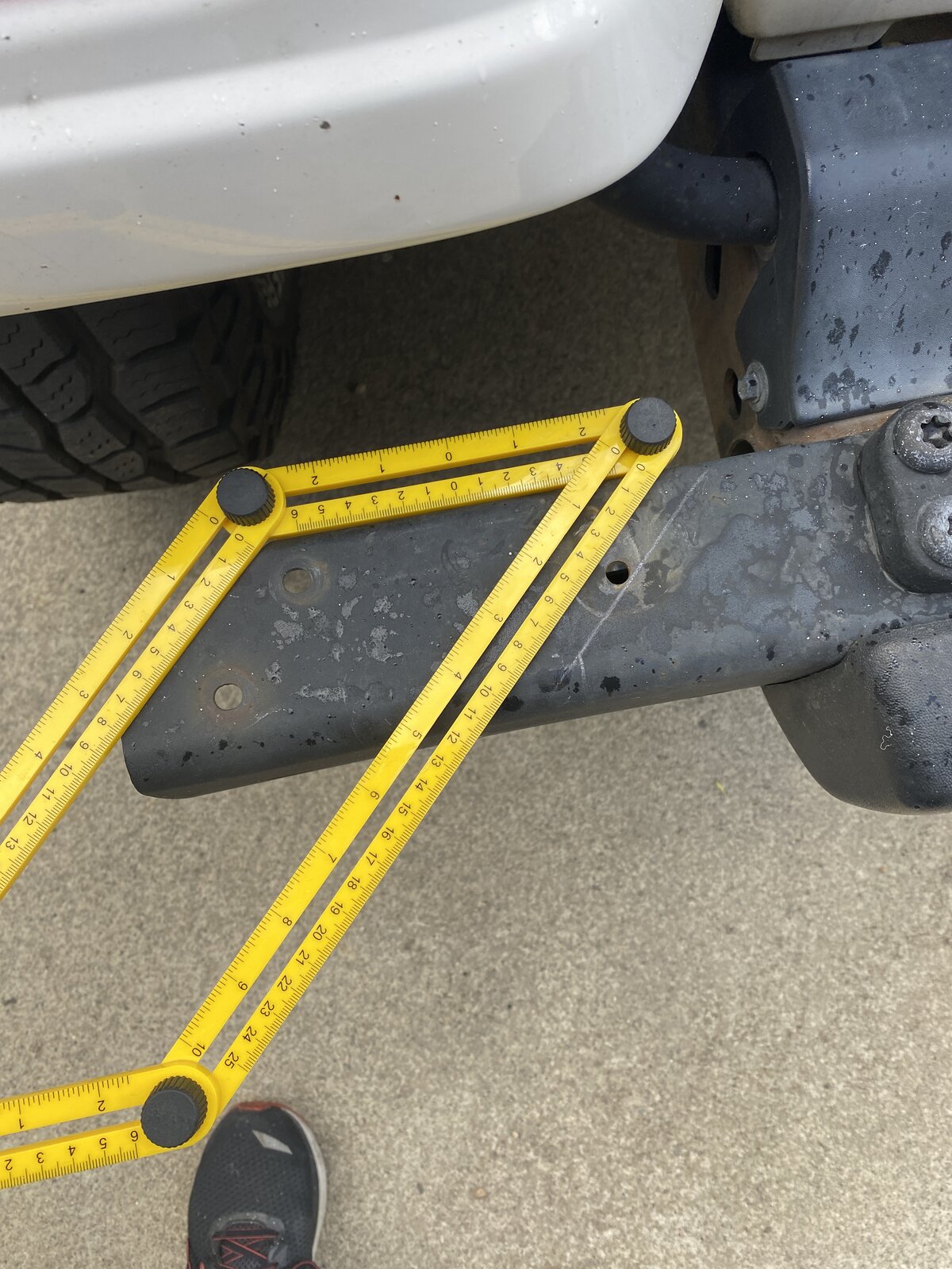

A goal is to stay light, so the stock bumper is getting cut at the same angle as stock and Mopar stubby end caps. Today we made the cut and mocked up the caps. We’ll remove the bumper and repaint soon.
