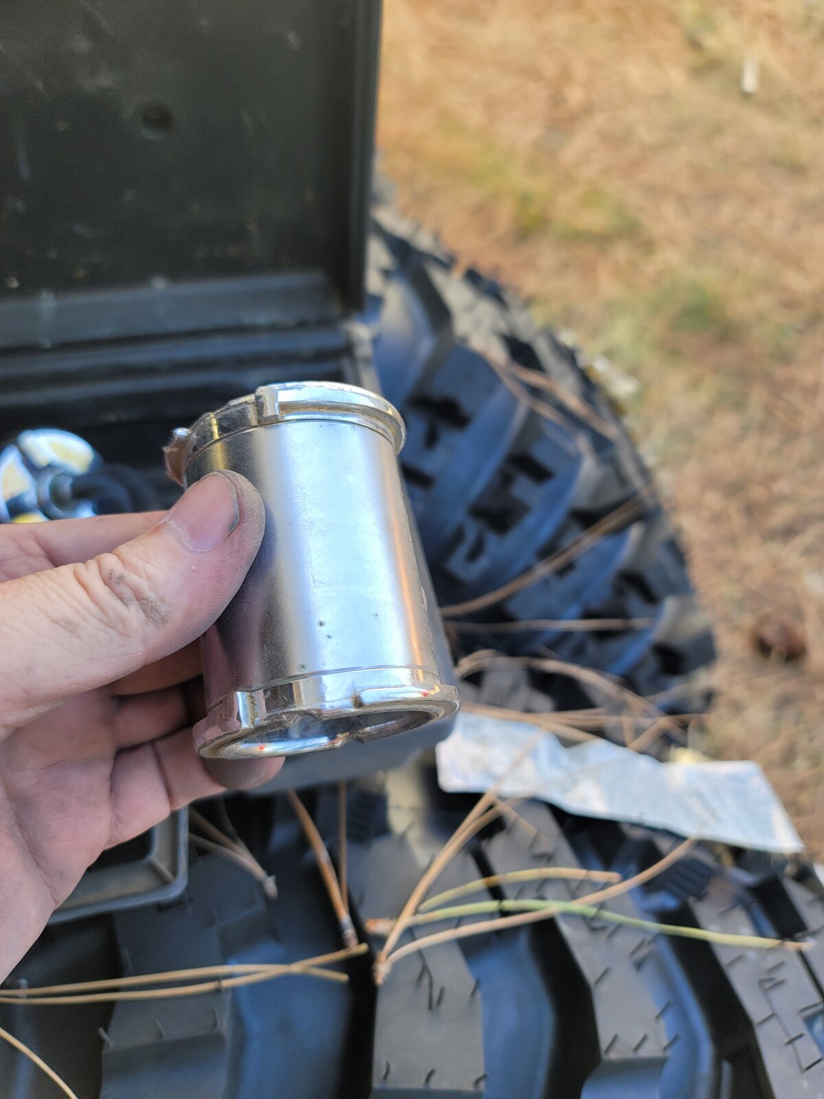

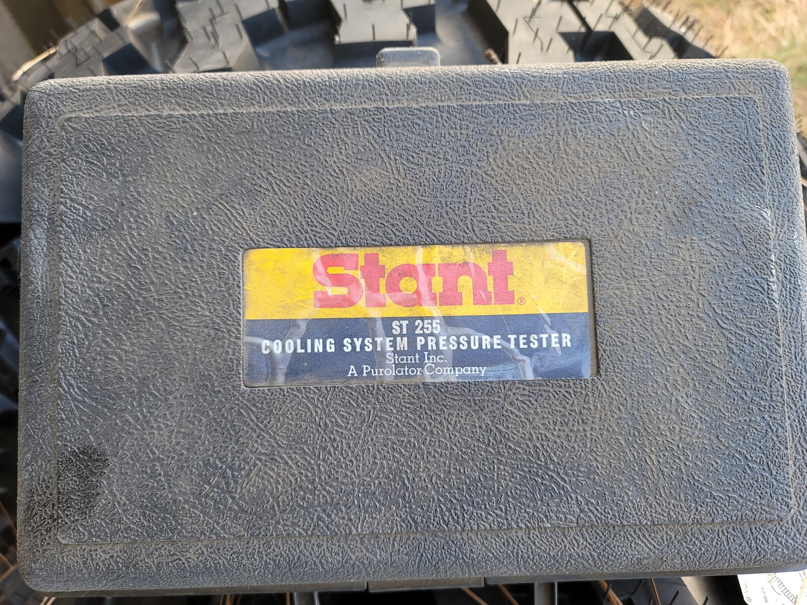

When my daughters TJ was doing this I found a crack in the upper radiator tank.
Go back to the auto parts store and rent a coolant system pressure tester. If you don't have one of course.
It'll have this pump in it to pressurize the system with. You pump it up and see if it will hold the pressure. I think 16 lbs but check.
Then it will also have this adapter to check the radiator cap.
Again you pump it up to the specified pressure to see if it holds.
Good plan. I’ll rent one. We flushed it today. Didn’t see much. Seems to be running fine today, but the system has something weak in it.
If it's a leak some place by pressurizing the system, you should be able to find it. You want to let it sit for 10 minutes of so once it's pumped up. And most auto parts stores rent them for free. You put a deposit on the tool and then once you bring it back, they give you the deposit back.
