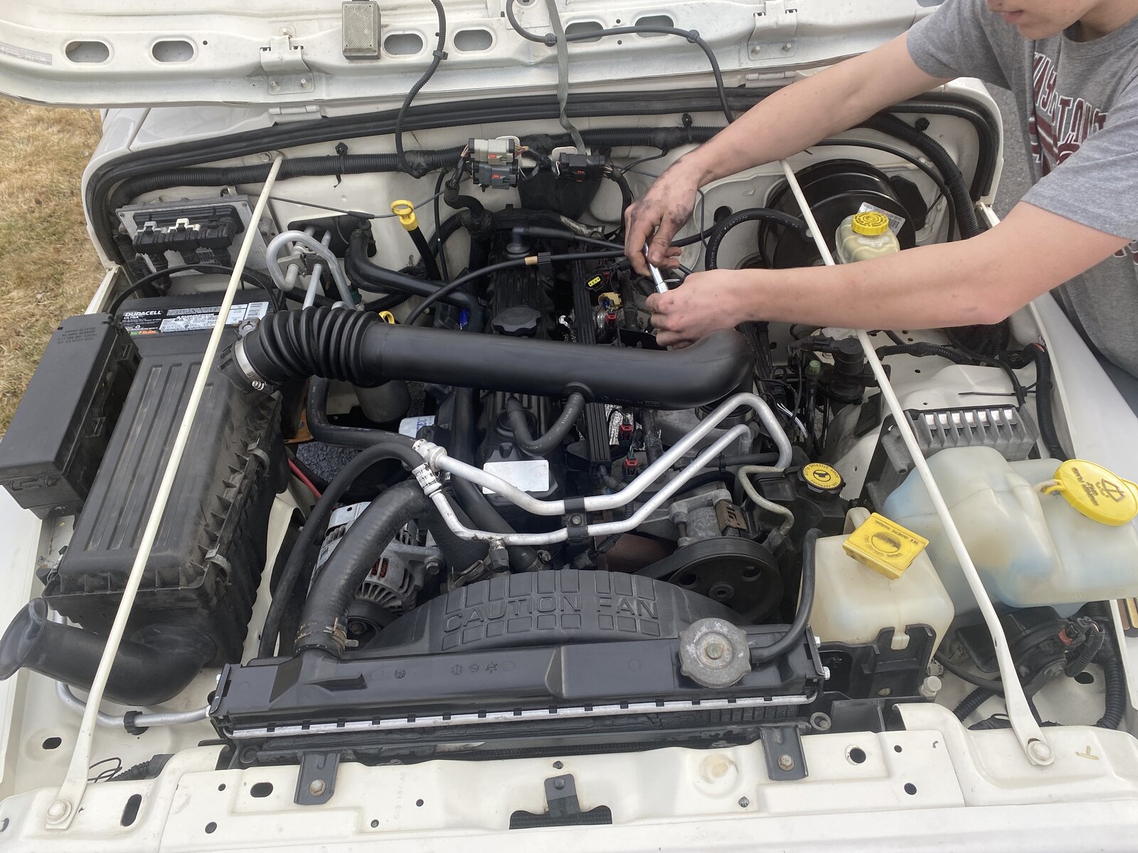

We have a lot to do. Well, they do. I made them research cleaning the engine, and they followed to a T the instructions from another forum post. People are so neglectful of these TJ’s. It turned out nicer than mine. 🤣
Before:
After:

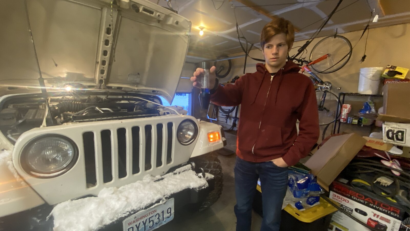

Did the block test. 2 minutes while engine warm and at idle. No color change. Thankfully that test turned out negative.
