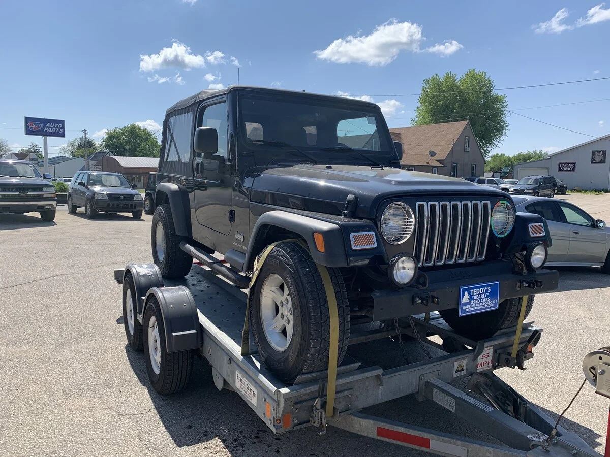

I bought my LJ in May - black 2004 auto w 107k miles for $9500. I was pretty satisfied with my purchase; the tub looked good, the frame looked good, all in all it needed some maint but nothing too crazy.
Got ‘er home and started picking through everything since the interior smelled pretty bad. The history on this vehicle is a little unknown. There are tow hooks up front so I know it was towed behind an RV for some of those 107k miles. It was filthy with gravel dust, and looks like it might have been sitting unused for some time. I picked it up from a small dealer in small town Iowa, and he had gotten it from a dealer he works with in IL.
The frame looked good on the outside, I’d come to find out later that there was a little rust damage that will need to be repaired (not pictured)
