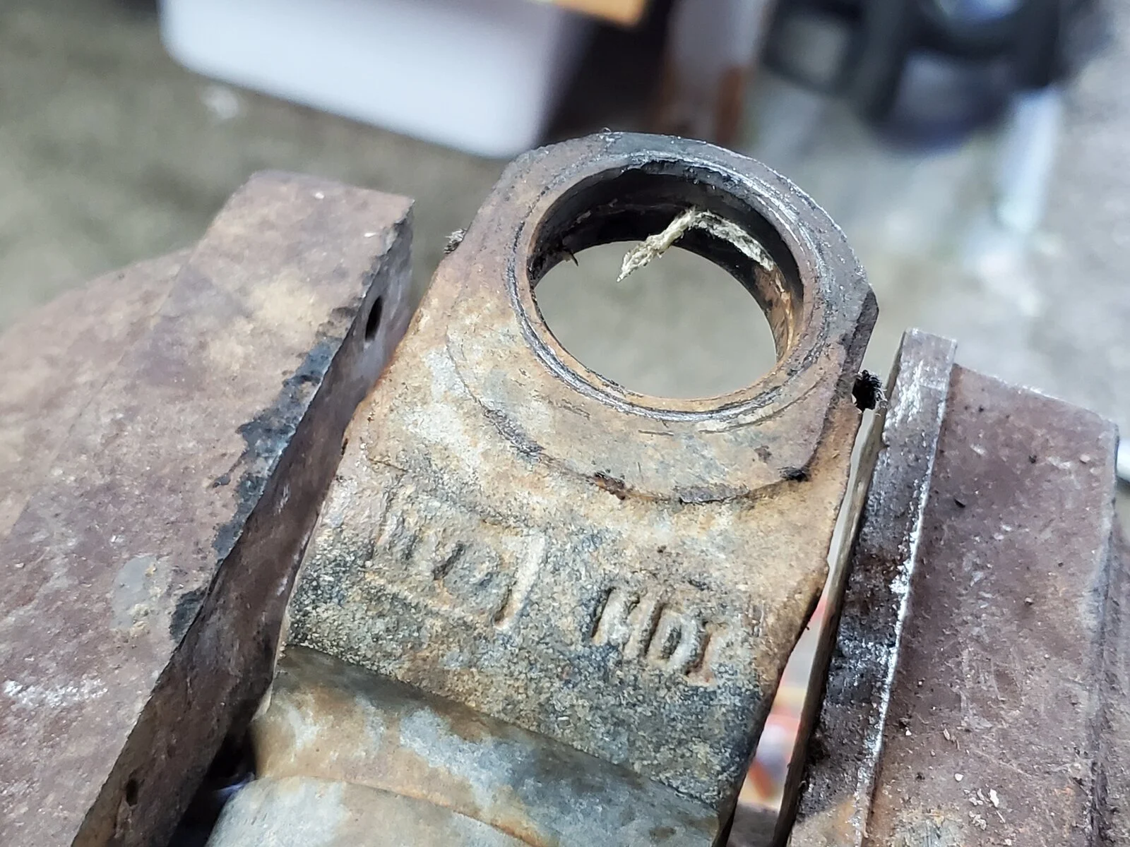

What am I missing here. Did the previous owner put the wrong Ujoints in? No retention rings or clips that I can see on the inside or outside. Is that normal? I think it is but want to make sure.

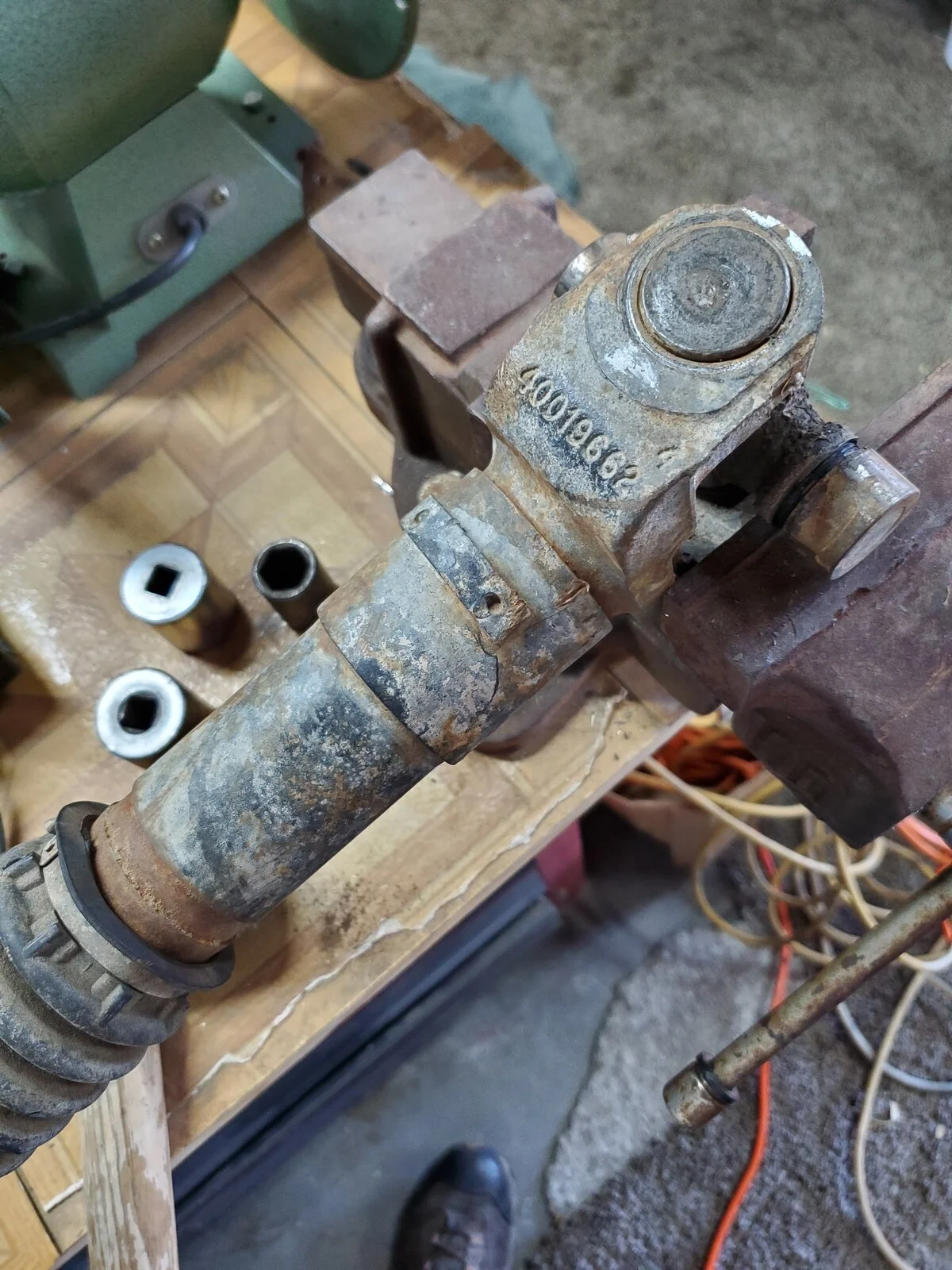

Background: I'm replacing the front driveshaft ujoints. I can't find my ujoint clamp press. The ball joint puller and two arm puller is not doing me any good. Father in-law with the press is out of town. Rear was done some time ago but I've never done the front. I've done them before on other vehicles so how hard can it be? Damn thing won't budge. Oversized impact sockets and a hammer aren't working. I'm afraid that if I pound on it more I'll start bending things.
Does this look right to you? For a Rubicon, I'm pretty sure it's OEM. Just won't budge and I want to make sure I'm not missing something before I really go at it.

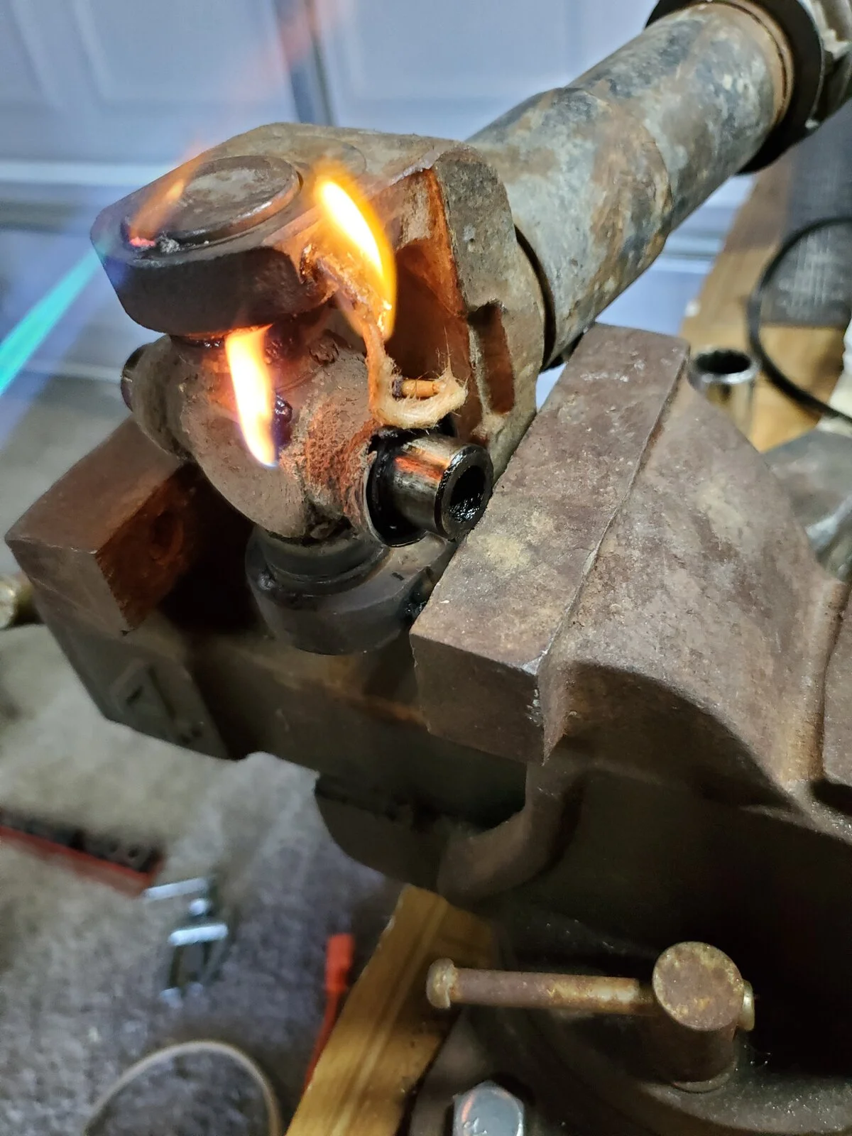

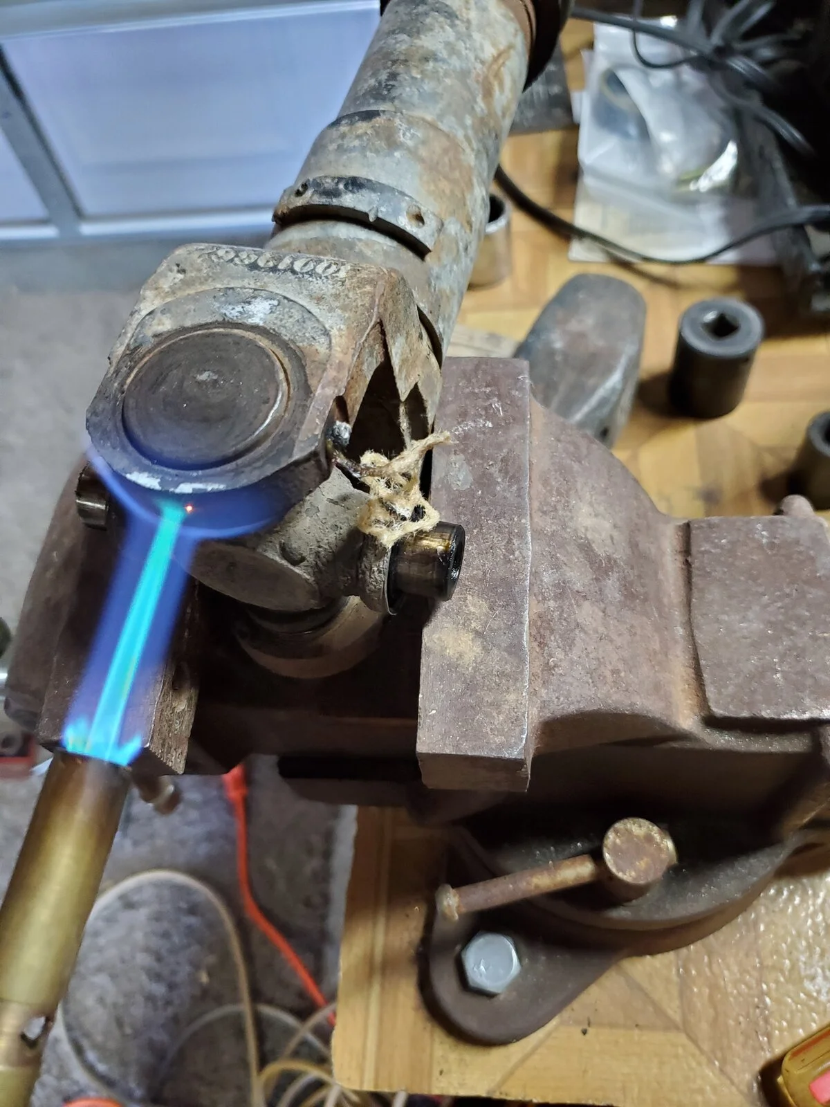

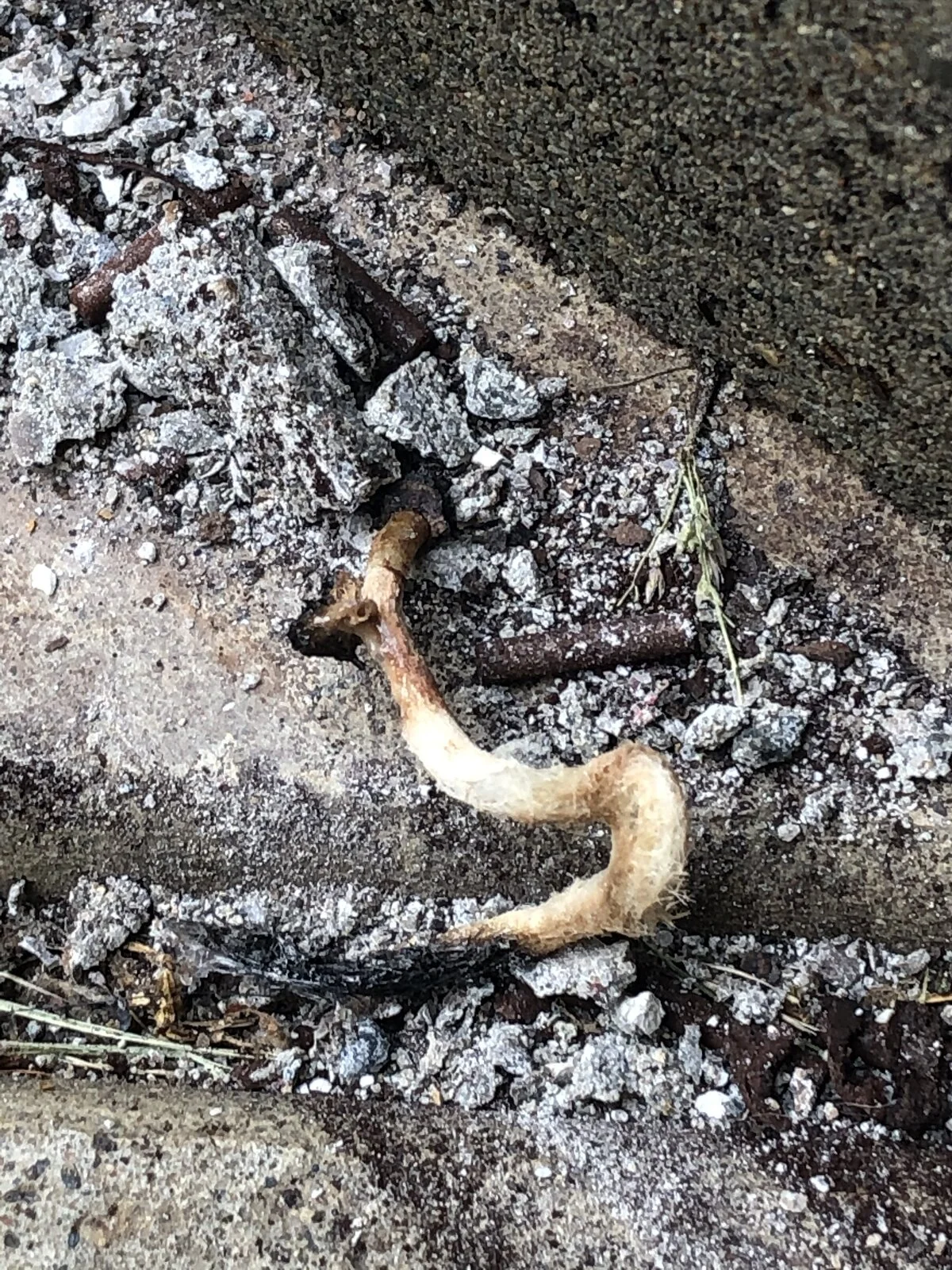

The factory u joints are held in place with a nylon injection. There might be a couple light colored nubs visible on either side of the yoke. You need to heat the yokes up with a blow torch to soften the nylon. Eventually it will start to squirt out. While hot, press out the joint.
I second this. I wailed on it for a while before I figured this out. Just heat it with the torch, and the nylon shoots out the little holes. Looks like this, and quite a bit of it will come out.

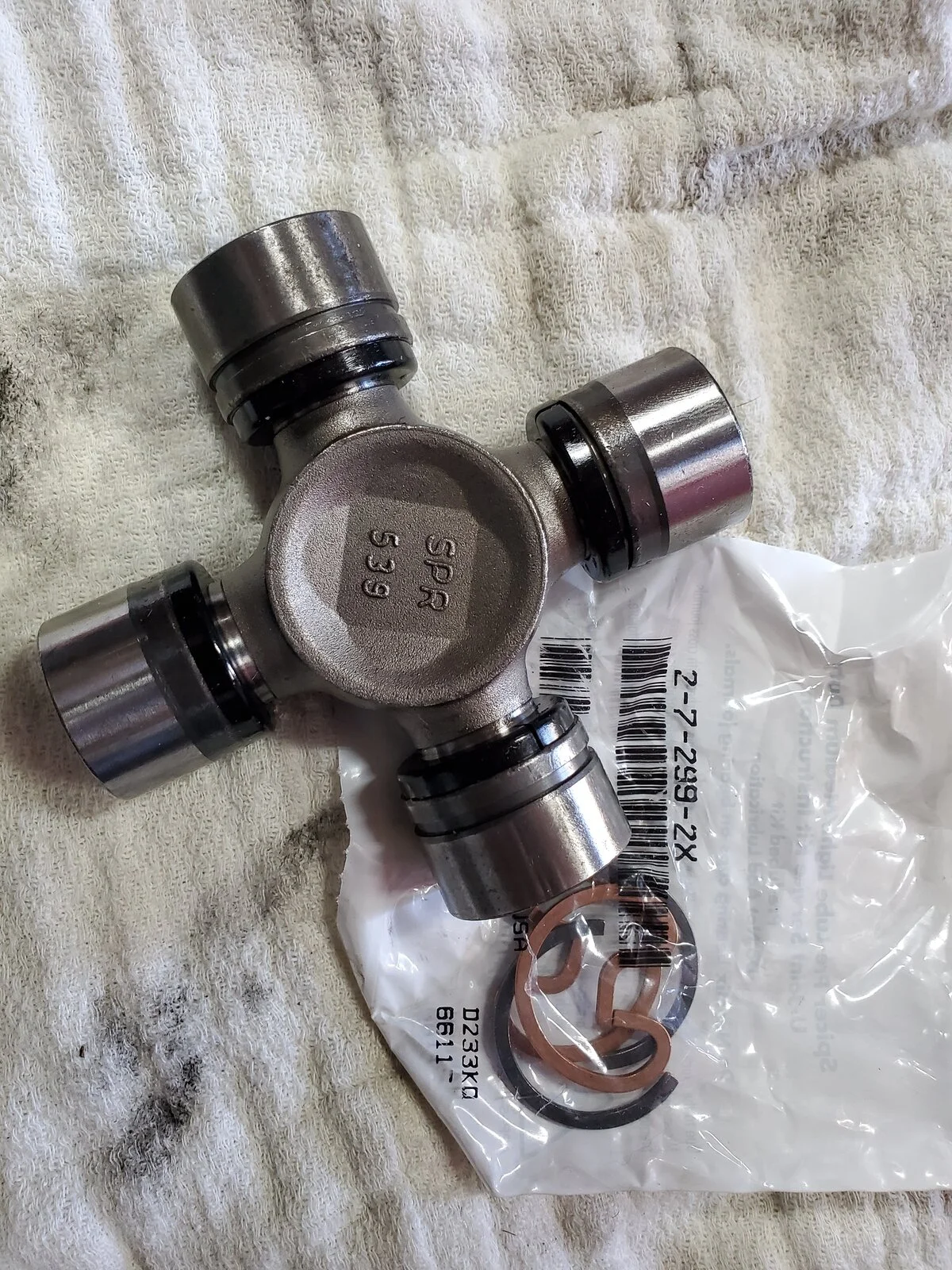

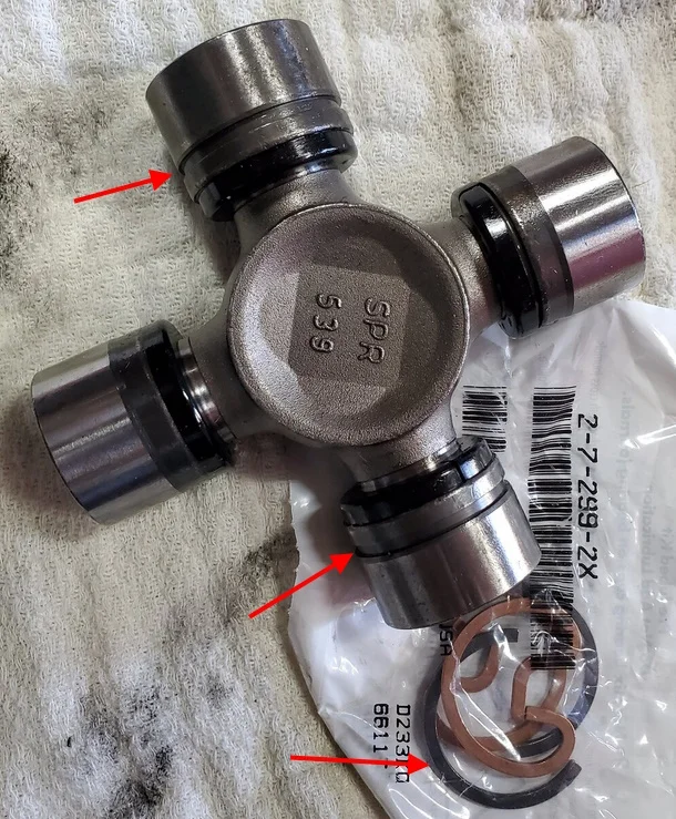

So at this point I'm guessing I dig out the remaining nylon inside the inner ring and use nothing in its place?
The Teflon injected retention works incredible, just not easy to deal with.
