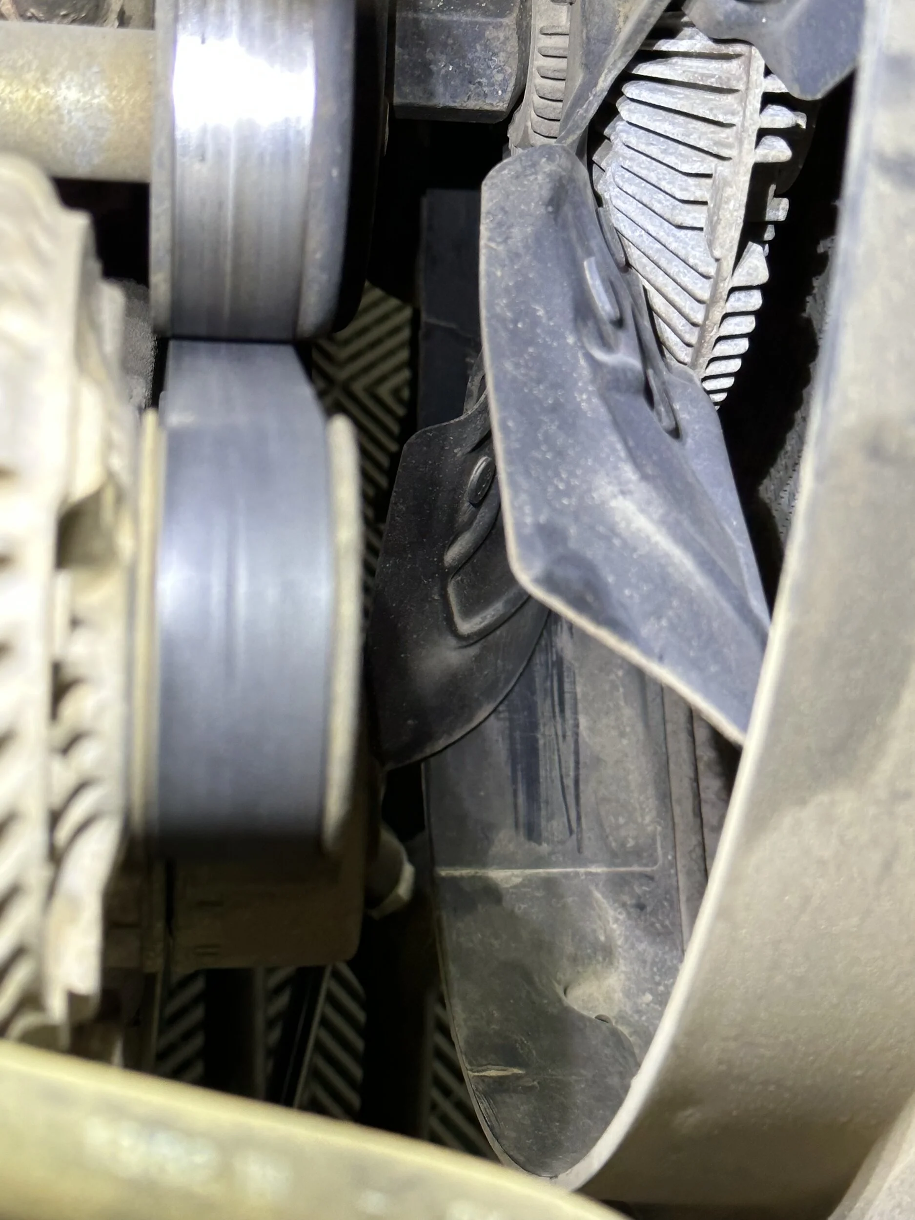

Well tracked down the sound finally, it’s my radiator fan hitting the bottom of the fan shroud.
A bit strange since I don’t have a body lift or MML. The only thing I can think of is that I tweaked the stock xfer skid enough from rock strikes that it pushed up the transmission and angled the engine enough to do this. Any thoughts?
Does the fan wobble when there is an engine load?
I dont believe so, I checked for play. There is a significant difference in clearance between the top of the shroud vs the bottom. I think I have 1.5" of clearance at the top and maybe 1/8" of clearance at the bery bottom.
