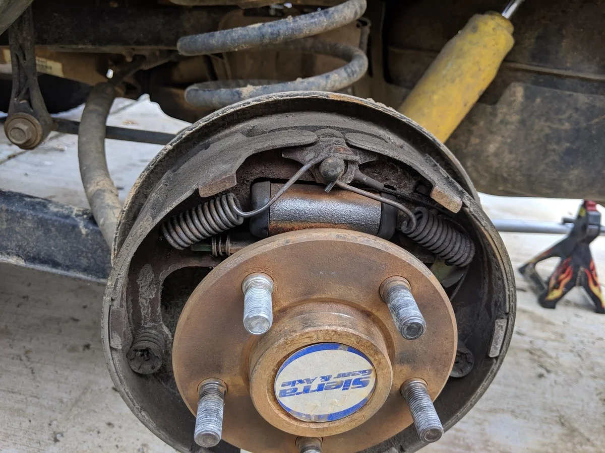

Little brake job. Saw that Sierra gear/axle sticker. Makes me wonder if it's been regeared. The rear diff is leaking a little, so I guess I'll go count the teeth when I take the cover off and replace seals& bearings.

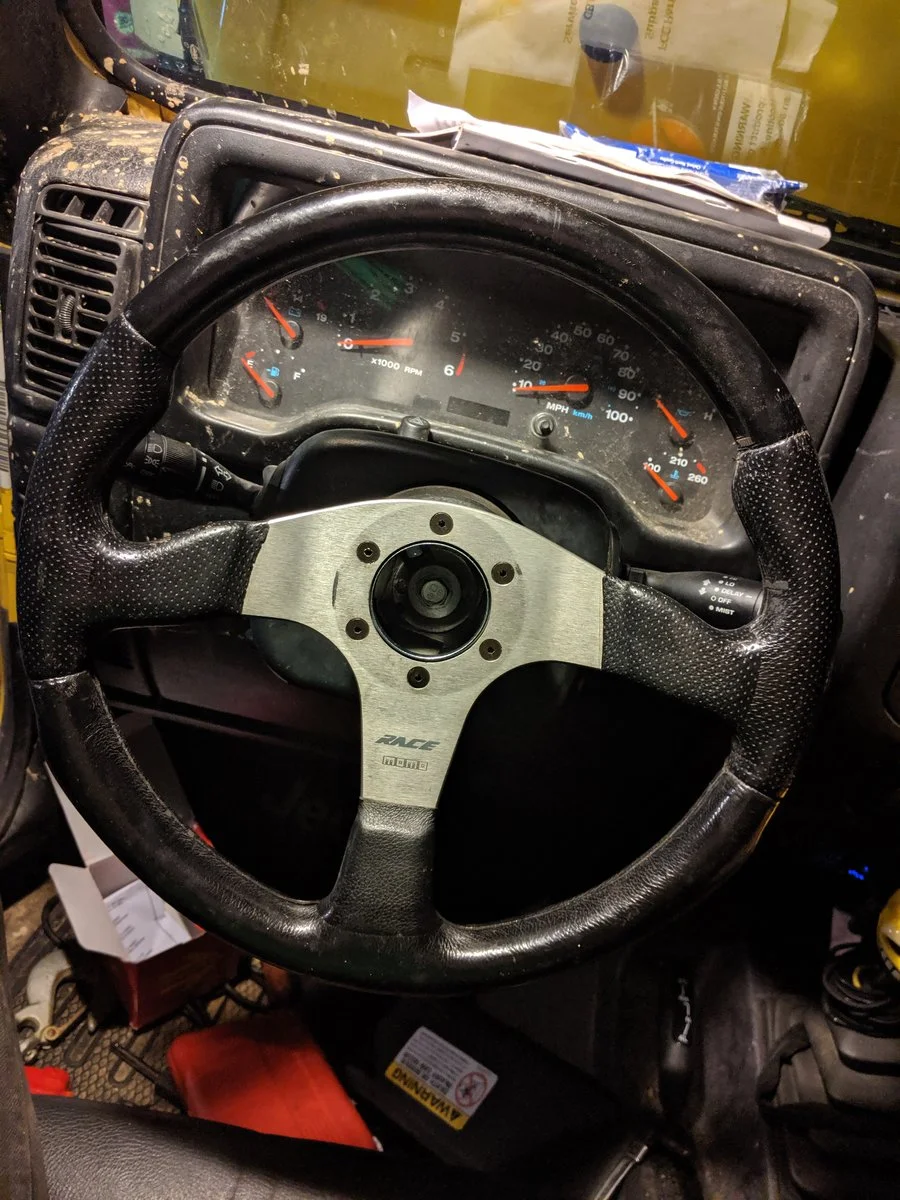

A Momo wheel on a TJ? LOL... that will be a first!
You should be able to turn the airbag light off by simply pulling the bulb in the cluster.
Haha, why not. I'm was going to throw it in my 4runner. But since that project is pretty much scrapped after getting this tj. Why not toss it in the Jeep. It's a little smaller in diameter so that's a plus for me, a man with long legs. I'm sure as hell not gonna put it in my Tacoma.

Funny thing. That steering wheel (if I were to buy one) would cost more than my Mopar radiator. Its ludicrous imo. But I can't argue with free.99

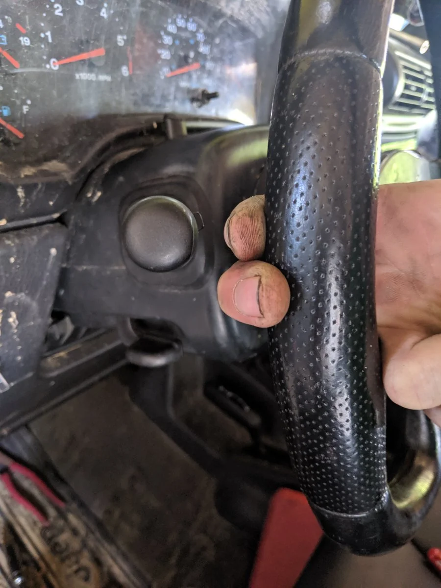

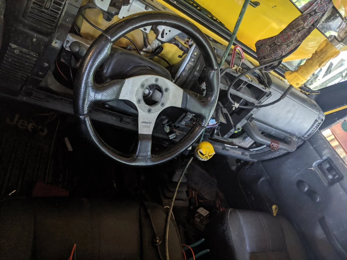

So I did it. And it "fits" the adapter to the spline anyways.

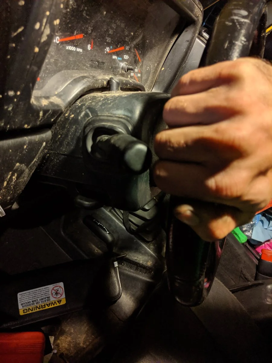

"Small" clearance problem.
Still brainstorming on a way to solve this.
The problem with the adapter is that the spline doesn't go all the way to the end of the coupling. There's roughly a quarter inch of smoothe before the spline starts.
Update.
So I have a big tub of stainless scrap (used to do maintenance at a food processing plant) and in the tub I found a nice disc that fits over the spline out out and the adapter fits into it nicely. There was a bit of a gap between the inside if the disc and the steering shaft. So I grabbed an old leaf spring bushing from my toyota, shoved it in-between them. The bottom of the adapter was grinding around on the metal housing around the steering shaft. Now it's not. And I've gained enough clearance where my fingers don't smack the blinker/wiper sticks. Now I'm going to see if one of my old jeep hub-center caps will fit into the steering wheel to cover up the bolt.

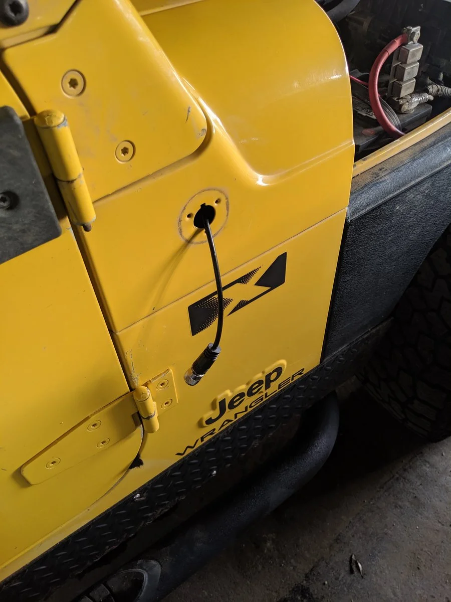

Ran my CB antenna cable today. Also checking all the wiring in the dash, just to make sure nothing is showing excessive wear n what not.
I think I did my antenna cable right. I won't be able to test it for another few weeks til my new antenna comes in

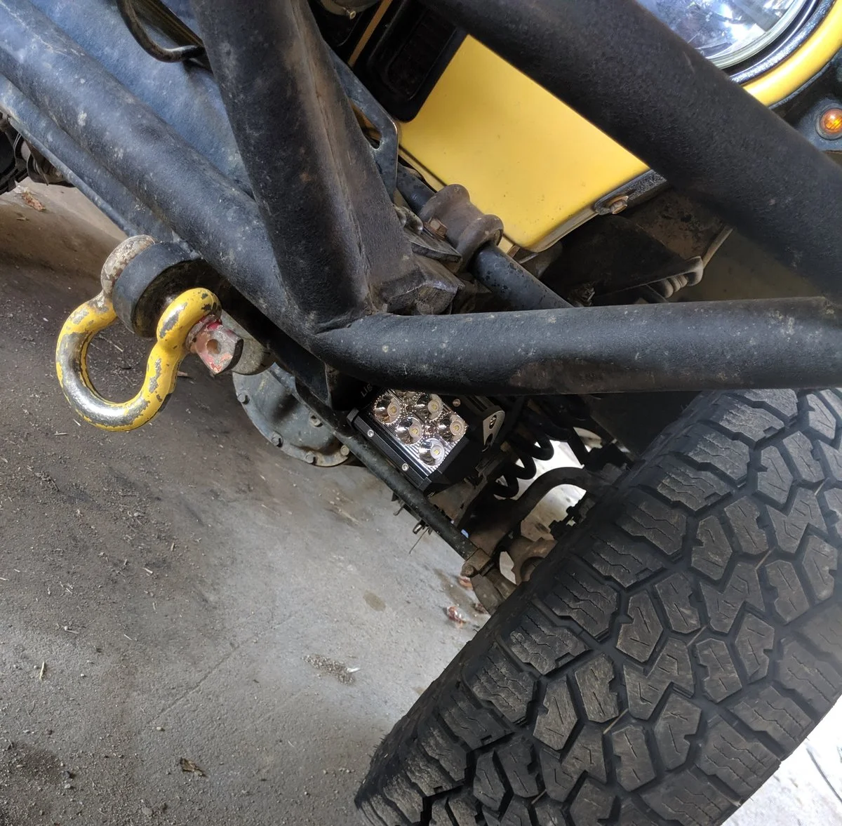

Not wired up yet. Waiting to get, or make, a switch box for all my junk. My wife "what if a rock snaps them off?" Well I got 16 of these lights a few years ago and have only used two of them for my old xr650r
They are Chinese specials for sure, but they are quite bright. Ran them on my bike for a fee years with no issues in rain or mud. Really just wanted some more front lights on it for trail riding. I thought about the A pillar mounts, but they don't appeal to me a whole lot. If I want lights up high I'll get a windshield light bar.
Those lights are so cheap that even if they do snap off, a new set is under $20 on Amazon last I looked!
Seems like a nice place to put them though!
