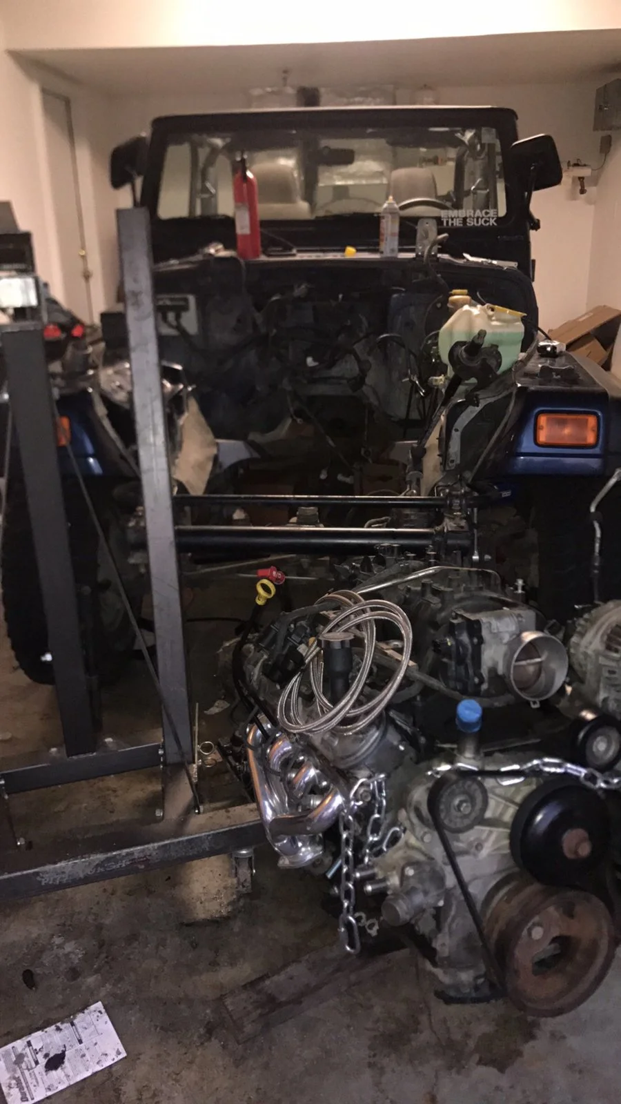

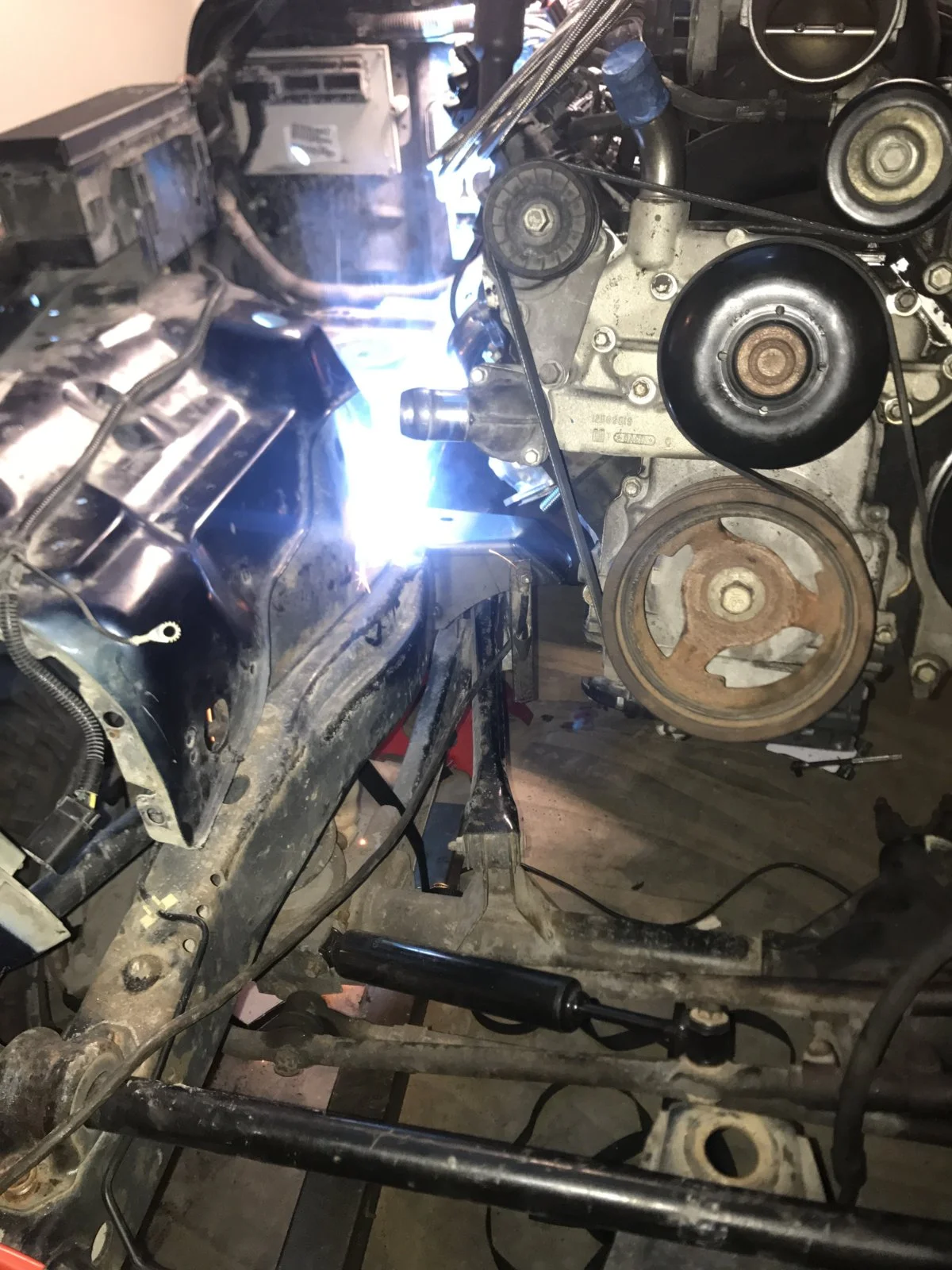

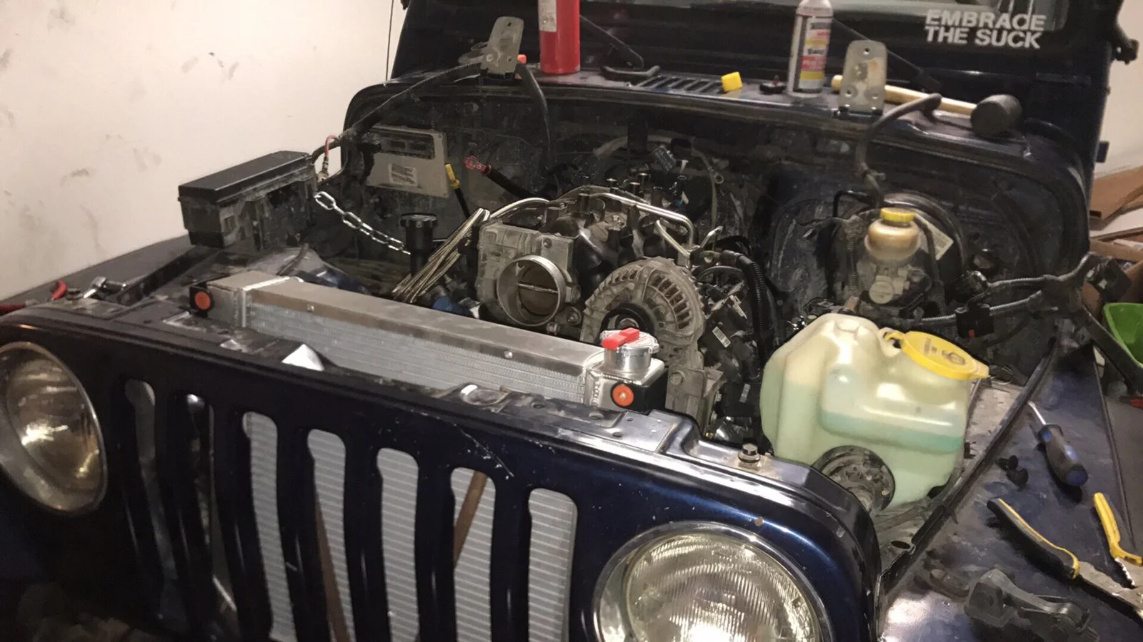

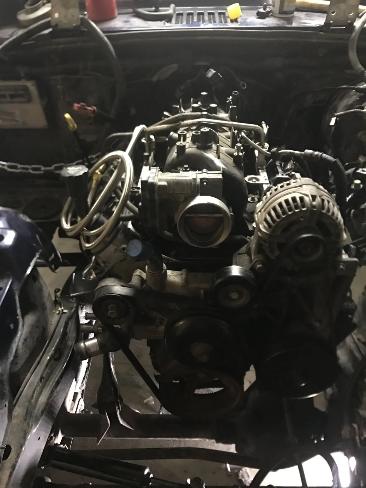

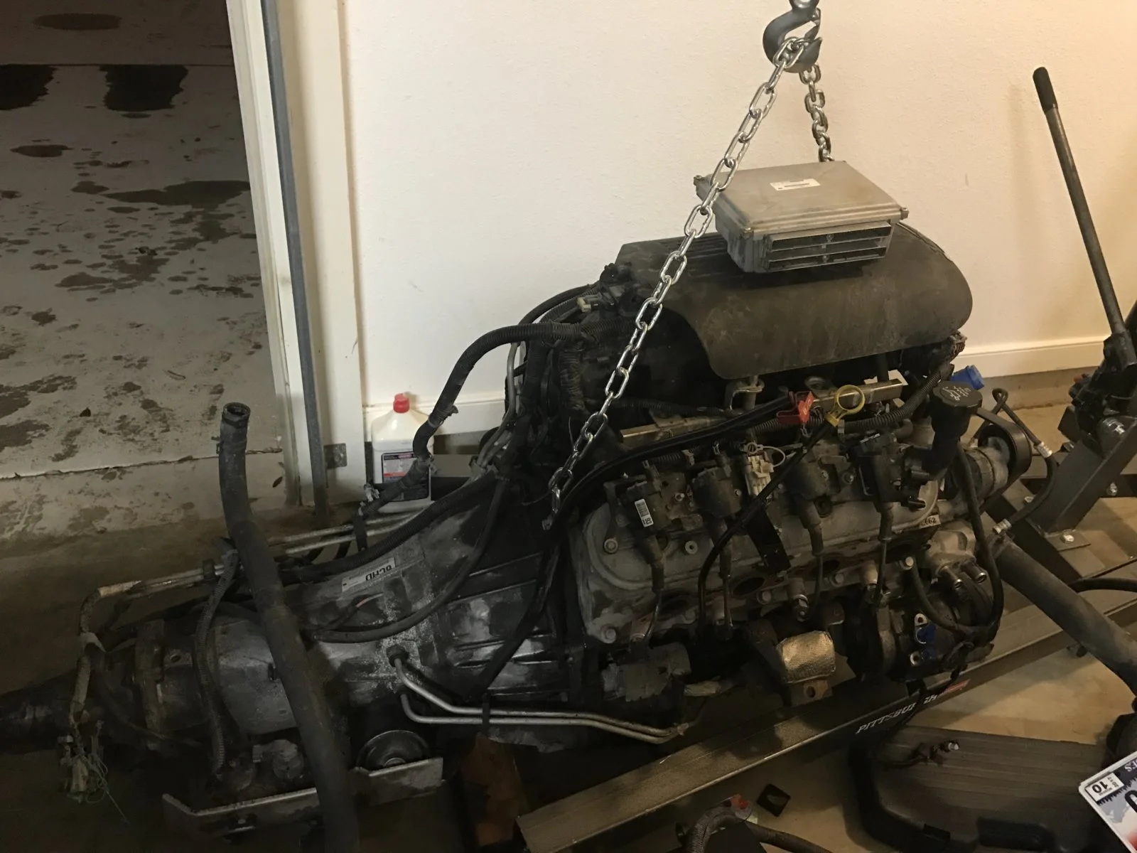

Starting this a little late, but I'm in the middle of dropping a chevy 5.3/4l60e trans into my tj and prepping some Dana 60/70 to swap in the near future. Going to run the axles full width with a 3" front stretch and a 5" rear stretch. Trying to decide on 37" or 40" tires. The tire size will determine my lift height. All I got to do for the tj to run is finish the wiring and fuel lines. Getting my driveshafts from Adams Driveshafts and got everything I need for the conversion from Novak. I'm learning as I go on this build. Currently looking into getting trusses from Artic or fabricating my own. Always welcome any insight for this build. The goal is to be street "legal", but be able to hit the trails without worry.

The 04 tj fuel pump pushes enough psi for the 5.3. I just need to replace the regulator and I'm good to go. Deleted the Evap system

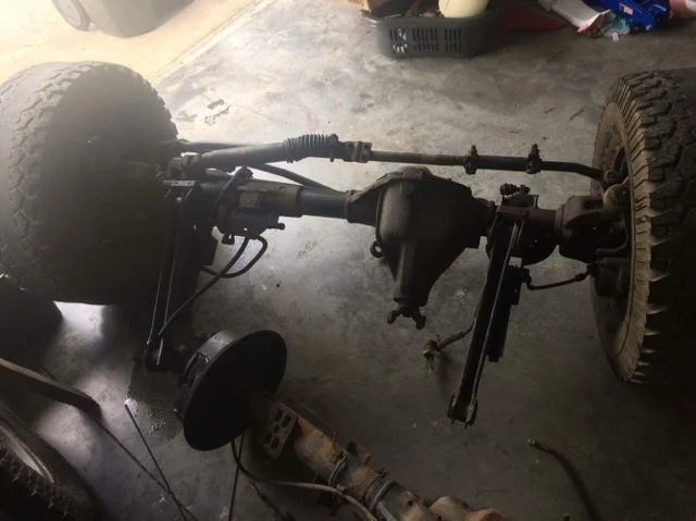

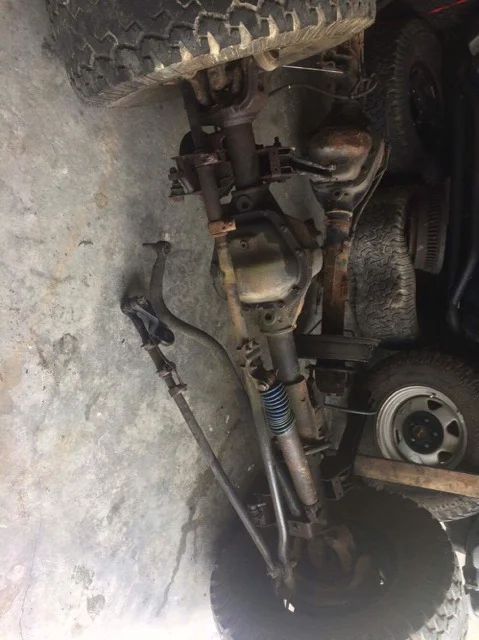

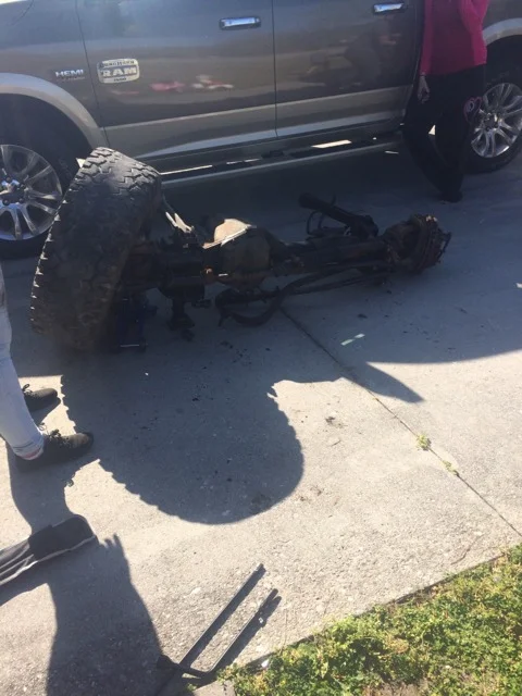

Here is the Dana 60 and 70 I picked up for 400, both came out of a 98 Ram 2500. I know they aren't the desired Ford Dana, but for the price I couldn't let them pass me by. Just ordered a CAD delete from EMS Offroad. Decided to just buy a truss and brackets for the Dana 60 from Arctic Industries. As for the Dana 70 I'm still looking looking around. Can't seem to find a pre fabricated kits for a TJ. Might end up making my own or buying a kit for a 14 bolt or Dana 60 and trimming it to fit the Dana 70. Anyone know where I could find a truss and brackets for the Dana 70? I'm going to be running a 4 link rear, possibly with a coil over set up.
