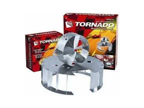

FWIW, I got a 15 HP and 5 MPG gain with this. Don't let my secret out. I've been hiding it since the 90s. 🤫

Everyone knows that the Tornado only worked if you used Slick 50. And wasn't it replaced by the secret garage hack where you generated you own hydrogen as you drove.

That's how Chevy turned the sbc into a Vortec engine making a bunch of tiny tornados inside. ;)

Not as well known are the additional 3 HP and 2 MPG gain by adding "SplitFire" spark plugs to the mix.
