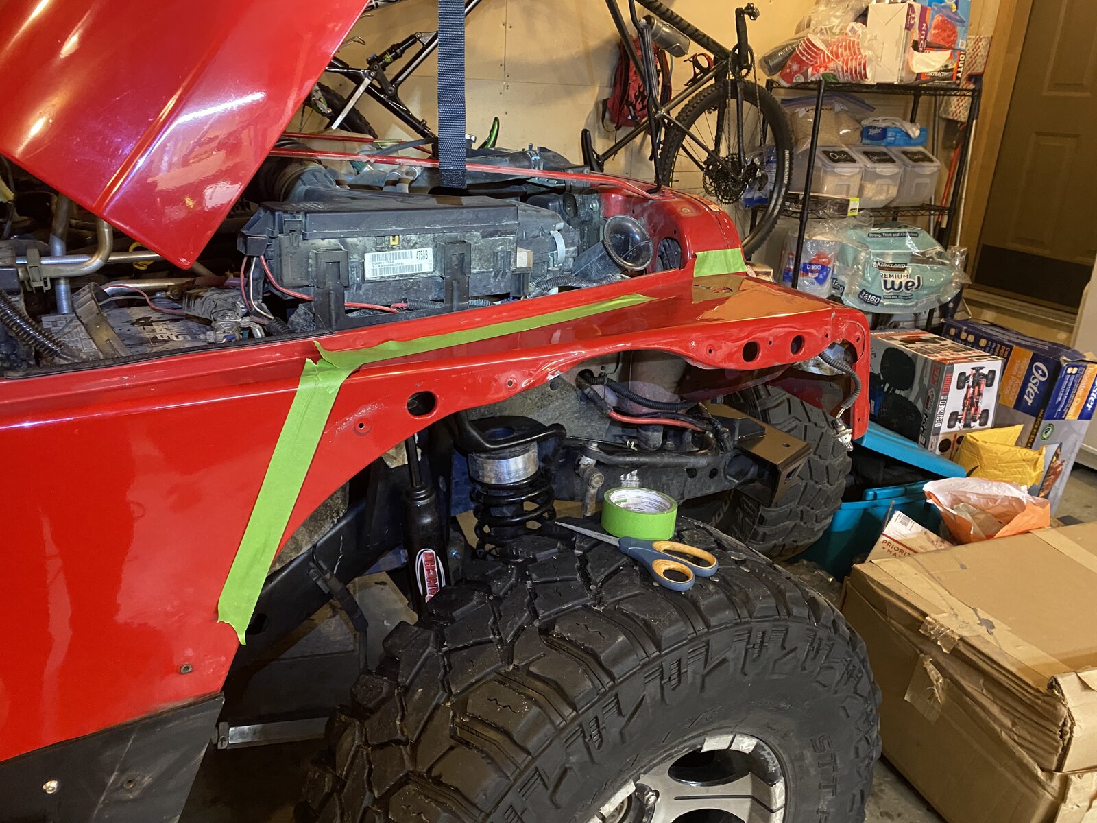

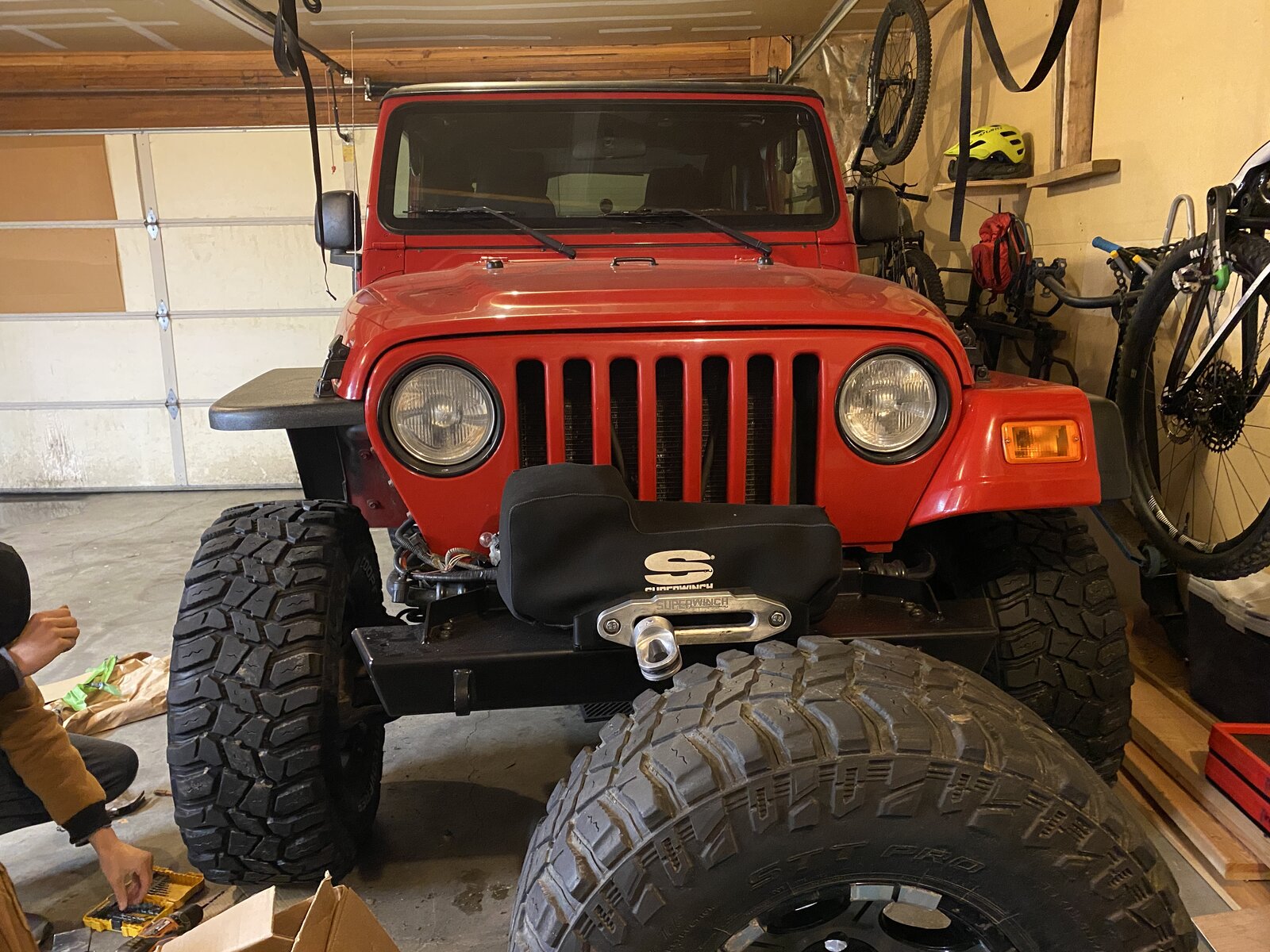

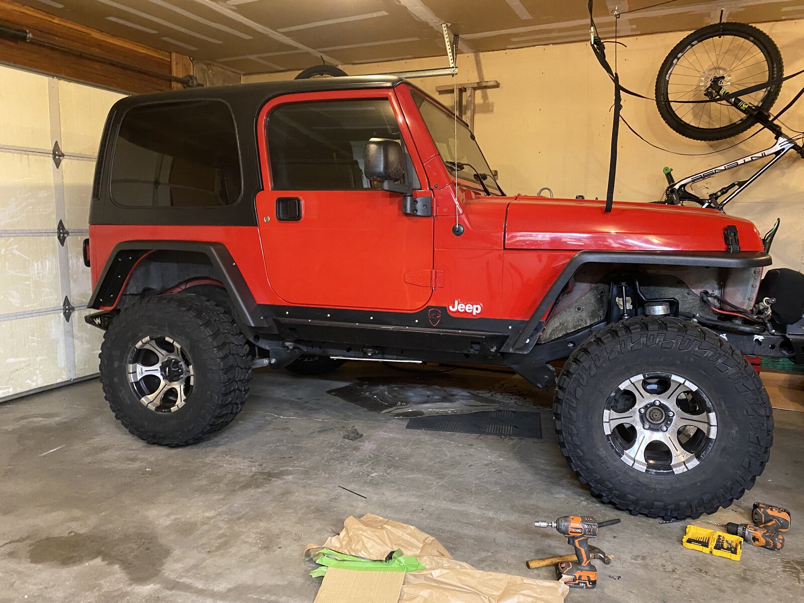

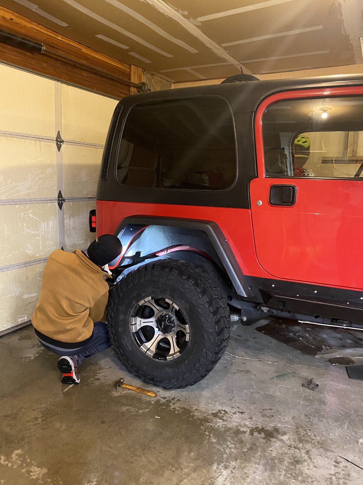

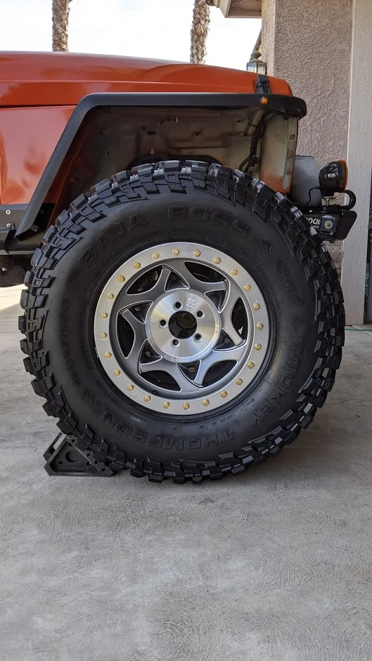

Installed the MCE’s on the passenger side today. Started with the rear since I had the most concerns there. Fronts were easy. I was actually pleasantly surprised.
No additional gains in the rear, of course.
In the front the up to the seam on the stock fender was 8 3/4 and now the up to the MCE fender is 10 1/8”. No gains at the rear of the front fender well, of course. I wasn’t having a problem rubbing my 33’s in that section, but I had got into the seams, so that problem is solved, as well as the bent up stock fender. Overall, pleasantly surprised with the appearance. Jury still out.

It looks great!

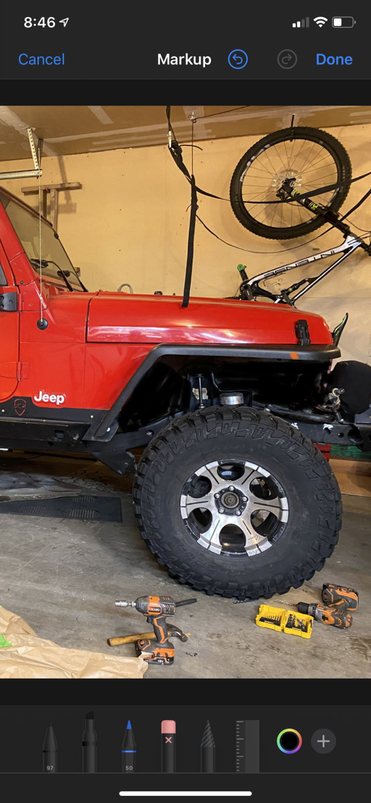

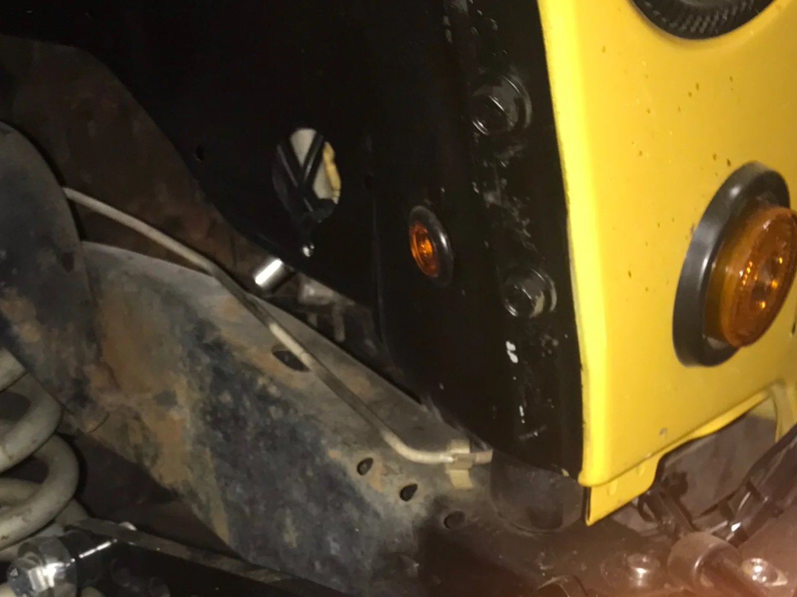

I’ve got some very similar side marker/turn signals coming Tuesday, 3/4”. Not sure where I want to install them yet. I saw where @jjvw installed his, in the lowest of the three stock support bracket holes. He also added the JK signals under the headlight. I ordered a 3 wire that can serve as both a side marker and turn signal. Another option is the bumper. Any suggestions appreciated.

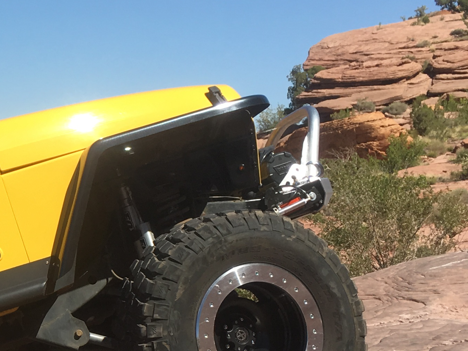

Jk style would likely look the best but I'd have a hard time cutting into the grill. I'd just do something like this...

Jk style would likely look the best but I'd have a hard time cutting into the grill. I'd just do something like this...View attachment 213795
I feel the same about the grill. It’s quintessential Jeep TJ. Hard to cut. If it does look best I’d be willing. My question is can the side marker be on the front? Or does it have to be on the side?
