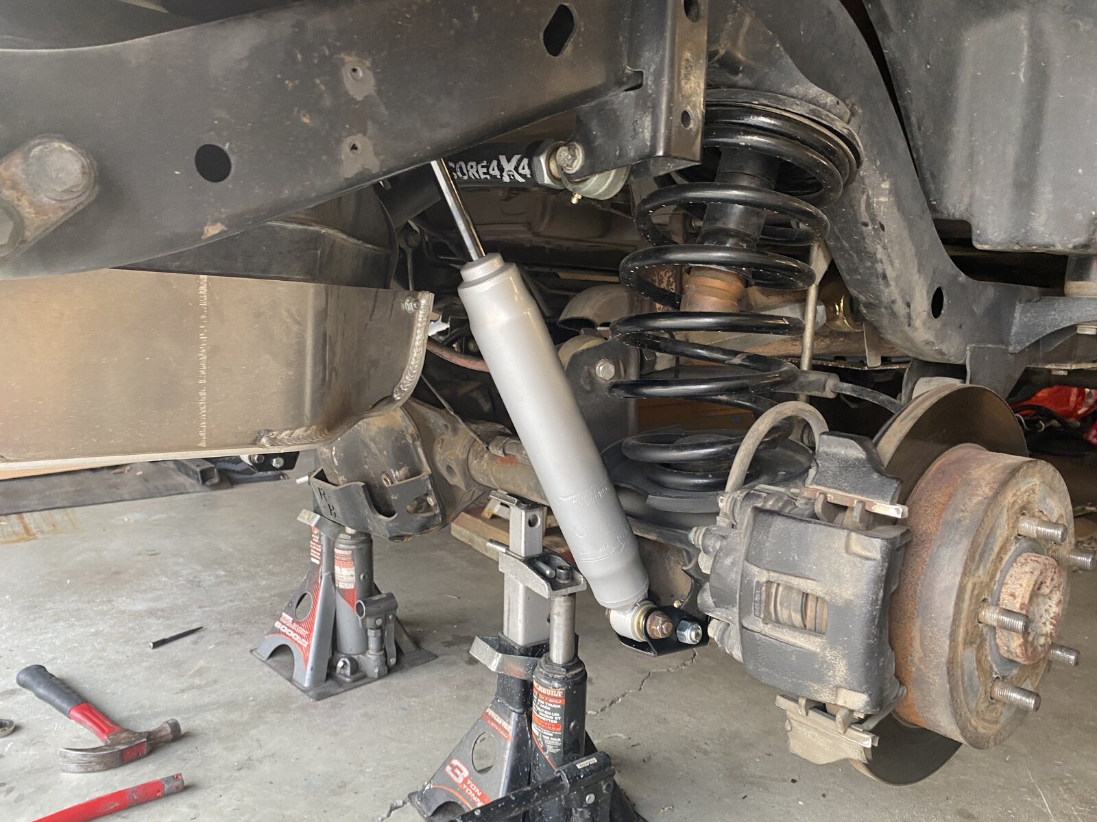

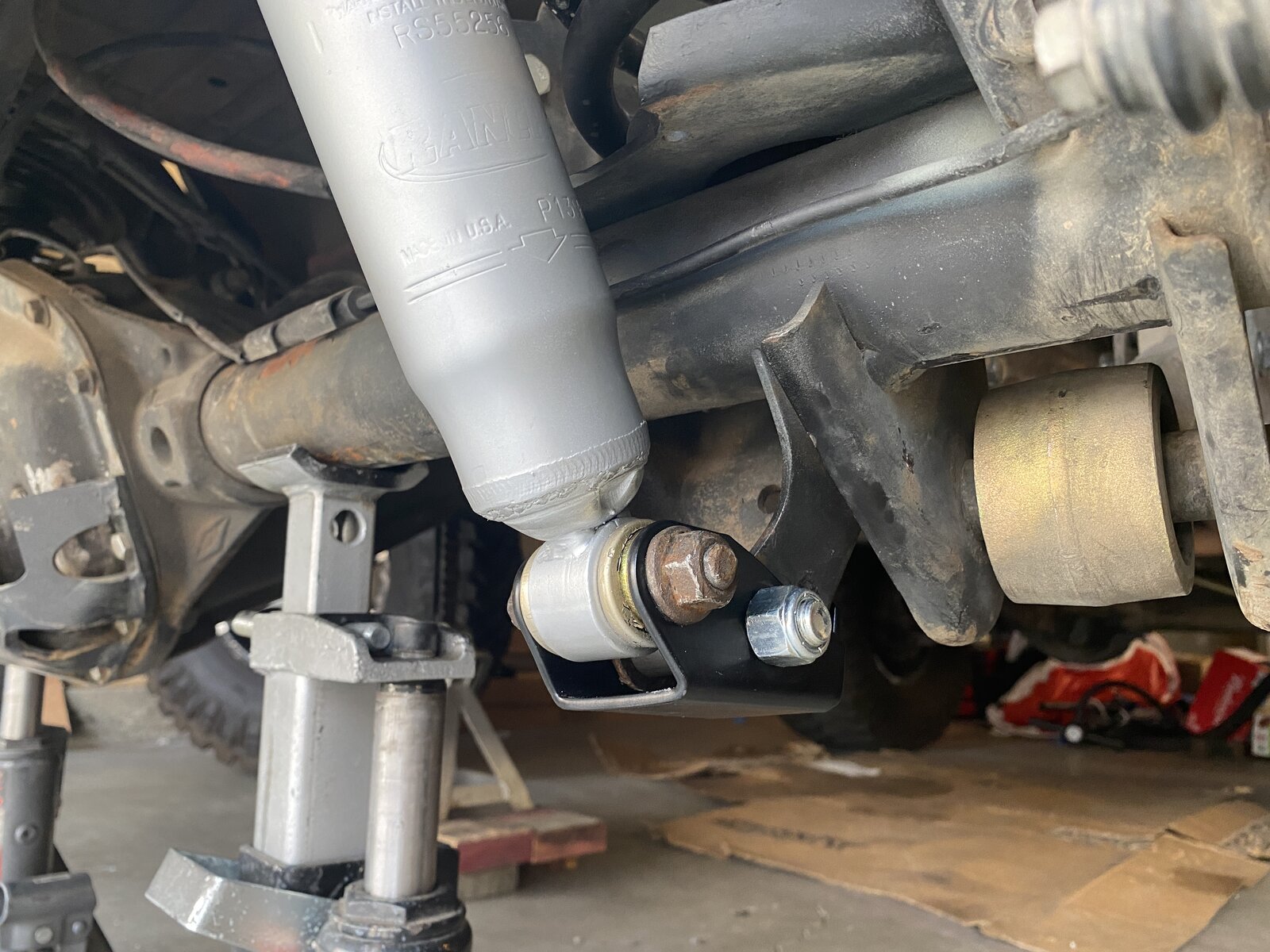

Got the Rock Jock CE-9601 rear shock extension brackets installed and switched the rear Fox shocks for the Rancho’s. Night and day difference. I think it’s all what you You were right @Mike_H, the rear makes a bigger difference than the front in terms of ride.
Right now I’m pretty happy with the ride on and off-road. I have more travel and a good travel bias. Glad I have extended brake lines. These Currie 4” springs are looooong, but I did manage to just slightly detach the front passenger spring from the keeper.
Front UP 5”, DN 4 5/8”
Rear UP 4 5/8”, DN 5”
Still anxious to try the Walker Evans @Wildman, very.

Ideally cut the factory brackets off and get a new set and weld on in the proper location, but the extensions will work for now.
