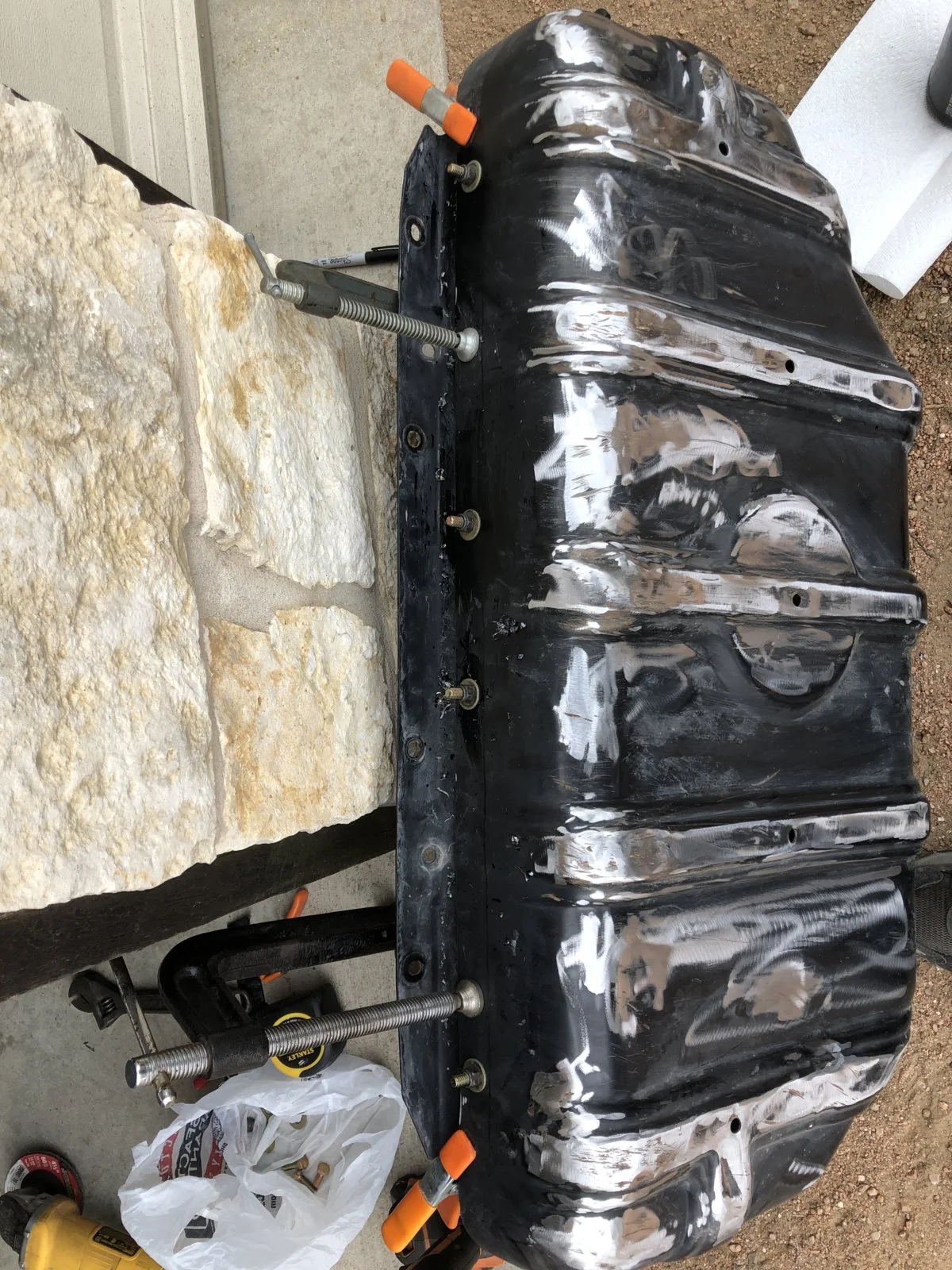

Wanting to do the Stock Gas Tank Clearance Mod tomorrow AM. With a 1-1.25” BL enough space is cleared to remove the skid and tank, trim the mounting edges, re-attach 1-1.25” lower and reinstall. As per the following thread on Jeep forum
https://www.google.com/amp/s/www.je...ification-free-ground-clearance-736901/?amp=1
However, and this is where I need some help, I climbed under the Jeep to check for clearances. It looks like I have 3/4” max between the tank and rear upper shock mount crossmember. My thought is to do 1/2” at the front where that trouble spot is and a full 1.25” at the rear. Thoughts??? @jjvw, @Mike_H, @bobthetj03

When I cut mine, I put it together at a hair over an inch, tacked the skid and test fit.

Yes, but the BL doesn’t move the rear shock crossmember which is welded to the frame. There’s plenty of room everywhere except that one spot. My thinking is that the front of the skid doesn’t really matter for clearance. It’s the rear that matters for departure angle. Couldn’t I just raise the rear? I could possibly go 1.5”+.

I was able to raise both ends evenly. I didn't pay much attention beyond that.
Someday, now that the cross member isn't a shock mount on mine, I would like to go higher into the tub.

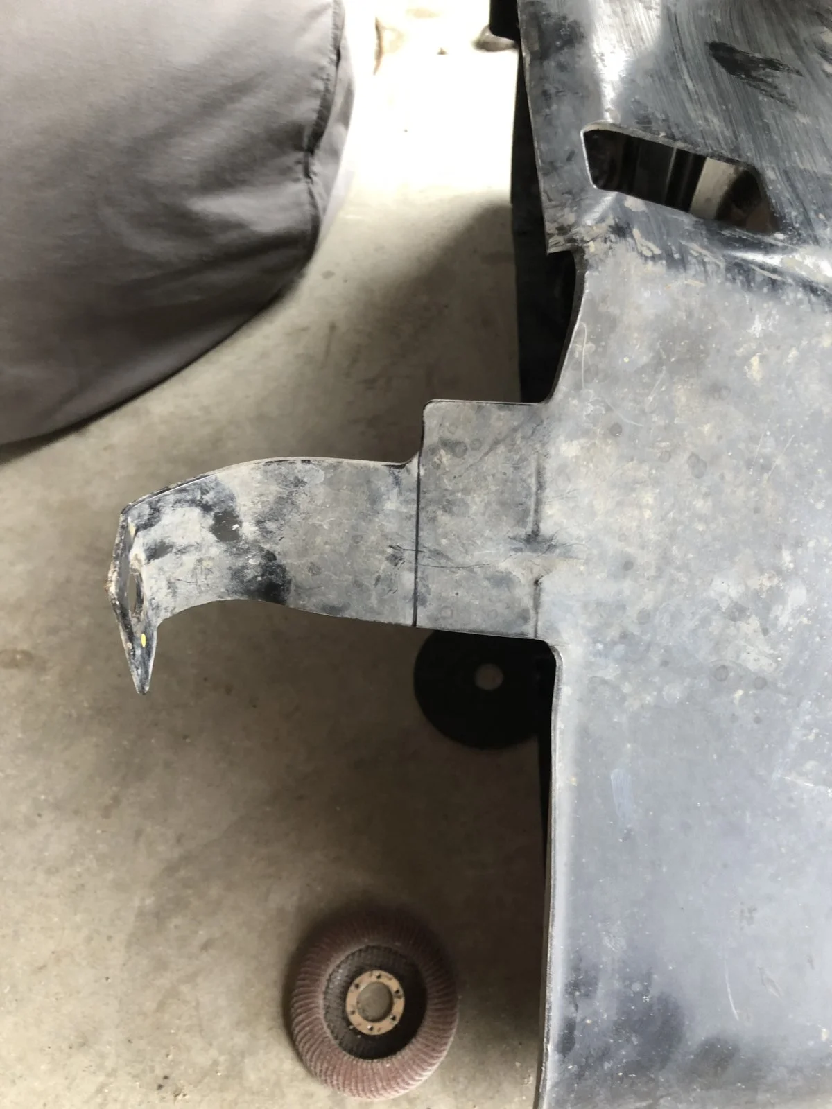

I started the gas tank skid clearance mod. The connectors are getting brittle on our Jeeps. I broke one and then broke a tiny plastic part off the fuel pump. Totally sucks. I’ve learned a few things though. I ordered a new Bosch pump, but I had some Plast-Aid and am trying to build a bridge to fix the fuel pump. Sort of just for laughs, probably not smart, but I’m doing it anyway to see how strong it will be by manana. It won’t hurt anything, the replacement won’t come till Monday. Anyway, progress so far.
Broken plastic stupid piece.

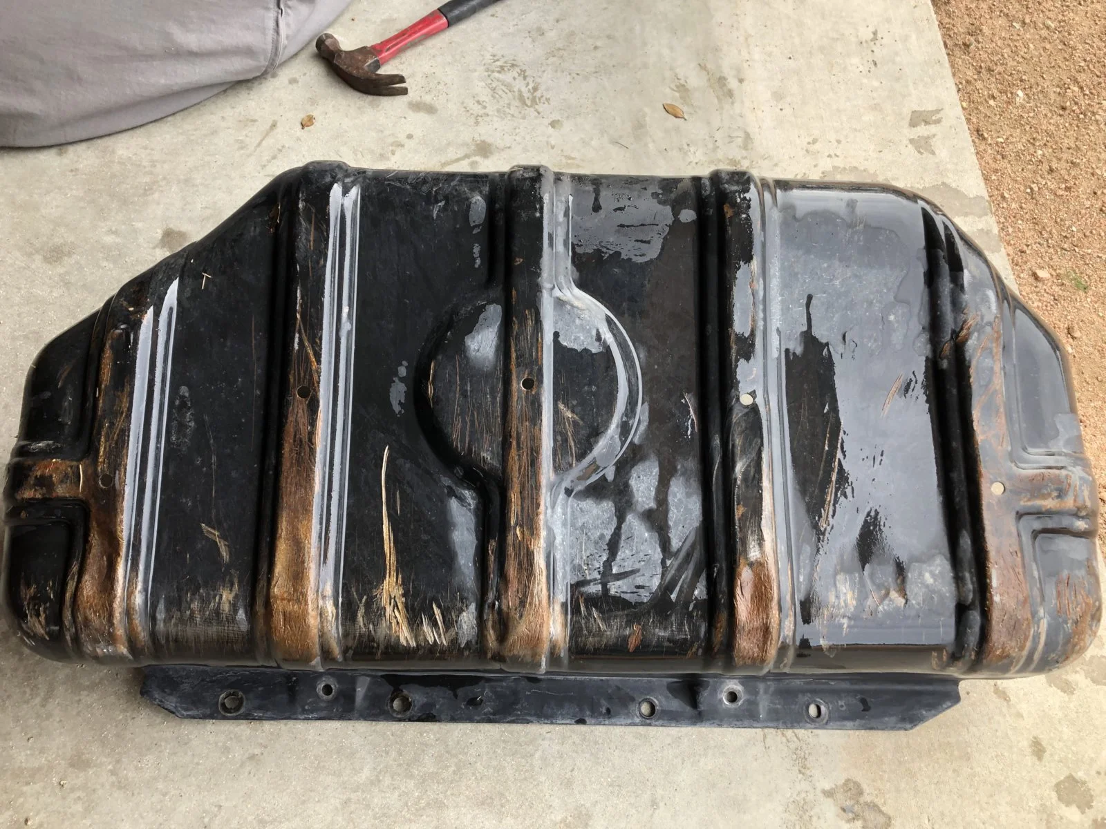

Skid after washing. I think I scrape my rear a lot
82720

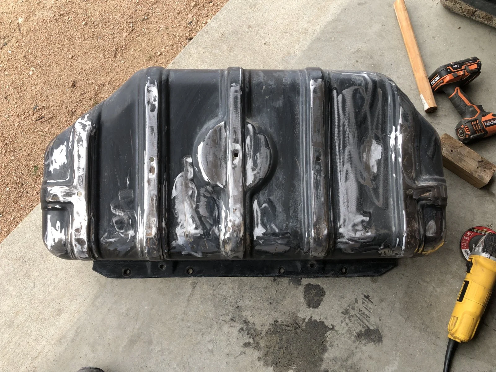

Sanded down as far as I’ll go for prepping
82721

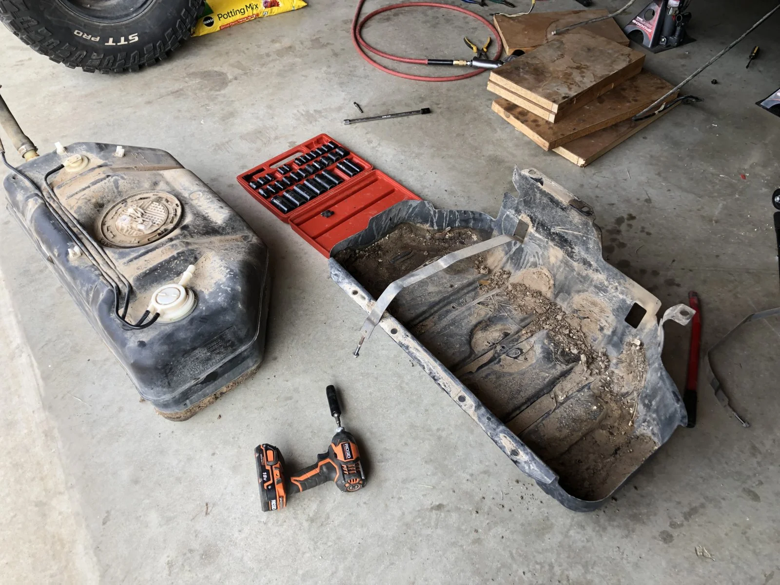

When they first came off the rig
82722

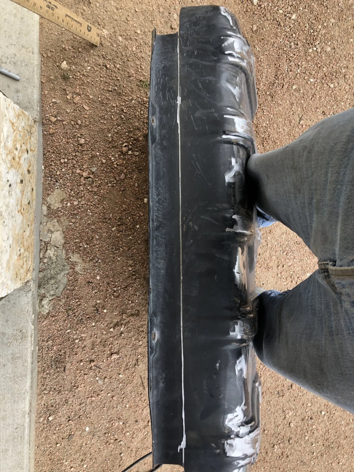

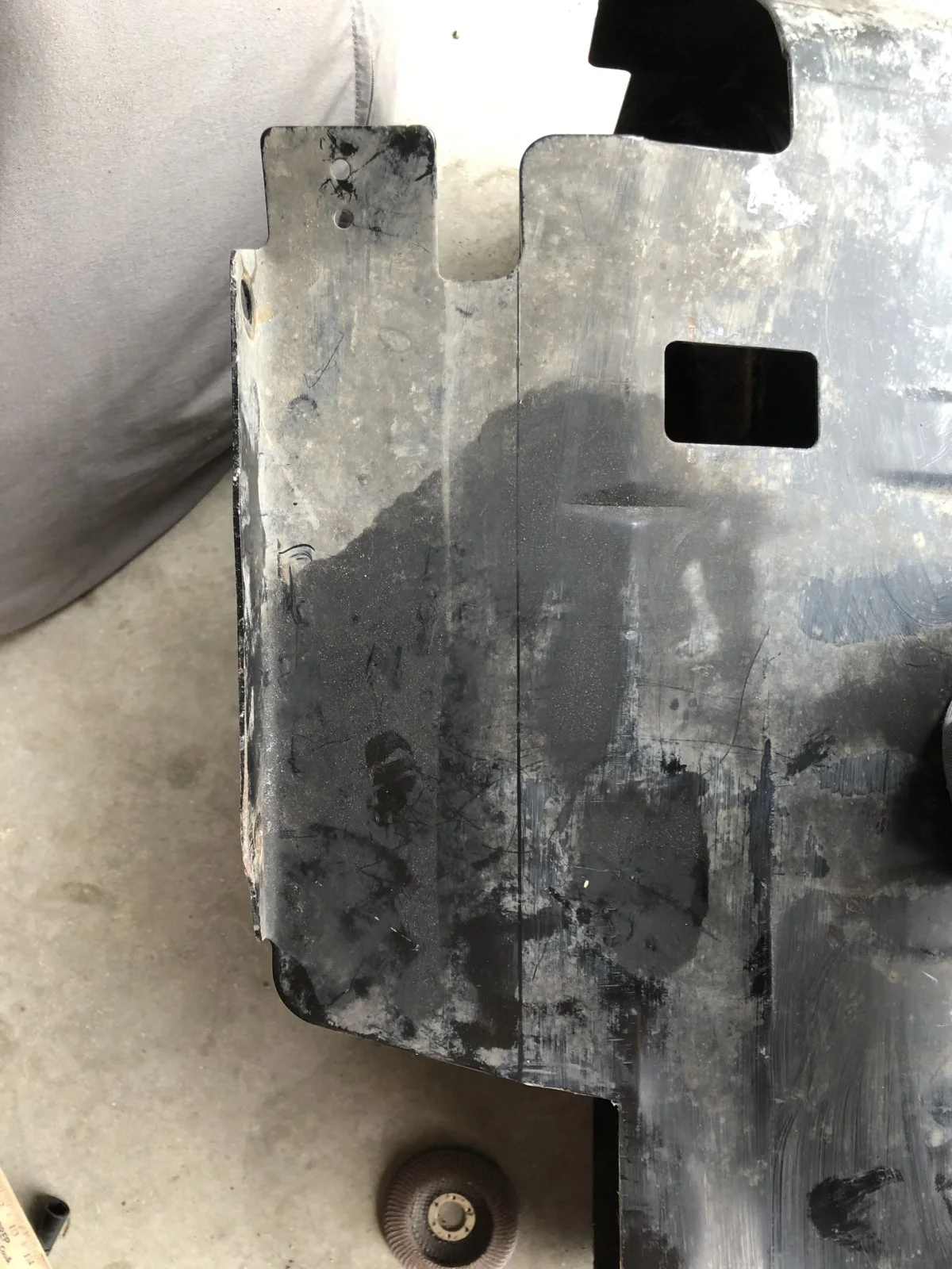

You can see the line where I cut the skid and later re-tacked it 1.25” shallower
82724
82727
I’ll paint it tomorrow and it will look like a new car with hail damage.
Thanks @Mike_H, nice write-up. I’ll be painting mine today. I really need that 1-1.25”. Hopefully this will help some.
It made a HUGE difference for me. Before...I would bang that thing all over the place. After the 2" lift and 1" GT tuck, I don't know that I've hit it. I'm sure I have, but its not something that sticks out anymore. Now...its the stupid factory TC skid. I've got ideas there too, man...
