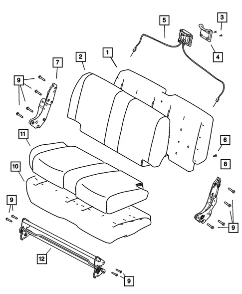

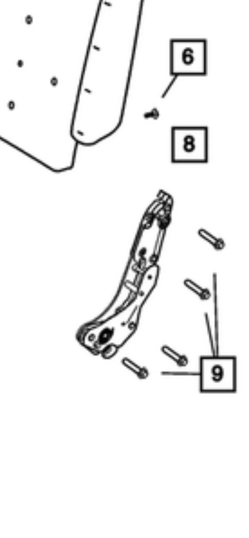

Trying to restore a 05 rear seat, but run into a problem. The latch mechanism (part 8 in the pics) is all rusted and won’t move, but seems riveted together. Has anyone ever taken this latch apart or have a source for replacements?
Bought the seat used and previous owner let it rust to where it won’t latch so hoping to sandblast the metal, paint and reinstall.
I looked through the “How To” section, but couldn’t find anything relating to this.
