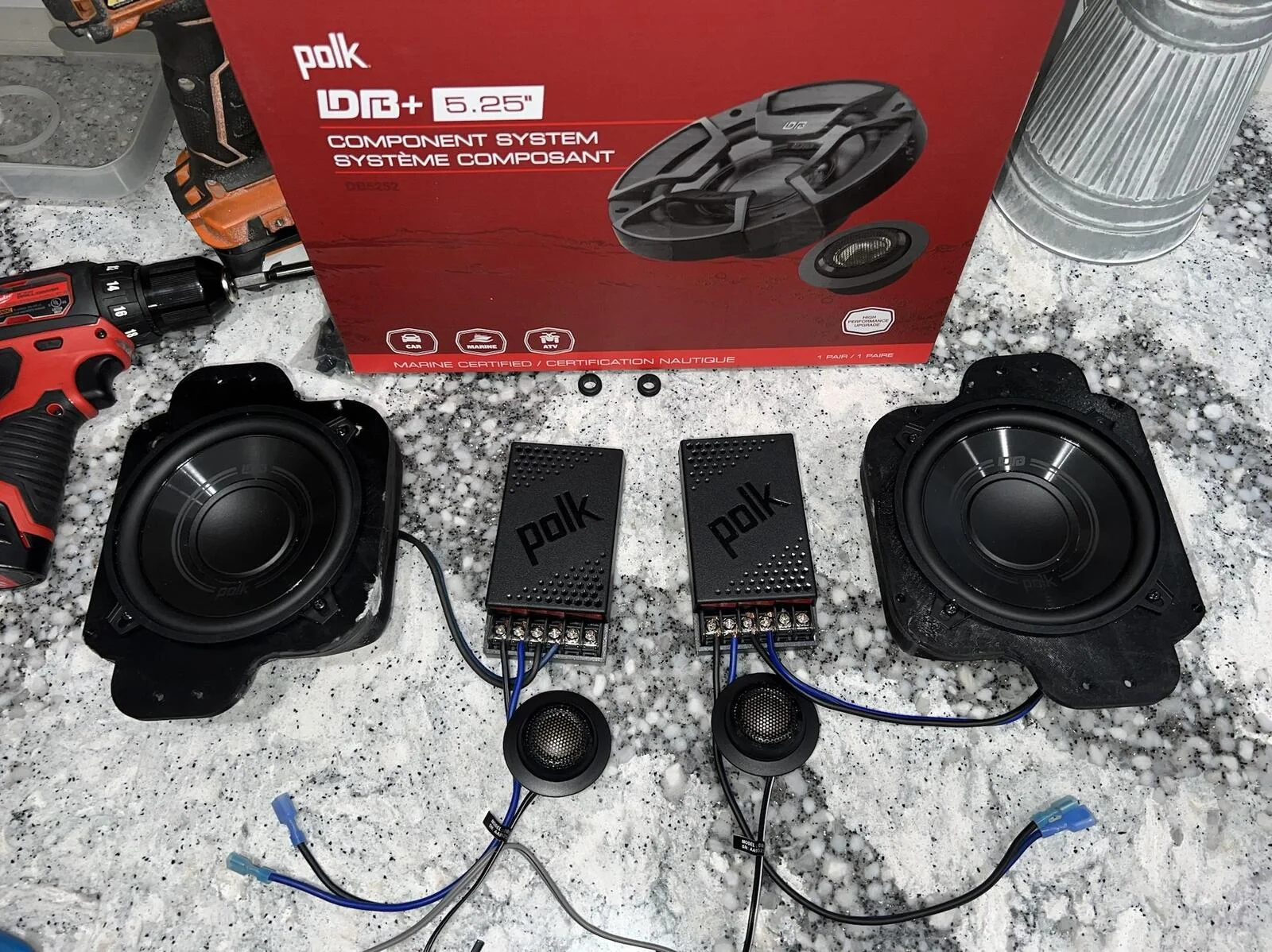

Short Term Speakers: I've got some 16yr old very lightly used Polk db525s in my CJ-7 that would be an ideal quick fix since they aren't going to be used for at least the next 6-9 months until the 7 is road ready again. The only problem with this is that getting the driver side speaker out is a real pain given all the other stuff back there, and putting something back in wouldn't be much fun either. I'm not sure the money saved using something on hand is worth all the effort and tool throwing that would be involved making it happen. I also have some 16 year old Polk db 6500 and db 650s in my daily driver that would be decent for kick panel pods and sound bar pods, I could pull those and then upgrade my truck where quality speakers have a better chance of succeeding, so to speak. I know these Polks are all pretty efficient with head unit only power and the marine certification is always a bonus for a Jeep. Past that, as I mentioned above, I'm considering the Kicker DS, CS, or KS series, the Polk db522, or maybe even the Hertz Unos. I know the Polks were popular 5 years ago but it has been at least that long since the model has been updated and they have fallen somewhat out of favor as a result - I'm keeping them in consideration due to my past experience and their marine certification.
No matter what speaker I go with, I'll be using the brackets that shift the aim more toward the driver's torso instead of their knees as well as some baffles I have leftover from a previous install. I won't be going with the select pods as I'd rather spend that money on kick panel pods.

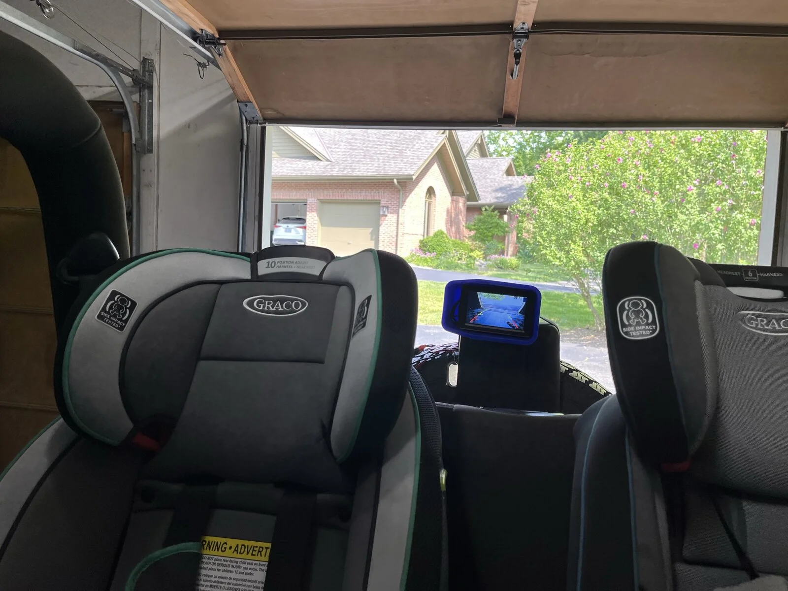

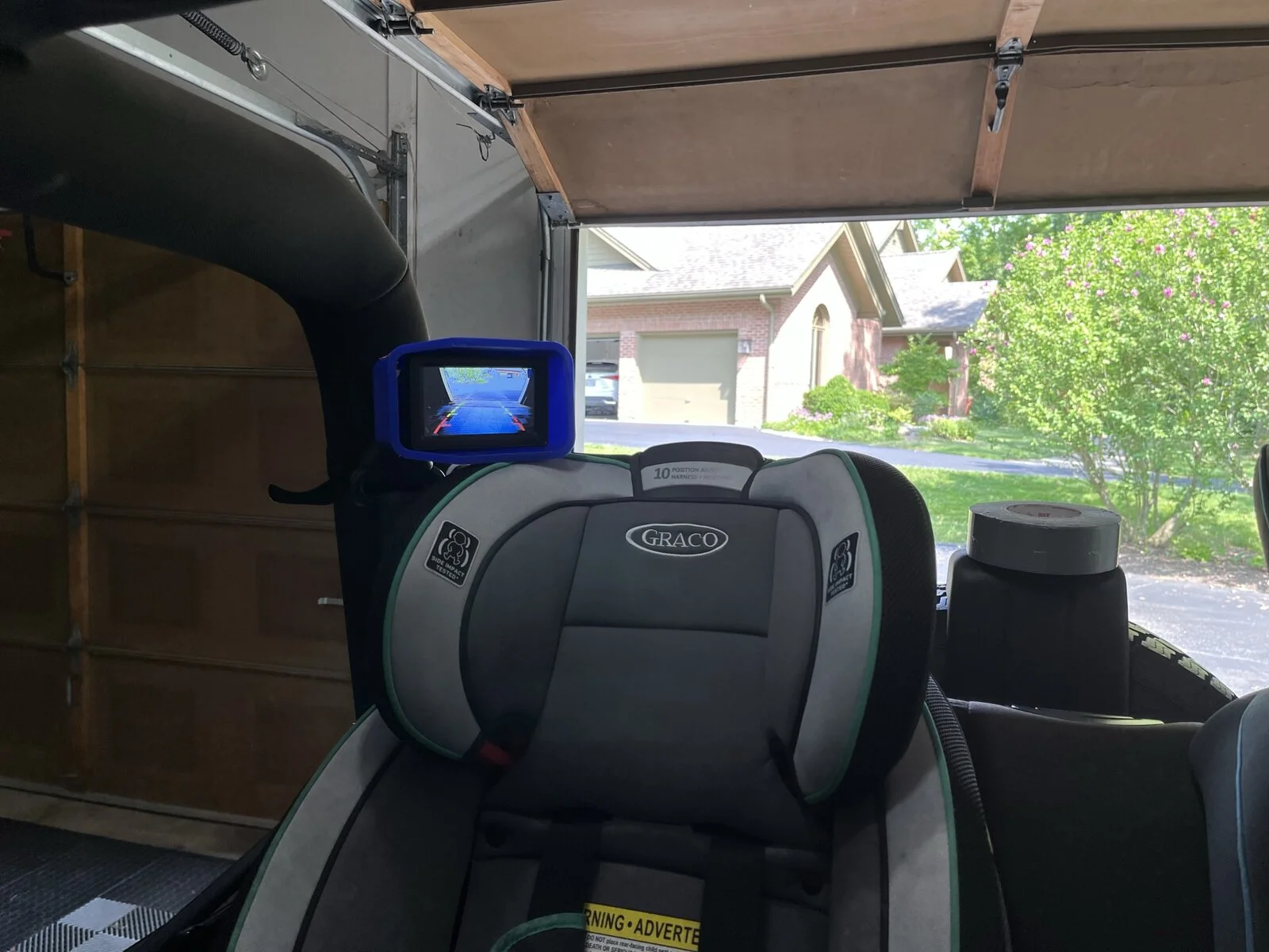

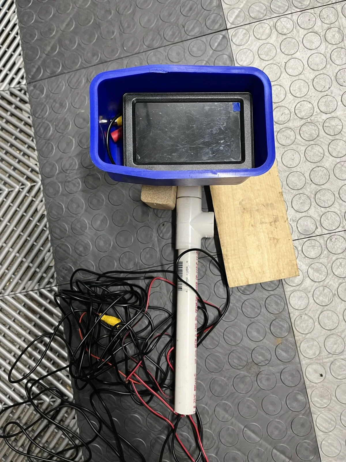

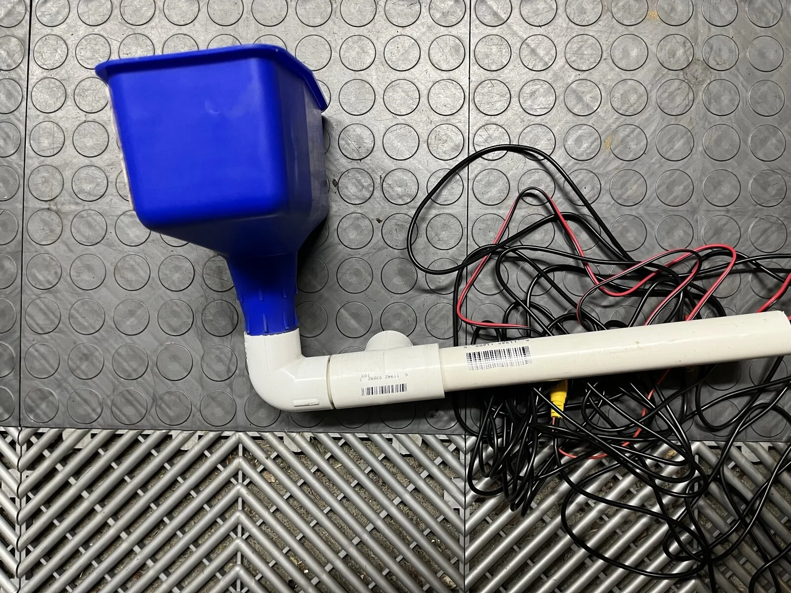

I was using this as my front camera before I decided that the front camera idea didn’t do much for me function wise.
Ill run it instead of a different rear camera because this one is of higher quality.

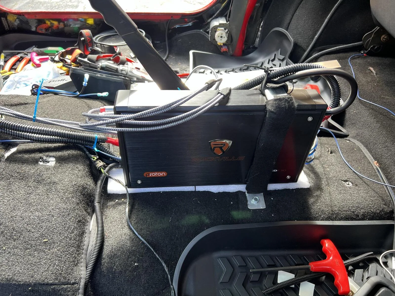

Get an amp, figure out where to install
Mine went in the center console and I wired it all from there
I tossed the junk OEM sub that was there, this fit zero problem
The bracket is just a 2” wide piece of aluminum from Home Depot lbent to shape, and.hot glued fabric on it for some cushion

I ordered a pair of the Polk db522 and they should arrive today. Not sure if I'll keep them but I started to feel like if I didn't order something soon I'd just get stuck in my paralysis by analysis phase and still be trying to make a decision in a few years.

Imo, the polks are cheap enough to just buy another set and save yourself the headache of moving parts around.
Agreed. The ones I have don't fit great where they are in the 7 due to the top mount depth so I had to use some spacers. The db522 would be a better fit there. But that driver side speaker was such a pain it may take the speaker not working at all for me to pull it back out.
Good info. If that old sub wasn't sitting around unused I wouldn't even consider it, I'm not even sure I want to go thru the effort of installing it in my truck that I bought it for way back when given the better options available now. I may just try to get a little $$$ on eBay for it and move on to something newer.
What are you using for wiring and wrap? In that pic it almost looks like flexible steel conduit, is it split loom? I've used wire wrap in the past which has a very nice clean look and offers flexibility for wires having different entry and exit points but is a pain to actually wrap and isn't easy to add more wires to at a later time without unwrapping and rewrapping.
Your build brought Skar speakers to my attention, I hadn't heard of them before. If I go with kick panel pods and amp, I'm definitely going to consider their Maine SK65MB
https://www.amazon.com/gp/product/B07RSKRV8Q/?tag=wranglerorg-20
I bought 3/8" wire loom for the power wire
https://www.amazon.com/dp/B07PNBYWMP/?tag=wranglerorg-20
I bought 1/4" wire loom by 100' for the 14 gauge speaker wire I used for all speaker runs.
https://www.amazon.com/dp/B07KDFD3WP/?tag=wranglerorg-20
Also make sure you buy quality shielded RCA cables so you're not picking up any harmonics.
Length will depend on where you mount your amplifier(s) but mine was 6.6' x 2 for the deck to center console
The sub I have a hop off point from the amp RCA outs
I also have this speaker terminal set for crimping on the proper connectors.
https://www.amazon.com/dp/B08HH6RL1H/?tag=wranglerorg-20
Something like this bypasses the need to carry spare fuses for the amplifier power wiring also if you decide to use it.
https://www.amazon.com/dp/B078XQJFSW/?tag=wranglerorg-20
[URL]https://www.amazon.com/dp/B07PNBYWMP/?tag=wranglerorg-20[/URL]
[URL]https://www.amazon.com/dp/B07KDFD3WP/?tag=wranglerorg-20[/URL]
[URL]https://www.amazon.com/dp/B08HH6RL1H/?tag=wranglerorg-20[/URL]

I did get a chance over the weekend to start mock up work on the back up camera system.
Having a view out the back of the vehicle in or on top of the dash is nice for when you first go into reverse or while you are backing up/trailering and passing over the dash image while switching focus back and forth between side mirrors. But having the image in the dash isn't as helpful if you are trying to look out the back of the car while backing up. As I tend to still use the old school method of actually looking back when backing up I want a monitor somewhere in the back to fill in the blind spot while I'm turned around in the seat. The 2 places I have in mind so far are on the back right vertical of the roll bar or on top/back of the brake light.
This is something I want to get done fast but also don't know exactly what I want long term (monitor size, enclosure, mounting location) so I'm just using parts on hand for the prototype. I'm using a camera and monitor leftover from previous projects, scrap PVC, and a locking oil funnel for the housing. The housing will not only give it a mount but also some shade and hopefully some cover from the rain.
So far it looks like this:
I used a heat gun to soften the neck of the filter to get the PVC through. The taper of the filter causes the monitor to pop out so I'll probably have to create a ridge for it to sit in - I'll probably use the heat gun to do this as well. If this makes it past initial design and testing, I'll rattle can it all dark grey or black so it blends in a little better.
Location testing:
I like the roll bar view the best so far, but I'm a little concerned it is less protected from the elements and that it may just getting ripped off at speed. The brake light location is more protected, probably easier to secure and potentially better for running the wires, but I felt like I had to turn around more than normal to see it and that a larger screen may be necessary. A folded down soft top would also at least partially block it if it isn't on top of the light.
As for the camera mount, I tested 3 locations.
  1. On the tow hitch receiver. I like mounting a camera in the receiver plug/cover as it is easy to get the wires there and pulling power and a reverse feed off a 7 pin plug is very easy. Unlike mounting on the tailgate it is a fixed position so not as much concern with snaking wires through hinges. You can use it to back into place for towing and then just pull the whole thing out and disconnect the wires to put in the hitch. I wasn't a huge fan of the viewing angle at this level, though. It would have shown the absolute minimum necessary but was dominated by the ground and didn't seem to show the blind spot as well. Maybe if I changed the camera angle a little bit it would have been better, but as of now I'm calling this doable but not ideal
  2. On the bumper. Slightly better angle, still a fixed position, don't have to remove it for towing. Would require some drilling into the bumper or some kind of tie down to mount it, so some better some worse here.
  3. On the spare. This had the viewing angle I liked the beset. This is where the factory mount is for newer Jeeps so there are brackets/cameras available for exactly this location. Cuts down the options if I want to get a cover for the spare (there are some with the whole for the camera but there aren't as many design options). I would hopefully be able to run the wires through the same loom as the brake light and it would be a very short wire run to the monitor if I mount it on the brake light.
I'm leaning toward roll bar mount for the monitor and spare for the camera at this point.

A few quick updates:
Got tired of reading/planning and switched to install/experiment mode. I put a set of db522s in the dash with the MTX angled adapters. Clarity is greatly improved. Volume is slightly better at 40 but still no use at 60, as expected. Bass is still muddled, also as expected. May not be the best all around sounding speaker but I liked the versatility it offered being marine rated.
Gave up on the previously posted approach for the back up camera monitor housing and will be going with a NEMA enclosure instead. If it works, I'll post pics and a link. I realized a few days ago that the brake light wiring doesn't go thru the hinge but connects via contacts on the door frame/tailgate so I'll have to come up with another plan for running the wires.
