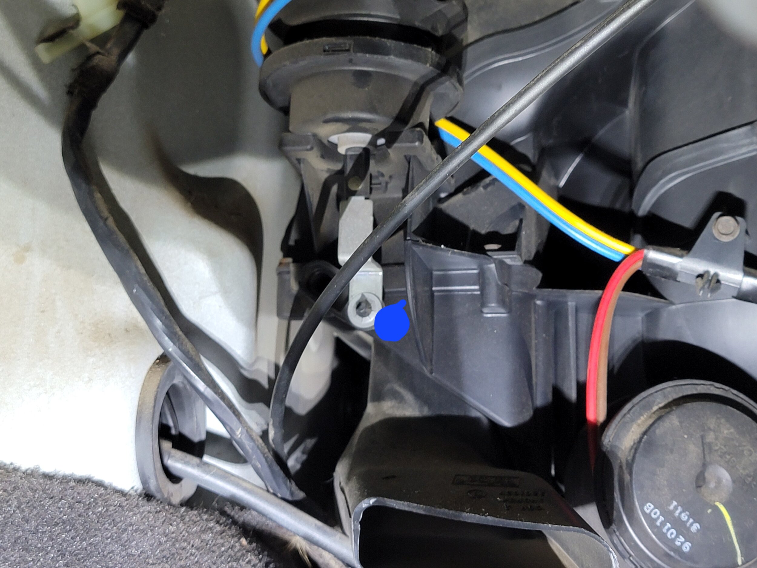

Since my actuator/door is stuck in "up" position, I was thinking I could disconnect the actuator, and drill a small hole with a circular saw as recommended roughly where the actuator arm would be in the "down" position.
My use of the terms are up and down are relative to the position of the actuator/arm, not necessarily the doors actual position on the interior of the hvac.
This would be roughly where I marked in blue. The actuator is in what I would call the "down" position here, as this is the wrangler we have at work.

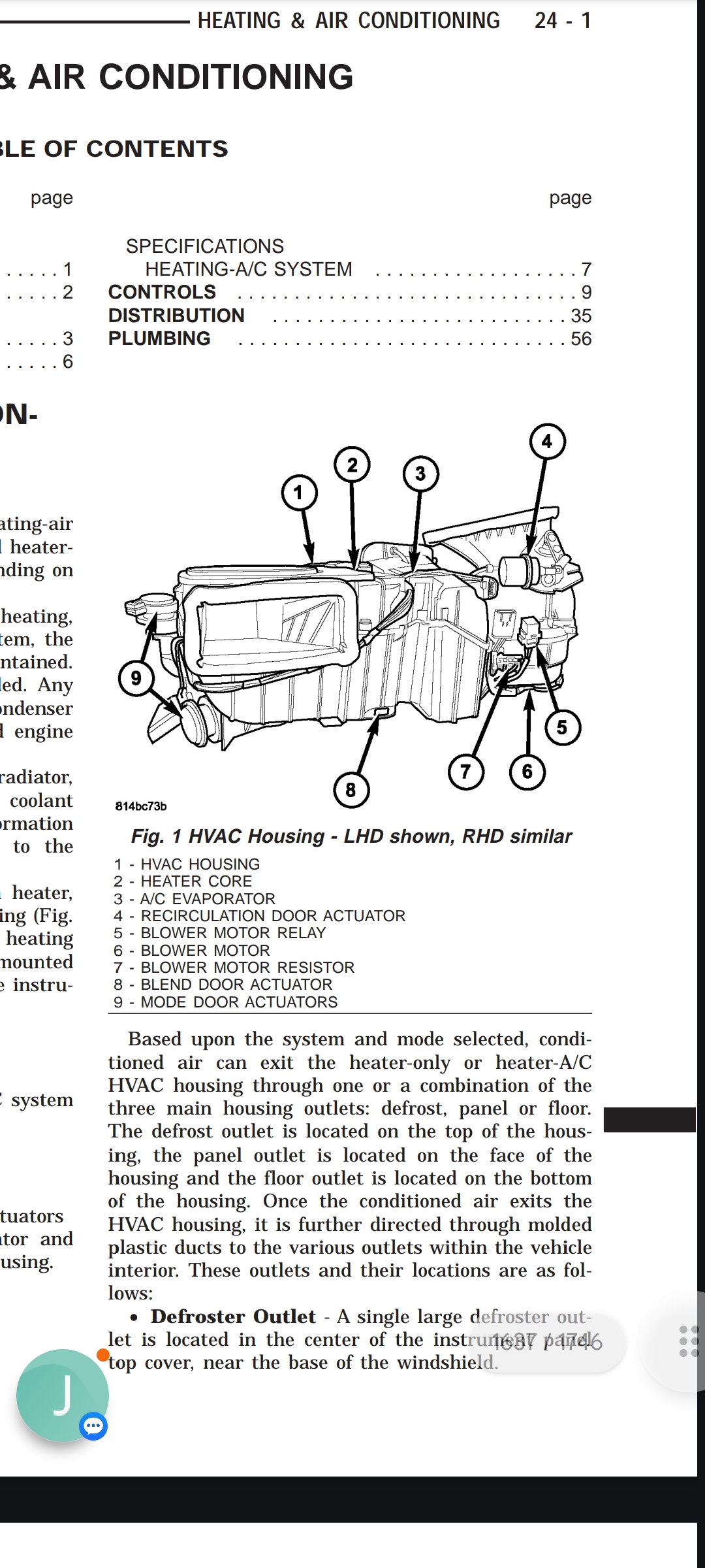

Based on this diagram, I should be well clear of anything I want to avoid right?
I would still take great care when making the hole however.
Then I could position some compressed air to blast more directly at the door to break some stuff free.

I would not compromise the integrity of HVAC box. The only issue that you will encounter, is you'll need to get the AC evacuated and recharged.
Do it the right way... doing it the shortcut way turns you into the next DSPO. Remember the phrase... "Don't start vast projects with half vast ideas..."
