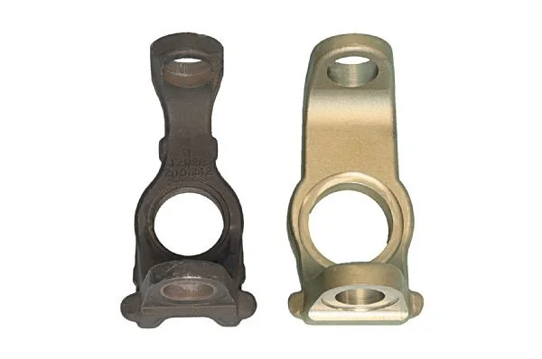

You could start "small" by sleeving it (*requires drilling holes in your factory axle tubes to rosette weld the sleeves in place) which will boost your strenth up 30%, Off Road Evolution offers sleeves for your axle. You could gusset it, as well as truss it as well. But at the end of the day it still has smaller inner C's and small Dana 30 diamter tubes. Sleeving, trussing, and or gussets are usually a suggested route as you may not need anything more than this. I guess a good question to ask yourself before throwing money at your Jeep is, are you actually breaking parts?
Stock inner C compared to the PR44 inner C:
