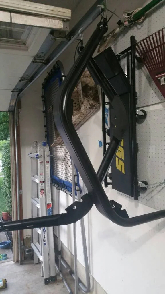

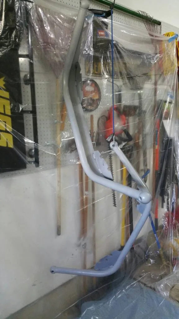

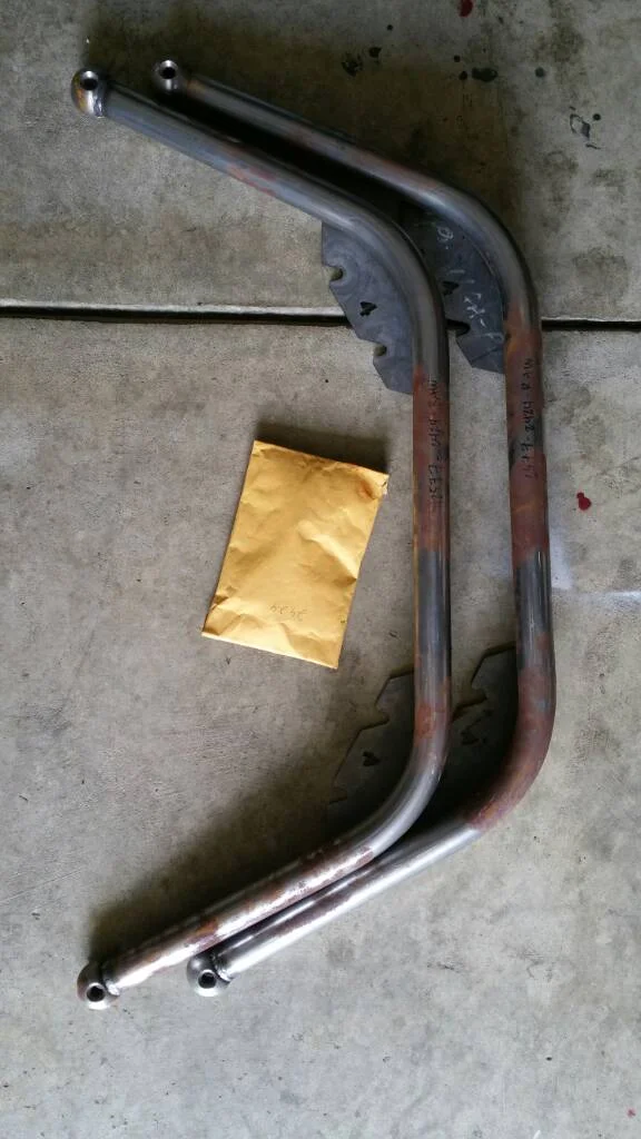

Picked up some metalcloak rear fender flares today for dirt cheap. Now I just have to get the mounting plate and install them.
There was slight surface rust, but it came off easily.
Primer coat

Nice man, those look like brand new. Did you media blast them or just rough them up with some sand paper?
Reactions: joshself
I used a cheap scuff pad from autozone and took about 30 minutes on each to make sure I hit every spot. There was no rust left afterwards. Then I cleaned up the fine particles/shavings with xylene. Finally I did two coats of primer with a 4 hour dry time in between. Paint will be in the morning.

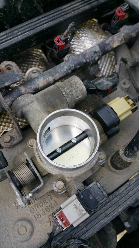

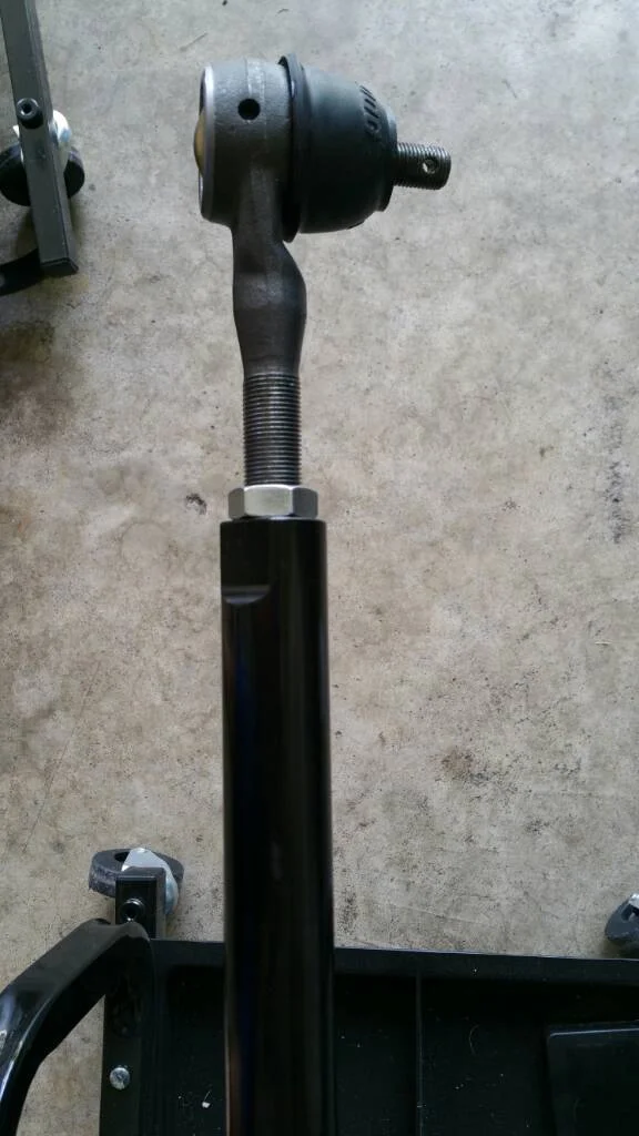

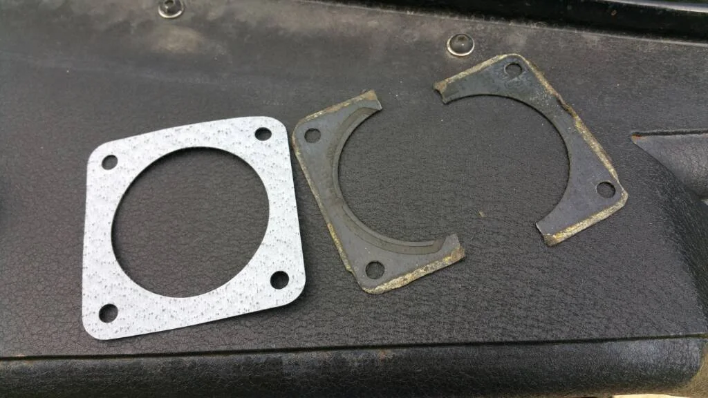

Finally got the Moog tie rod ends for the new tie rod (maybe now I'll finally install it) and put a new gasket in the throttle body. The old one was cracking.
