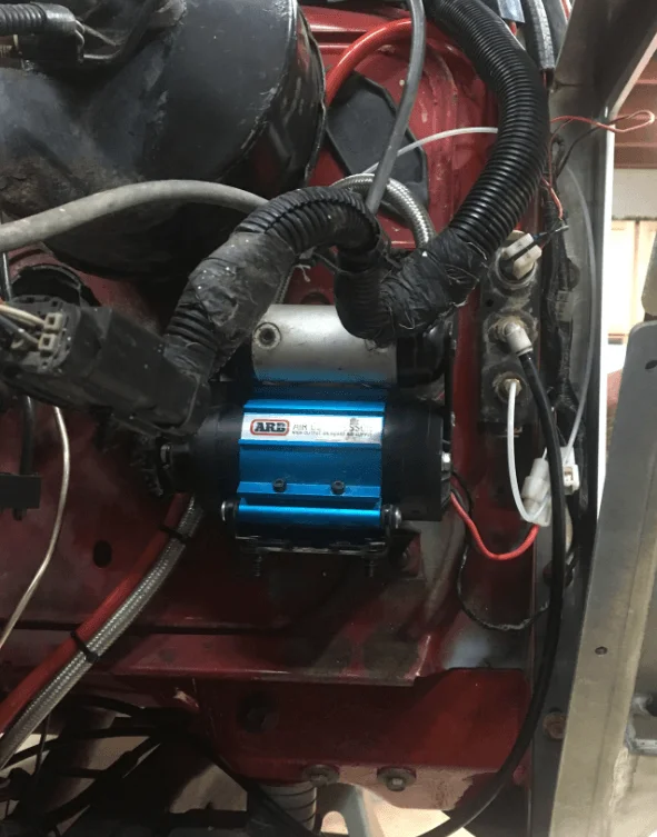

It's all good :) Yeah it's on the ABS tray. I also made a mount for the quick release fitting to make it a bit more convinent to hook up.
EDIT: Added pic from build log

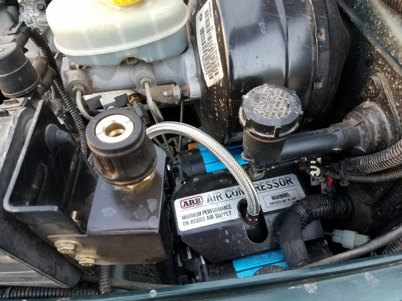

I mounted mine in front of the airbox behind the passanger headlight. I would have used the abs tray but the location is already taken by the oem rubicon locker pumps. Did your tummy tuck require you to relocated the locker pumps or are they still in the stock location?

I do went with ARB CKMA12V due to the size and paired with a 2.5 gal tank and is able to inflate a 35 x 12.5 R15 from 10 PSI to 27 PSI in around 1.75 minutes the pump making one pause while the tank empty out.
I have never attempt to run any power tool with this system.
Installed on the ABS tray and now that Hi-Lines are in I fabricate a bracket where the ABS tray mount was to have installed in the same area. Much cleaner and organized install.
One thing I have never complete is the pump filter intake relocation to inside the cab where it can breath cleaner and cool air but, i do recommend it if you head this direction

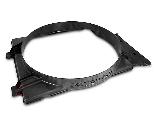

It required that I trimmed a very small amount of material off of the fan shroud. Then I just went to homedepot, got a piece of steel that roughly was the same width as the pump, cut it to size, drilled holes for the pump to attach, then attached the steel plate to the tub in front of the airbox. I wouldn't have needed to trim any plastic but being able to remove the filter element without the whole pump needing to be removed was a big concern for me.
I attached a photo of the little amount of plastic I had to trim.
I attached a photo of the little amount of plastic I had to trim. View attachment 63313

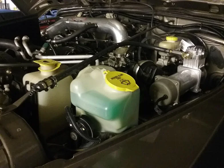

Here is a link to my simple onboard air system using a Viair 400H compressor: https://wranglertjforum.com/threads/how-to-simple-onboard-air-for-your-tj-lj-viair-400h.10235/
