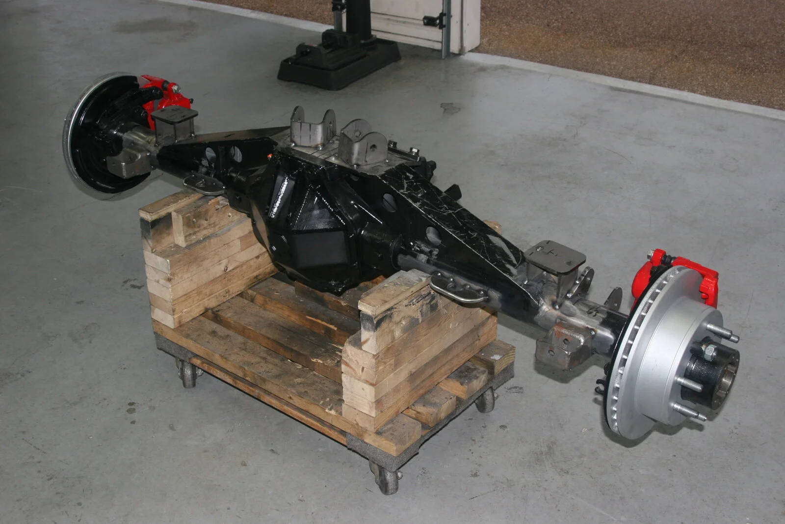

OP - If you are interested, here is the write-up I did in my build thread:
https://wranglertjforum.com/threads/nashville-tjs-build-continued.42035/post-753648

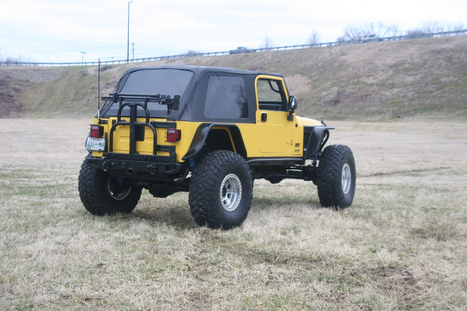

But seriously - does this 14 Bolt make my ass look big???

Not a chance. You look great, honey!🤣
