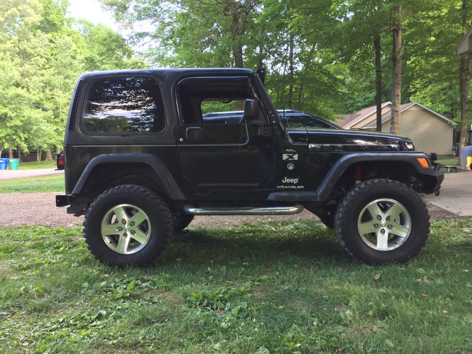

I had to switch to JK 17" wheels, I want the 15" wheels back. Here are 33" on 17" wheels, 4.5" lift. Looks silly to me.
I agree with your assessment. But isn't it because the tires need to be bigger? Not the rims smaller? I think it would look the same. As the gap between the fender well and tire will still be to big.

Those are 33” tires, they are big tires already, they just look small on the 17” wheels. There’s quite a bit to swap out just to run a 35” tire, and I’m not going to toss money at it right now.
I’ll run what I have for now until the tires need to be replaced. I think if I put a flat style fender flair it may look different.
