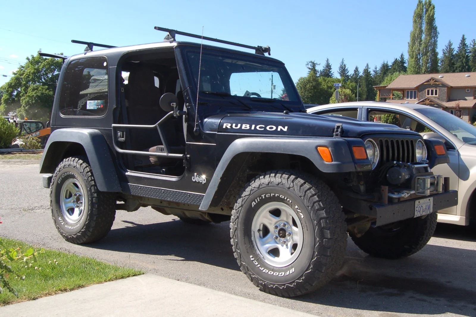

Any of these will fit the 31x10.50R15s
I'm running 33x10.50R15s on the stock 15x7 Steel Spoke Rims. Stock Rubi suspension too. So 31x10.50R15s should fit a '98.
