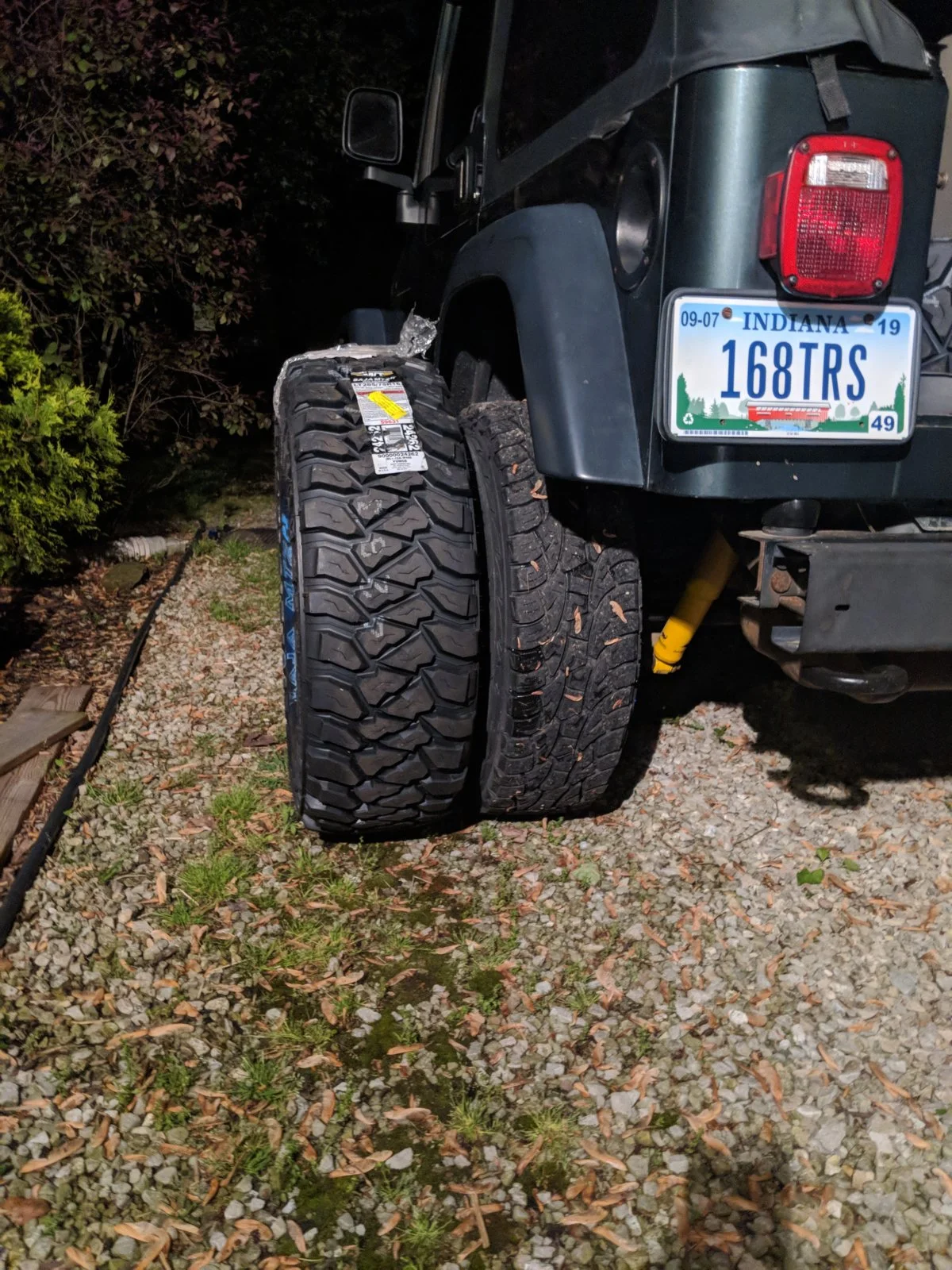

There are not any good 285/75/16 tires in load C, most are load E which is the size and type of tire I run (MT MTZ P3). It is a heavy tire that does not have a ton of sidewall flex, I air down to around a 12 psi on the trails. I've never had a load C tire to compare it to but do not doubt a load C would absorb more of the road imperfections. Love the look of them with the MOAB wheels though, a few washers on the steering stops helped prevent rubbing until I got my Antirock.
