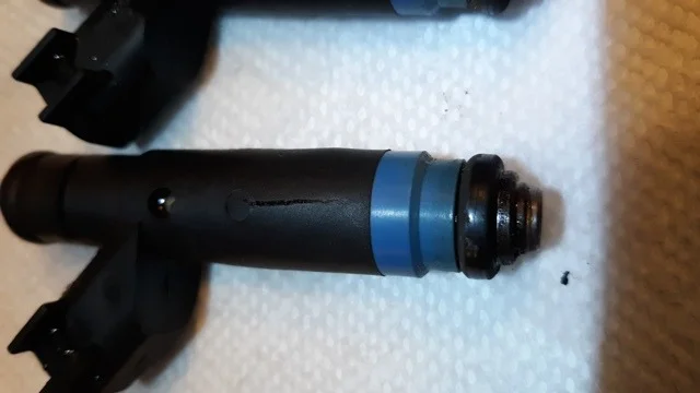

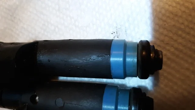

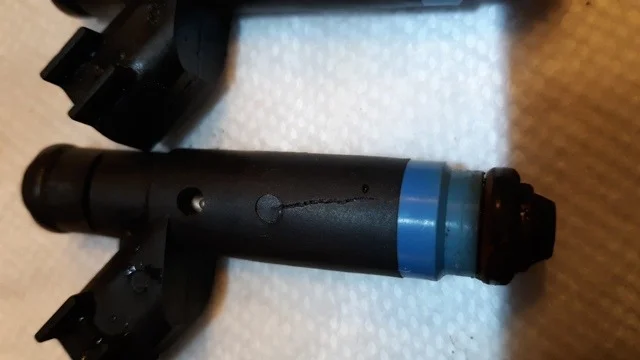

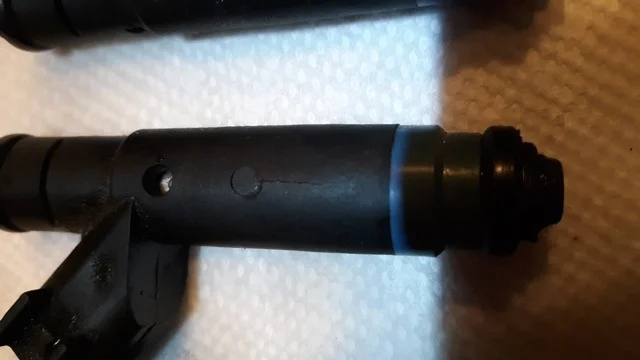

@Jerry Bransford , do you think cracked outer housing is grounds for replacement?
No, that outer rubber sheathe is not what keeps the gasoline inside.
Yes, I realize that but with most other kinds of parts, a cracked housing can point to another internal problem (swelling, freezing, overheating, etc). My experience with fuel injectors has been mainly from a manufacturing and testing perspective with FoMoCo. A crack like this would be cause for concern, even though it won't cause a fuel leak.

Thank you, sir. I'll keep that in mind for now. I'll seek expert advice about the cracks. If they're no big deal, then I'll just rebuild (or have rebuilt) the ones I took out. If any of them are not rebuildable, I will certainly take you up on your offer!
Yes, that's an option. I'm going to try cleaning and rebuilding first. They're oval-connector Deka injectors (you can see in the pics)
