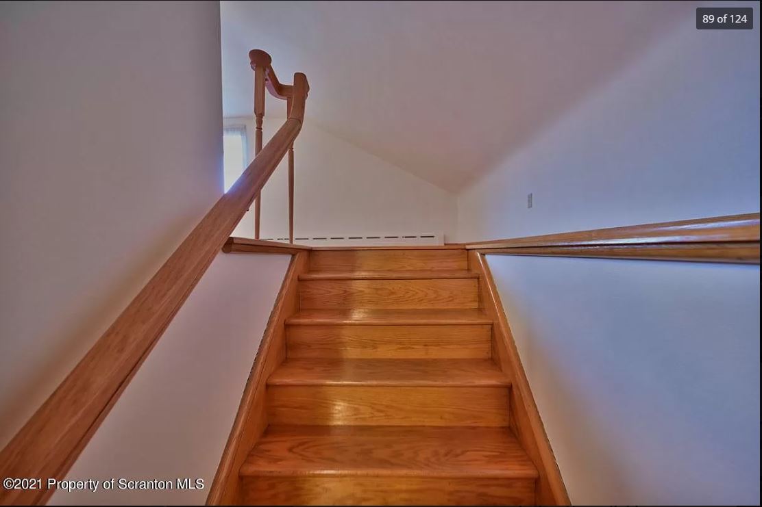

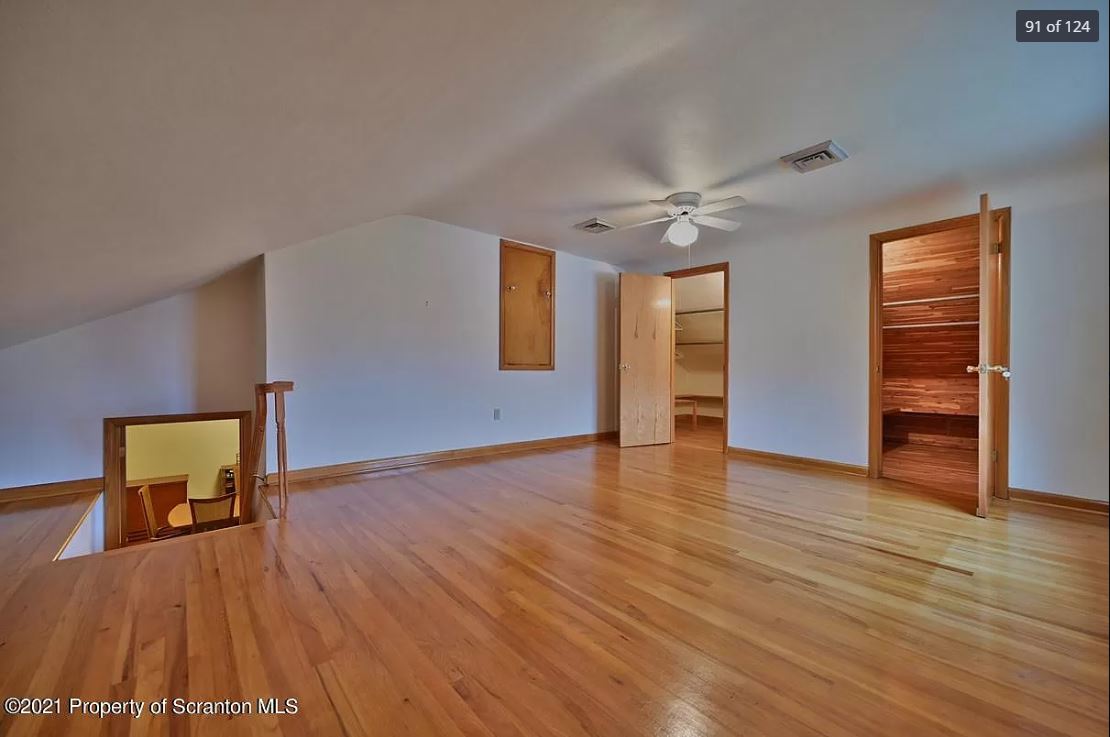

The door leads to stairs...
...to a decently sized room with all hardwood, heat, A/C, good lighting and two huge closets (one is a cedar closet).
I would like to deck this room out as a proper office but also a reading room/library (it's quiet up here!!). I was thinking that since it's attached to our bedroom, it would be fun to keep it "private" when not in use. Could also be a good place to store a gun safe :)

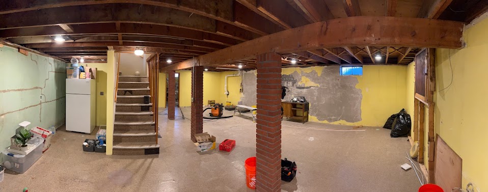

Had a 20 cu yd dumpster dropped off and planned for the whole house to help me get the basement cleaned out. The kids were excited to help and I even promised a trip to our local favorite diner. Well, come Saturday 8AM, no one was nearly as excited as they were at 5PM the day before, so it ended up being a one-man operation.
A bit counterintuitive, but the first thing I did was clean up the basement some before tearing into it further. The cats have enjoying clawing all the previously tore down ceiling tiles it to pieces. A quick sweep and pick-up of the smaller pieces let me have "working" areas with easier to manage piles. I sorted pieces by their size in order to better facilitate getting them out of the basement.
Thankfully, the basement still has an old coal shoot doorway that led straight to the garage, which was 10' away from the dumpster. You can see the square door in the wall in one of the photos below. This saved me a lot of time and stair climbing, to which my knees and back were appreciative of. I piled small pieces in buckets and large pieces into my ice fishing sled just outside the coal door, then dragged it through the garage and into the dumpster. As Jim Halpert put it, "porque es muy rapido!". After that, I pulled down the rest of the ceiling cardboard and bagged up the insulation (it was moldy and had some mice droppings, so I "rolled" it down and put it directly into garbage bags).
Once again I paused for a moment and did a "clean sweep" - allowing me to think about how to best manage the next step, which was pulling all the studs from the walls. The process went surprisingly easily, as a 2-3 smooth whacks with my 3 lb. mini sledge did the trick. A few studs had outlets installed, dropped from the ceiling lighting, so I waited to do those until the very end.
With the studs off the walls (most of them at least, I did have to leave a small section to temporarily support the coal door), a lot of the peeling stucco came off, either by gravity itself or with a gentle persuasion from a small scraper (the bright square at the top of the image above is the coal door leading to the garage).
When I finally got it all cleaned out, I realized again how big this space actually is - it's 31' long by 25' wide. When subtracting the stairs and not counting the laundry or mechanical rooms, it's 700 sq ft of usable space (that's as big as our first apartment!).
With my 2-day dumpster rental over, I did some final cleaning and disinfecting (I was using a mold/mildew biocide during the entire demo as I wanted to keep dust down and also address any potential biological sources). The basement smells 1000x times better already and I only found 1-2 areas where I think we may need to address some moisture issues. The first is by the fireplace, where I think water is coming down the vent itself or sneaking by some flashing and working its way down the brick. The second area is by the front entrance to the house, where I think there were clogged gutters at one time. The windows have some efflorescence on them as well, but I think that's partially due to poor sealing and possibly pooling around the lip. I have new windows planned anyways, so not too worried there.
Next up is to pull the nails from the ceiling (that held up the cardboard) and redo the lighting. All the lights are pull-switch style flush mount lights. Not only do they hang low (the glass covers are barely above my head), pull switch lights suck donkey d*%$. I'm going to replace them with 6" recessed can lights (going with the art deco/industrial theme), fitted with LED Edison bulbs, and a dimmer. This will be the "primary" lighting down here, for example when cleaning, during game nights, etc. I'm going to have plenty of accent lights as well, so while I'm running wire, I'll prewire a few things into j-boxes and have them ready.
I think we've decided to keep the fireplace as a working, wood-burning fireplace, so I need to have a chimney guy come out and inspect and possibly add a liner (since the exterior of the chimney is technically "indoors" when the PO built the sunroom). I'm also going to need to replace the doors and convection vents, as they're near rusted all the way through and falling apart.
Lots to do and lots to think about for any major next steps, but I have plenty to keep me busy for now...
