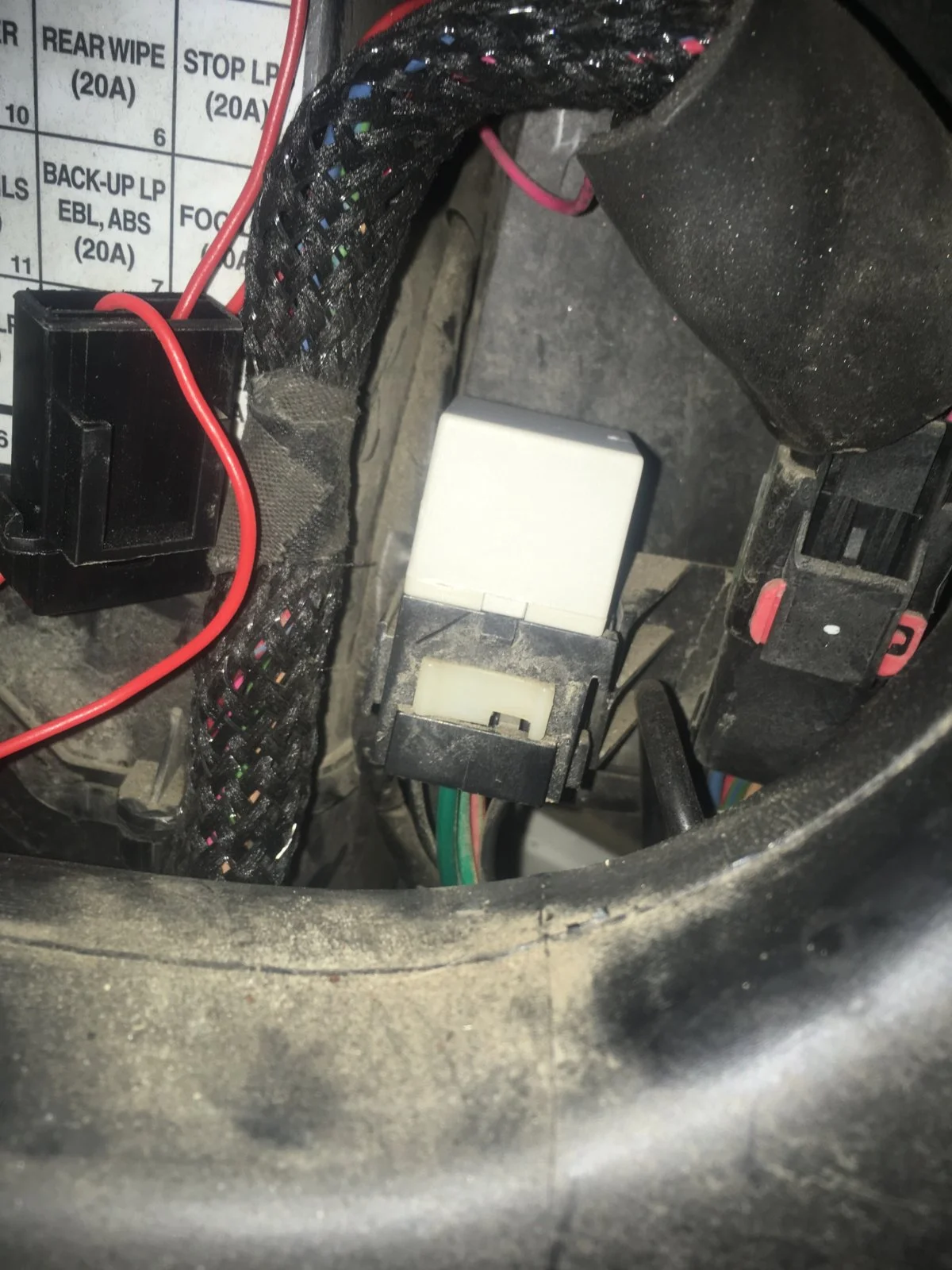

Well today I solved my problem. FINALLY!
I went to the store and got a blower motor switch after work, drove home and installed it. No difference. At this point I was ready to set fire to the jeep so I took another look at the FSM and under the heater/AC section found the location of the blower motor relay which was right behind the glove box sitting upright. I’ll try to attach a picture. Another trip down to the store to pick up a new relay and to return the blower motor switch and I have heat on all four settings! Thank you all for the input and help.
So in short if you only have air movement on the highest setting on your jeep try these three things in this order:
1) blower motor relay located behind the glove box standing upright (around $15)
2) blower motor resistor located under the passenger side kick panel (around $25-$30)
3) blower motor switch (around $30)
Keep on Jeepin’ on, now I just need to figure out my coolant leak...
