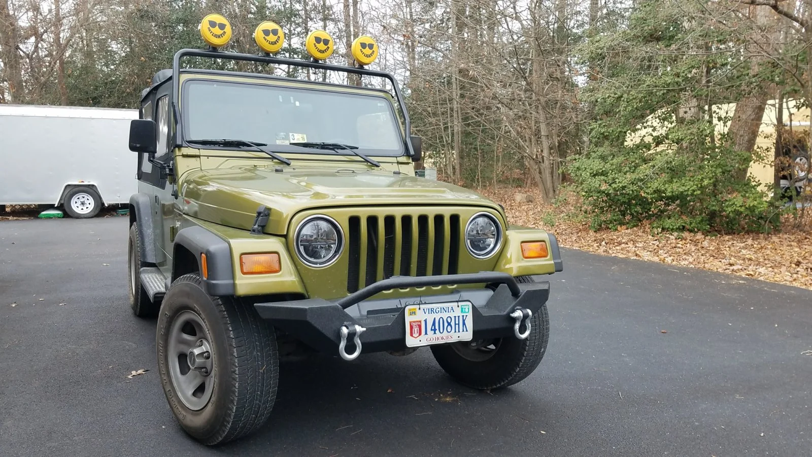

Okay so to start off, I have a clean 1997 Jeep Wrangler Sport in Citron Pearl (4.0L with 5spd manual). My mom bought it new in 97 and has babied it ever since. I started driving it around 87k and it is now nearing 92k and now that I have my license and a job I am able to start doing some mods to it, as she never did. Im not trying to do anything extreme but I do plan to do a little more than only overlanding.
Here is a fairly recent picture of it right after putting on the new bumper I got for christmas.

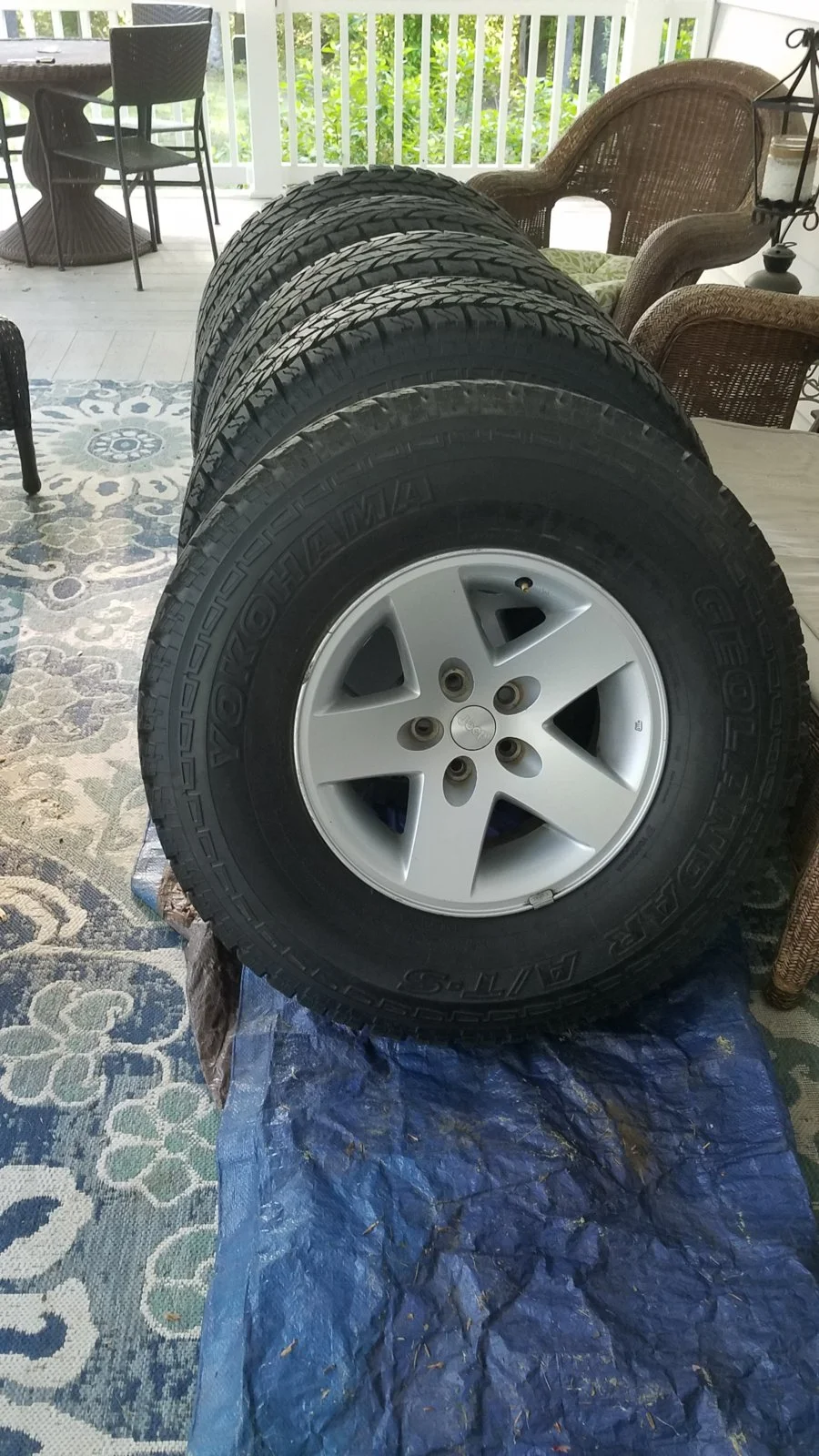

I was able to pick up a set of 5 16" Moab rims and some Yokohama Geolander A/T-S tires for around $750

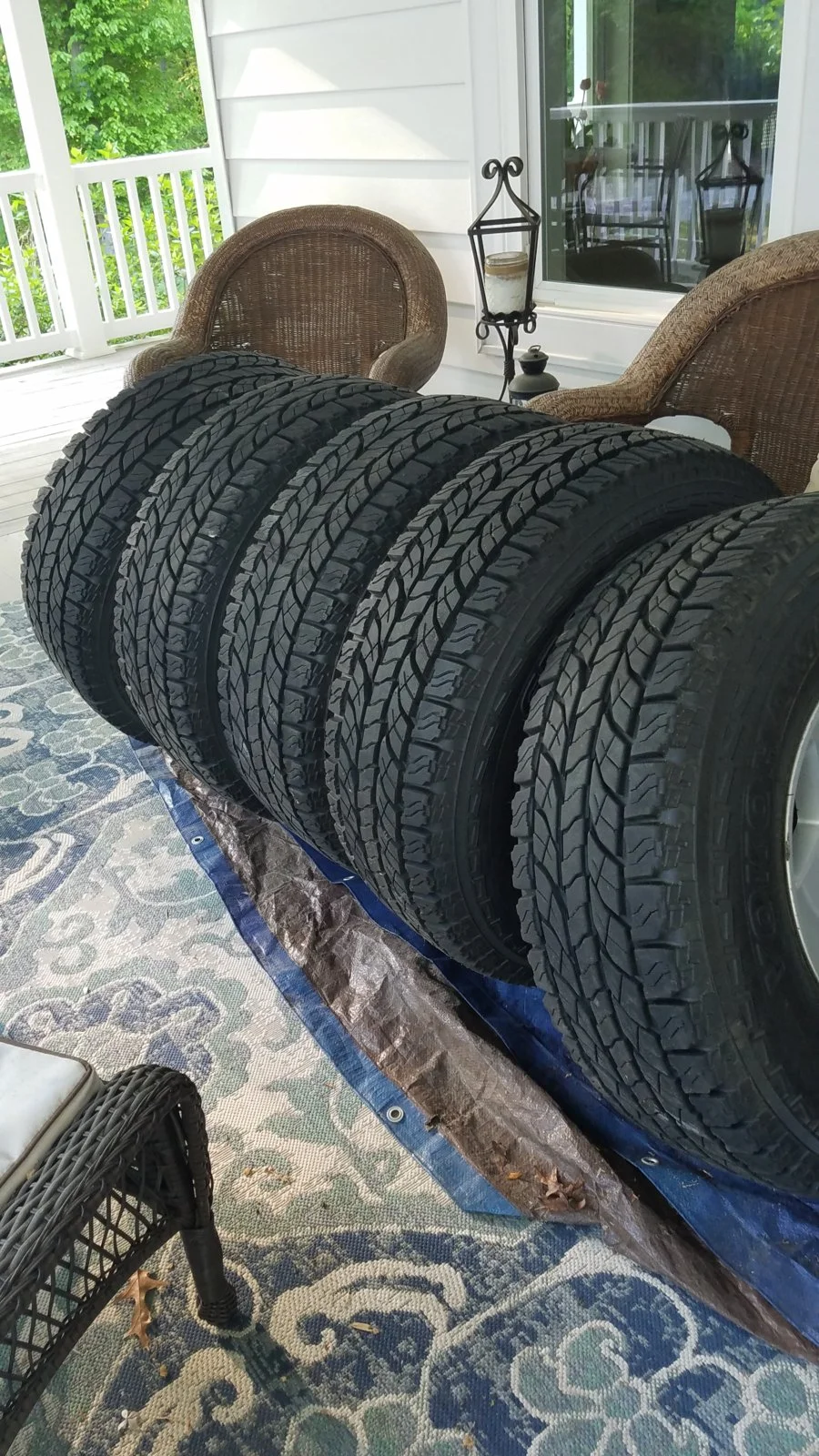

Whats the Metric size of those tires on the 16 in wheels? You may need to add a washer to your steering stops if you get any rubbing once you install those. I had to add a washer on my old 285/75r16 Maxxis, and my newer Duratracs were a bit worse with the more aggressive side wall. Love the Moab wheels thought, still running those on my Jeep as well.
Reactions: Chris S
Theyre 265/75r16. I love the look of the moabs as well, and I figured if i ever wanted to go to different rims or back to 15s I could help foot the bill by selling them since they seem to be a hot commodity in the TJ community.

Nice score on the wheels and tires. Once you get the lift on, the jury's out as to whether those will rub or not. My tires, the same size, 265/75-16, on the same wheels, barely rub sometimes at full steering lock. I did not make any steering stop adjustments.

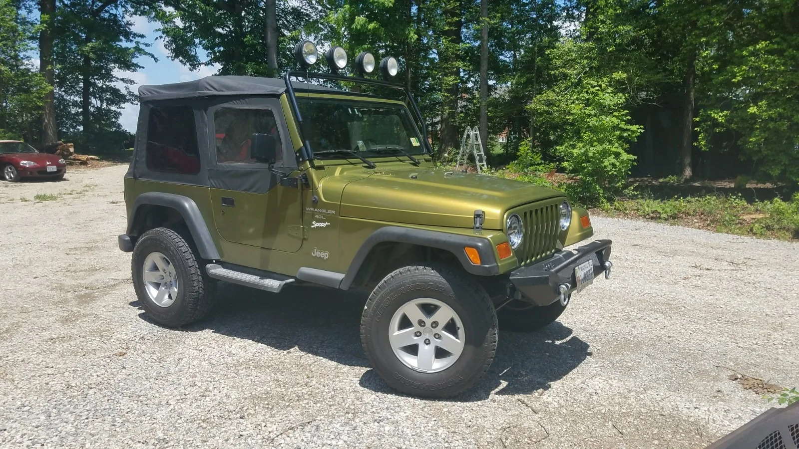

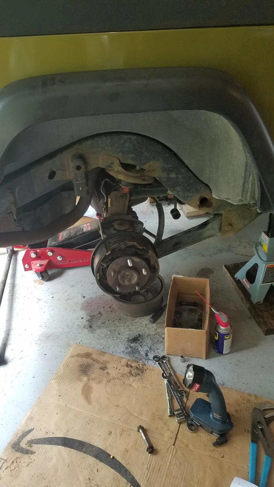

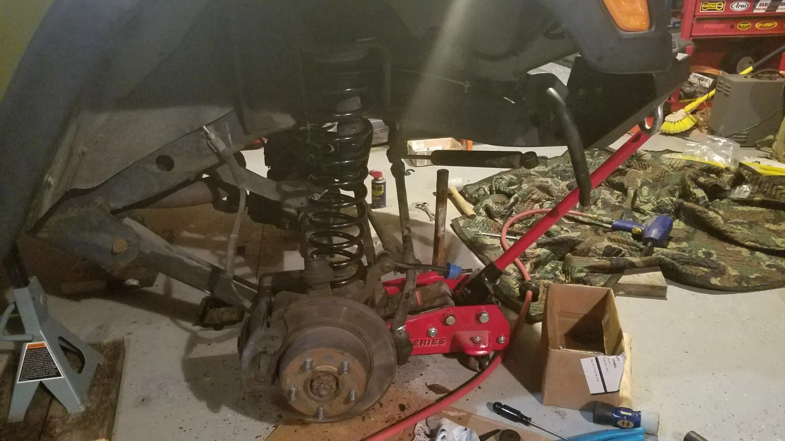

Installed the lift all day Saturday and finished up and tidied up sunday morning. Ran into a lot of issues with rusted bolts even after soaking them in tons of Kroil. Kroil is your friend haha! Was also able to get a much closer look at most of my frame and found a couple issues. Dont have any pictures for the time being but I will post soon to get some ideas for repair. Mostly surface rust except one part that may be a hole. Hopefully I get that solved but enough of the bad news, the good news is that the jeep is looking great.
Started with the rear suspension components

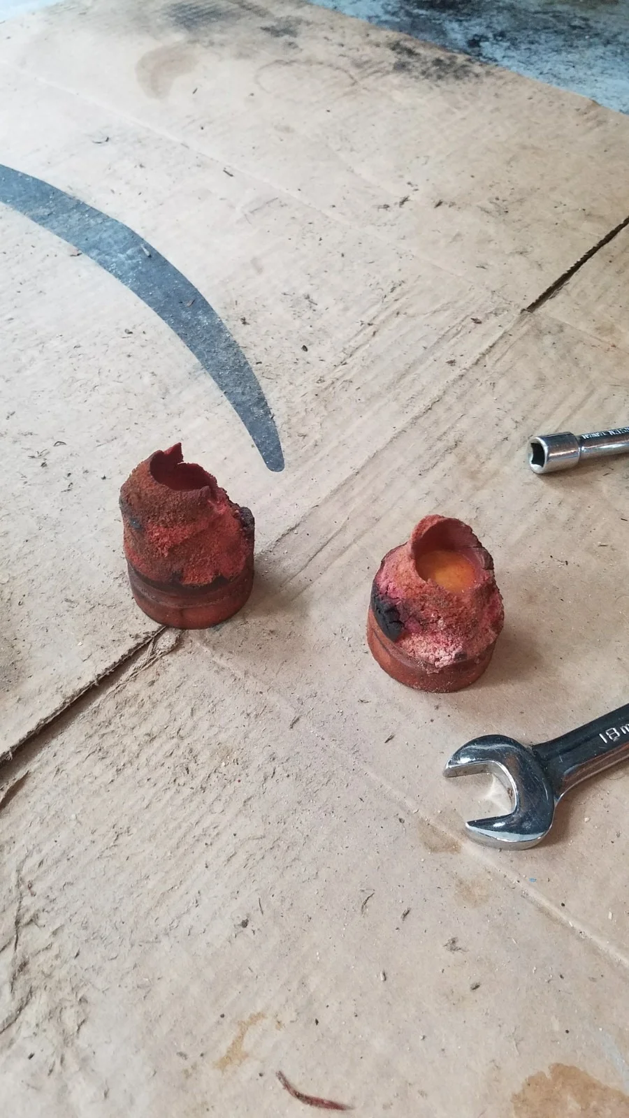

bump stops were practically gone, got some daystar replacements along with the ome spacers put on.
Trackbar mount and rear shocks went in pretty well, didnt have a spring compressor so rear coils kind of sucked, but i dont know where the pictures of all that went

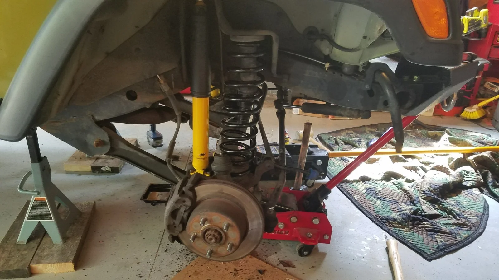

Next we did the front suspension, and we ended up just buying a spring compressor and got them in much easier.
The yellow shocks looked really good with the Citron pearl green
Finally the finished product, looks a lot more like a jeep with only a little bit of lift and bigger tires, can't wait to take her offroading. I will be putting on the spare sometime this week once i get some spacers for the rear brake light, need about an inch and a half more space. Also I have a little bit of rub at full lock so ill be putting on some washers to account for that soon. Other than that no vibes except for a little around 2nd gear going about 15, maybe thats a gearing thing? Should i lower the transfer case anyway? or should i just save up for a SYE and CV driveshaft to help with long term plans too? No vibes going above 50, so hopefully it will do fine on the interstate too. Any recommendations?

Wow, those jounce bumpers are practically disintegrated!

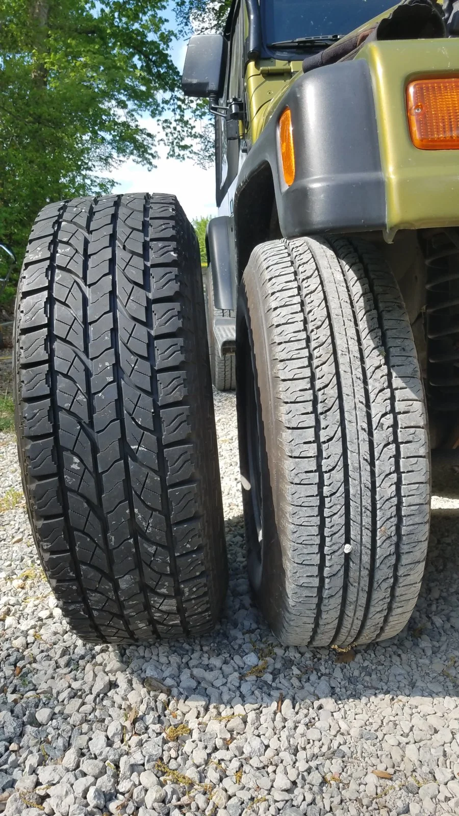

My speedo is off due to the bigger tires (265/75r16) but they are kind of in the middle of 31" and 32" tires. My gearing is 3.07, so should I go with a 27 tooth or 26 tooth gear for the speedo?
27 tooth. While a 265/75r16 is equal to 31.6", you'll find in the manufacturers spec for most tires, they are less than they claim. Yours will be closer to 31" than they are to 32".
