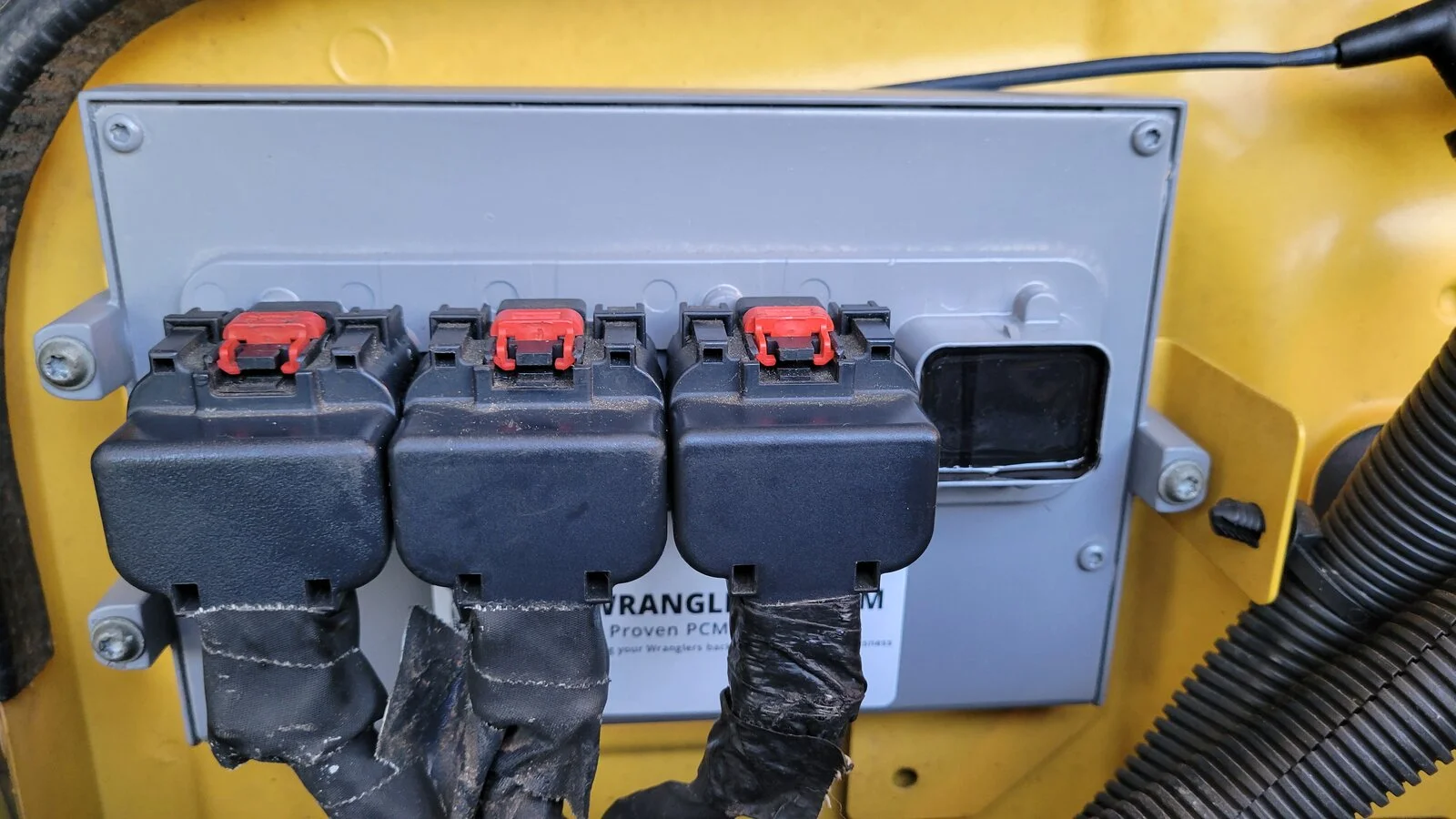

If YOU decide you need the ECM, I am 3-4 weeks on my new one from Wranglerfix. I can testify that mine works like a CHAMP. If that's the direction YOU decide to go in I highly recommend them due to Mark's service, shipping and oh yeah, it fixed my ECM problems.
