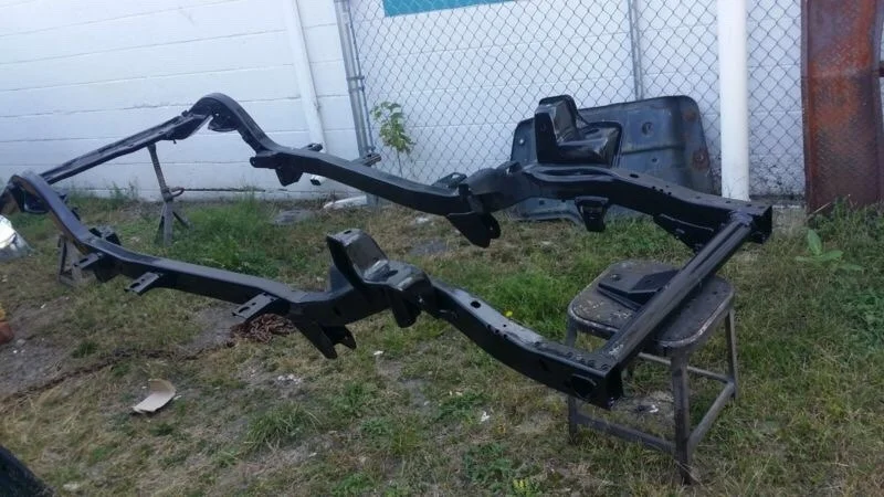

Hey y'all... I am in search of a frame. The rust near the rear control arms is beyond the point of repair. Rather than bracing this location, i'd prefer to set the body on a new frame.
If any of you know of one for sale, please, let me know! I am open to cleaning up surface rust and minor welding/bracing. If it's a like-new frame, all the better.
I'm located in a Minnesota and open to driving around 500 miles for pick up. I figure that will get me most of the way through WI, IA, SD and ND.

Check out http://car-part.com
Search within a certain radius of your zip code for a frame. It will pop up with any frame in your area. That site searches all auto wrecking yards throughout the entire US. Bookmark it, because I use that site all the time and it's never let me down. It's how I found my hard top!

Thanks for this. I've been requesting quotes/pictures/info from this site all day. May have a lead on a rear frame in Iowa. I'd prefer to not merge two frames, but may have to get crafty.

Ever ship anything vehicle-frame sized across country? Something tells me the price will exceed the actual purchase price of the frame...
No, but I've shipped cars and motorcycles a plenty across country.
Your best bet is to go on http://uship.com once you find the frame you want. Post a shipping ad with dimensions, size and description of what they're transporting. Shippers will bid on your listing and you can choose the shipper (and price) you want to ship it.
It's hard to say what you'd spend to have it shipped. The closer the frame is to you, the cheaper it will be. To transport it across country, I'm guessing you'd spend minimum $800. The good thing is that it doesn't need to be protected like an actual car, so it may be cheaper to ship than you think.

You're a wealth of information. I may have a frame identified. Thanks very much for your help!
