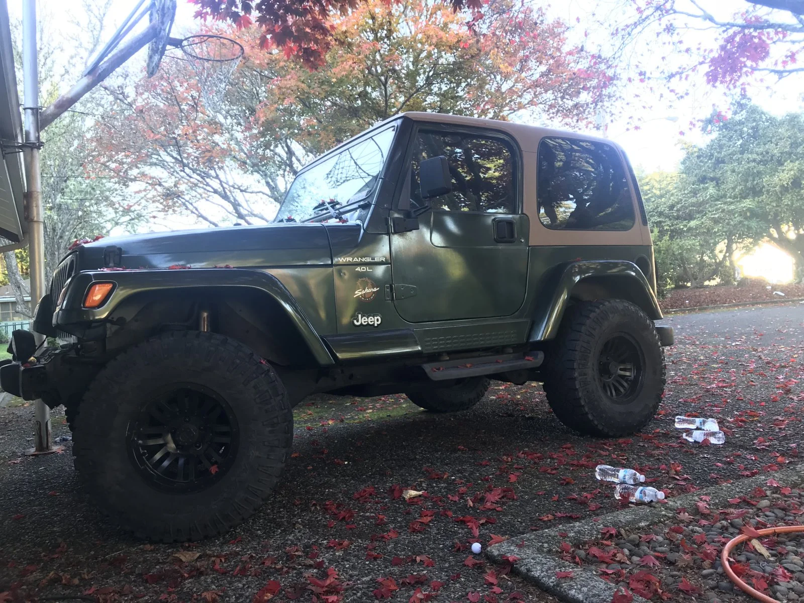

So, the first order of business is to make it more driveable. The PO didn’t know if it was lifted or not, but it is running 33x12.5. Based on useful knowledge found on this forum I measured the springs and determined it has a 2” lift (14” and 10” respectively).
The springs look ‘ok’ but the shocks are toast. They are rough country shocks, and according to the internet they are crap. May not have been crap when new, but I can tell you they are crap now.
I hear good things about Rancho shocks, but which model of shock do I need for a 2” lift? Or should I look at something different?
I should be clear that this is to make it driveable while I save up for a complete OME kit, but that will happen next year.

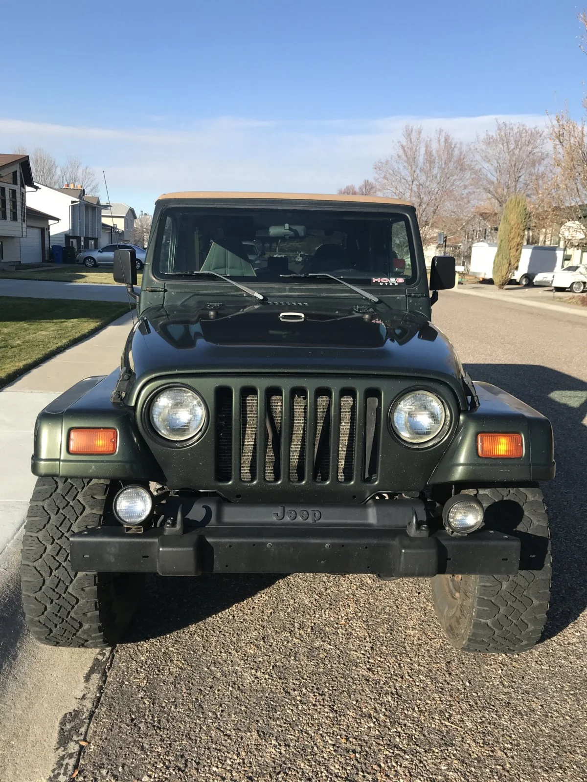

Help you out huh? I can help you out with some bumpers ;)
Kidding of course! But on the subject of bumpers, your fog lights seem to be directly in two entirely different directions.

Yeah, the lights needs adjusted and tightened.

As far as ride quality goes, Rancho RS5000X are the best shocks you can get without spending a small fortune. Sure, you could spend $1000 plus on shocks like me and have them tuned specifically for the vehicle, but that's a waste of time and money, unless you are really trying to build the hell out of it.
For a 2" lift, these are the Ranchos you'll want:
https://www.amazon.com/dp/B01963N4ZY/?tag=wranglerorg-20
You won't regret those. I've run Bilstein 5100s, Fox 2.0s, OME Nitrochargers, and Rancho RS5000X shocks. The Ranchos ride the best of the bunch, no contest.

To stay on 33’s and use the new Rancho shocks you really need a minimum of 3-3.5” of overall lift. To achieve this you can keep the springs you have for now, but the shocks run long and you’ll need a 1.25” body lift to provide for them and properly clear the 33’s. Later you can go to OME springs.

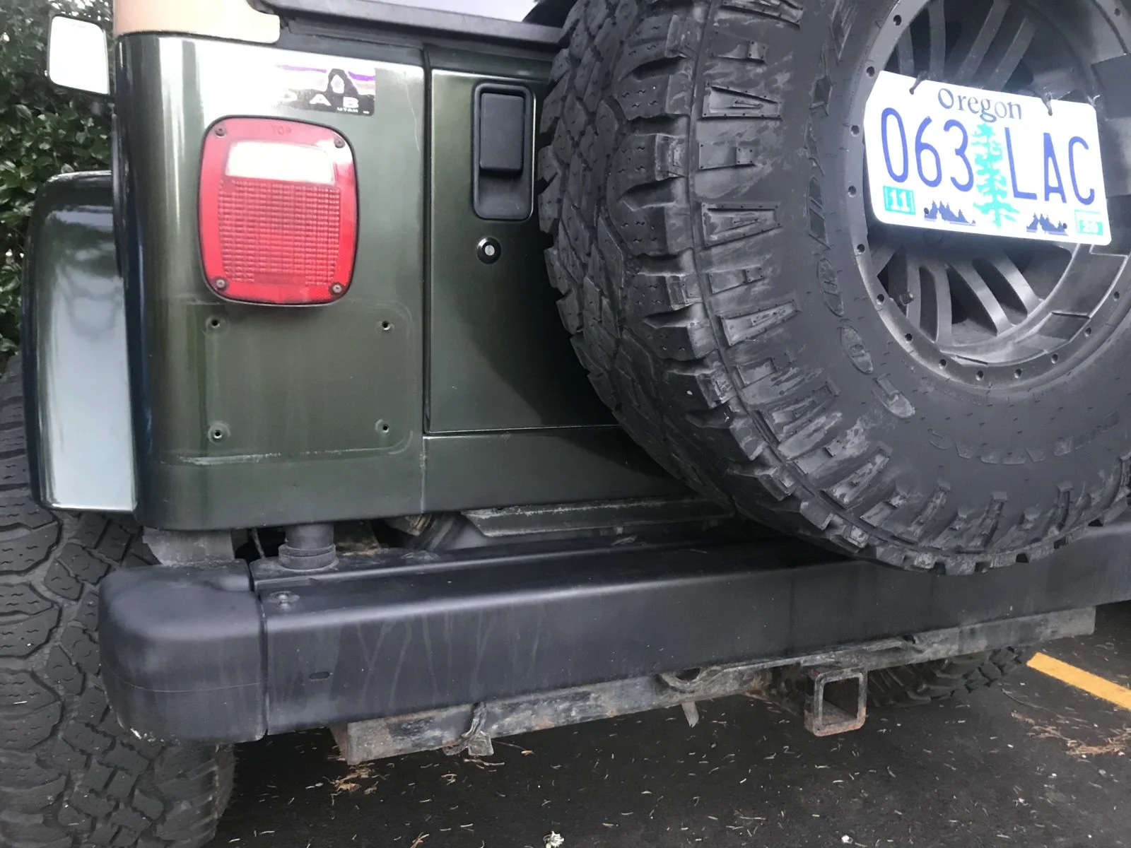

Okay, a little more help needed. It's great to get your thoughts, experiences and knowledge. So my question is, will you look at my butt?
All joking aside, and yes I'll post a picture later, I'm trying to figure out how much body lift I'm running, and I'm being lazy and don't want to crawl under the jeep until I get my garage cleaned out, and that will probably be after Christmas.
I think I have a body lift (after reading several threads). I am running 33x12.5's I have clearance and only rubbing at full lock. I have measured my coils and determined I have a 2" lift there (I assume rough country since that is what shocks are on it). So, how big is a stock butt crack? Anyone have pictures of a stock butt crack?
Show me your butts?
Do I need to start a separate "Show me your butt crack" thread?
bobthetj03
vibrajeep
Feb 3, 2017
8,068
NorCal
It's pretty easy to tell. Just look at the rear below the rear door. This is no BL.
