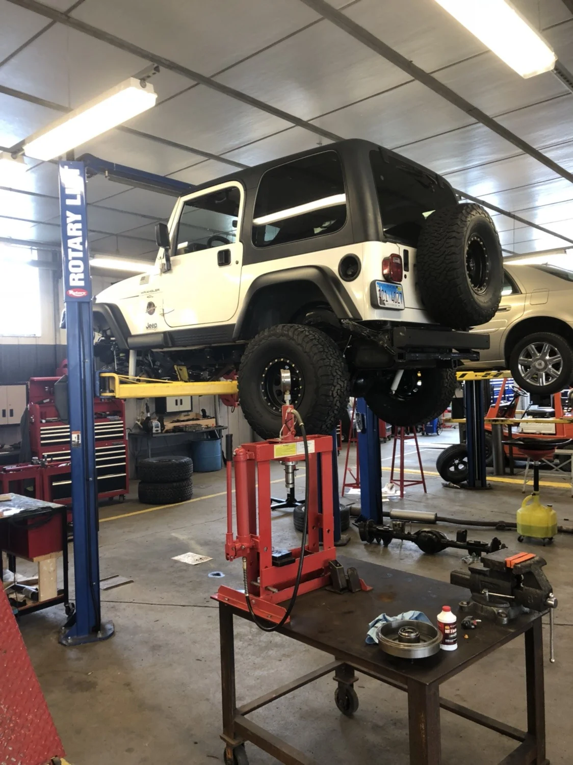

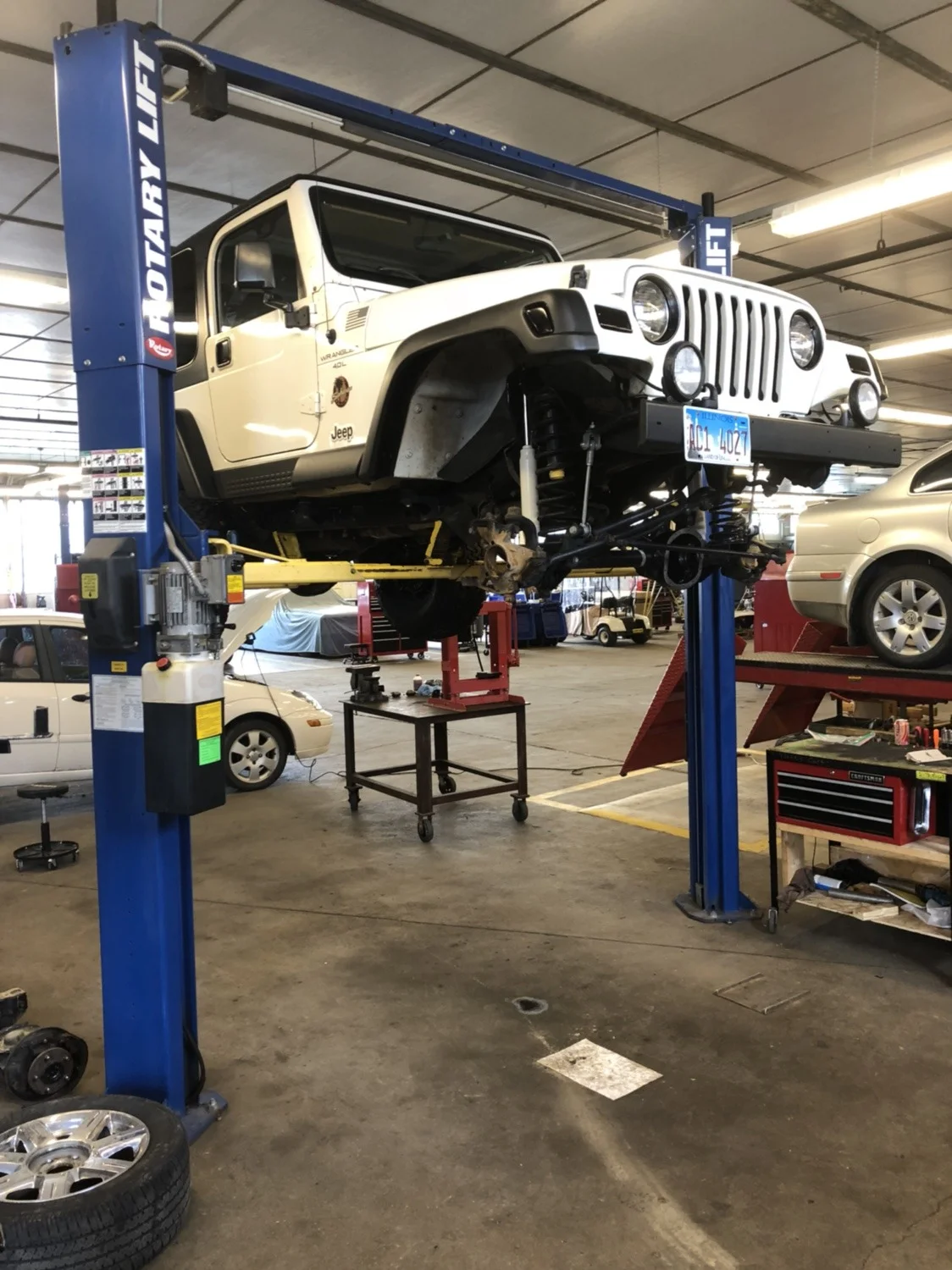

Finally got my 4.10’s installed. Pulled a Dana 35 out of a 4 cylinder tj and had quite a bit of trouble finding a Dana 30 so I bought a ring and pinion from BobtheJet and installed it in my current Dana. Replaced the front u joints in the process as well.
Everything went pretty smooth and I am happy to have some performance back. I need to get my new speedometer gear in and that stage should be over.

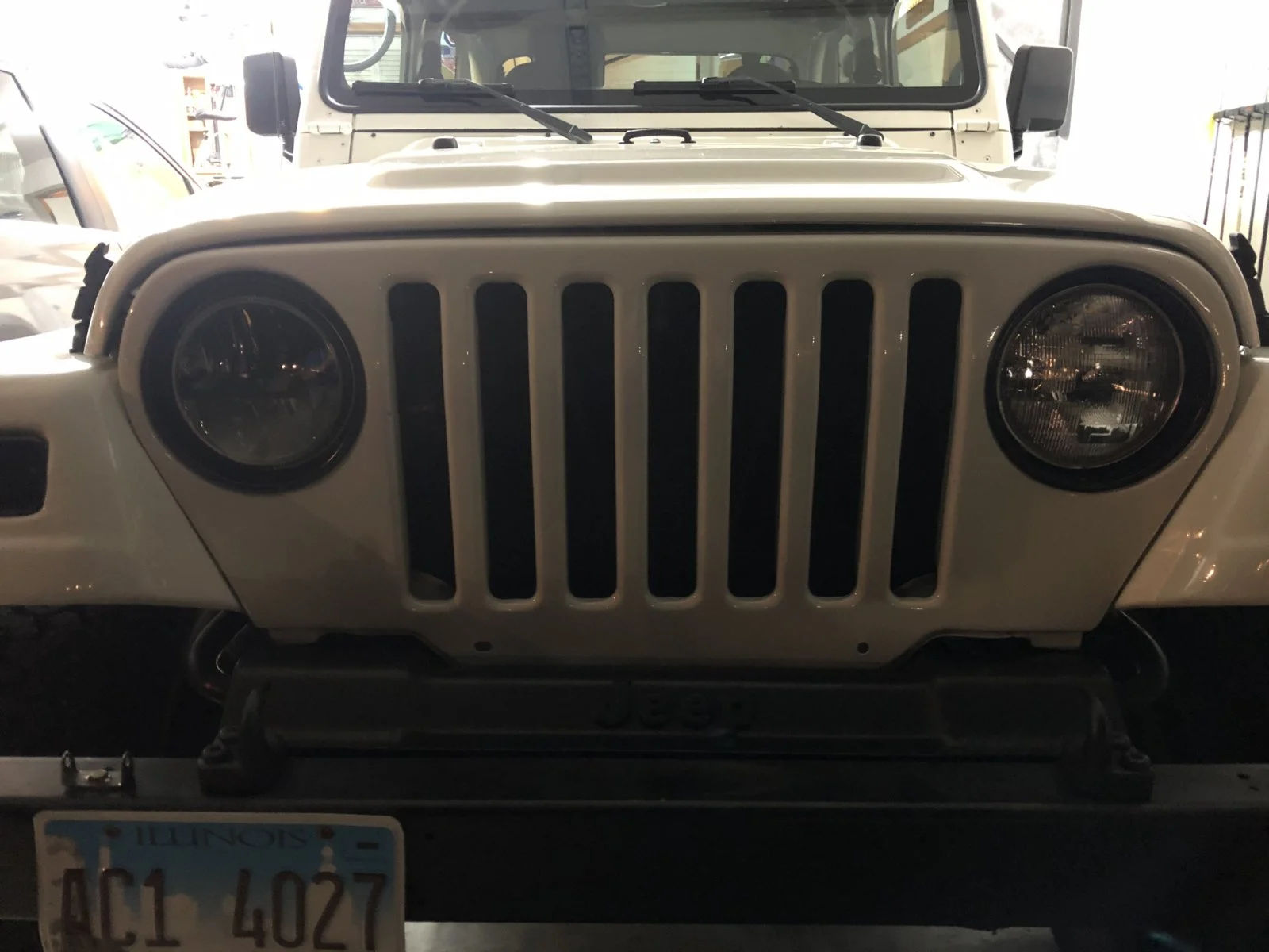

Sorry for the lack of updates. I haven't been doing much to the Jeep lately other than just driving it. I did install some knockoff Truck-Lites that I got off of eBay. What a difference!! I also elected to remove the OEM fogs and install LED pencil lights. They really aren't needed though as the new headlights produce so much light compared to stock.
