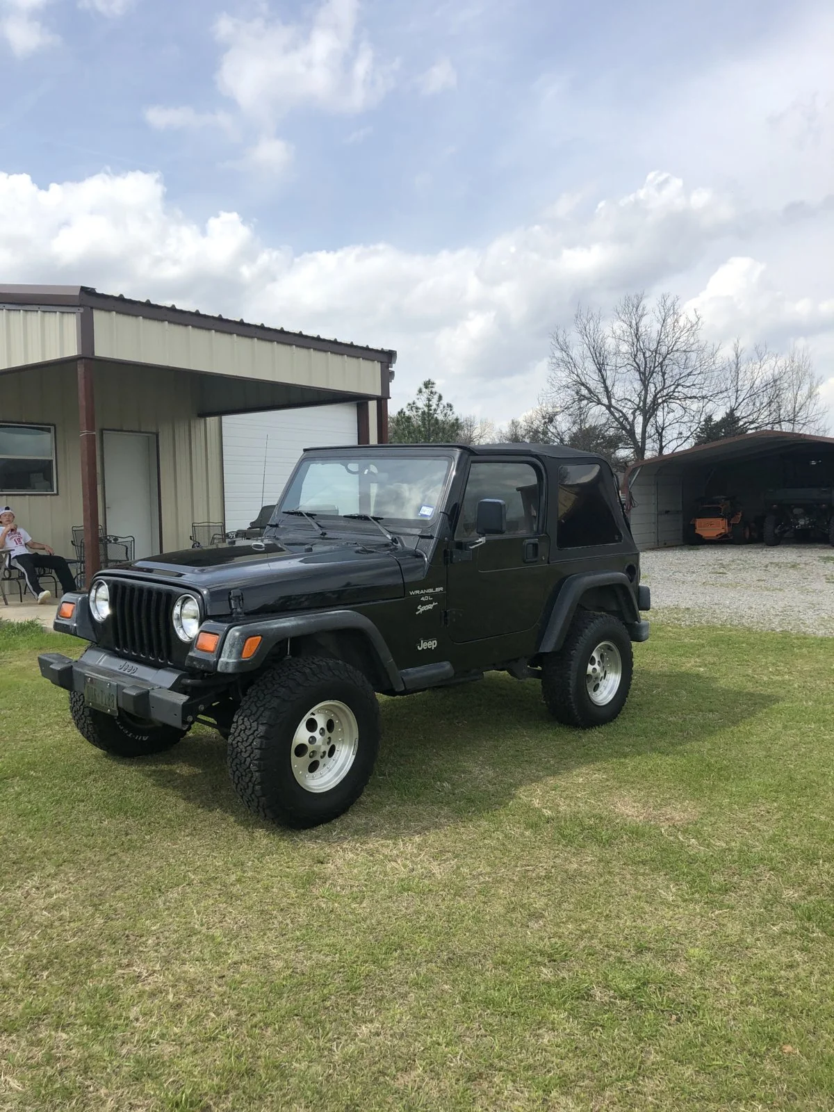

I sold my 06 a couple years ago due to health reasons thinking I wouldn’t be able to take care of it. I had it regeared 4:88 with Detroit Trutracs, upgrade axles, one 2.5 heavy springs and 1.25 body lift all from Dirk at DPG I got the kit without control arms. It did great in Ouray Co. on a trip there. Story short I regretted it ever since so I found a clean 1999 4.0 5 speed only mod is 2 in procomp springs & shocks. I put 31 X 10.5 x15 BFG AT tires on it, a rock hard bumper and M8000 Warn, other than the springs and shocks I like the way it rides and thinking about staying with the 31 on tires just so I don’t have to regear. So I’m looking for suggestions on what lift kit. I’m not a big fan of the body lift even the 1.25 like I did before. So I was thinking OME kit with track bars and all from DPG. I also seen JKS has a 3 in Kit but can’t find any reviews, or I thought about Currie but I think it’s a 4 in. I’m thinking 4 in and 3 may be too much with 31 in tires I don’t want it looking stupid. It’s not a DD just hobby or fun and not looking for a cheap way out.

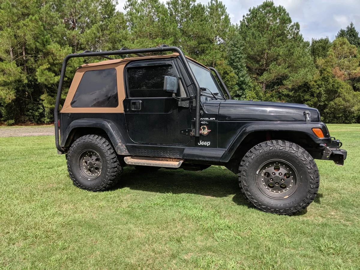

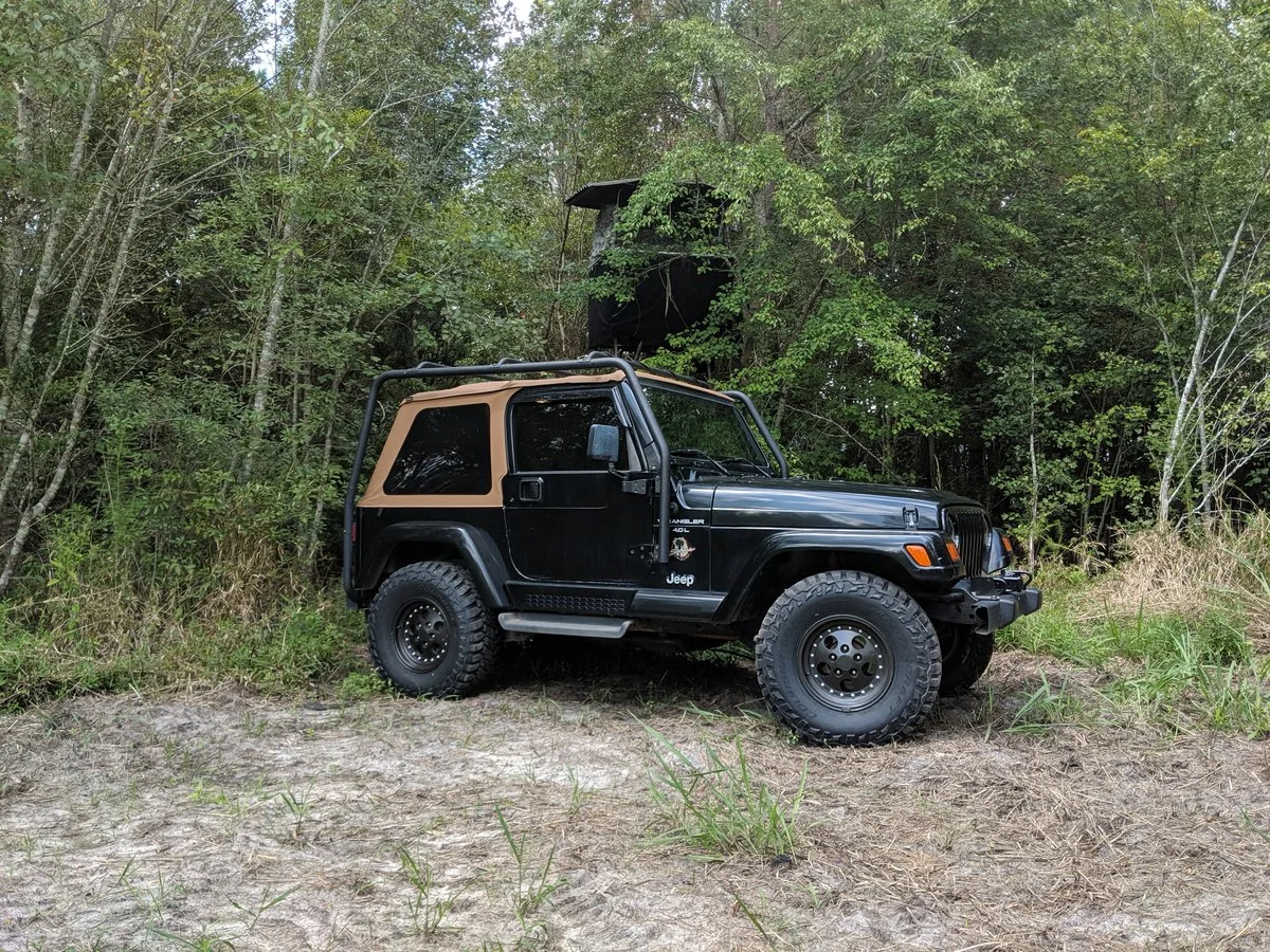

@Farmergreg and @stephen Preyer have the JKS 3" kit. They seem to be happy with it. If you stick with 31's get some 2" BDS or Procomp springs and RanchoX shocks. Best bang for the buck IMO.
Love the look of a 2” lift and 31’s. Knowing what I know now, I would’ve stuck with my 33x10.50’s and a 2” spring.

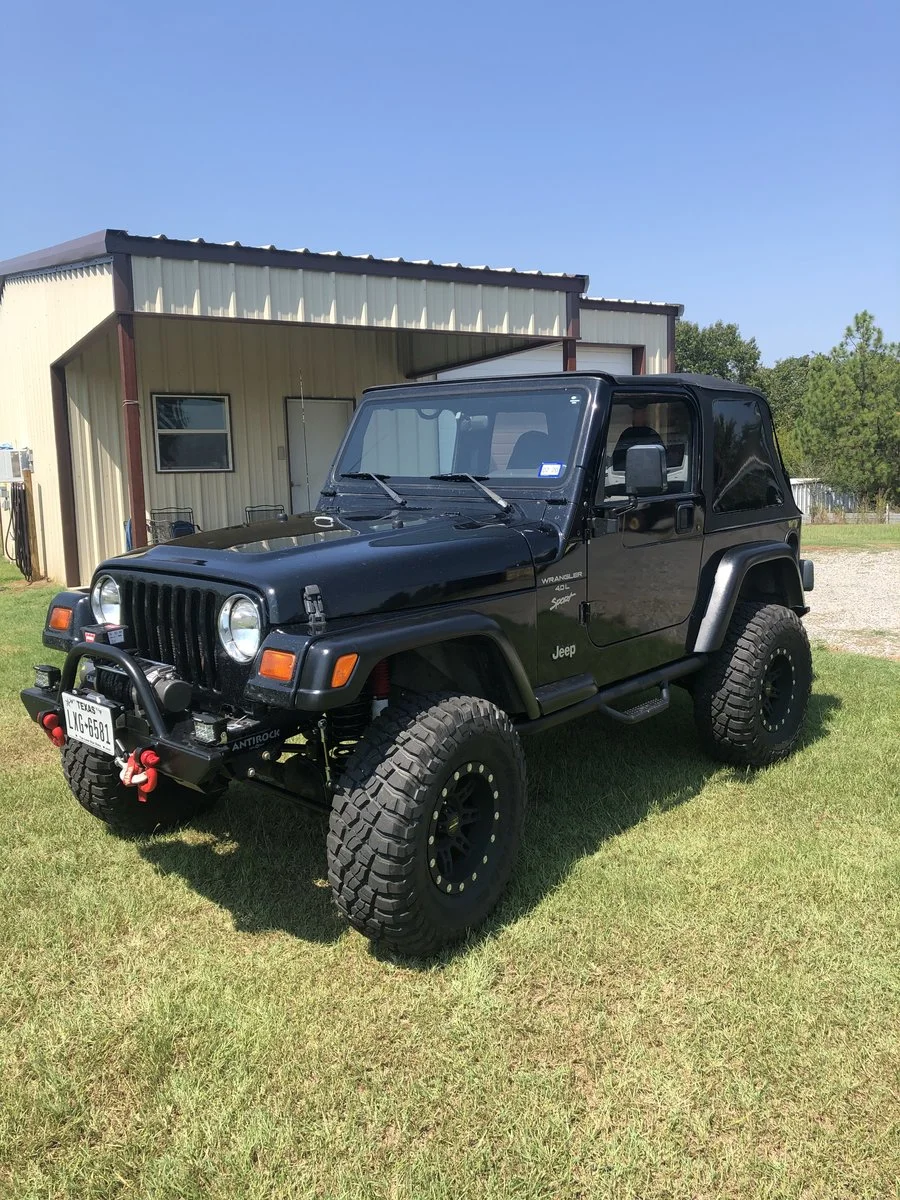

Now I can give my opinion on the JSPEC lift and 31 in tires after 400 miles I just added a sye and Tom woods drive shaft, BFG mt 33x12.5 Currie 4 in lift with control arms and anti rock , both adj track bars, Currie drag link and tie rod among many other things. The JKS wasn’t that bad just stiff and not what I wanted. Here it is now.
