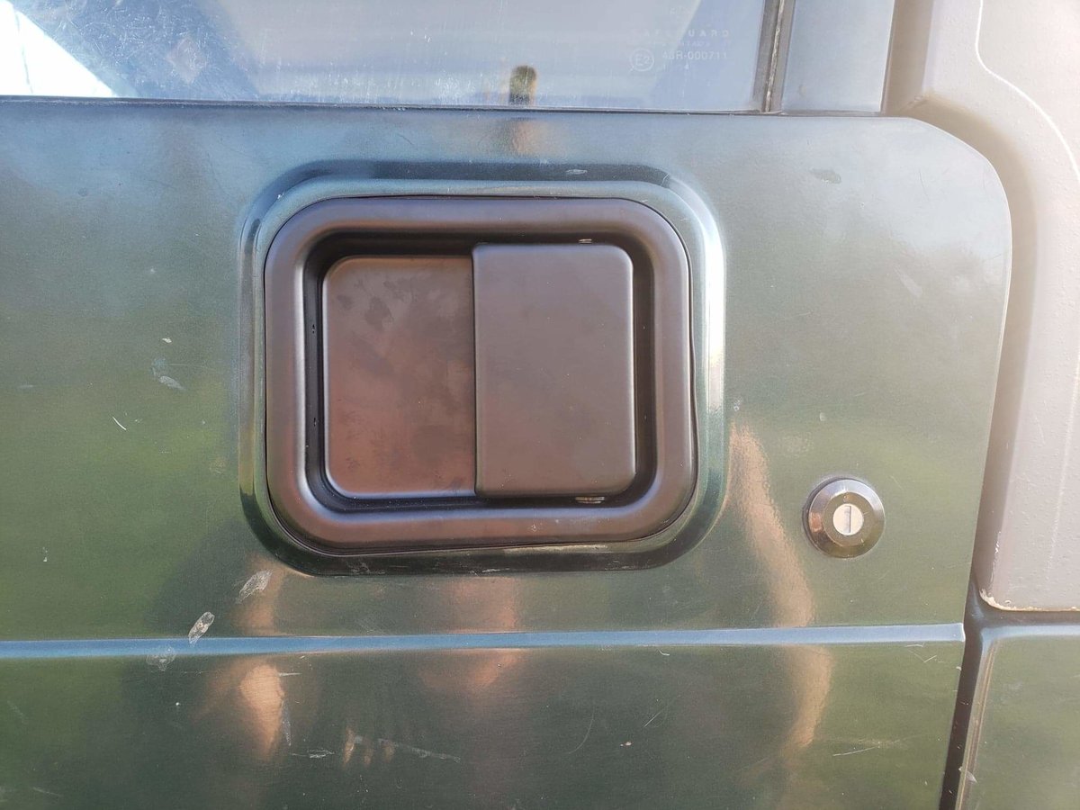

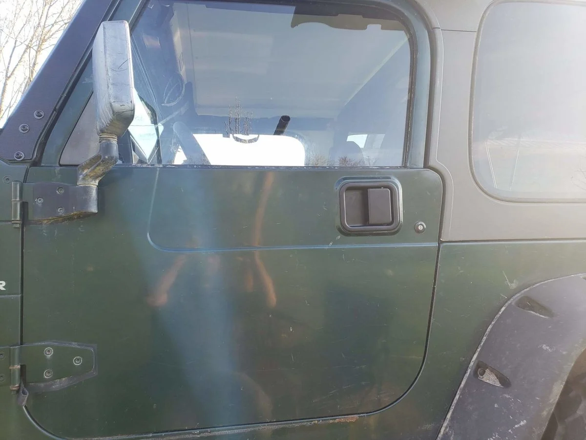

So me and the wife needed to replace the TJ's door handles as they were loose, and passenger side was a pain to open. Was hoping we could get them to mount on backwards. We started on the drivers side, and honestly the worst part is just being able to get to everything, which is mainly the handle keepers. Took us about 2 hours to do the drivers side, because we was winging it, and figuring things out. Once we moved to the passenger side, it literally took about 20 minutes. It was so easy to do, no cutting at all. The only modification is bending the arm for the handle. Which you can take completely out, bend it and test it easily. If anyone is looking to fix that abomination stock junk facing the wrong way pair of handles, dont hesitate to do it. All you need is a flathead or two, torques head, and a pair of pliers.

Once the paddles are flipped, you will notice how natural it feels which is identical to a YJ full door factory setup.
I may be in the minority in saying this - I like the way the TJ handles are placed. Being right handed, I can't see how the YJ style would be more "natural" to grip and open, unless perhaps you use your thumb to flip the paddle open.

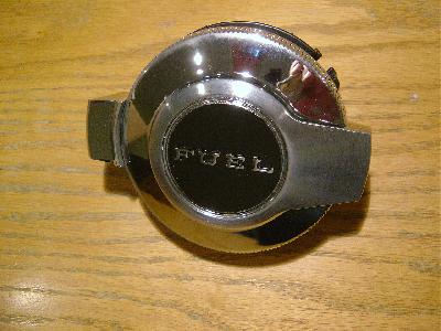

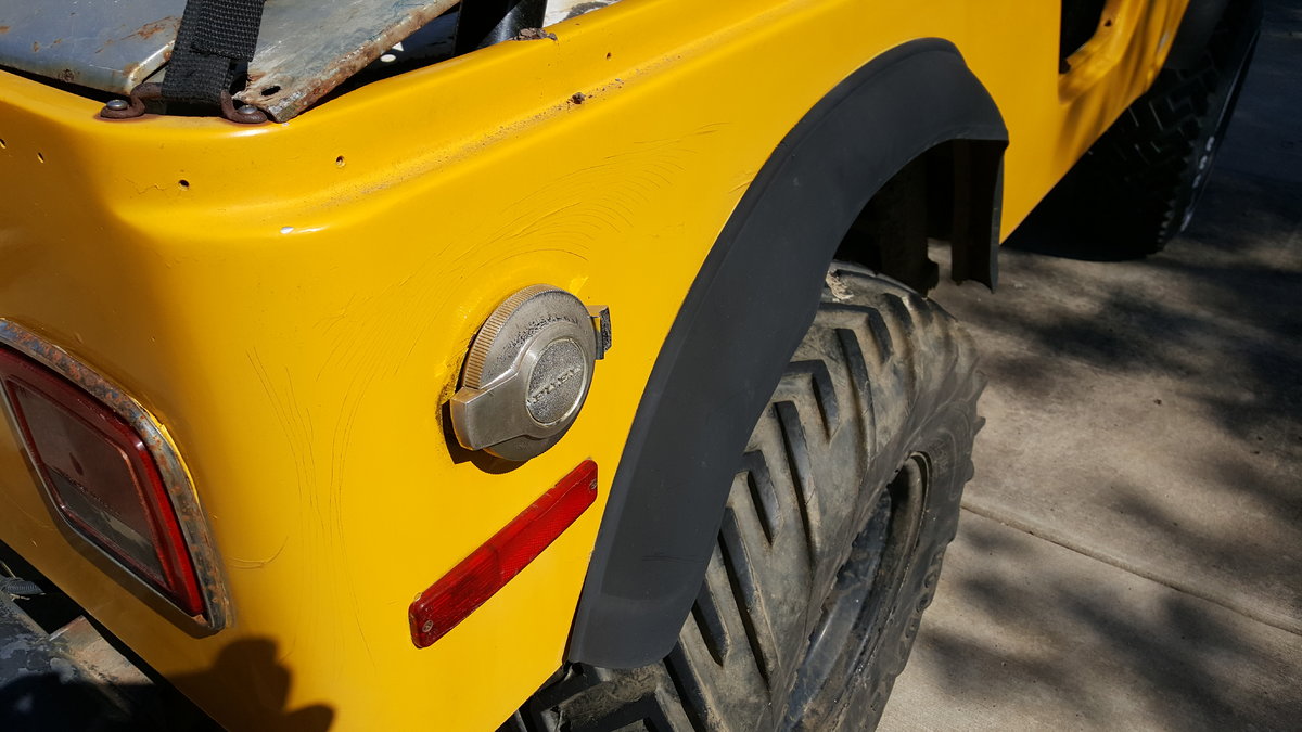

Vaguely related: the PO put the gas cap from a 1969 Charger on the passenger side of my CJ. I always worried about swinging open both on and off the road but it never did happen.
Now that I own it again and it needs some "restoration", I want to replace it with the cap from an early 1970s Challenger.
Terra Tires from a Ditch Witch! My dad had those on his cj5 back in the mid 80s.
