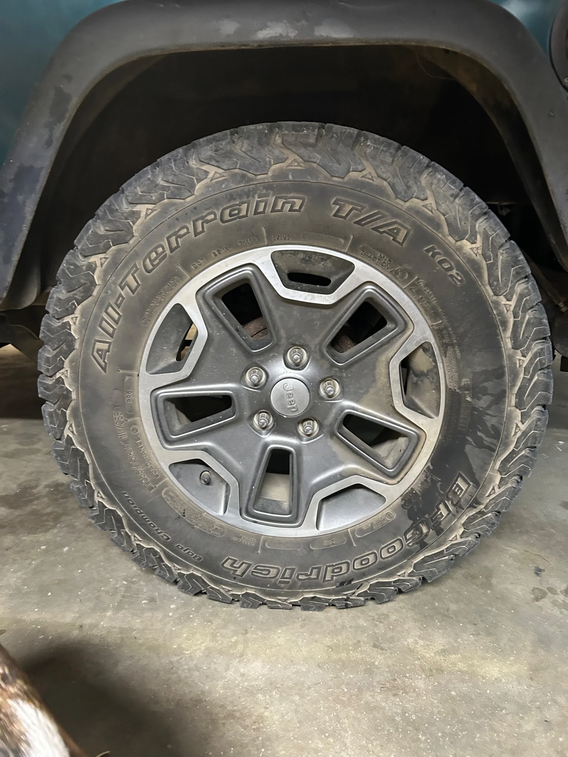

We bought. 1999 TJ. The previous owner put 17 in Rubicon tires on the vehicle. I don’t like the height and want to restore it back to the original 15 inch tires. Is this possible without spending a fortune?
Post photos, please.
A tire is different than a wheel. I'm assuming you're talking about wheels but mistakenly saying tires.

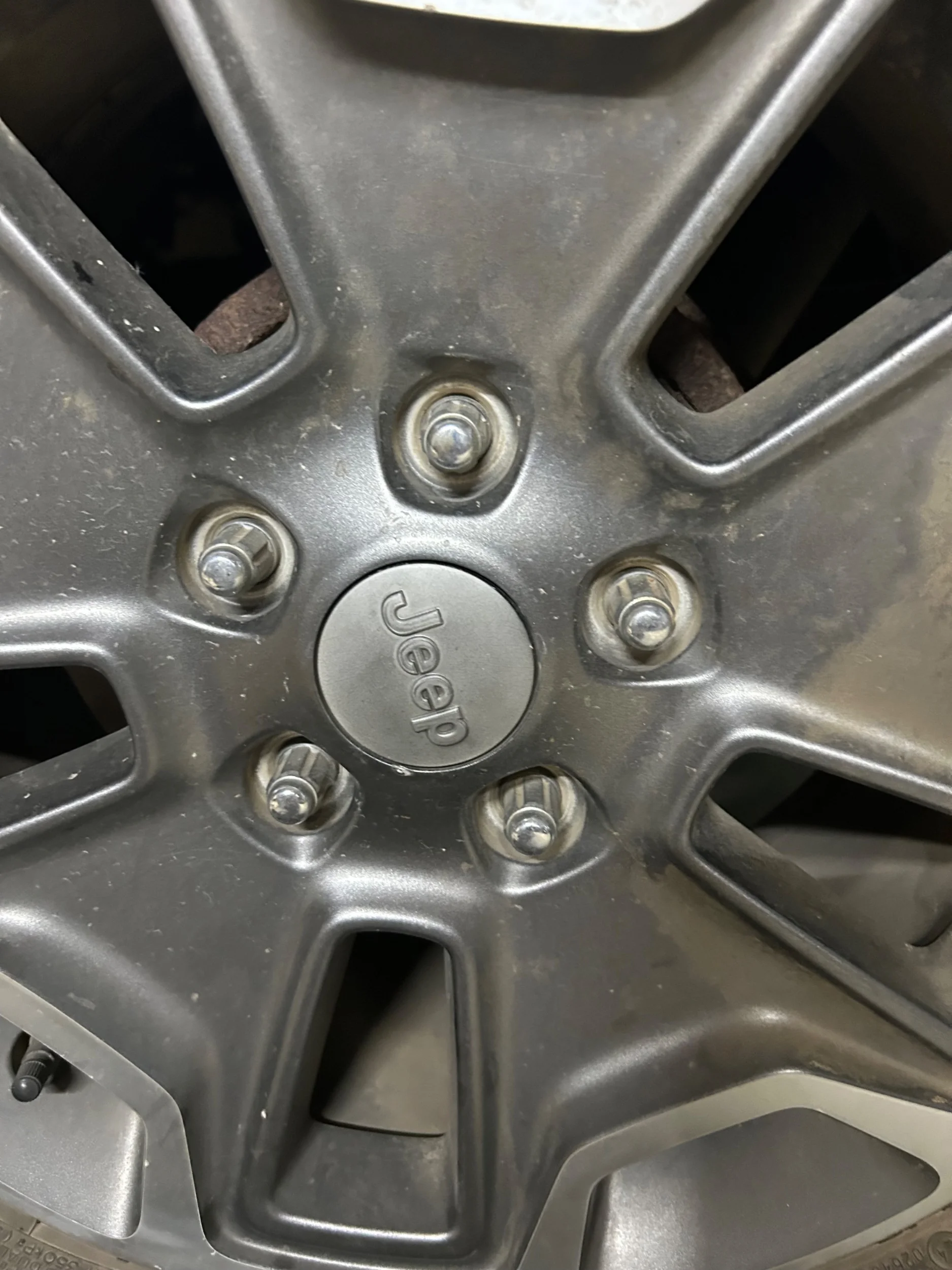

Are JK wheels 5.5x5 instead of 4.5x5? Pretty sure you need wheel adapters to run those newer style wheels, so you might have to remove the spacers/adapters as well as those larger wheels, and then you could just bolt on the stock 15" wheels.

JK 5 on 5, TJ 5 on 4.5, CJ 5 on 5.5

Shouldn't be an issue. The 17s are mounted with adapters. Remove those and put your wheel (and tire) of choice on.
