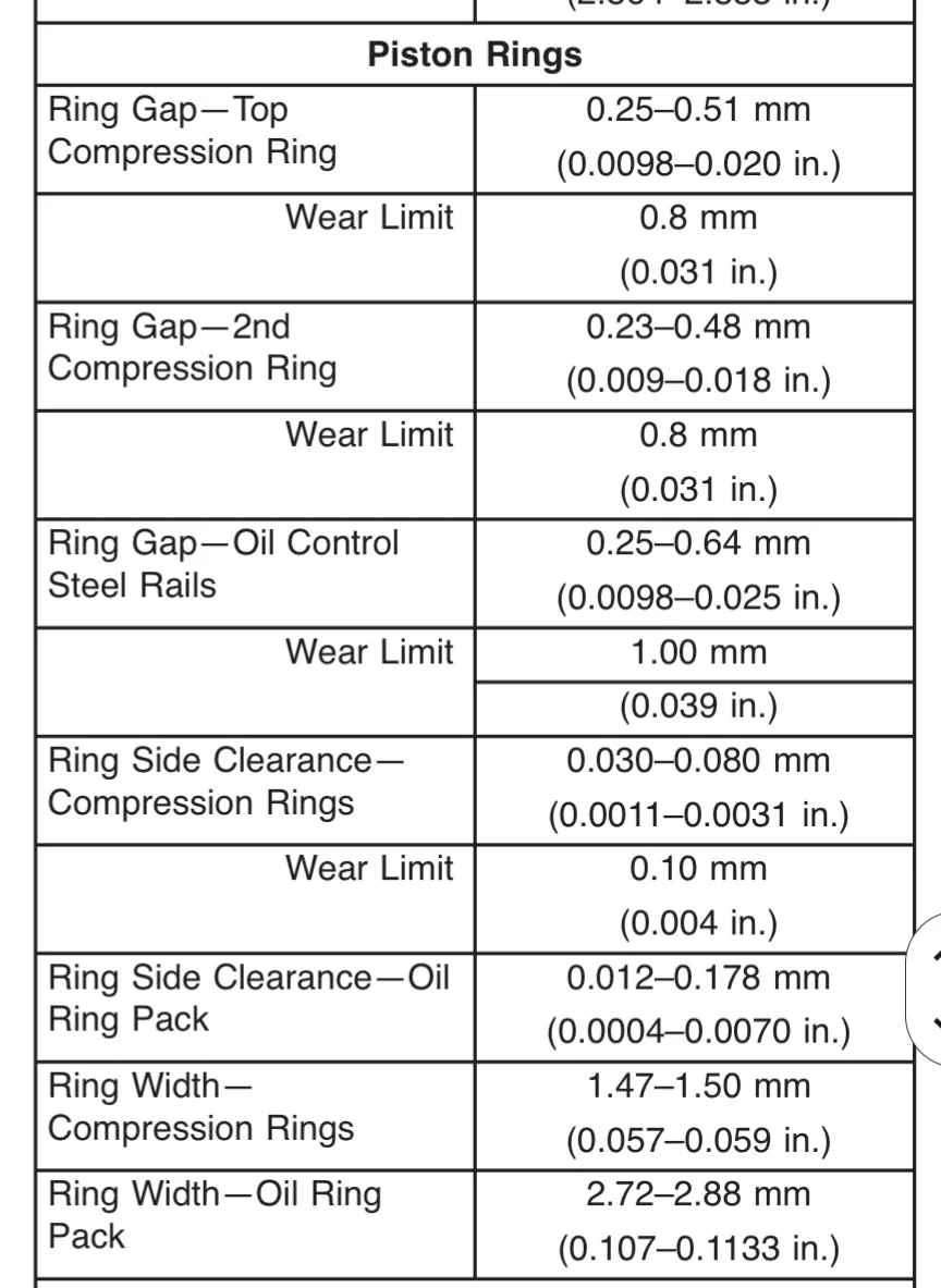

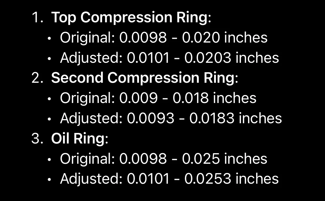

Piston Rings:
The pistons are 0.50mm over, but I’m not exactly sure what size rings I need ,what the gap should be, or what brands are the best to get. I did some digging and couldn’t find much, but maybe I didn’t search hard enough.

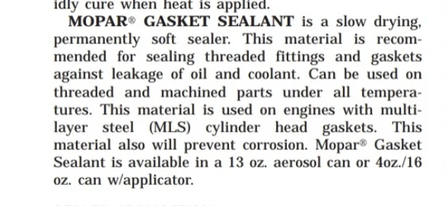

Block Gasket Sealant:
The 2.4 has a two piece block, and when I pulled it apart I noticed it looked red. What exactly is the right sealant to put on the mating surface between the blocks?
