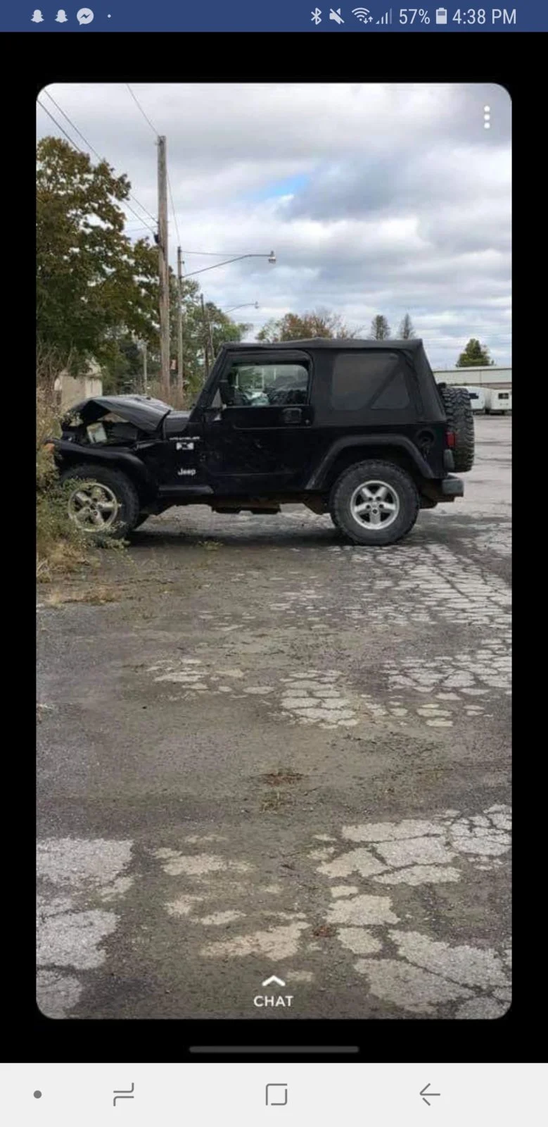

Yeah I know somebody who is a retired professional welder so I could have him help me with the mounts. My uncle has done many engine swaps so he can help me with the swap too. This is the doner Jeep and the only thing I'd need to buy is a radiator and engine mounts. I was going to buy this TJ anyways just to use as a doner for whenever I need parts and I figured I would do a 4.0 swap too if I got it. Here is a pic of it
Yeah I know somebody who is a retired professional welder so I could have him help me with the mounts. My uncle has done many engine swaps so he can help me with the swap too. This is the doner Jeep and the only thing I'd need to buy is a radiator and engine mounts. I was going to buy this TJ anyways just to use as a doner for whenever I need parts and I figured I would do a 4.0 swap too if I got it. Here is a pic of it View attachment 71550
That should do it then! Having the entire vehicle will make life a lot easier! At that point it will literally just be swapping things over as oppose to hunting for parts you need.
