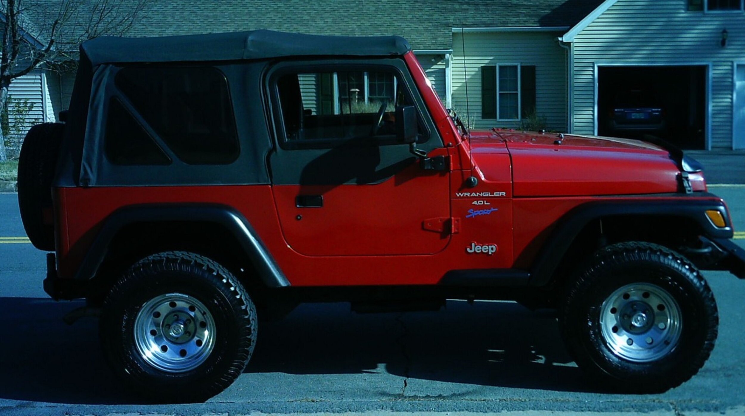

I ran 32s with a 2" BB several Jeeps ago. I bought longer shocks and nothing else. Zero issues.
