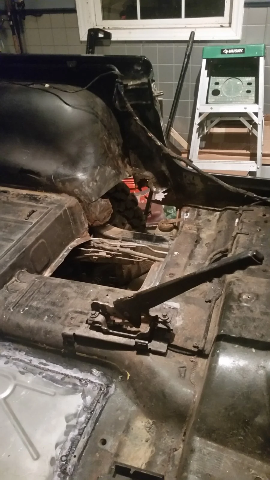

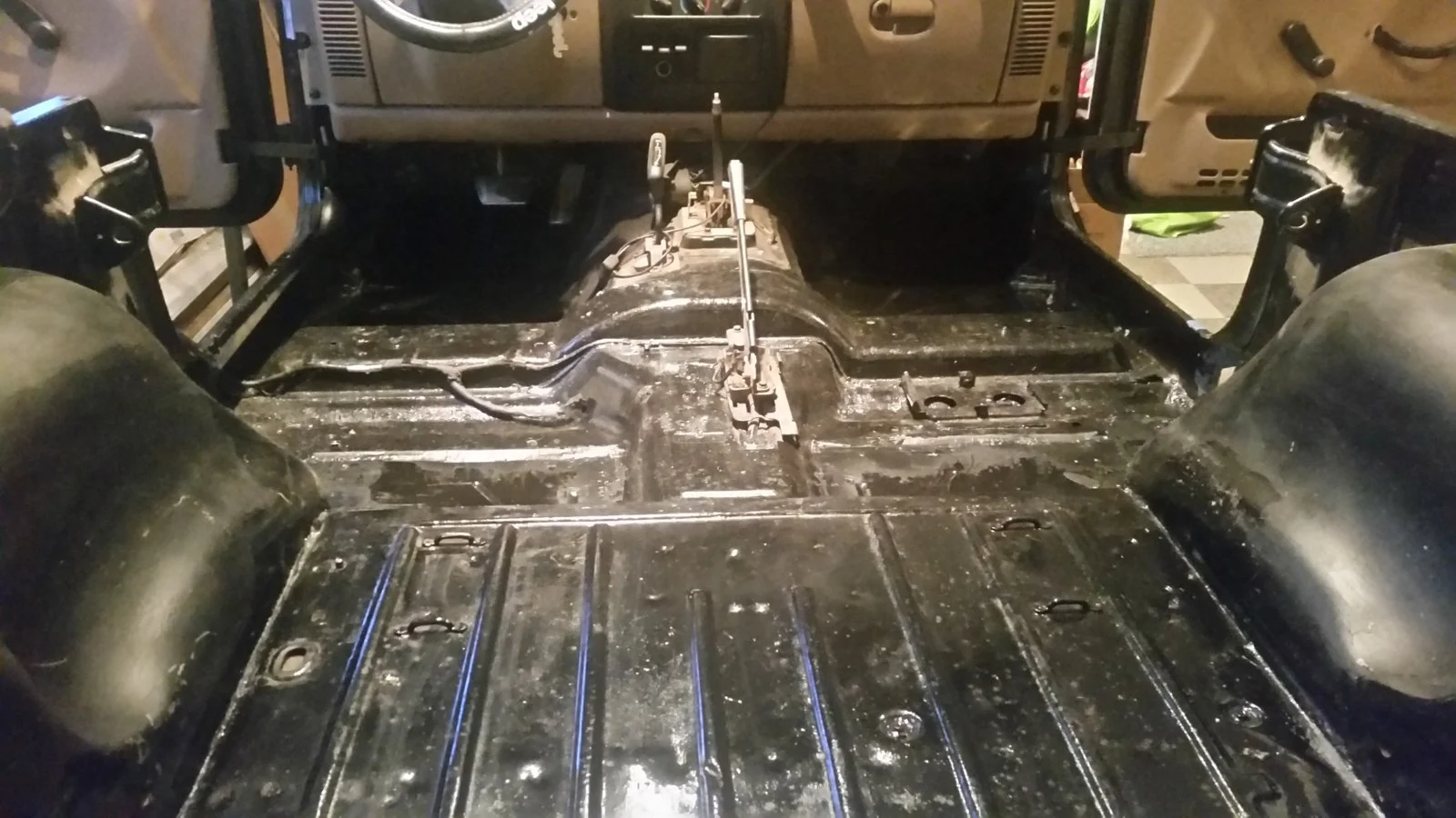

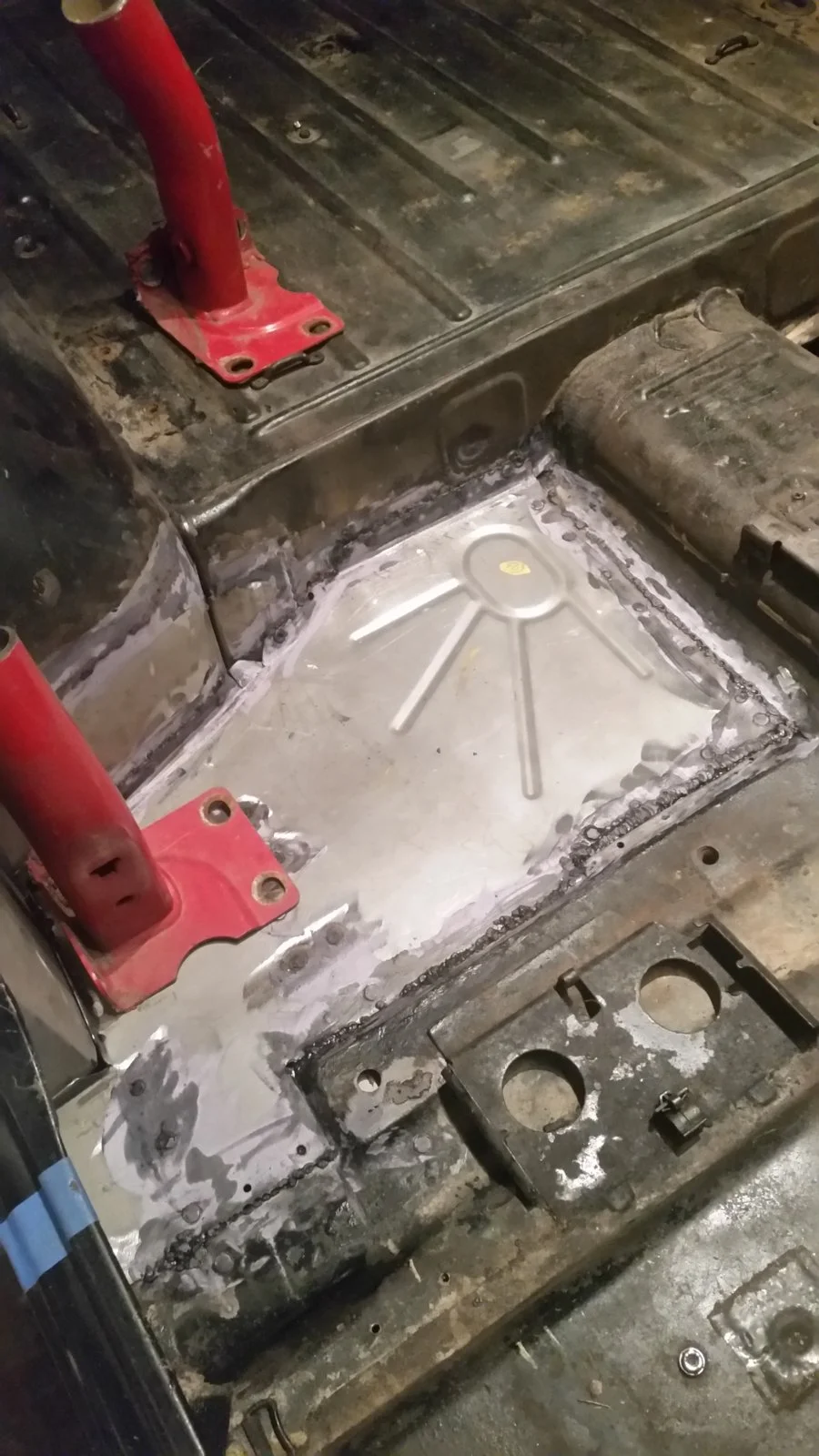

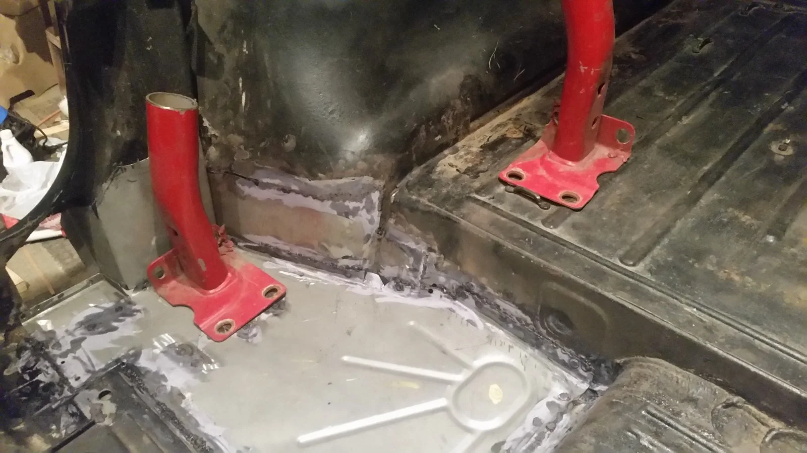

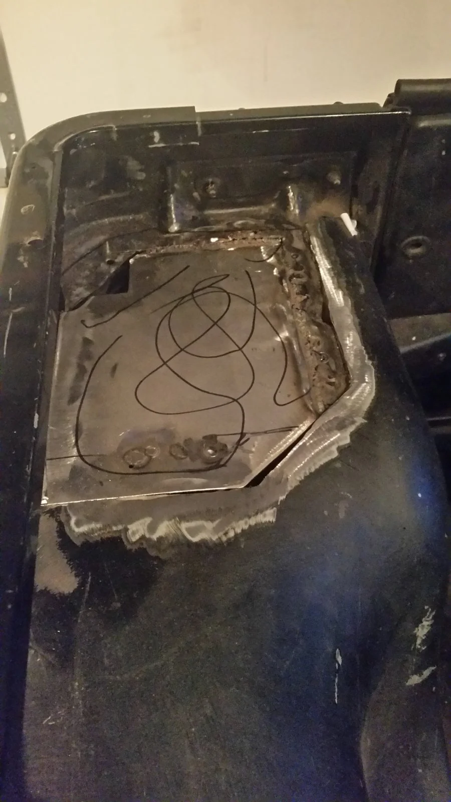

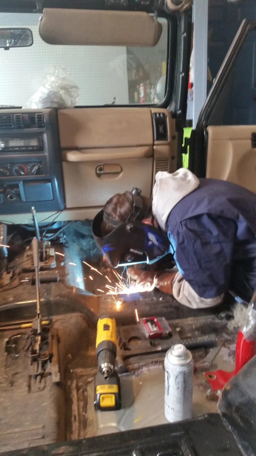

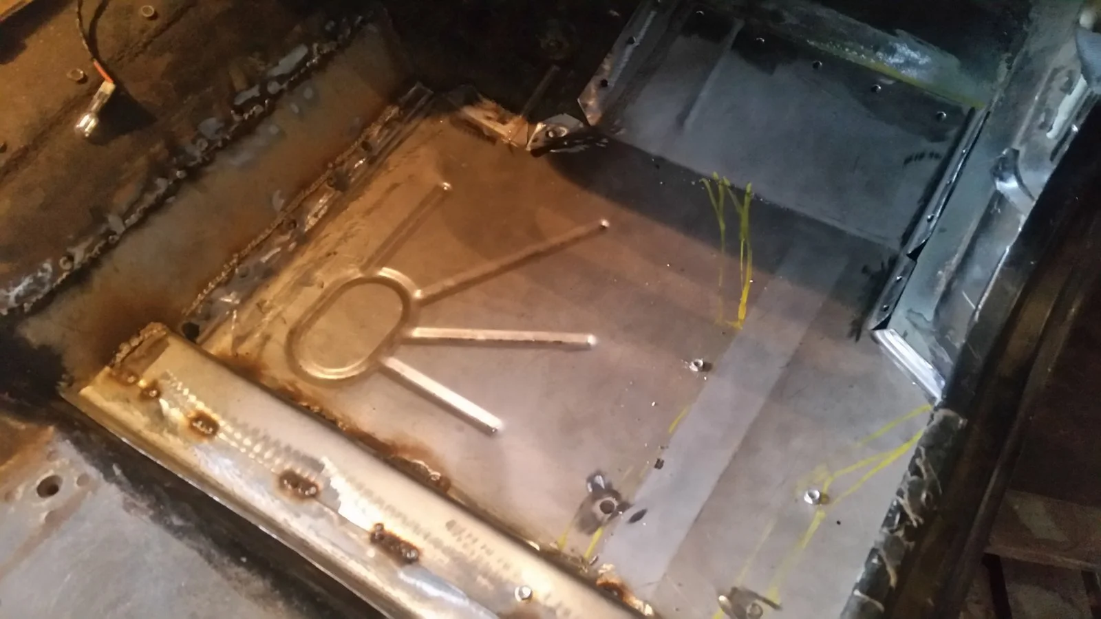

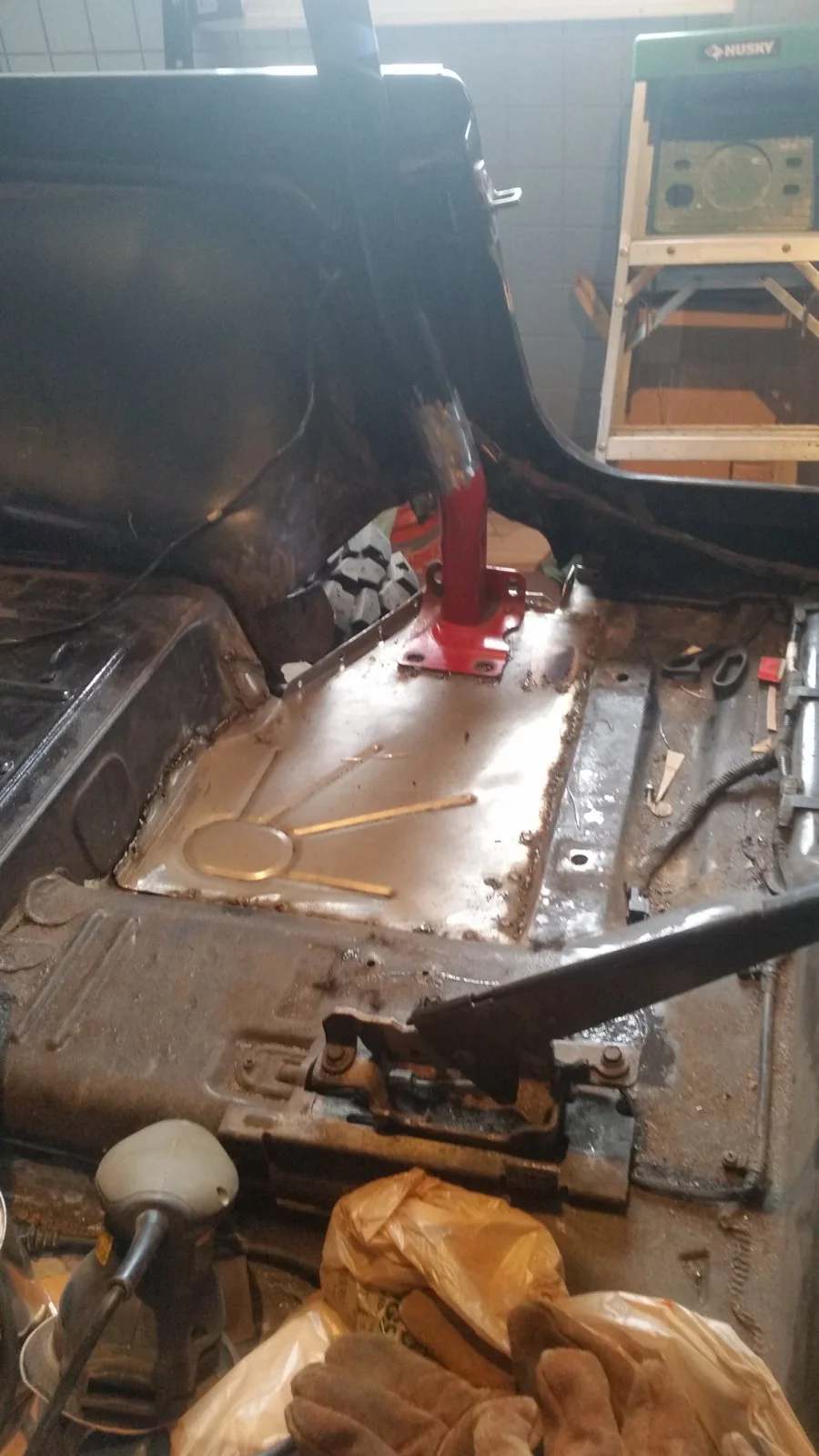

Been busy with work, the kids and life so I haven't gotten as much done as I would have liked. Here are some pics. I have the passenger floor done, need to weld the feet on the roll bar so I can line up the door striker box correctly. Last step in the process will be to bolt in the rollbar and weld the quarter panel piece in. Everything is cut and formed so it will go quick. I had a surprising amount of rust under the rear rollbar support on the passenger side. Had to rebuild the inner support and the top of the wheel well. I decided to use 16 guage for both just to add some strength since these welds aren't factory. Jeep used 16 for the inner support and 20 for the wells. The driver's rear floor is all cut out and I will be cutting the pans and welding them in hopefully by the weekend. Slow and steady!
20180324_193420.jpg 20180325_110805.jpg 20180323_211012.jpg 20180323_211023.jpg 20180323_211037.jpg 20180323_211051.jpg 20180323_211121.jpg
Reactions: JMT
View attachment 36865 View attachment 36866 View attachment 36867 View attachment 36868 View attachment 36869 View attachment 36870 View attachment 36871

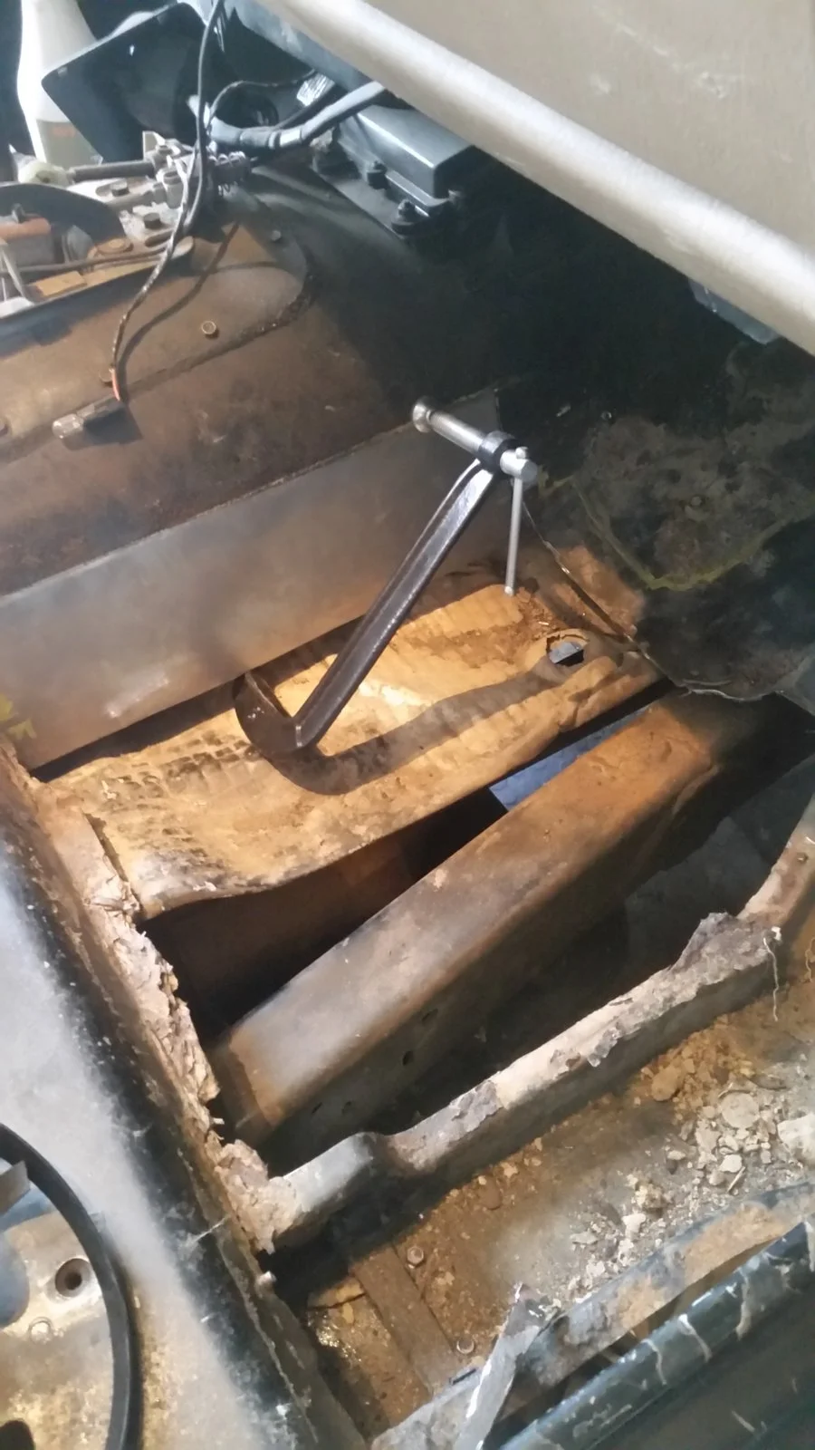

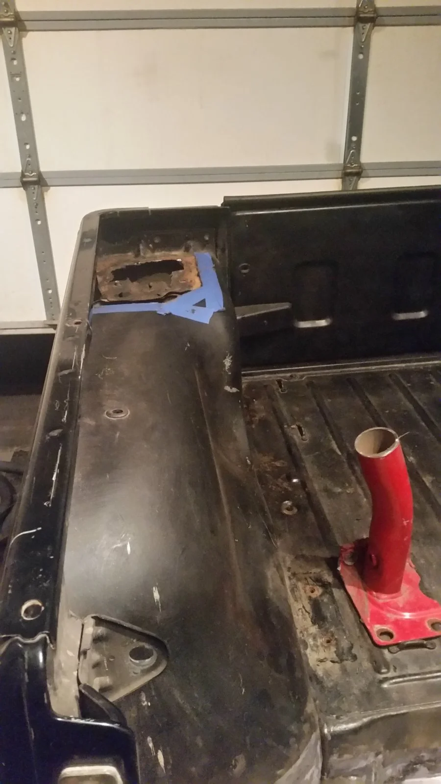

The saga continues...
Spent most of last week traveling for work to Colorado Springs. This is the view from the room I was in- Pikes Peak. So jealous of the beautiful outdoors you guys get to admire every day. Saw lots of amazing Jeeps too. I can definitely see why re-gearing is so important in this region, given the altitude. My rental was a Suburban (no idea why they gave it to me) and it was gutless. I mean noticeably less power. Can't imagine how a TJ on 33's would feel with stock gearing in that thin air. Anyways, I was able to get some work on the Jeep done over the weekend. Both rear floors in, still have a small piece to weld for the rear driver's wheel well. Roll bars now have feet again and are bolted in temporarily - still need to paint them. Front passenger's floor is welded in. Included a pic of my 15yr old welding away- he is getting pretty good at it. It has really started giving him a sense of ownership and and pride doing this. We are having a blast learning as we go. Started the messy job of painting everything with POR15. We got the bottom painted from the back bumper up to the rear floors done. Now it is ready to put the gas tank back in once the final welding gets finished. Of course baseball season is upon us so I am losing my helper since homework and practice have become a priority- plus I like to go see him play!

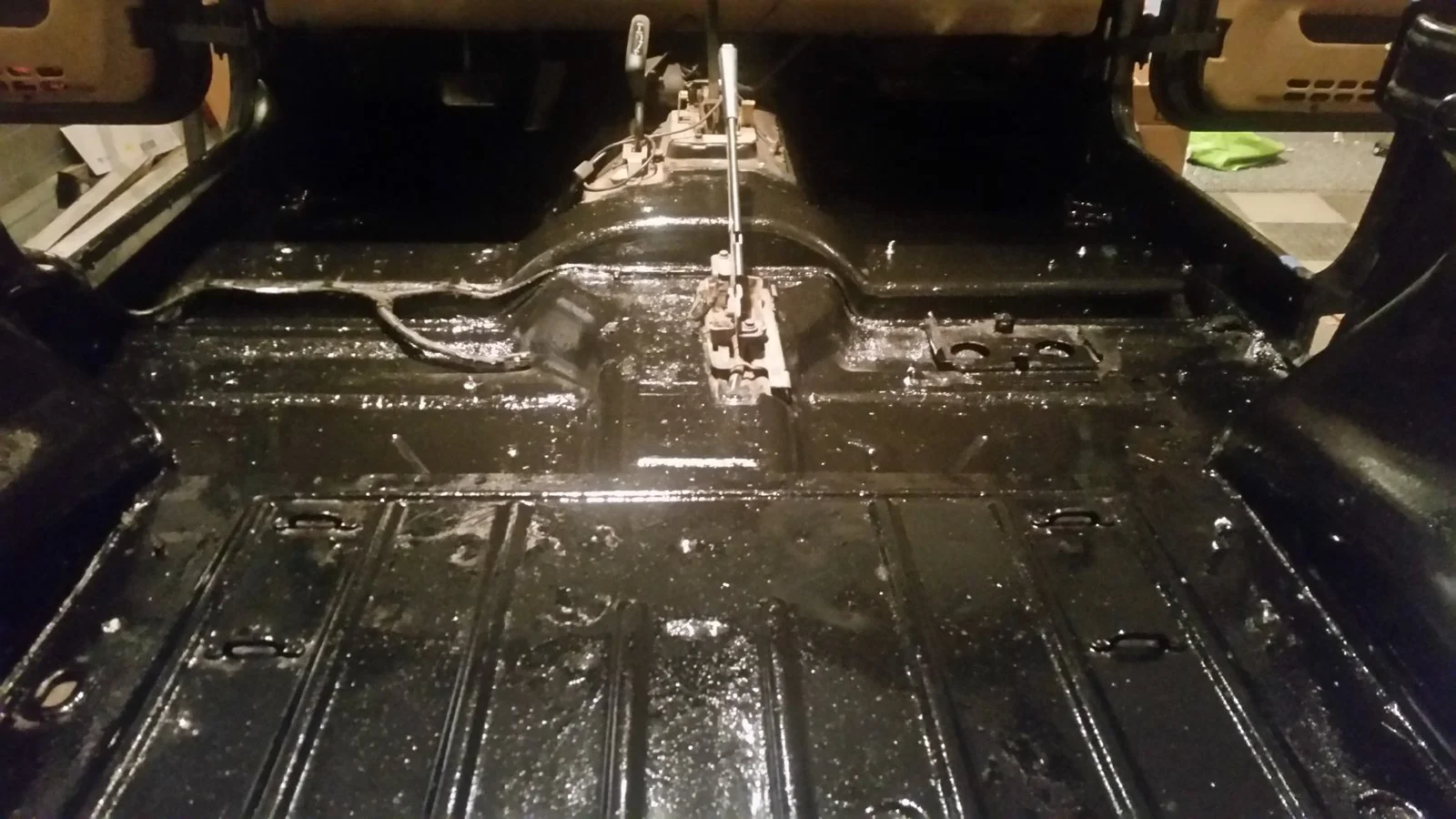

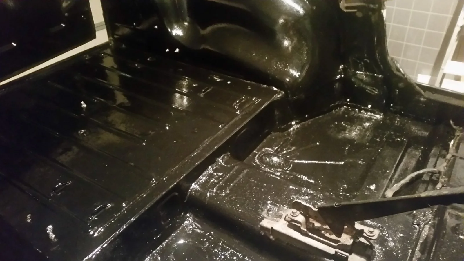

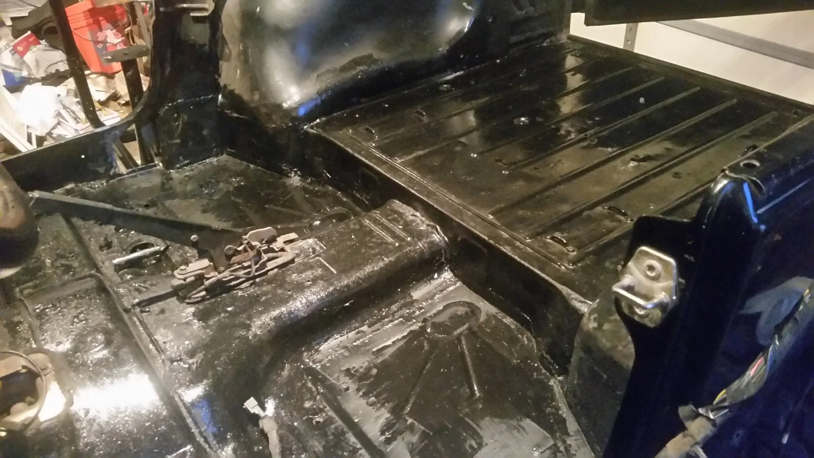

The light at the end of the tunnel is getting brighter!! I applied a liberal amount of POR15 to the tub and especially the welds and seams. I then followed it up with Eastwood 1K seam sealer. Stuff went on easy but the buzz I got was insane, even with the respirator. Stinky, stinky stuff! After it cured, I painted the entire inside of the tub with another coat of POR15. It is so shiny now!! I am going to focus on the bottom of the Jeep, repeat the same process above and then hopefully get the gas tank back in by the weekend. If this darn weather ever breaks I am going to bed-line the inside, just for added protection and durability.

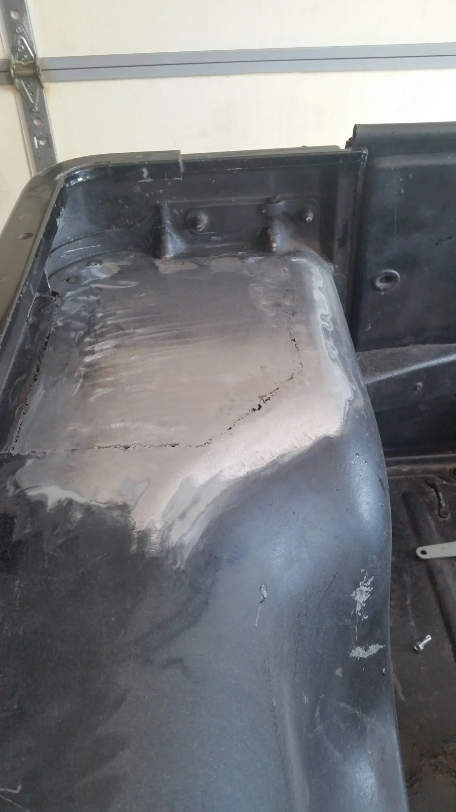

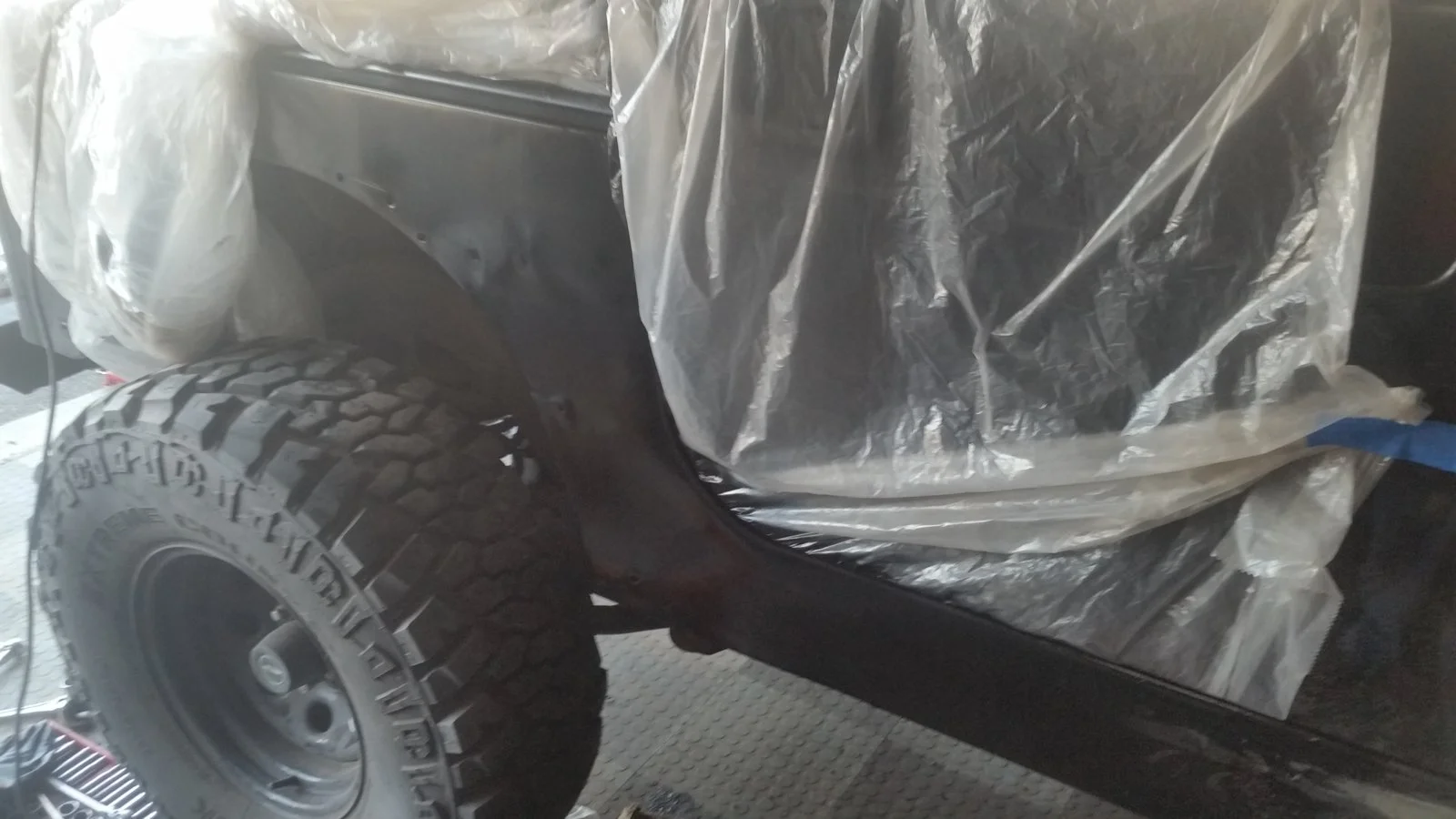

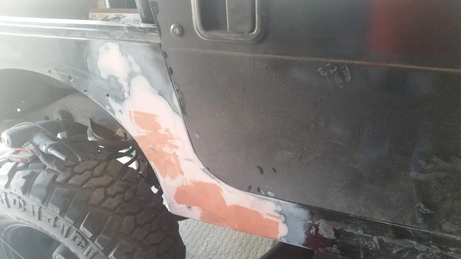

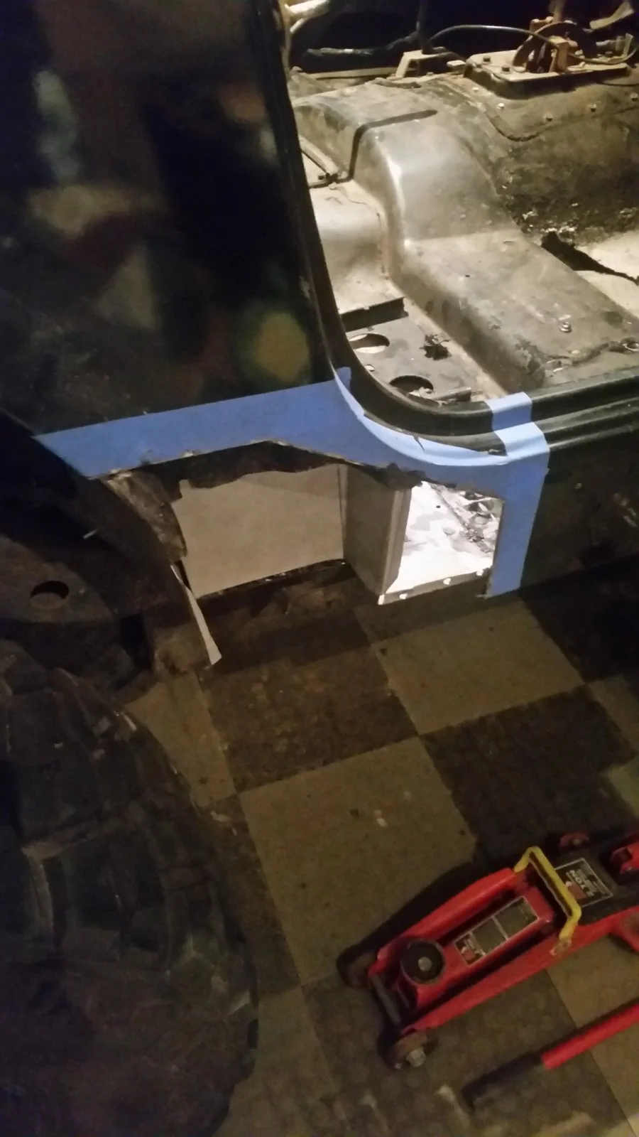

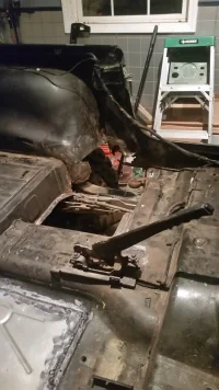

Haven't posted any progress for a while- been really busy at work. As you can see above, floors are all repaired. Fully POR15 inside and underneath. Tackled the wheel wells but forgot to take many pics. Here are some shaky cell pics of the side. Welded in new corner, added a bit of good old Bondo to smooth out the slight warping from the welding. Not sure I am completely happy with the non-factory radius of the pieces though. More than enough clearance for the tires but I like the more rounded edges, maybe I am being too critical since it is getting covered up by the flares anyways. Shot some rattle can on it until the weather warms up enough to apply proper auto paint to it. Doesn't look that bad in the meantime. Now I am focused on fixing an annoying transmission leak (actually two). Pan gasket is seeping and the shift shaft seal is dripping. Messy job but not difficult- saving it for this weekend.
