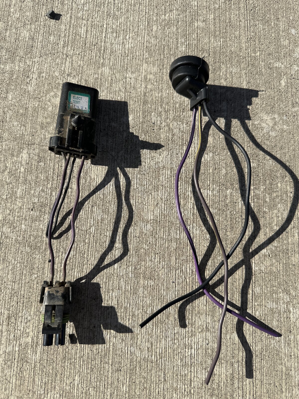

Hey mrblaine and or Jerry, can you help me with the wiring for the nss? I bought this connector for the nss on the 32RH but I’m not sure which wires to splice together with the harness from the nv3550.
I'm not trying to pass the buck, but have you looked at the wiring diagrams in the FSM for the years you're sourcing from & installing into? Matching up by color might not work as perfectly as you want, but if you trace the function of each wire in the FSM you should be able to figure it out.
Did you ever get an answer on this?
I actually did get it to work! I didn’t think to take a pic of the final product but it ended up being more simple than I thought. Thanks for your help!
