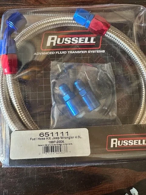

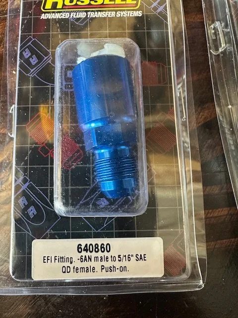

Are you talking about something like this?

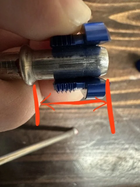

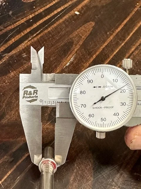

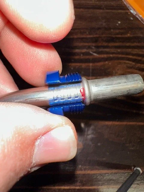

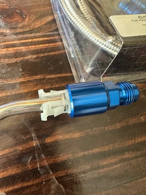

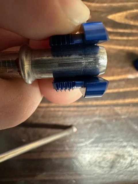

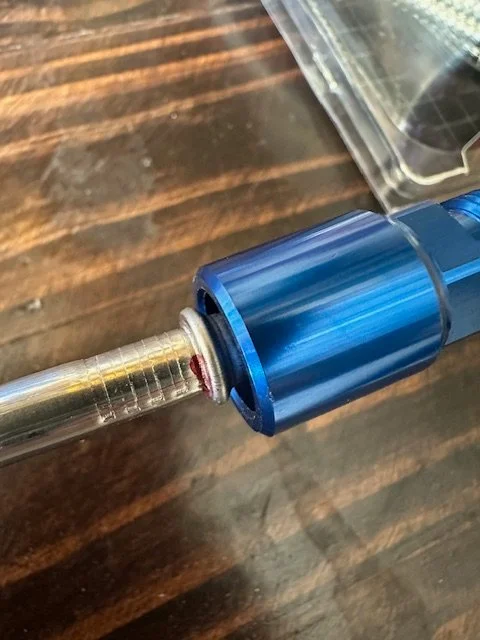

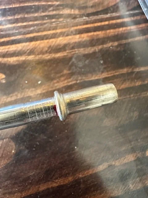

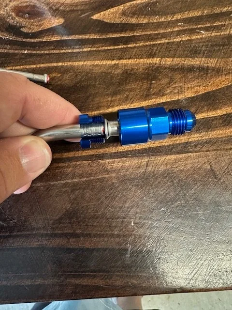

The SAGA continues. Received the new set of hard lines from JEGS. Well they are manufactured by SS Tubes (Fine Lines), JEGS apparently just labels them with their own part number. Well same sad story, they are not formed correctly. So back to square one. I found these fittings (see attached photos). Anyone see any reason why these would not work? the are 5/16" compression X -6 AN male. If I cut the formed portion of the lines off and install these fittings, seems to me like it should work. Any input from anyone would be greatly appreciated.
