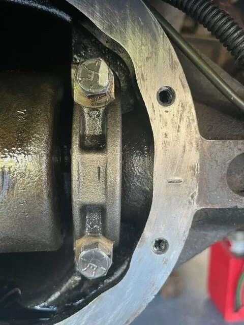

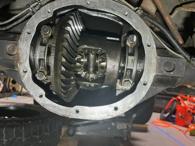

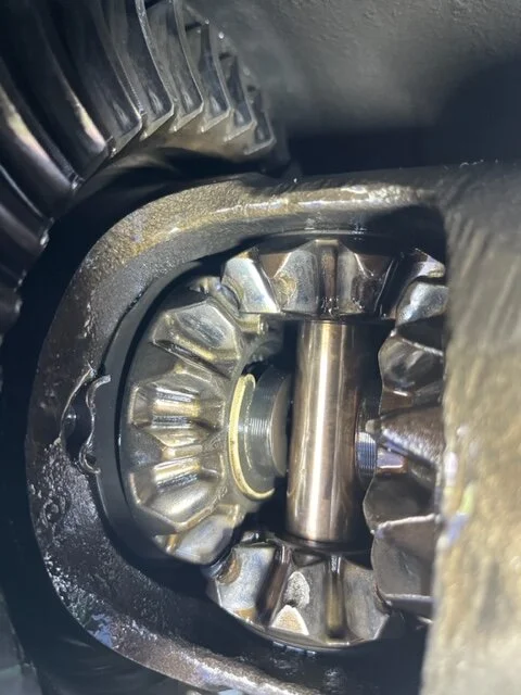

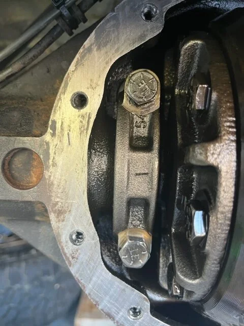

It has a stock Dana 35 rear diff and 33 inch tires. We knew it needed a gear ratio change as it is slow as hell and after some research, with the 33 inch tires we want to go to the 4.56 gear ratio. With both front and back differential leaking fluid they need opening up anyway... Well..... on closer inspection the pinion bearing is finished and spider gears are shot as well. I also noticed that the carrier bearing caps seem to be installed incorrectly as the marks (horizontal and vertical lines on housing and cap) don't match up and the fat edge of the cap is on the outside rather than on the inside, nearer the spider gears...... (see attached pictures). I have bought the 4.56 kit and spider gears from Extreme Terrain but my question is:
Do I return the caps to what I think is their original position where the marks line up, or do I rebuild it and put the caps back where they are now?

looks a lot like the gears I just removed. You should rebuild (new 456 R&P) and put them where they belong. I would assume that they don't hold the races properly like that and are probably missaligning the carrier.
Thanks. I am pretty much rebuilding from scratch so will put the caps where I think they belong...

Also, what's up with the washers on the bolts for the carrier bearing caps? Looks like someone butchered up the washers.
Thanks Andy. I looked through that article quick and saw this which would indicate I am OK going to 4.56 with the current carrier, right?
Good catch on those washers. I never noticed that and I have stared at that thing a long time.... I will look into that a little more too.

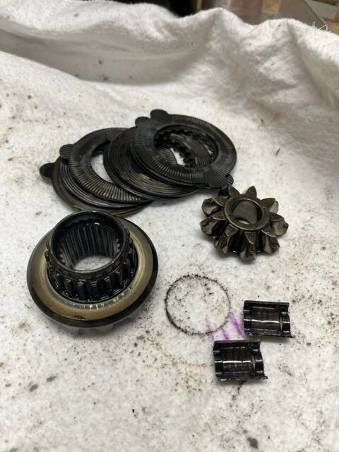

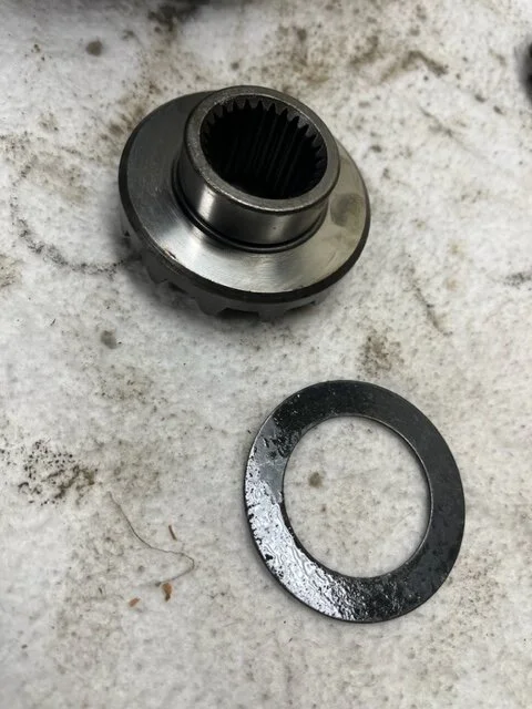

So... now the next problem.... I took out the spider gears and there are a bunch of shims on either side that are not with the new spider gears I bought. The carrier must be completely different? See below:
old:
New:
Any ideas whats going on? The old spider gears are like nothing I've seen on the videos.
Ah OK.... So am I better off rebuilding the limited slip diff or buying a new carrier and going back to a standard diff?
I don't know why you wouldn't want to stay with at least a limited slip.. everyone says they are a pain to rebuild though?? Just get a new pad carrier.
That would be your choice. I can't decide for you. To rebuild a limited slip, you'll be looking at this:
