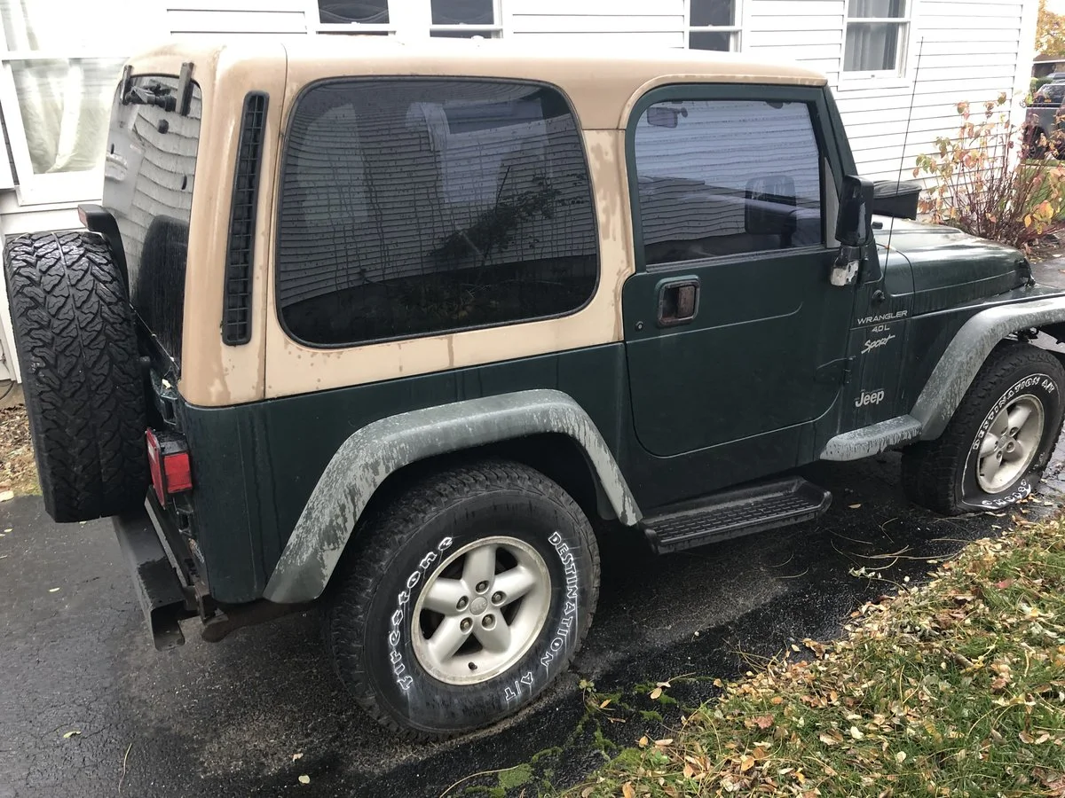

Hey y'all, this story begins with a 2000 TJ Sport 4.0 that my father in law drove for about 16 years. Since then, it has sat for the last two years or so. It had an inch of water in the tub, all the tires are dry rotted beyond use, it has a circa 2002 Viper alarm system that drains the battery within 3 days of a full charge and most of the suspension looks like its garbage. The positives are: it only has 96,000 miles on it, the 4.0 still runs strong, the frame and tub don't look totally shot despite the NY winters.
As it's a bit of a family heirloom and I've always wanted at TJ, I am going to restore the old girl to her former glory. The only problem is, I have no idea where to begin. I don't have a ton of experience working on cars outside of bolt ons, lift kits and the occasional youtube truck build binge. I have a decent budget, but not nearly enough to do everything I want at once. I want to eventually build it into something more than just a Jeep to drive out onto the beach with. But I figure what better way to learn all of this than with a free Jeep.
My idea is to turn the TJ back into a reliable driver first. My thought is a complete teardown to the frame. Repair and protect the frame, repair and repaint the tub, replace the disintegrated fenders and give the engine a nice overhaul. Basically, I'd like to clean everything up, replace what needs replacing and go from there. At that time I think I'd put a lift on and 33's.

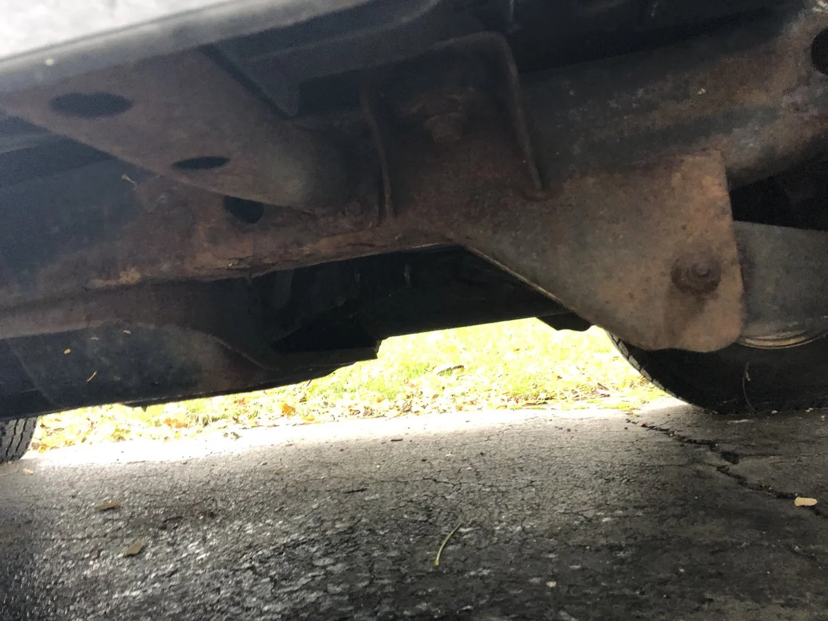

Secondly, that frame has rot on it, which I can clearly see. That's going to require cutting out the sections of the frame that are rotted and welding in new sections. While you're in there, you'll likely find more rust, which is going to require even more sections of the frame being replaced.
However, the place to start is definitely the frame. You need to get under it and assess the damage. If it's only a few sections that need to be replaced, it might be worth it to just do that. However, I'm guessing it needs an entirely new frame (especially if you look at the inside of the frame), at which point it becomes a very large project.

The frame is definitely flirting with it. Get it inspected thoroughly. You can take a hammer and start whacking (hard) around the rust spots, even using a screwdriver and stabbing in areas. You will find out quickly if its rusting thru. They do make Saf-T-Caps which requires you to cut out the rot, and you can weld the new caps in place. If water has been sitting inside, check the floor boards for rust too. Get the rust checked out and if possible, fixed. Then worry about getting it running up to par with a good tuneup, fluid change, and other driveline repairs if needed. After that, if you still want to run 37s, we can help you easily spend $20k-30k.

I also don't mean to discourage you. I just want you to know that the frame needs to be really throughly inspected before making a decision on what to do. If the frame is mostly rusted (check it with an endoscope too), it's easier to get a new, rust free frame (they run around $1500) as it will save you time, money, and frustration.

The picture of the frame seems to be the worst spot. The rest of it still has paint on it for the most part, but I haven’t done an exhaustive look at it and I’m sure if it’s bad there it will be as bad elsewhere. I’m going to start tearing it down to the frame this weekend and go from there. I think I am gonna borrow a snake camera and needle scaler from work and see what I come up with?

Get a cheap scope off Amazon and check out the frame above the skid plate or try and drop the skid plate. That area, inside the frame rail and the bottom of it, will give you a really good idea of what you're dealing with. I had a frame that looked good till I dropped the skid plate and the bottom of the frame rail was 90% gone. Good news is safetcaps aren't a huge deal in that area if needed especially if you have everything off the frame.
