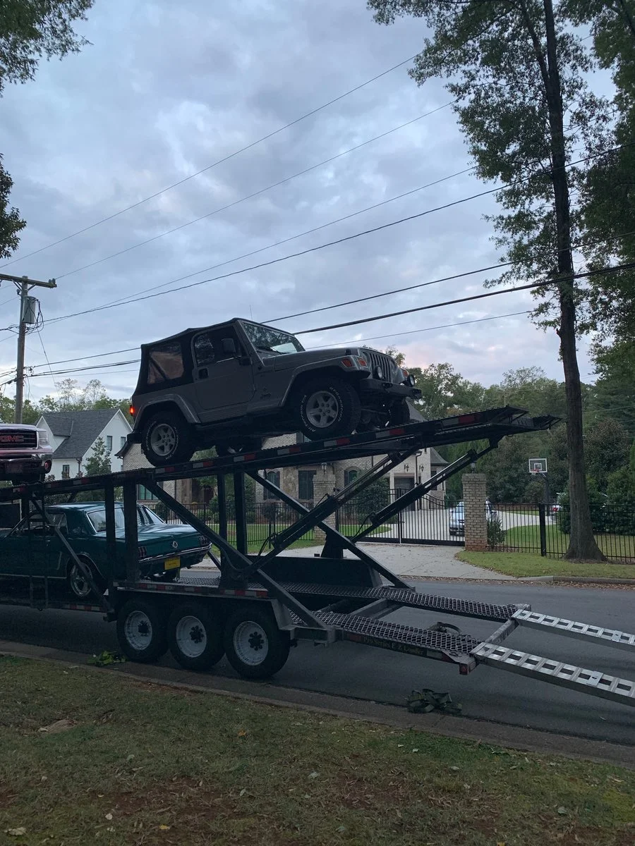

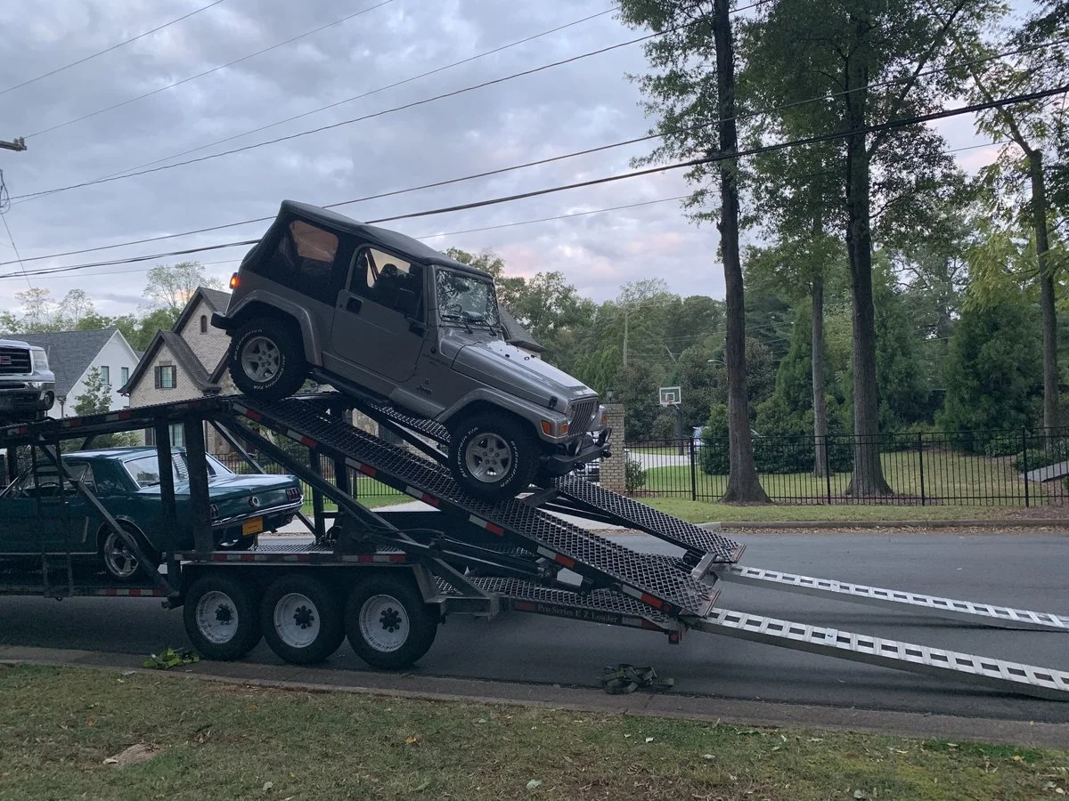

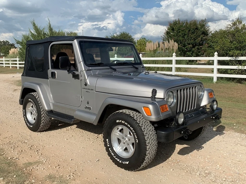

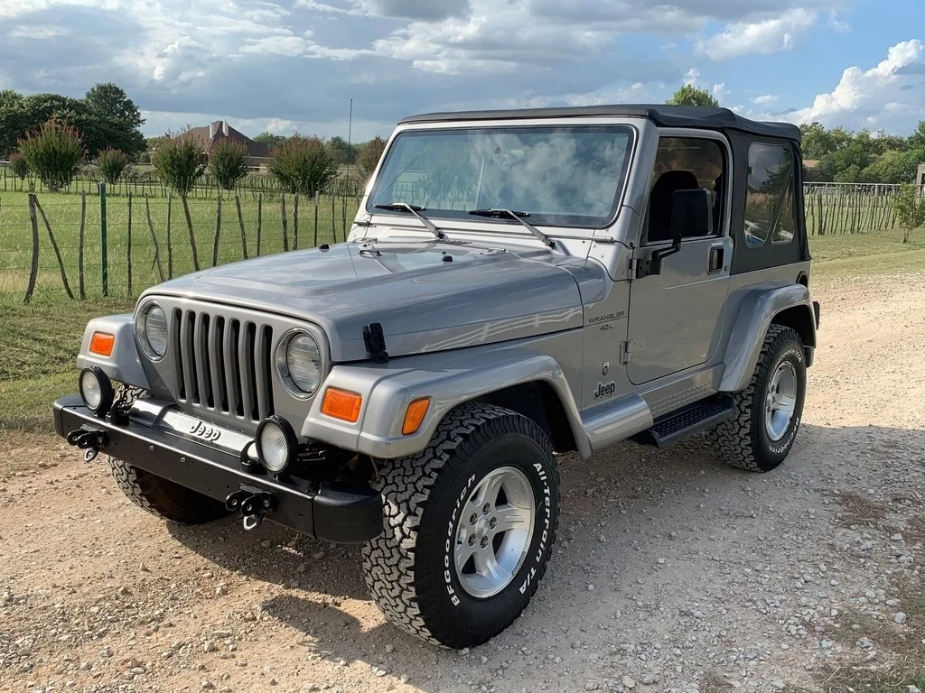

My first car was a 1998 Green Sahara. I loved that Jeep. This many years later, I am 38, have some money in the bank, and recently purchased a 60th Anniversary Edition TJ on e-bay. It arrived to my house in Charlotte, NC on a car carrier with 40k miles on the odometer and in basically stock condition with the minor exception of replaced tires, a new S-belt and some attachment hardware for being hauled behind the previous owner's RV.

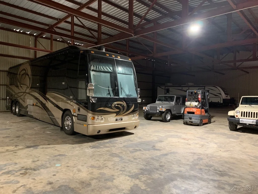

The Jeep was dirty but in great shape otherwise. I do believe it spent its life mostly being towed and living in a Texas airplane hangar — a great starting point!

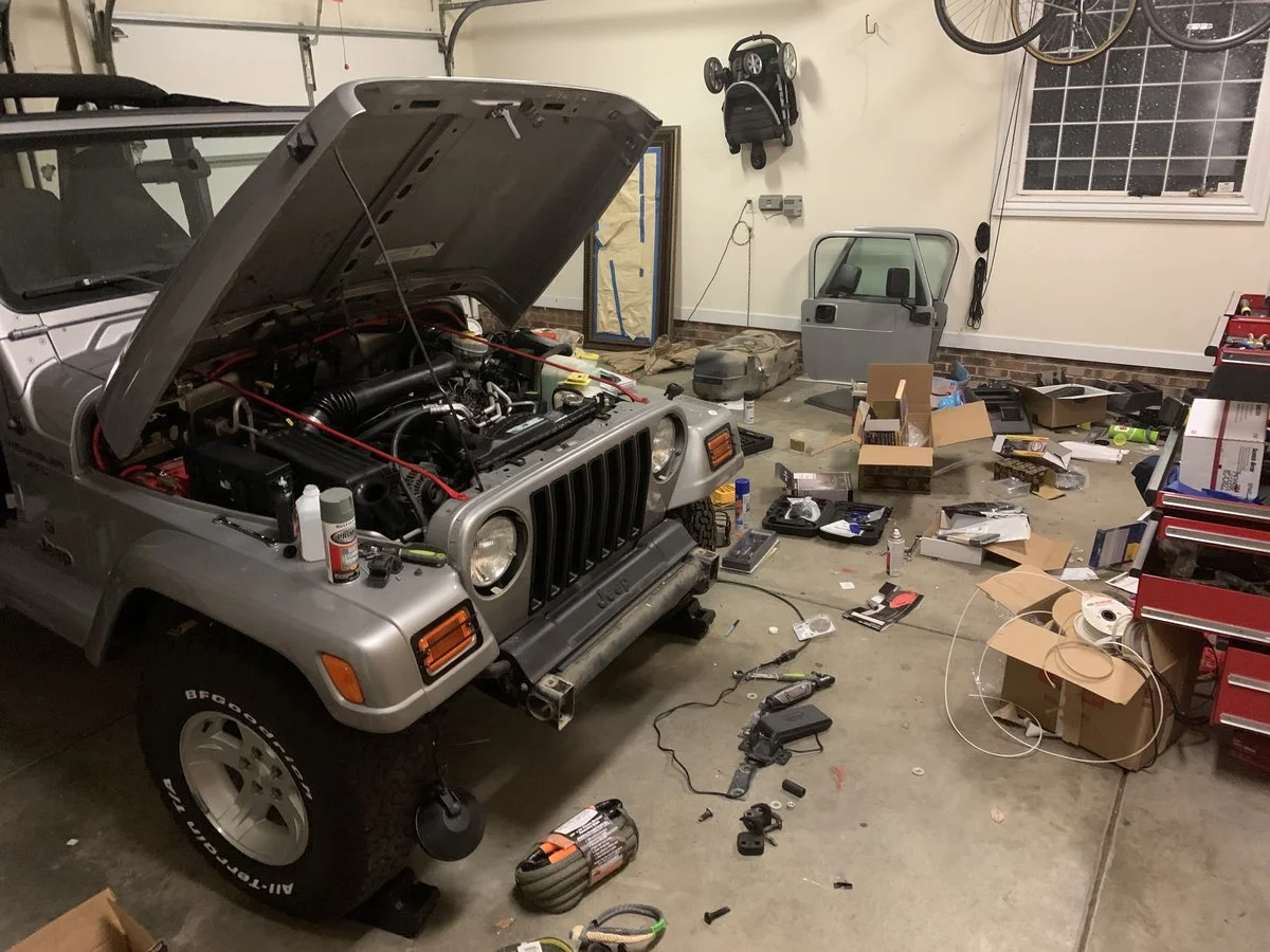

Phew... I think that's it. You guys can probably tell, I have gone down the rabbit hole with this Jeep. I have honestly been enjoying the work and project more than I expected. Some pieces have been challenging, and I have definitely said some horrible things along the way, but overall, this has been a great time.
The most current photos of the build as of 12/17/19:
Here are some photos from the first moments of when I received the Jeep. The first order of business was pulling the top, carpet, and dash apart. A good clean for everything. In pulling the rear tire and carrier off I think I may have found the Jeep's mascot - a permanent marker tattooed pink duck. It now belongs to my daughter.

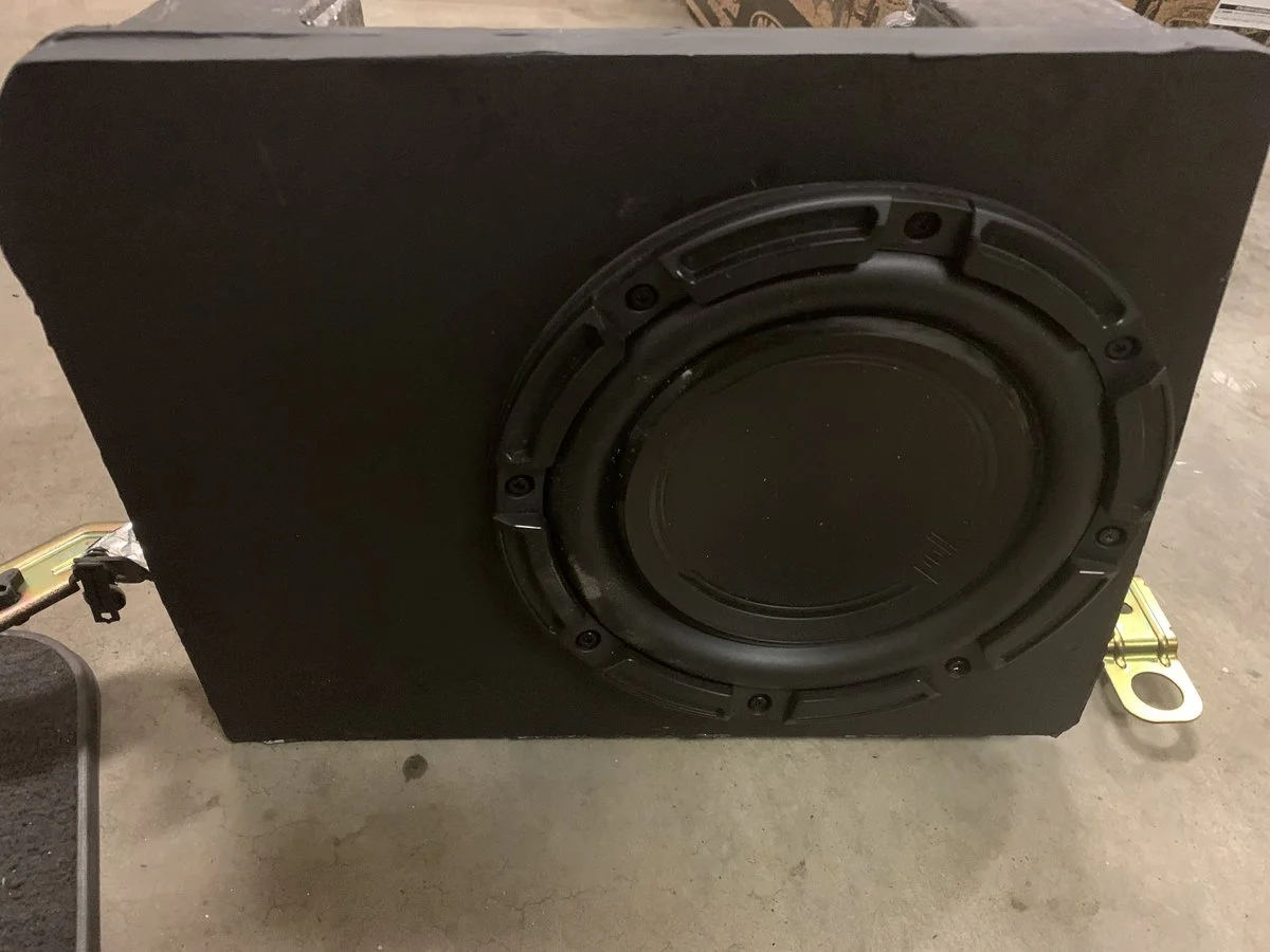

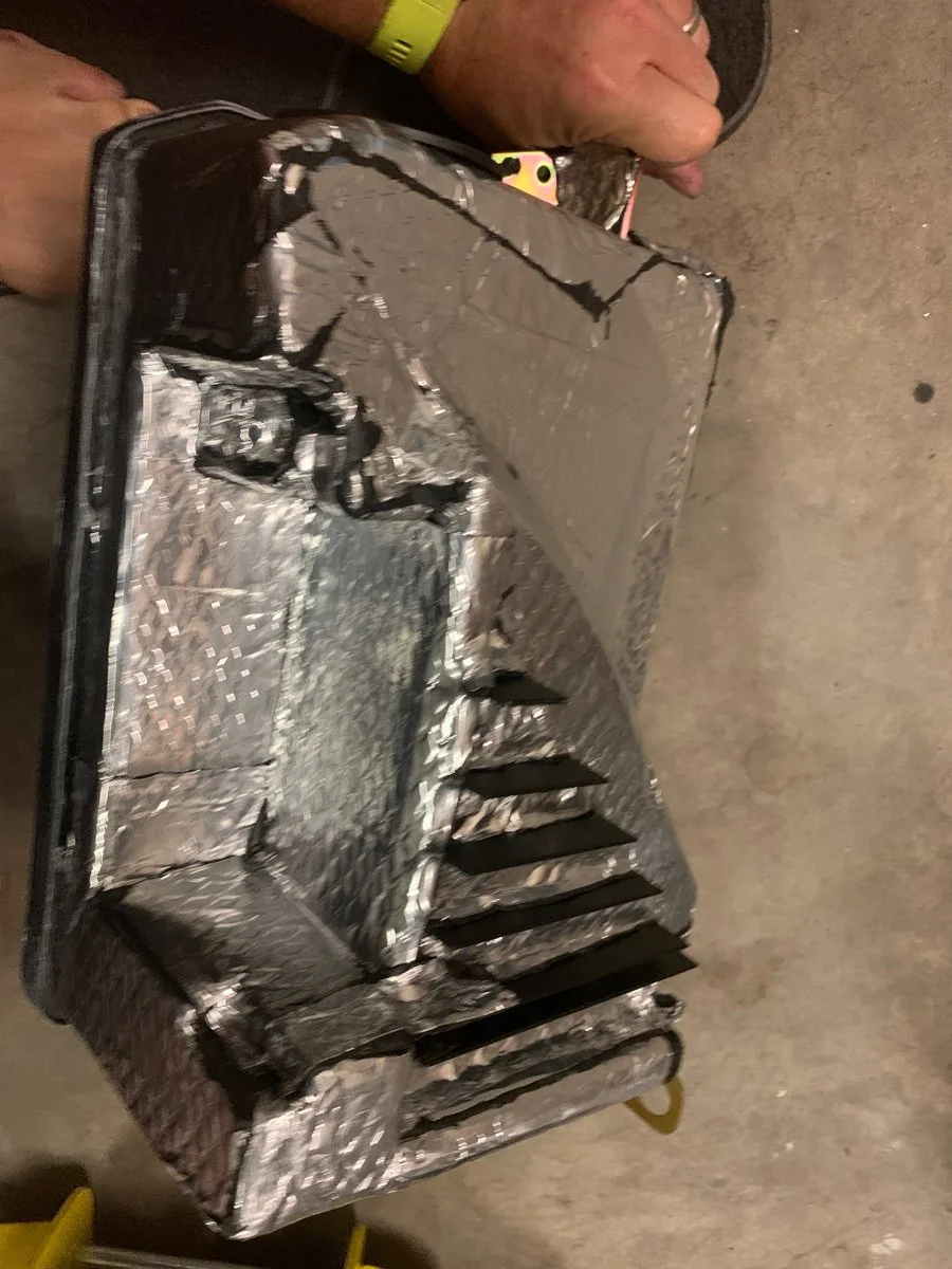

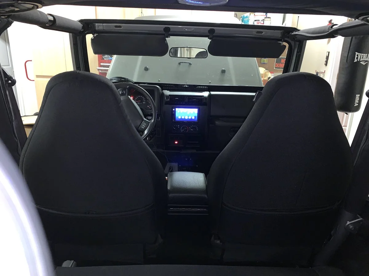

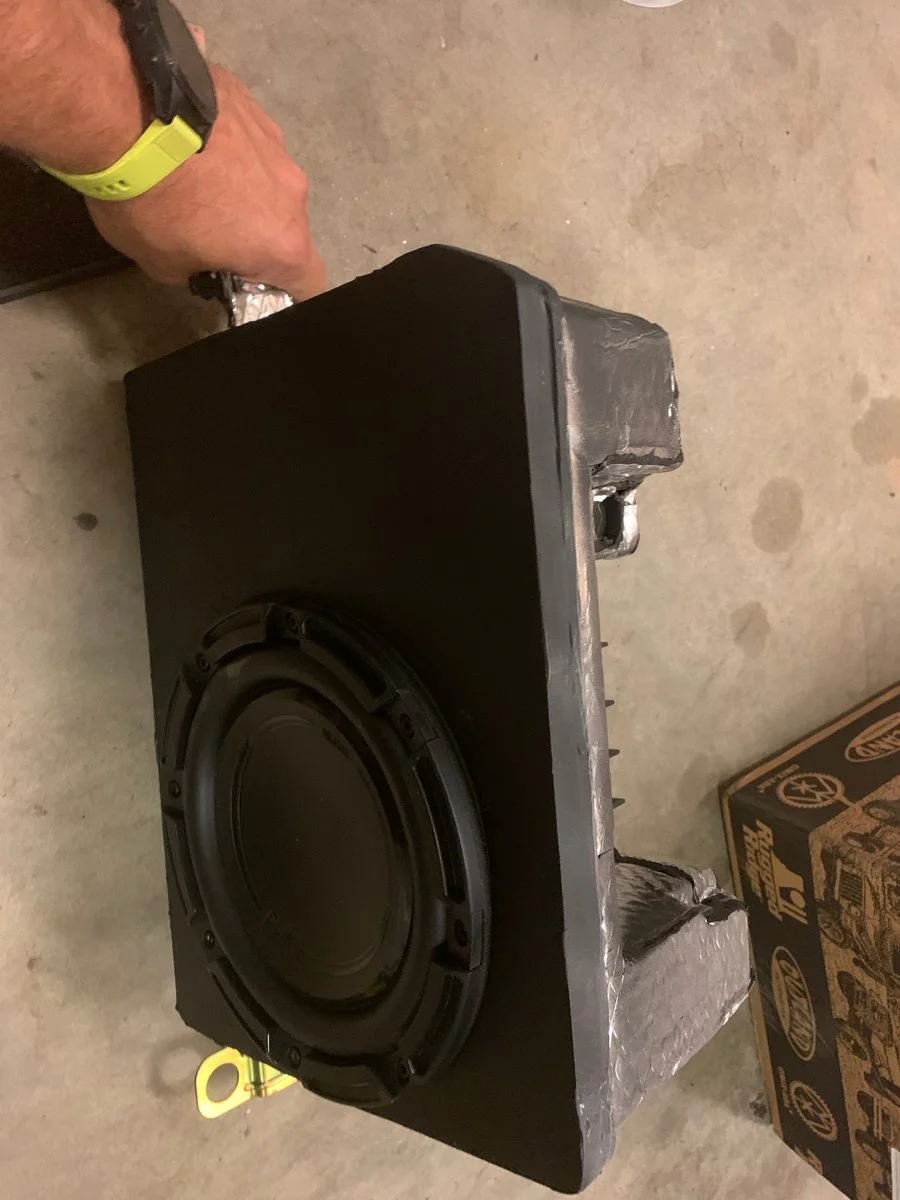

The audio work was pretty easy going except for the subwoofer box and the amp mounting. I don't have photos of the amps right now, but I can post some if anyone wants to see my solution. The Kendwoods I am using are tiny and I mounted them under the steering column. The subwoofer box is a combination of the old Mopar plastic enclosure and a custom cut piece of MDF that I used for the face of the box. I joined the two with liquid nails and screws and then wrapped the whole unit with Noico before mounting it in the Tuffy center console. The 8" Polk is what I expected. A speaker this size is nice enough, but it will never be a 12" in depth. Thankfully, I am past that point in my life. As a bonus photo, check out the original Audiolatina speakers - nothing but the finest from the factory!

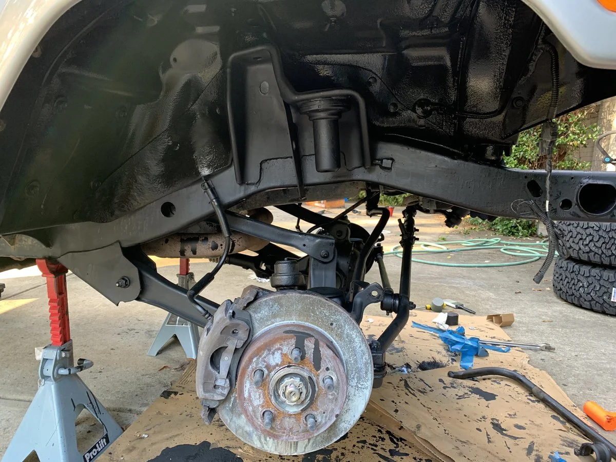

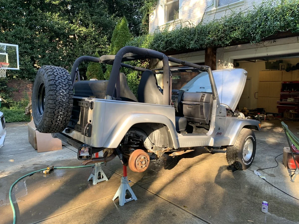

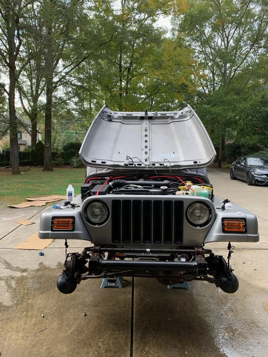

Here are a handful of photos, not in chronological order, from various points of the suspension and underbody work, as well as a few with the hood up. Lots of sanding, painting, wiring and lift kit things going on plus the fuel tank removal. This is as much as I have on the camera roll, but now that I have started this thread, I'll make more of an effort to document things through the rest of the build-out.

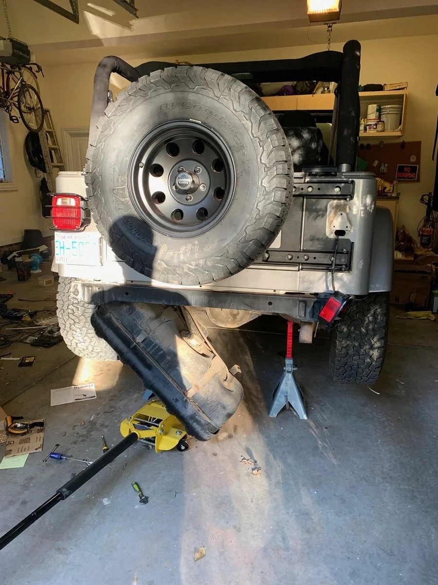

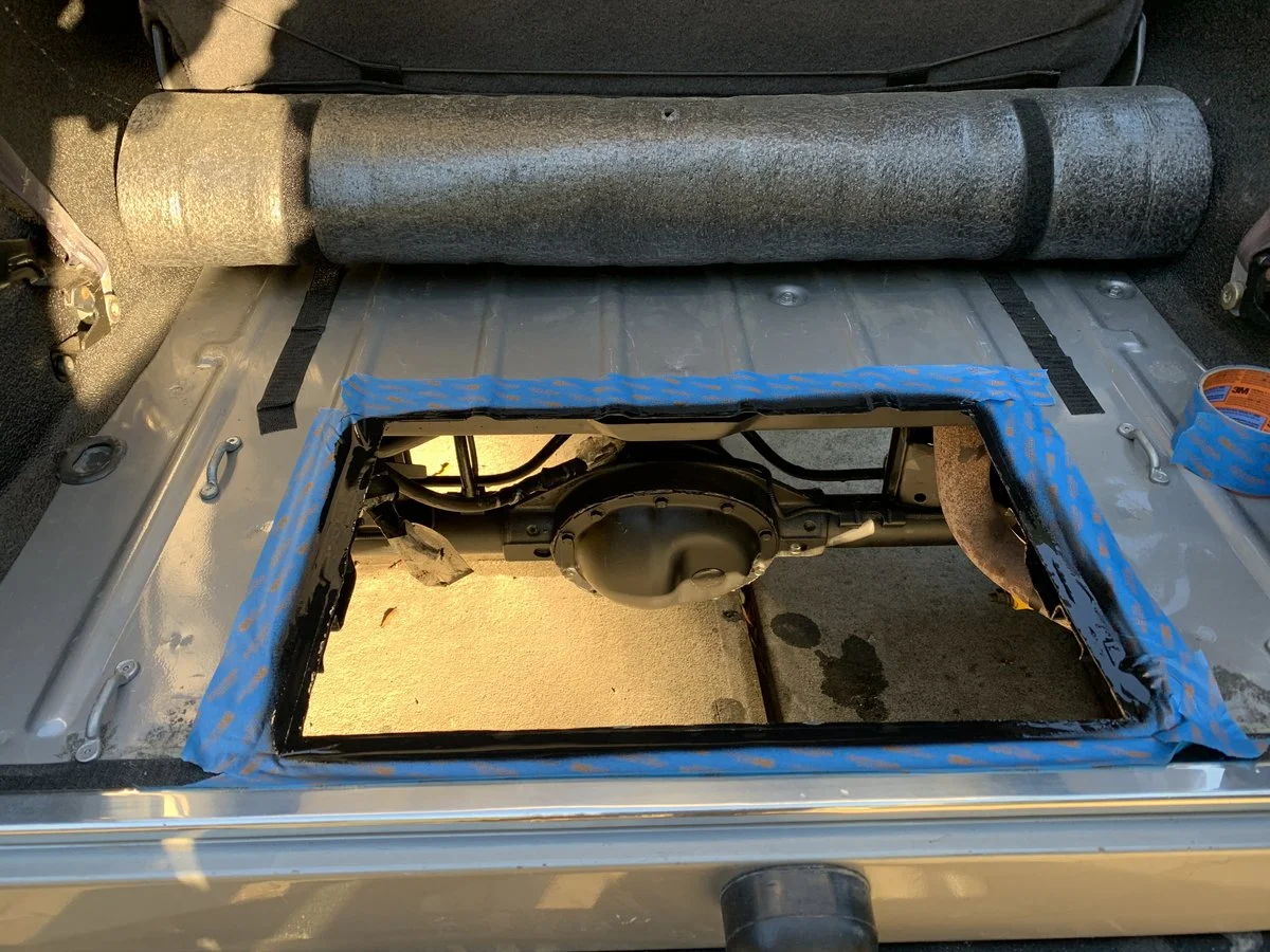

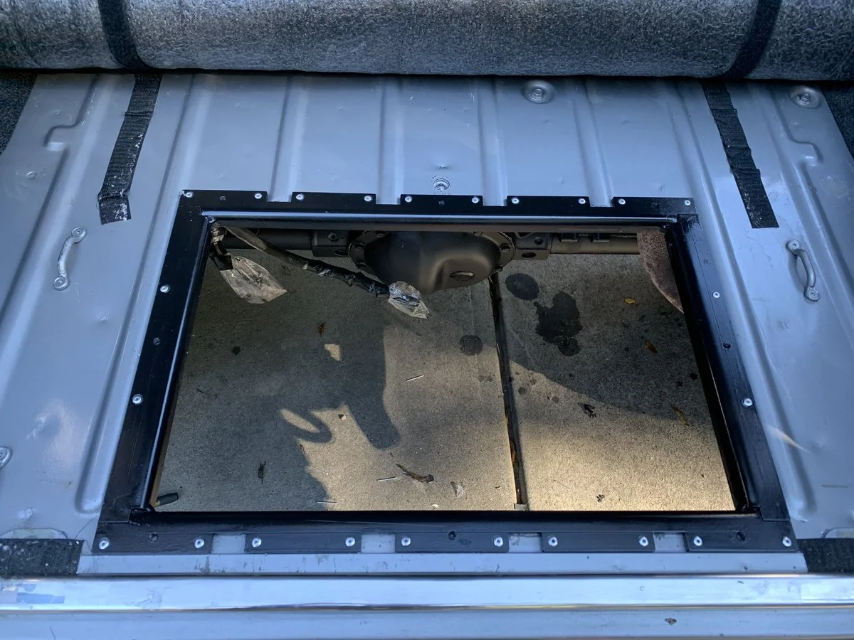

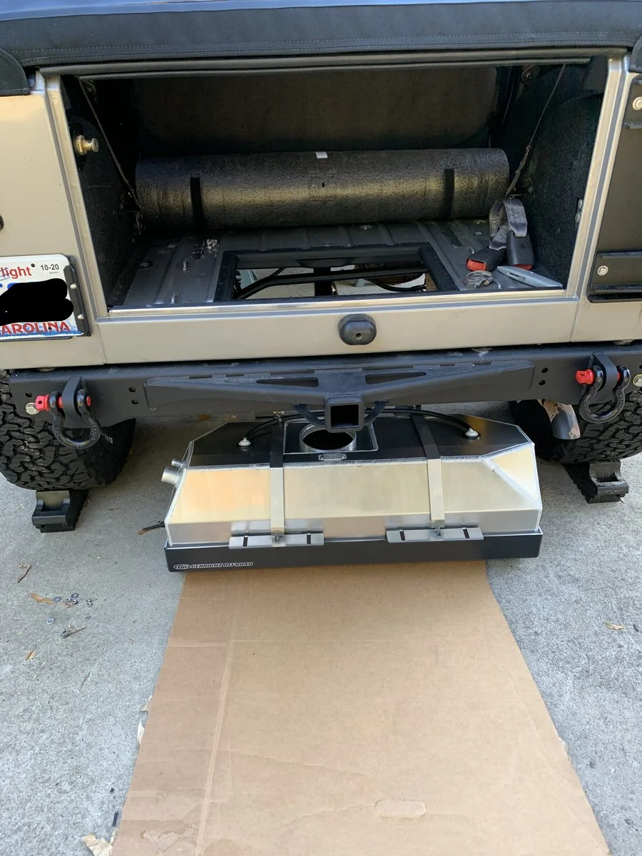

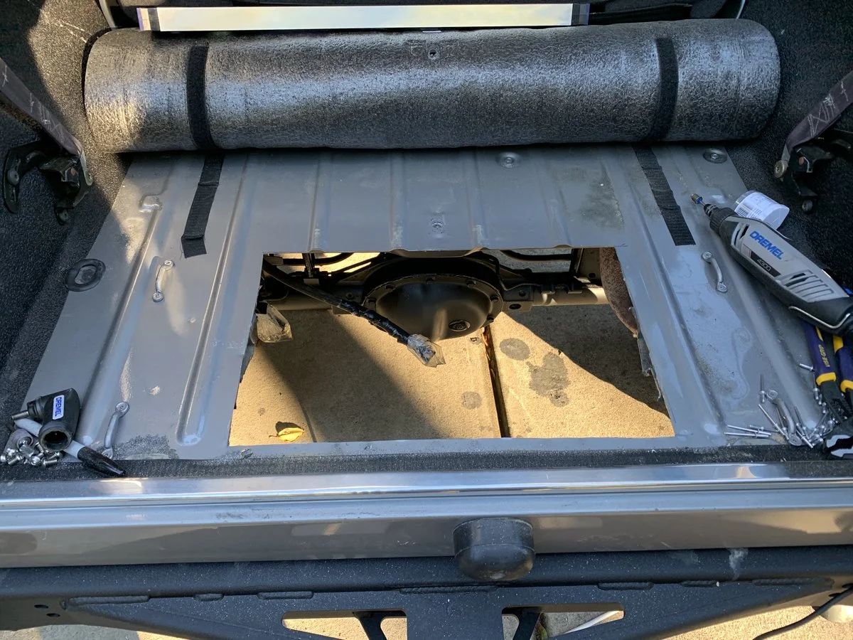

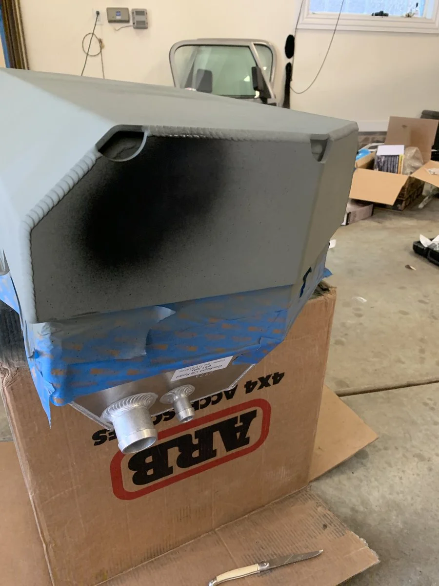

I decided early on to protect the fuel tank. I used to have a Tomken skid plate on my earlier jeep's tank, but it was quite heavy. When I went looking for lighter, more elegant alternatives, I discovered that Genright makes a 25 gallon aluminum tank with its own skid. They advertise that, despite the increased capacity, it bolts right into the factory position, and I was sold. (I have yet to install it.)

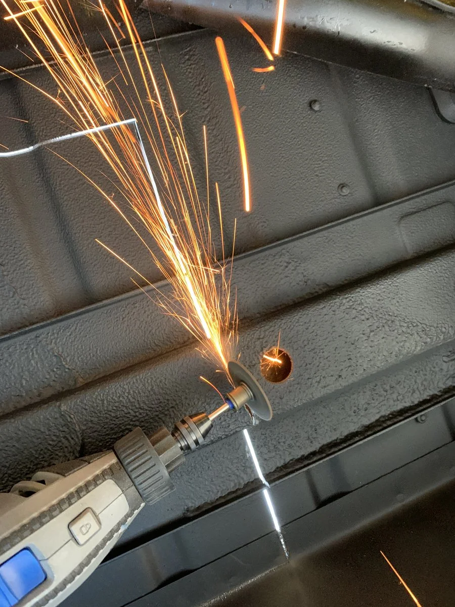

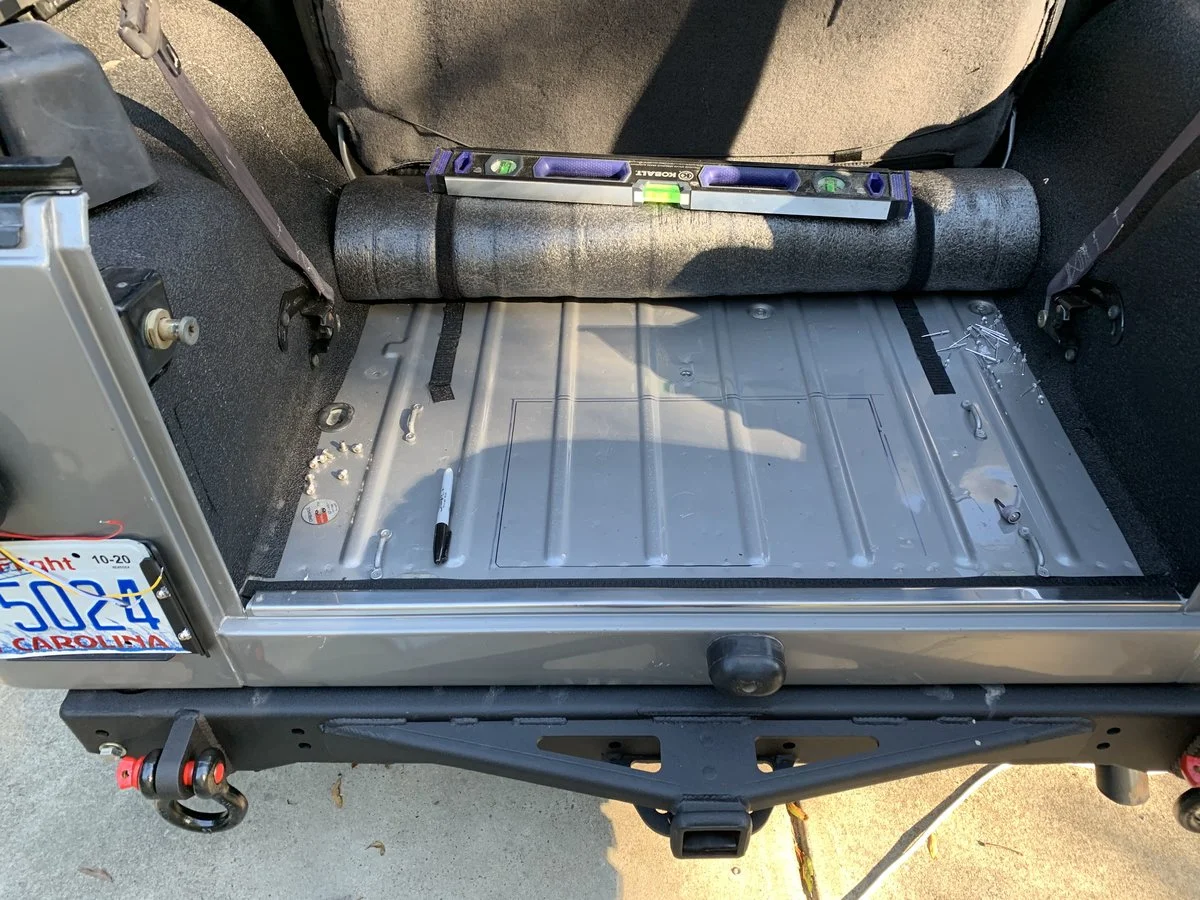

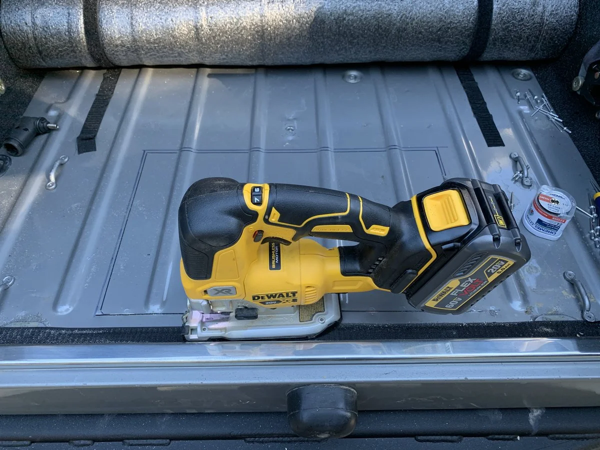

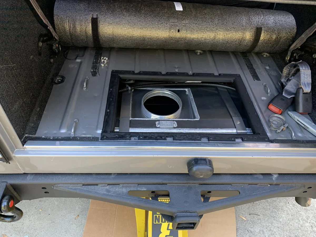

One of the options Genright offers is an access panel that cuts in and installs over the fuel pump. It may be overkill, but since I decided to undertake the tank swap, I figured I might as well go all in.
Yesterday, I painted the tank black and began the install for this panel. Pretty simple stuff if you have the right tools.
Photos to follow. When I have it caulked, riveted and finished, I'll add more photos and edit this post.

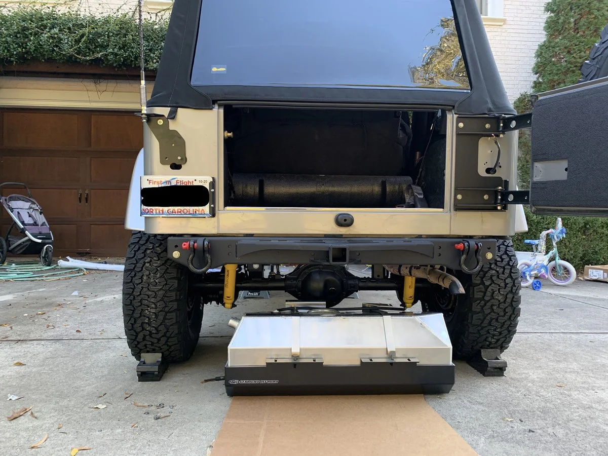

All installed. On a whole, this was a pretty simple swap out if you have the right tools. (I can't imagine it without them.)
The worst part was getting the damn ring off the old fuel pump. The Genright custom wrench was a flimsy joke; a strap wrench did nothing; but a dead blow hammer and big flathead did the trick. It blows my mind how tight the plastic on plastic bond became over the years!

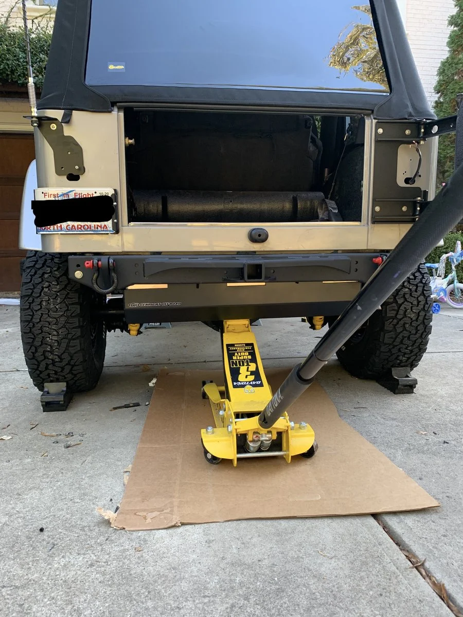

Credit to Genright for getting the hole alignment perfect. I just raised the tank on my jack, connected the hoses, raised it the rest of the way, bumped it into place with my hand and bolted it right up.

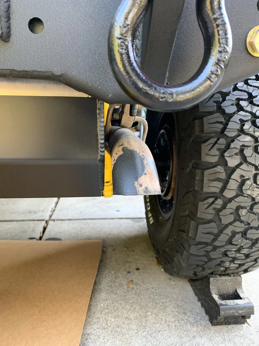

** Note how close the exhaust is to the tank, however. I am swapping for a Borla cat-back, and will finesse this when I put it in.

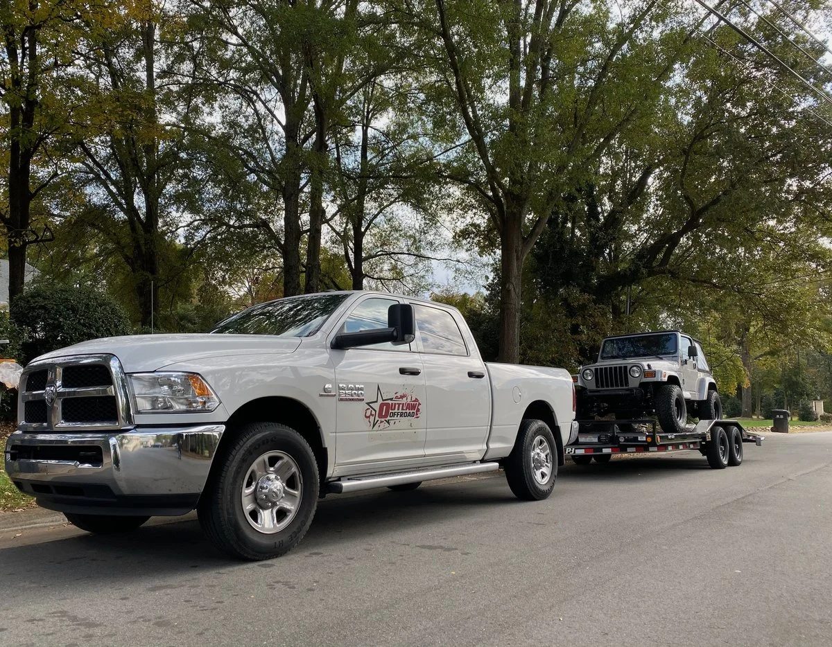

Tomorrow, my Jeep heads to the shop for new gears. Good bye 3.07. Hello 4.10. Good stuff!

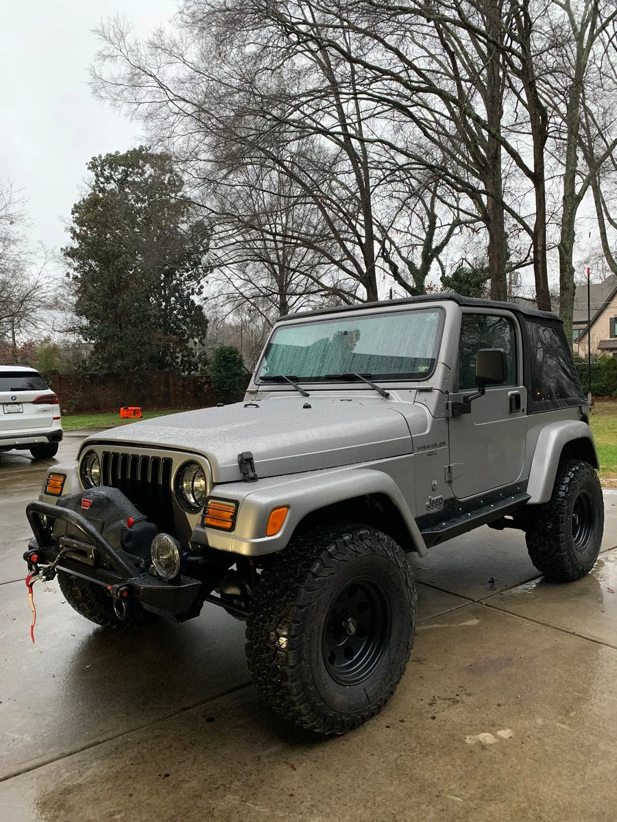

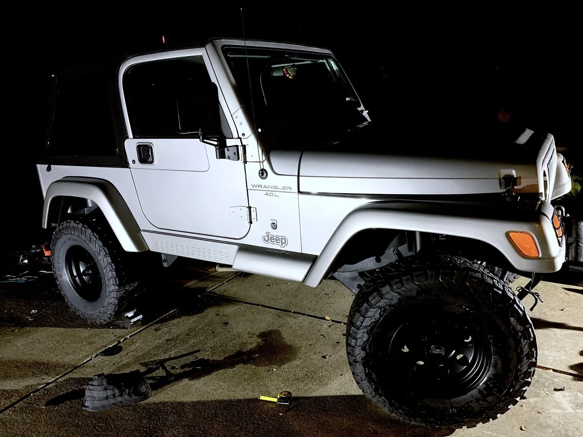

I scrambled in the dark to get it trailer ready. It was the first time I've had all four wheels on since adding the lift kit. (Big moment!) In my opinion, the OME 2.5" and 32x11.50's looks pretty sharp. (I have not added any body lift.)

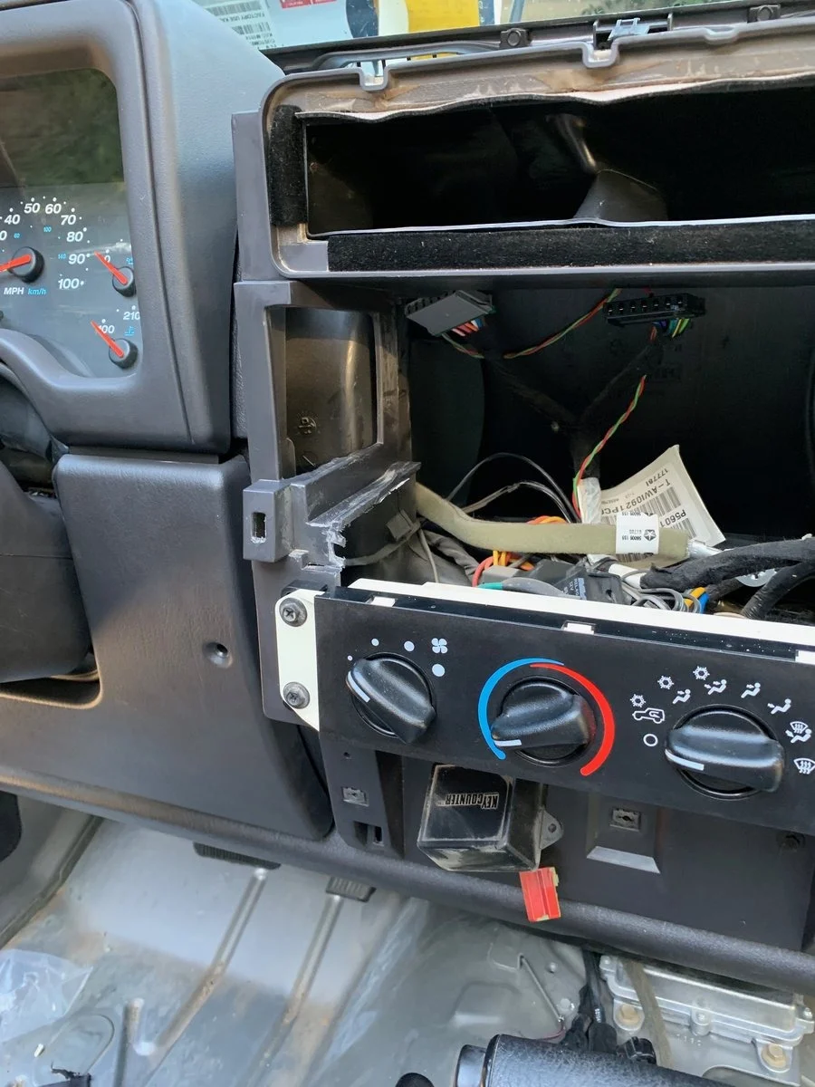

Noticed you cut the dash for new radio What did you put in and how did trim out end up
I put a Sony XAV-AX1000 double din unit in. The cut is simple stuff if you have a 90 attachment for your Dremmel. I'll throw two photos up. Kind of dark, but you get the idea.
