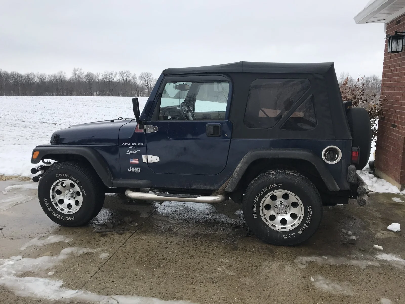

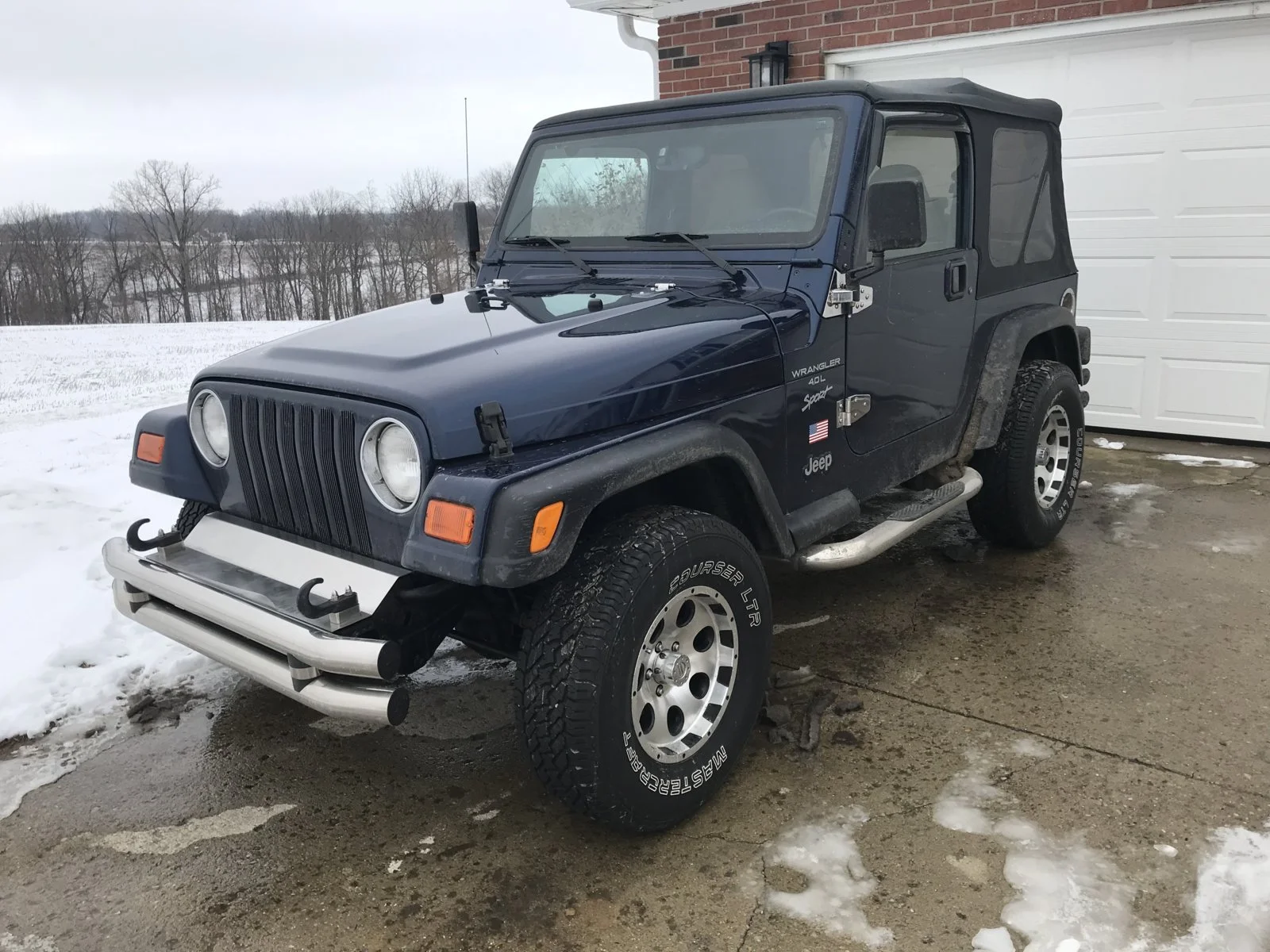

Welcome...Get some pics of that Jeep up. What size tires are you running? If you measure your springs, that can tell you the lift amount, if any. Stock front is 12" stock rear is 8". Any more than that is a spring lift. Also, if there is a plastic puck on top of the spring, that will provide lift too.
To correct your ride: If it is "bouncy" after bumps, that indicates worn shocks that can no longer resist the motion of the spring. Replace them. If the ride is "harsh" but controlled, typical fixes include lower tire pressure (lots of shops overinflate the tires). Most guys run around 26 psi on 33 x 12.5 tires. Skinnier tires, increase pressure. You might also have crummy shocks...some ride very stiff because they are designed for heavier vehicles.
As far as replacement parts...the list can be quite long. You have 3 tie rod ends in the steering that can loosen up, 4 ball joints (2 on each knuckle), the steering box itself can wear, the control arm bushings can be worn and contribute to a loose feeling. The trackbars, front and rear, have bushings that can wear out. There is also a non-replaceable ball joint on the frame end of the trackbar. I wouldn't try to fix everything at once. It you have the means, put the front end on jackstands, grab a big pry bar, and try flexing the individual joints. If they are worn out, they will move pretty easily and sometimes make a clunk. That is what a good shop would do, but I fear most shops will just look at it, then give you an estimate for 2000 bucks to replace the whole lot.

I was able to get some pics posted and hope to have some time to check things out since the vortex meltdown is underway.
I’ll start with what you mentioned above and will let you know what I find out.
When you hit bumps in the road it feels out of control and bounces you around.
The Jeep doesn’t continue to bounce like it’s riding only on springs.
I was looking at shocks and springs and maybe that’s the best start to make it more stable.
I’m debating if this was a good decision on her first vehicle but for $8000 I thought it was a pretty good deal.
