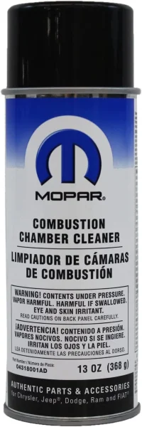

Have you tried using some sort of aerosol carbon remover? Mopar used to sell a can specifically for the 4 liter. Sea foam works pretty good if you buy the kit that attaches it to a vacuum hose. You could also just pour it directly into the throttle body with the engine running. Make sure your in a place that won’t call the fire dept because it smokes like crazy. I’d also swap the plugs out to a stock replacement like champion or NGK.

https://www.amazon.com/dp/B00BV4D97K/?tag=wranglerorg-20
